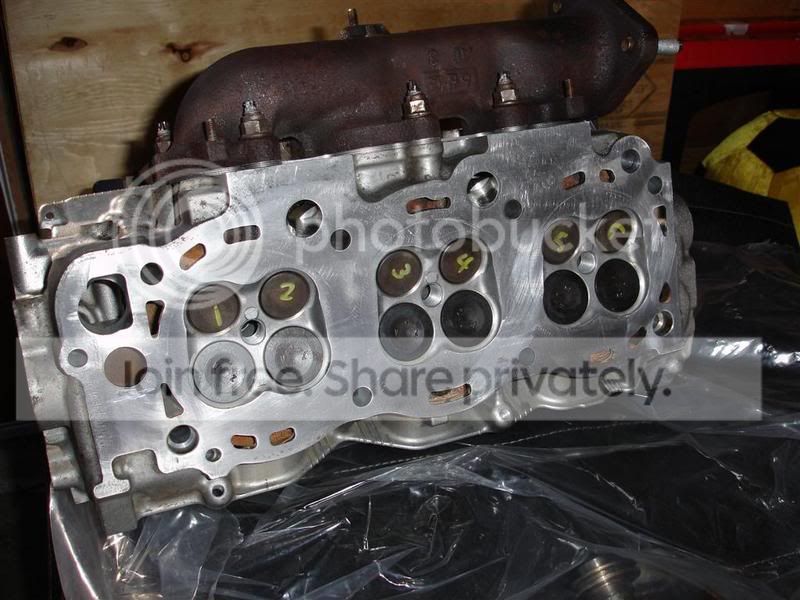

I'm surprised the 5VZ is cracking heads because I don't think I've seen one yet. I've seen plenty of cracked valves and I have seen cracked heads on the 3RZ for sure too. There isn't much clearance between the two, you're right but that would definately be a serious design flaw if there were any significant number failing in this manner.
Here's a pic from my HG job:
