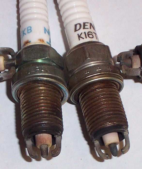

Better late than never, here's that pic I said I'd take of my stock plugs. NGK is on the left and from the passenger side, Denso is on the right and from the drivers side. These plugs were pulled after 65k miles as you can see there is much greater electrode erosion on the drivers side. Otherwise the plugs had very similar insulator colors, one side was lightly coated brown (intake valve side) the other side was uncoated and looked new (exhaust valve)

Uh...
What pic?
Dr. Z
Old Apr 15, 2003 | 07:32 PM
FattyCBR's Avatar
Joined: Oct 2002
Posts: 524
From: Towson, MD
What you can't see it? Yotatech froze up on me while submitting the reply.
