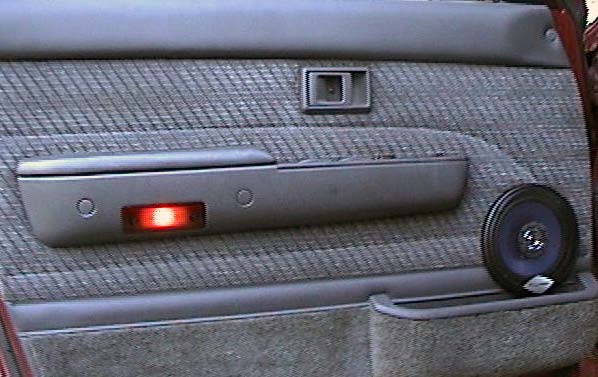

no fabing at all other than cutting a whole in the door panel. the metal on the door has a perfect spot just above the door console ill post a pick. i thought it would be extremely close with the window going up and down, but they fit and work perfect with no problems with the windows up or down. they look really good in their current location too. i thought at first i was going to have to take my door console off too, but the speaker fits perfect just slightly above it.

heres the other door. i was sweating lining them up the same but i think they came out pretty good
