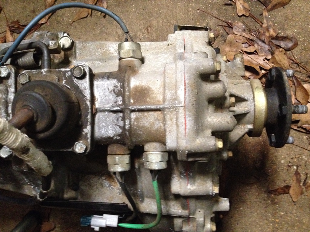

Old Jan 19, 2017 | 09:24 PM
Charchee's Avatar
Joined: Jul 2012
Posts: 893
From: Arkansas
Only two huh? Man Durk, you and I have walked a hundred folks through these issues and I swear there's something new to learn every time. I see no reason why in the world a J-Shift with no actuator would have three switches but there is one in my carport with three of them. 2000 SR5 Auto. I mean how many different configurations did they make? What the hell is that third switch. The third switch in the electronic ones that I'm familiar with is for the center diff lock/unlock best I can tell. Could it be a neutral position indicator.
I don't know. Just thought you'd get a kick out of that.
Old Jan 20, 2017 | 03:29 AM
teleman37's Avatar
Joined: Jan 2017
Posts: 19
The SR5 in my year only have 2 seniors, one on the driver side and one on the passenger side. I removed the crossmember under the transfer case and used a jack to lower it down just enough to get my gear wrench on the sensor. I could only see 2 sensors.

Huh?. You got me. I do not have EWDs for 2000 and I just use my '99 as they are always identical to 1999. (Canadian 1999s because they have DRLs.) I'd love to see that EWD.to see how it changes with that extra switch..
