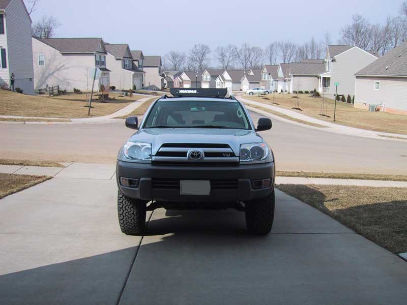

Here is some pictures after the lift and the 285's.
Attached Thumbnails 4th gen. 3inch RevTech and 285/75????-truckweb.jpg

Old Mar 3, 2004 | 11:06 AM
Good Times's Avatar
Joined: Dec 2002
Posts: 4,690
From: Los Angeles, CA
LOokin good
btw, what made ya go w/ the arb air? Just wondering.... I hope you're not gonna use that to air up cuz you'll fry the motor plus it'll be slloooow.

Still a bit more trimming needed.......
Attached Thumbnails 4th gen. 3inch RevTech and 285/75????-truckwebfront.jpg
Old Mar 3, 2004 | 11:12 AM
Taints2k3's Avatar
Joined: Feb 2004
Posts: 22
From: North East, MD
Thanks! I got a good deal on the ARB, no other reason, really dont even need it. I did use it once to air up tires after surf fishing, but wont take long to burn it up with these tires...Only thing I found it good for is filling up kids arm floaties!!! And a smoker could fill those up with a breath or 2...
