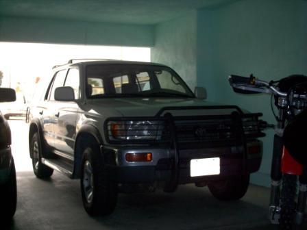

I will have to post a pic of my Beast so you can see her in all of her agony! I have the black plastic fender flares, so it would really look dumb without the running boards!

Here is the Beast in all her agony. I think that it would look dumb without the Running Boards!
