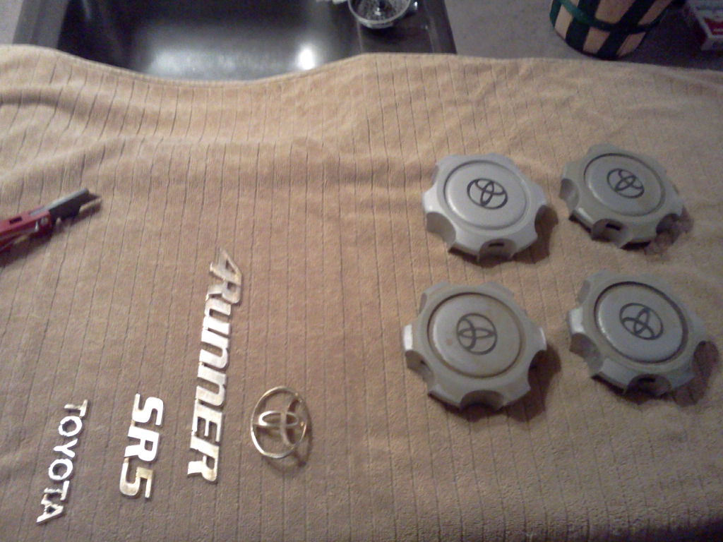

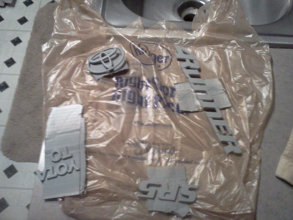

Hello, I'm new on here. I'm into modifying things and am very happy there's a place where I'm not alone. I've read lots of threads, got a lot of great ideas. Some of the guys on here should design toyotas full time. First off, sorry if I posted in the wrong place, like I said I'm new to this fancy internet thing .. so feel free to move my thread if needed. Thanks. Ok , I grabed a 98 4runner that has 170,000 miles, I had a toyota sienna xle, nice van, but still a van ; ) my toyota badges were flakey and turning green. I didn't like that so I looked on here, found out how to take em off , and did. I sanded , primed , and painted them black and a ton of clear. I like em. Still need to go back on. But its freezing cold in columbus, and I need to do more work on my rear gate before they go on. I'm going to get a dent out and repaint white. Then re install the badges. So I have time to kill and I removed the grill, added a little mesh behind the grill and now need to reinstall. Its not as cool as the schotki mod " sorry I know its spelled wrong " but I didn't feel like getting that involved in the grill right now " definitely in the future " now I need to find a rear windshield arm, used parts are hard to find around here. Well just adding my little bit . I love the 4runner , the back window is the best thing ever. Mine is a 98 sr5 automatic , no rear locker : ( , I'm planing on doing the deckplate mod, isr mod , cup holder mod " who puts the cup holder above everything? " I'm going to put the rino liner in a can on the lower part of the truck , rear and front bumpers. And many more mods to come I'm sure. I can't seem to upload picts? Keeps crashing. Damn you android!
The badges look very nice. Welcome to YT!! get a photobucket account and upload all the photos to it (its free) then copy the img code to here when you want to post a picture. Keep up the good work!
Hey guys, thanks I like em a lot better. I'm not sure how to repost this but feel free to share/repost it. Ill get a photobucket account , thanks for the heads up. Yea the badges were just sanded , primed with a rattle can , and painted with gloss black , then cleared 100 times give or take .. they seem pretty bulletproof . I wasn't into the plastidip, it costs as much as all the cans I bought, with not so permanent results. The clear coat is the key for a lifetime of use.

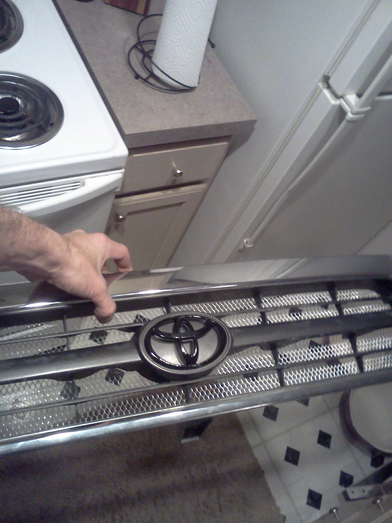

Soon as it warms up just a little I'm going to be back to working on the runner, its seriously just too cold with no garage. I put the grill back on and it was freezing. Next is to fix / try to remove a dent in the rear, bondo the imperfections, then tape off everything / back window, and prime and paint it with an automotive based spray can " I ve only sprayed auto paint once or twice before " and don't have an hvlp, and used rust~oleum automotive spray cans before with amazing results. Looks exactly like an auto finish . It blew me away. I'm still looking for a good spray can of super glossy clear, no luck yet. If anyone knows of one, id try it. If it was a side panel id take it somewhere, but being just the rear, I can do that easily with a rattle can. I'll take picts and share with the class. I'm probably going to do the hurculiner the same day, above my running boards its getting rusty, I want to eliminate all the rust along the bottom. I'm going to tape off the doors above the factory "ryno coating " ? Not sure what its called. Down low, then use the hurculiner after sanding it all down to bare metal, or as close as I can get , prime it a couple of times, and hurculine the bumpers, plastic side flares, above the running boards, the rear bumper and if the running boards look funny, do them too, and clear coat it for uv. I'm hoping that will take care of the painting untill I do the rims gun metal gray, or whatever goes with everything . So busy next week, ill take before and during picts . But that's the game plan, then I can finally put my badges back on.

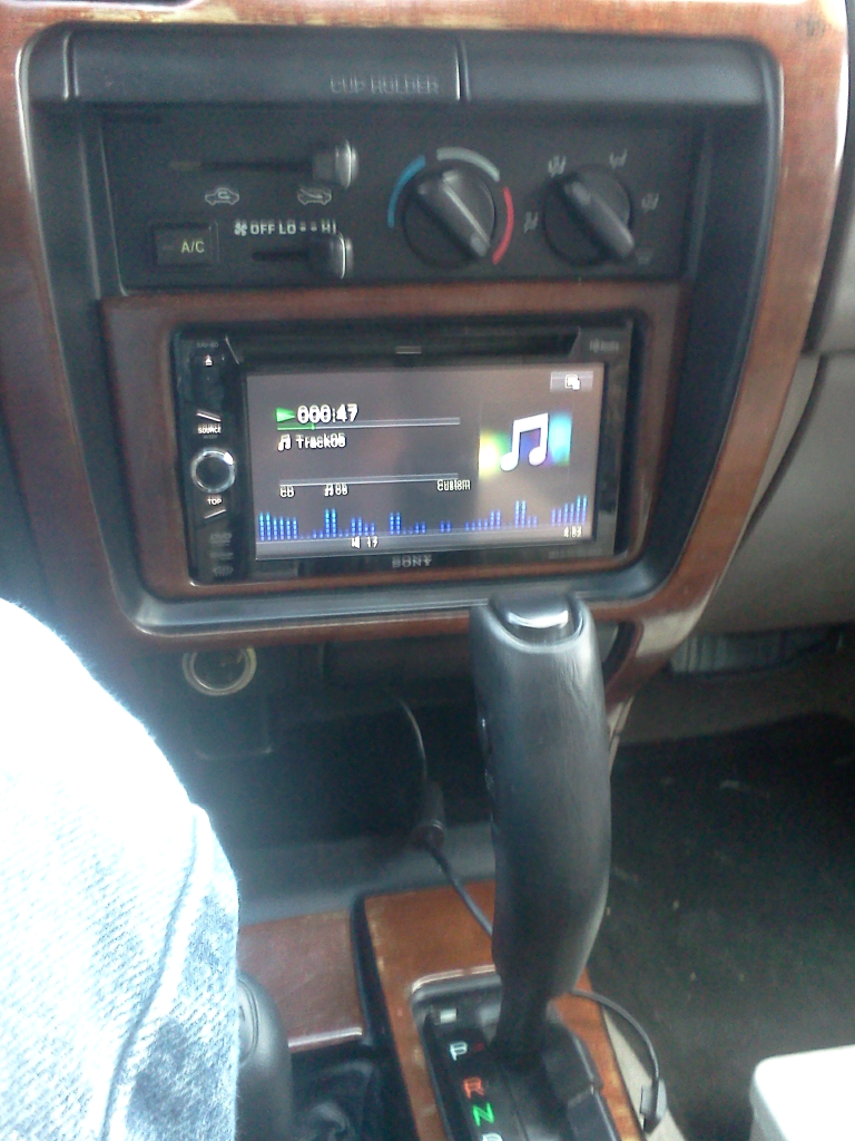

So I just installed a sony xav 60 double din dvd in the 4runner , one word, PIMP. Lots of cool features, nice sound, great picture quality when watching movies, ipod control. Pretty sweet. I found out that the rear window antenna will work alone with the head units. Needed an adaptor, it was 8.99 at wallyworld, it had all the different antennas ( dodge, gm, toyota, vw and a couple others) and went to a standard antenna witch went into the deck. Easy as pie. I was a little nervous it might be cellular from way-back-when because of the funny end, but it worked flawlessly. So I no longer have to hear the broken power antenna. Edit : i heard the antenna today , i think i just didnt hear it because of the new raidio , have to find another route to figure it out . o crazy every time I get in or out. ; ) and used just the rear antenna. Couldn't be happier . My electrician buddy said if you combine two antennas , it might degrade the reception because of something about needing 75 ohm

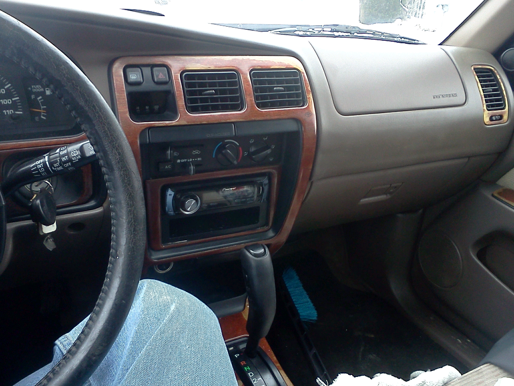

Now you gotta do something about that woodgrain trim. You should take off that center bezel and peel off the trim. If you can't get some of the glue off or scrape it a little bit, just sand it down some and get some plastic paint and paint it black again. I did this with mine a couple years after I put new woodgrain off ebay on it. I had some knicks in it, and bondoed them and sanded it all nice, it looked perfect after paint, and it's such an easy small piece to sand/paint. It looks nice and clean with the all black too. Yours wood look awesome with that sleek in-dash. Consider doing that instead of buying new woodgran, cheaper and simpler/sleeker.
Both you guys read my mind , yea, I want to remove the front antenna. Its ugly, flakey gold , discolored. I was thinking the same thing, remove and bondo. You had a great idea putting a panel in first underneath , then floating out with mud, I was thinking about taping off around the area, fill and paint it. Keeping it small rather than spraying the whole panel. I think it would be bearly noticeable witch is cool with me. The trucks not perfect. But I want it to look good. I was super happy when I read about the 2nd antenna in the rear window. Yea I definitely need that little arm for the rear window , it just crumbled when I took it off. When I start to paint I'm going to remove the rest of it prior to painting. Ill tell ya this weather is killing my working on the truck.
Also yea I've been thinking about removing the faux wood package, I think it would be nice if it was in good shape. But mines hit in the mouth. The fourms say its a long day of work , so I'm waiting till its a little warmer. But I definitely want it gone, I've seen picts of runners without it and I almost think they look better. So again just waiting for this weather to get a little nicer.

Removed the wood grain dash kit : )
Items used
1 . Hair dryer
2 . Wallet sized gas perks card at local gas station
3 . Wd-40 and rag
4 . Armorall or similar and a new rag
Turned the truck on and let it heat up, its still in the mid 30°s right now outside. Kinda angled the vents to get the plastic hot-ish . Used a hair dryer to heat the area I was working on , I used a free plastic wallet sized gas perks card and worked it underneath the corners and pushed it as far as I could. Reheat and do again. It left small amounts of residue behind. After all the plastic-wood was off I killed the engine and was warm enough and started to remove the residue. Thanks to another post I used their suggestion , got a towel soaked a small corner area with wd-40. Placed it on the thick areas of goo and let it saturate the foam goo. I found getting it wet, waiting a minute and using a dry area of the towel to rub stubborn areas worked the best. The rest is elbow grease and time, when all is removed, use your armorall or whatever to shine it up. I lucked out and don't need to paint mine, I think because I used a thin, flexible gas rewards card. So I didn't really scratch it up.
I like it a lot better, and it didn't cost me a thing. So win, win.
