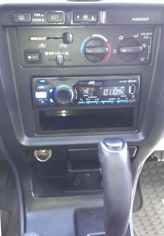

The lights I needed to replace are for the climate control, rear window, ECT, ashtray, and cigarette lighter.
Here is a pic of the dash on my 1999 4Runner SR5:

PART NUMBERS
Cig lighter: 84999-10250
Climate ctl: 90010-05152 (Qty 2)
Ashtray: 90010-05152
ECT: 90010-01042
Rear window: 90011-01038
Contrary to what I'd read the 90010-05152 bulbs came with the green "hat" already on them, so I didn't need to worry about saving the old ones.
