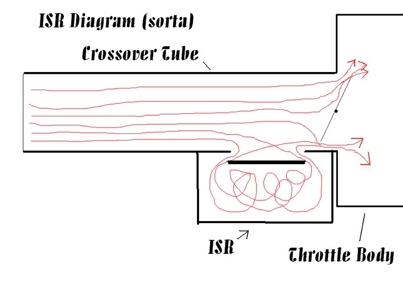

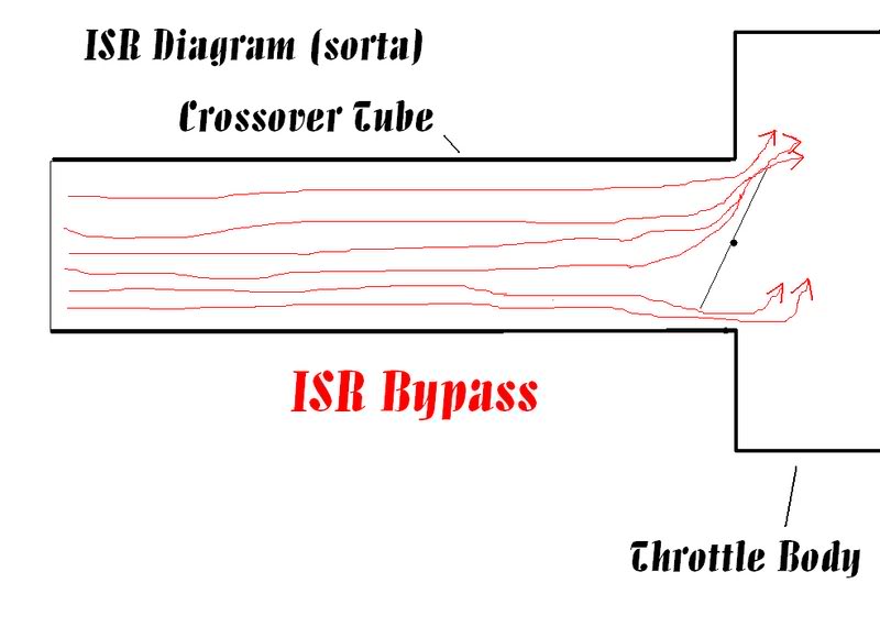

Intakes arent loud by any means, you can hear some draw at an open ended filter with a straight tube, but when the hoods down there will be no difference.
And as far as no power benefeit, wrong. Your taking the air that was brought through the tube and sending some of it down into a little box before it enters the throttle body. As more air goes down into the ISR it starts to get pushed back out, creating friction and slowing airflow. Once the cycle of air gets going it is no problem. But snappy acceleration is decreased when you have to cylce it through the ISR, rather than bypass it and send all the air straight to the TB.

I used the only photoshop i can afford... A.K.A. paint.

The intake silencer does just that....silences the SOUND of the intake. It has little or nothing to do with the airflow. Removing the intake silencer will NOT gain you any horsepower, and even if it did, it would be negligable at best. The air flows OVER the hole/tube, not down and in through it.
Direct flow intakes are quite loud. Ever hear one of those honduhs take off under heavy acceleration? Its very much louder. Often times its drowned out by fart can mufflers so its not as noticable. But its still there. Even with the hood down.
Also, a lot of the "gain" in vehicles comes from wishful thinking. If you THINK it is more responsive, then by all means it "is". However, dynos will prove that wrong. Many people get drawn into believing that THEIR car gained the advertised 15+ hp, despite that number being for one type of car ONLY. (read the fine print ) The gain in intakes comes from better airflow via straighter larger pipes and better filtering elements.
