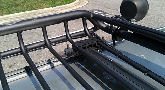

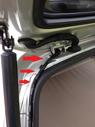

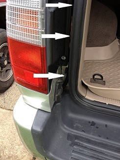

pics of wiring of roof rack lights

Nice work man! Got any more shots of that rack...do you have lights on it up front?

Yeah here are 3 more

I ran all the wiring down beside the rubber surround and then to the bottom of the truck and down by the frame rails to the front and then put in relays for each set and then only had to run wire to the switch through the fire wall.. Works really nice.

Nice write up! Much better than how I've wired mine up and you also kept in mind about the pinch points for the wires. Currently I've got my front lights wired up and ran through the driver's front door weather strip then under the hood to my auxillary fuse block. It was a rush job so I was more worried about function than looks. Since I now have plenty of time on my hands and my tool boxes are at home I may do the same as you did. The only difference is I'll run another auxillary fuse block to the rear with conduit to prevent rubbing. My rear lights are ran through the back similar to yours then through the interior side panel to the front auxillary fuse block. The same is for my hitch mounted back up lamps, but I have a relay for it to come on when I put my vehicle in reverse.

Thanks mike! Yeah i have about 12 hours total in install time for all three sets of lights i have all of the lights terminated with plugs so if i want to change lights all i need to do is unplug them and cut the zip ties holding down the wire loom. The thing that took the longest was running the wire then taping them all together every couple of inches then installing them in the wire loom and then taping the wire loom together every couple of inches then running the big long along the roof through the hinge down to the bottom and then through the chassis to the front. But its done and i wont have to worry with it again. It was well worth the time and money i saved doing it myself and i know its done right.
