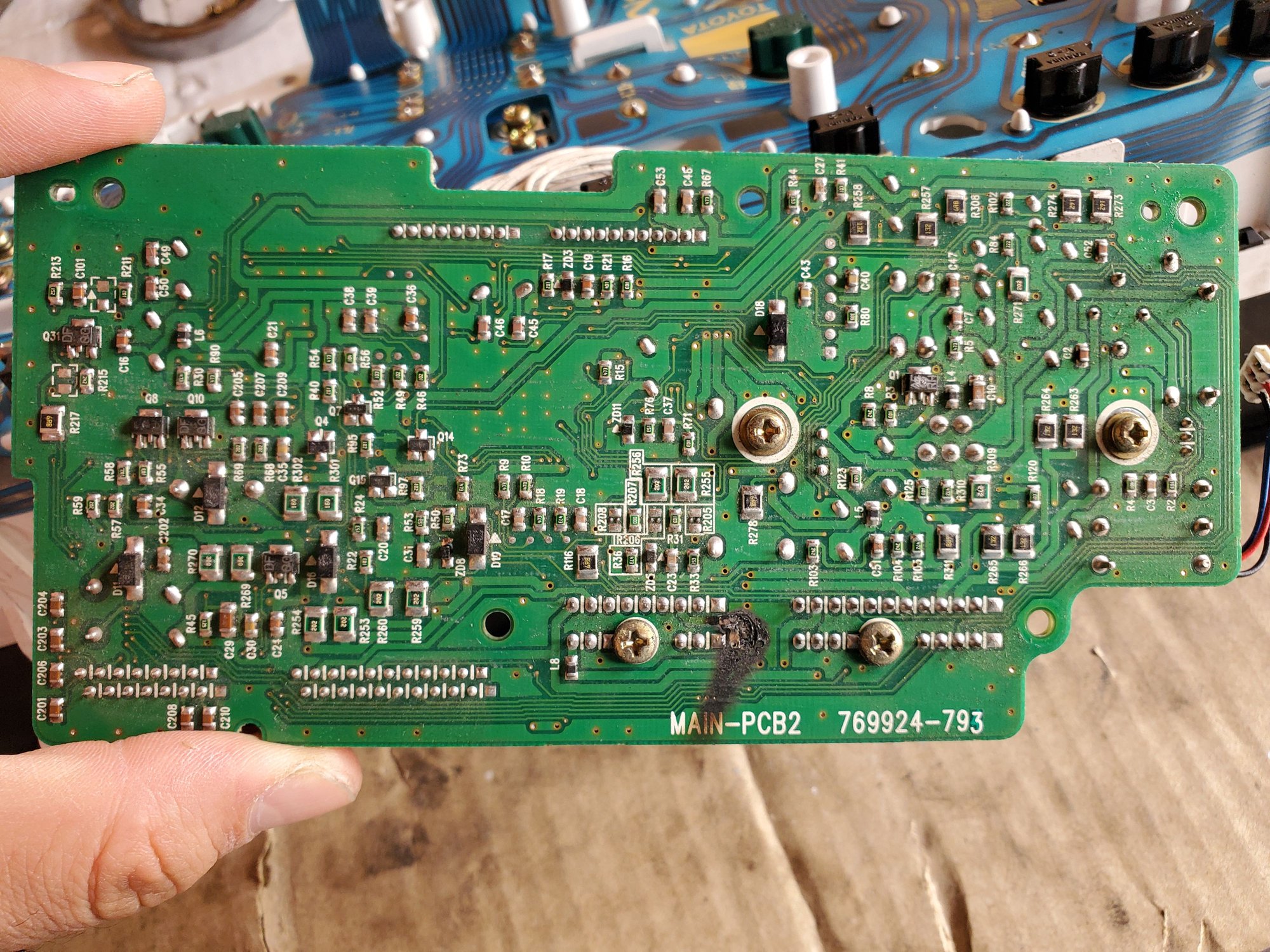

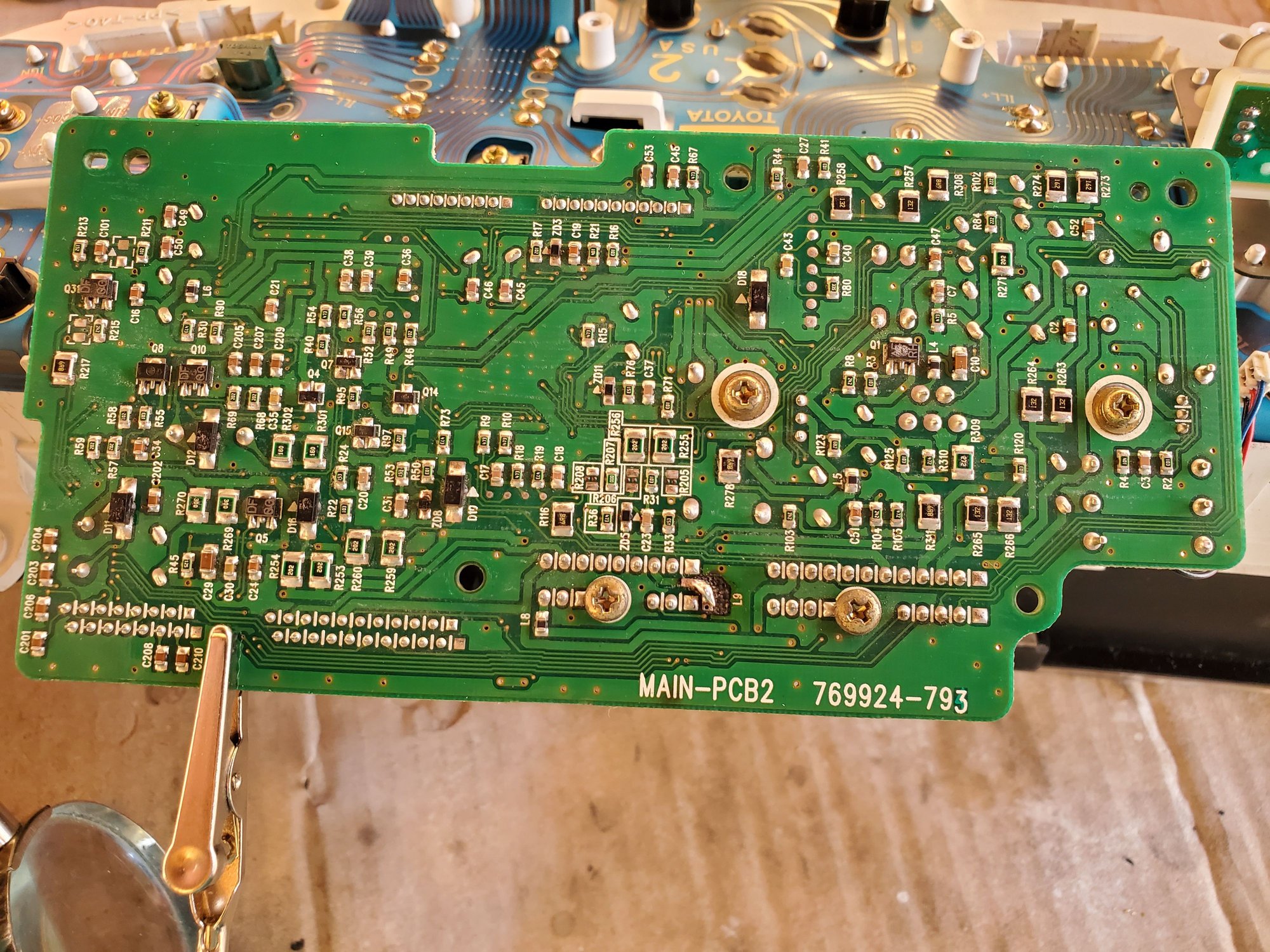

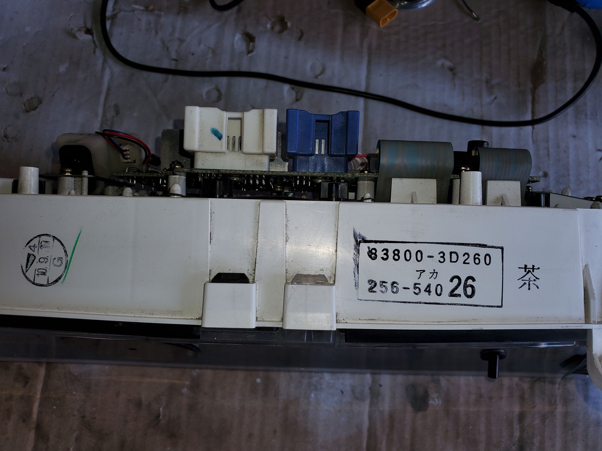

Check Cluster Board!
I know its an old thread but I just fixed this problem today after many days of troubleshooting. I had a slightly different issue (Gas gauge dial shoots to full upon turning key to "ON" then falls below empty). The problem appears to have been a burned out terminal on the cluster. It was next to L9. Cleaned it with alcohol, resoldered it, and gauge finally works. I also cleaned the fuel gauge receiver terminals and cleaned the dust off the boards. Just cleaned as much as I could. I did try checking the wiring between fuel sending unit connector and cluster, bought a new fuel sending unit, even resoldered and cleaned old unit. Turns out old unit was fine! Maybe was a combo of all of that. Maybe not. But I am glad I can post still being a new member, unlike Toyota 4runner forums..hope this can help some1 who may need it!
Check Terminal L9
Check Terminal L9
Terminal L9, be sure not to accidentally touch another any other point
Its on the other side
For a 2wd 99 4runner
