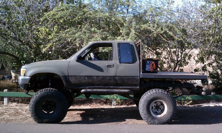

92 pickup excab on single cab frame custom flatbed SAS 5inch lift 35x12.5 locked blah blah blah..
