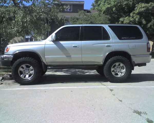

Just Lift the thing, a little bigger tire say 32 over 31 only raises you up 1/2 inch. but if you re going for look and not to wheel the crap out of it then just get a cheap puck lift like revtek, fit some 285's it will look sweet and you can use it off road, i did for about a year no problems.
Old Nov 6, 2007 | 08:56 AM
ninjarunner's Avatar
Joined: Oct 2007
Posts: 176
From: Rexburg, ID
U pick which one you would rather drive
Attached Thumbnails 32inch BFGs?-3-lift-small-file.jpg   32inch BFGs?-6in-lift-small-file.jpg

Ya, that's a tough choice, but if you have the 16" wheels, that's much better. More choices. That's what I did, I sold all my wheels to go to a 16". I haven't bought the tires yet, but I'm looking at a 265/75, 255/85, or 285/75. 11.5" wide seems just a bit much for a 1st gen, but maybe for a newer truck it's a better fit.
Old Nov 6, 2007 | 08:59 AM
Djlarroc's Avatar
Joined: Jun 2007
Posts: 1,299
From: Denver, CO
What are the respective tire sizes?
