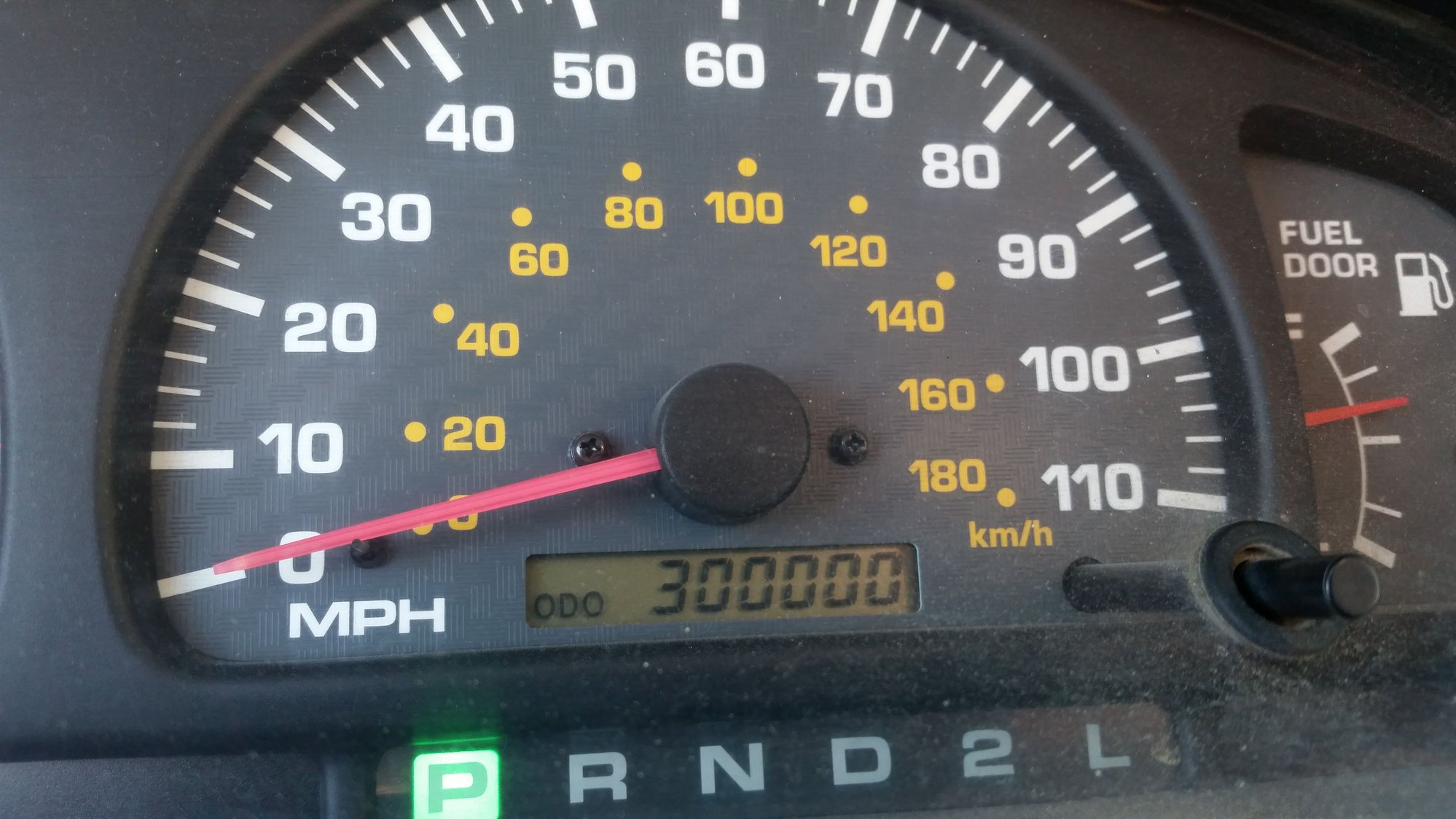

Hey everyone,
Well....i did it. I just logged 300,000 miles on my 99 4runner v6 4wd with the original waterpump ,timing belt and idler pulley. Along with those parts, the rack n pinion and transmission are original and i've never dropped the trans. pan. I exchange the fluid. The coil packs and injectors are original. This rig has spent lots of time on the trail and is no trailer queen. I actually think the climate in Arizona has a bunch to do with the longevity of the parts.
A true testament to whats possible with these 3rd generation gems!
