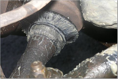

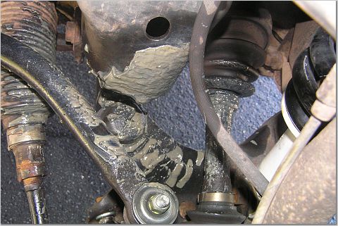

You mean ripped like this? 3" revtek lift - cv boot problem-47b7d833b3127cce857be3b55f1a00000026102aztndhk1asz-1-.jpg3" revtek lift - cv boot problem-47b7d833b3127cce857be29a9e9d00000026102aztndhk1asz-1-.jpg
Don't know anything about the Porsche boots but my lift included the the 1" diff drop. First set of CV boots ripped 2 months after the lift was installed. I figured new ones would fair better since the first set were the originals (160k+ miles). Second set ripped 3 months after that. I have since removed the Revtek spacers.
