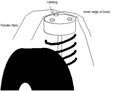

One of the 3 bolts on the top of the shock tower is rubbing against the lip of metal of my wheel well (driver side). I think the extra length is what's responsible for the rubbing. The duct tape is definitely just hiding the problem - for now it just keeps the metal from rattling/screeching against metal.

Okay here's a quick MSPaint drawing...
The arrow shows where the body is rubbing against the shock tower - it's a cringing screeching and rattling sound I get with the most miniscule bumps on the road :pat:
Like I said, I'll probably use a dremel and just cut around that portion.

Weeeelllll, is the cup upside down on both sides or just the DS? I'm not sure if the rubbing at the top would be due to the cup being upside down, or just the 3" spacer. I just ran out to look at mine and see if I could visualize this, and I'm still having problems. I'd think that with the cup upside down, the spring would be fitting over the cup, which I would consider a big safety issue. And if this was only on one side, I'd think you would also be off kilter left to right.
I'd get that flipped around asap, and if its still rubbing, call Roger for a body lift.

Actually, I'm not focused on the cup now. It did give me the extra lift I was missing... the image is just the top portion
What I'm focused on is the top of the mount now. You can't really see if it you take a look at yours because that wheel well flap (can't think of the right word) is in the way. If you were to remove that you'd see the lip of the body. An RB lift would definitely fix that but with the CF lift my 32" muds already look small

Hmmmm... on both sides I'm much closer. Could be the fact that I maxxed out at 3"
I take it by fender you mean the inner part facing the engine and not the outer part facing the flares... if you were to remove the flaps that protect the engine from road debris - you know the same one you're supposed to remove to reach the air filter, that's when the lip of the body is visible.

Okay here we go:
Attached Thumbnails 3" Cornfed lift - has this ever happened to anyone?-untitled.jpg

Well in any case, it would not be my first guess to think that the upside down cup was the cause of one of the upper shock bolts rubbing the body. I went outside again to take a look, and I can see the edge you're referring to. Maybe because when Steve and I did my OME's, he melted enough of the fender liner away with a drag light for me to see it. I would think the 3" spacer is what's behind it.
I would think that a 3" spacer could change the geometry of the upper arm enough to get it nice and close to the body. Again, we need Steve to bust out his book learnin' on spacers and springs.
