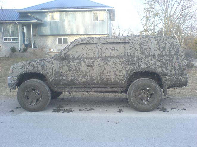

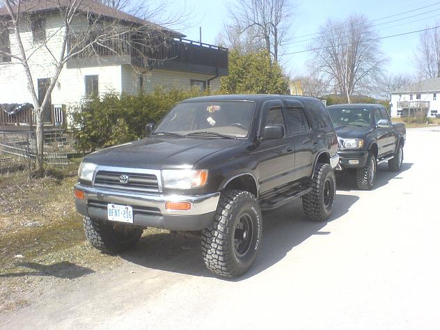

tundra coils, land cruiser coils,4 bilstien shocks(2 adjustable), ebrake cable bracket, diff drop, rear sway bar bracket, rear extended brake line,bigger bump stops and an adjustable trac bar.
Heres how it looks with 265/75/16s
Okay, I guess I misunderstood you - you already have the 1.2 installed, just not the body lift right?
I was going to say you'd probably be already with 35's if you just did some smart trimming with no body lift but now that I see that, there's no way.

well the tires are on, its not as terrible as everyone is saying, but im defintly going to regear still
Badass my friend!!
Are you not rubbing like crazy in the front though?
Fink
