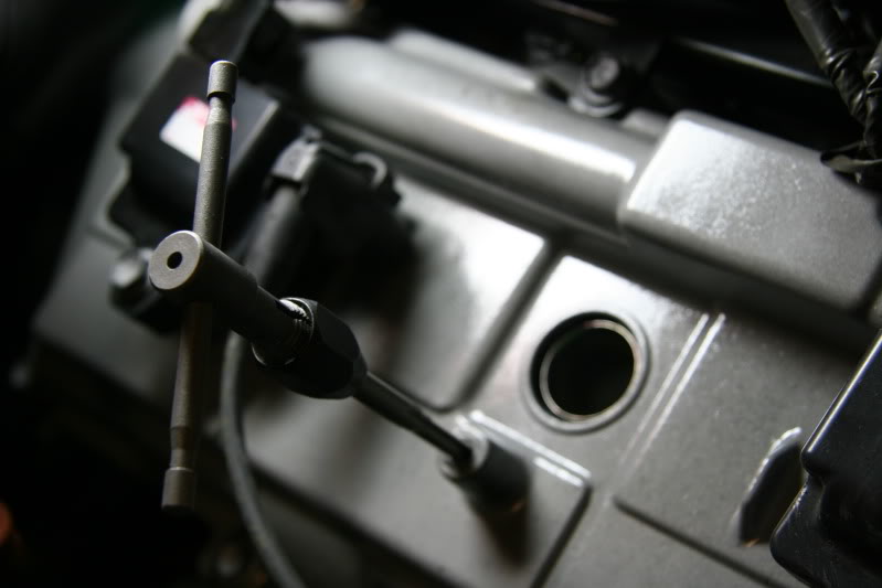

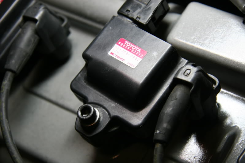

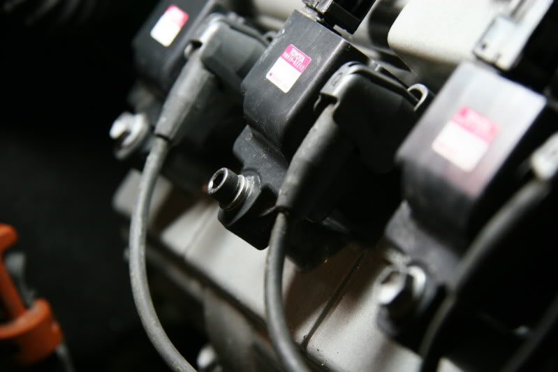

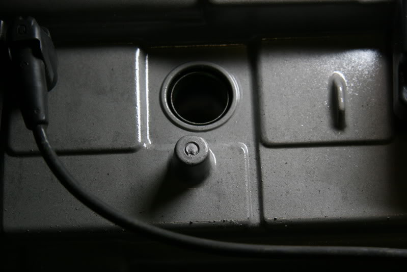

Well, the passenger side is done. But not without a snag or two....
I removed everything, bead blasted the aging valve cover, thoroughly cleaned it and clear coated it with Duplicolor high temp.
First snag: I tried to remove the PCV grommet from the valve cover - it fell apart. Luckily I had a friend running errands so he was able to pick up another from the dealer.
Then I put everything back together (FIPG in the corners, etc.) and hit another snag. The bolt holding the middle coil pack to the valve cover sheared off as I snugged it down. Even though I've completed numerous spark plug changes on this engine over the years....
So I carefully drilled the offending bolt and was able to extract it with an easy-out. Figured out the thread size & pitch (6mm, 1.00) and chased the threads in the valve cover with a tap.
So now it's all back together and running fine. Time will tell if the leak stops. I'll save the driver's side for when I have a wide-open weekend....
Oh, and thanks to my friend Robb (avalonracing) for all of your help today.

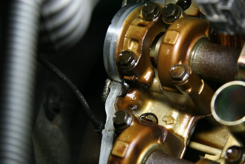

FYI
dont forget the (cam cover plugs) in the back held down by this cam journal in your picture.

Driver's side valve cover off, no serious sludge to speak of for 150k.
Rear cam journal, cam plug in the center of it. The factory VGC is still in place.
journal removed, cam plug cleaned up and coated in grey RTV, ready to reinstall journal.
The driver's side was more involved, I took my time, which resulted in probably 3-4 hours. I also replaced the intake plenum/manifold gaskets (2) for good measure. There was some oil residue in the intake manifold tubes, so not sure if that's a result of wearing rings or a plugged PCV system (all tubes appeared clear.) Just have to keep an eye on it.
