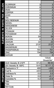

the report came back clear so maybe I'm losing my mind

"there's no significant fuel or coolant present, and the air and oil filters are fine (see silicon/insolubles)."
