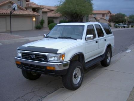

Pic is the same as the avatar but hey it's new to me. better late than never

Off with the running boards, on with the lift!
Nice lookin rig you got there

From: phoenix
Thanks! Yeah, the running boards will be gone soon. I was talking about that with a few of the AZ guys last weekend at an impromtu meet. Check out the pics from the Crown King run, My dad drove my 95 down the trail with the running boards on. the only damage was a bent idler arm. I was driving an exploder and scraped bottom all the way. I got to give the old man credit, he can pick a line!
