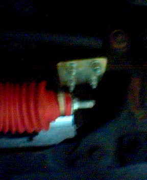

i recently had a skyjacker steering stabilizer installed and, to my surprise, it needed brackets to mount. i thought it would pop in where the original mounted.
is this a bad thing? they didn't remove the original, either. makes me wonder.
if anyone has any experience/expertise/opinions i'd love to hear 'em.
thanks!

these pics show how it mounts now. on the "driveside.jpg" one, you can see the oem stabilizer mounting bolt just above...
sorry for the bad pics; took them with my phone.
Attached Thumbnails 2nd. gen. steering stabilizer: do i need new brackets?-passside.jpg   2nd. gen. steering stabilizer: do i need new brackets?-driveside.jpg

sandcrawler
If it doesn't interfere with anything then it should be fine.
I had a Rancho like that for awhile
