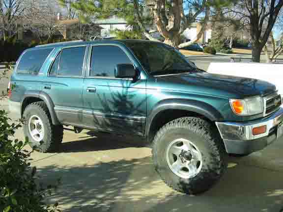

Don't fit, but we already knew that. Rotated tires on both trucks yesterday, for fun I mounted up the Cruiser's tires to the runner. Now I know why you guys vulture those FZJ80 rims, they really do look nice on a Runner! I tried to take it for a spin, but couldn't even turn out of the driveway.. ah well. Was good for a picture though!

those do fill up the fenders nicely though

sucks you cant drive it. lookin good though

Dang, those look big on that Runner. I am starting to think they look small on mine.

what would you need to do to make those 295s work? (lift, shaved arms, wheel spacer etc...)

Lift, mainly. Couldn't turn the wheels more than 15° in either direction. Front would hit the bumper, back would hit the inside of the fender. Made me question 285's even fitting at stock height.
It's funny how your perception of tires changes, when you first get them it's like "dang these are huge!" then after a while they start to look small..
