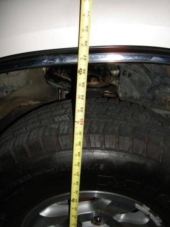

While I can't vouch for the 255's, I can say that I have no rubbing issues with the 285's. I run them on the stock rims and it is close, but there is no control arm rubbage. I do not have a pick at full stuff or droop but I do have a pic of clearance while not flexed. I like your idea of having two sets of tires. I run my mud terrains every day and I count the miles I'm putting on them. I wish I didn't have to use them for daily driving.

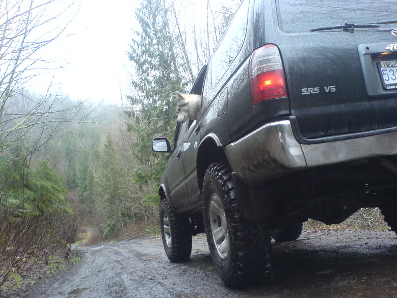

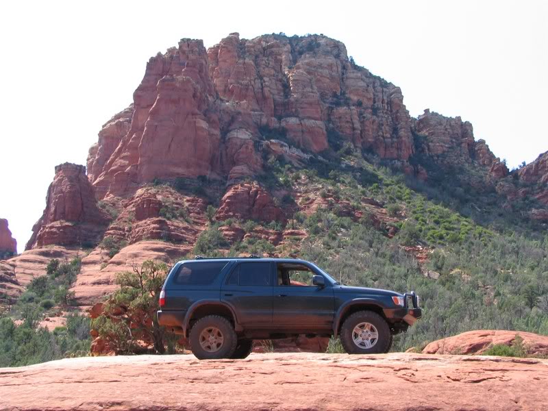

I love my 255's. I like the look of a tall skinny tire (not that they look TOO skinny, but just not overly wide). As for wheel size, 7" (stock) is perfect for 255's, but 8" would work just as well. There is some flexibility in wheel size. Have you read the article on the 255/85 tire size on the Expeditions West page? Another + for the 255 size is that it's a load range D tire, meaning a stonger, tougher tire. This also means a little less give when aired down, and the possibility of a harsher ride on-road (I didn't notice this- they are smoother than my old tires)
Here's a couple of pics, both on level ground. Oh, and this is with only a 2" BL, no suspension lift.
Driveway shot.
Trail shot.

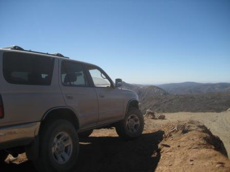

Pics of Old Man Emu w/ 265/75
Attached Thumbnails 285/75R16 or 255/85R16 BFG Mts for 3rd Gen 4Runner-2006_11_17-baja-1000.jpg   285/75R16 or 255/85R16 BFG Mts for 3rd Gen 4Runner-dsc01408.jpg

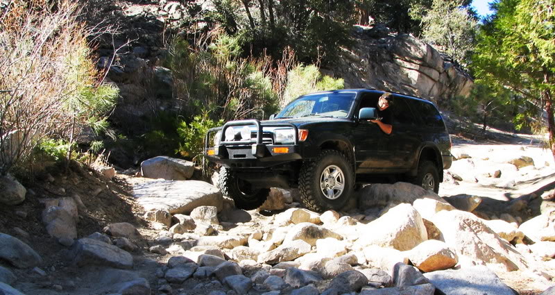

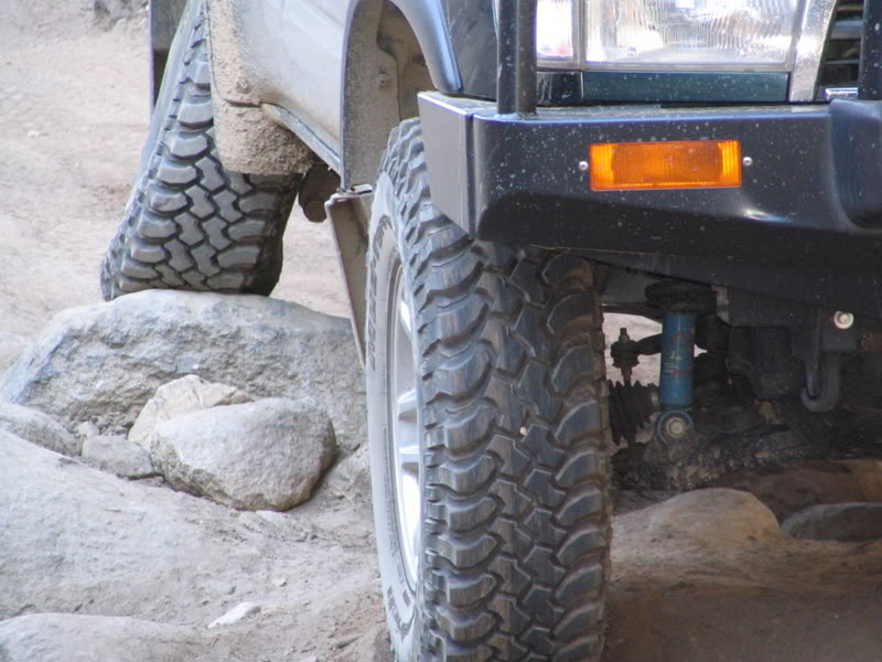

I have 255/85s. Probably the best all around tire size for a 4Runner. I don't understand why people have an issue with its "skinny-ness"; if you're that obsessed over tire aesthetics, then you might as well have an F150 with a cheap Fabtech lift covered in SRH stickers. I don't see the need for 285s on such a lightweight vehicle.
Anyway, I've used them in DEEP sand, mud, large/sharp rocks and have never had an issue with traction. The fronts do rub the rear of the wheel well occasionally, but I might be able to remedy that with some strut spacers.
