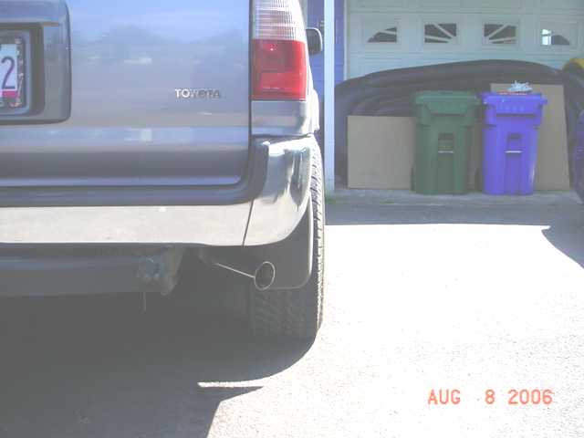

heres a few pics of the tip i have its set back pretty far as i like it not to stick out i think it looks good where it is .... i paid 70 bucks to have every thing installed

Yea Elton we are basically gonna have identical exhaust
