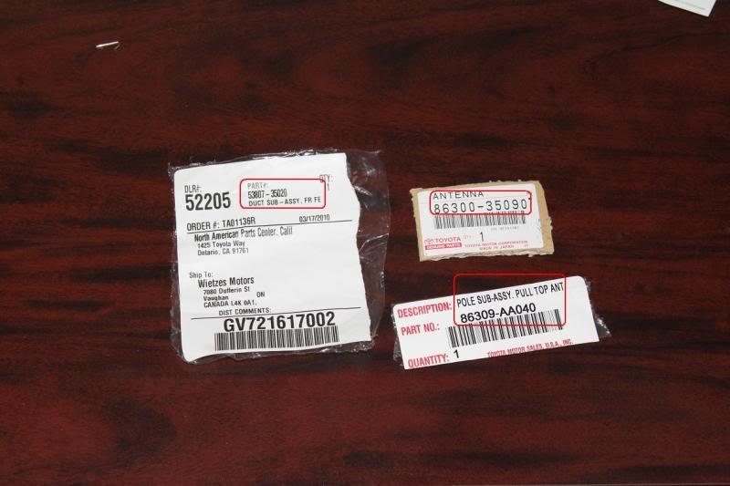

You may consider a few Toyota parts required for this install:
- 53807-35020 Tacoma Intake Tube "DUCT SUB-ASSY, FR FE" (Note - 4Runner intake tube will not work)
- 86300-35090 4Runner non-Motorized Antenna "ANTENNA" (Note - Limited 4Runner Motorized Antenna may not work. I didn't try it, as my was broken, but as envelope is very tight I'd assume it not going to work or it will be very challenge to make it work)
- 86309-AA040 Tacoma Antenna Wip "POLE SUB-ASSY, PULL TOP ANT" (Note - 4Runner non-Motorized Antenna has stainless steel whip, but as many mentioned before and dealership agrees, it's very low performance. Highly recommended to upgrade to Tacoma Wip)
Installation Time: It took me ~3 hour to install the snorkel. About 20 minutes to swap antenna and ~40 minutes to route a new cable to the radio. This brings the total install time to ~4hr.

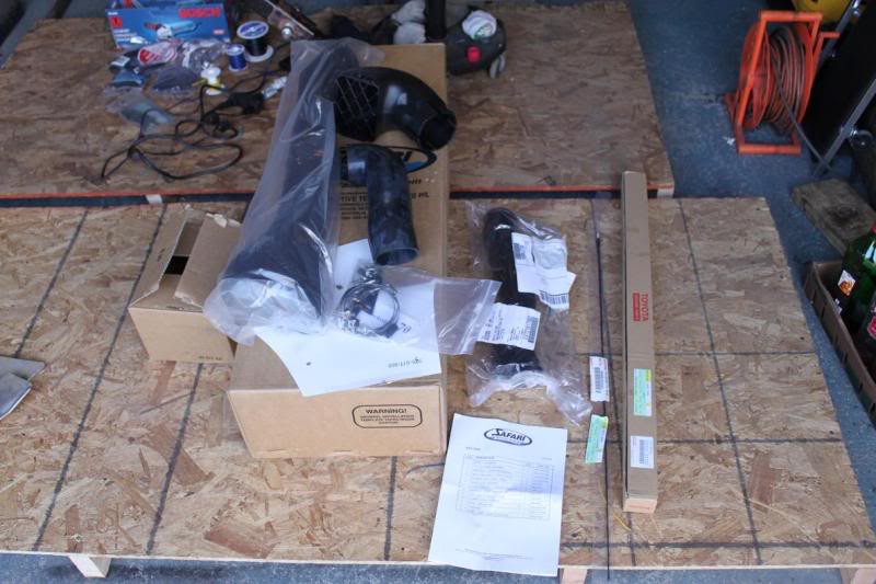

First of all align all parts on the flow and make sure you have everything:

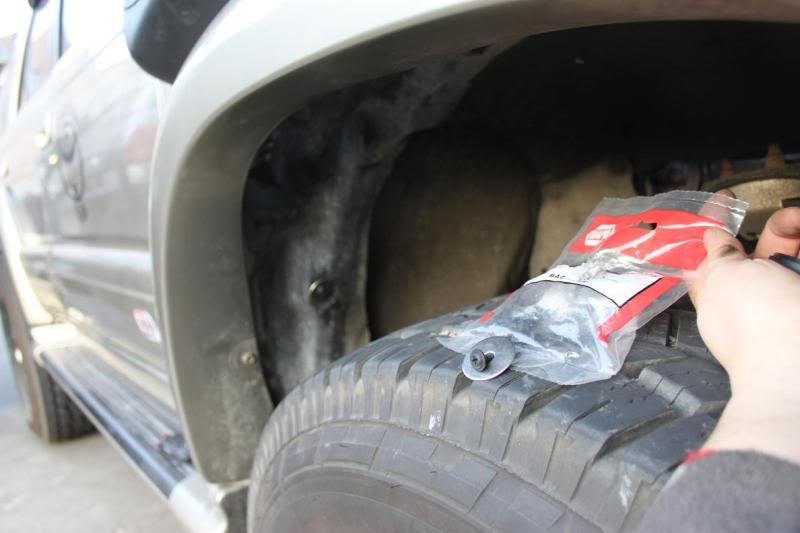

Open the hood as it will help you with locating a few clips holding the inner fender. You do not need to remove the air box as it stated in ARB instructions. Those instructions are for Tacoma. On 4Runner you are skipping this step.
Remove the inner fender. You can either remove it completely or partially. To do so you'd need to take square plastic clips off from the fender. Some of them have an easy access from the engine compartment. Be aware that front end has 3 clips (one hidden from the view), I spend 2-3 minutes trying to get my head down there to find it. It's facing inside of the vehicle and located right between the 1st and second clip visible from wheel well. To remove the clips from under the Limited flares you need to unscrew several bolts from the flares. Those are 10mm socket screws. You do not have to remove the Limited flares. Continue and remove all clips from inner fender. If you did remove all, then take it off. In my case I left the last rear one on and just drop the inner fender to the wheel.
Some of you may find that removing the wheel will help with access. In my particular case with 3" lift its not necessary as you have enough room.

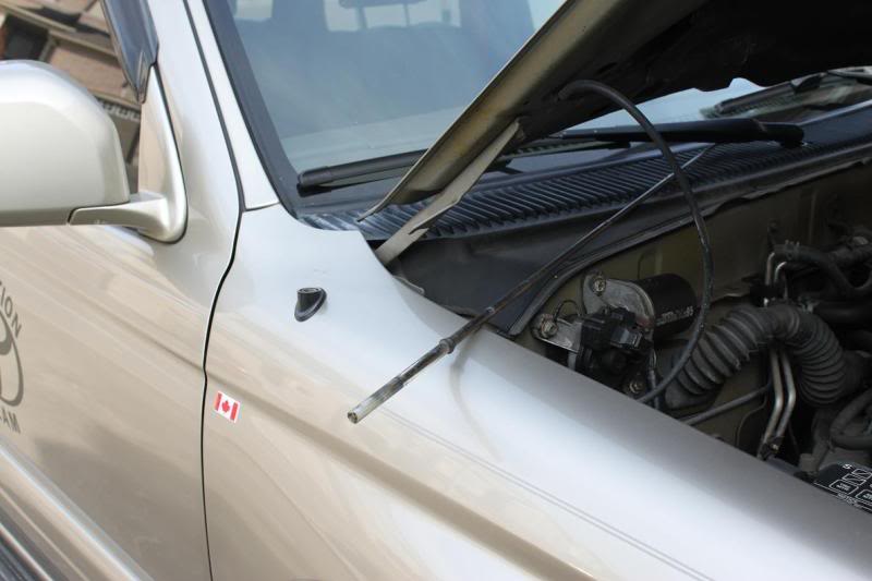

Next thing would be removing the mast from your motorized antenna. If you have non-motorized antenna, procedures are similar, but much easier. You still need to remove the antenna for future access to the snorkel bolts and safety while drilling the fender. In case of motorized antenna, have a second person with you. Unscrew the top nut holding antenna base. Have your help person switch the radio. While motor is running pull the mast completely off the assembly.

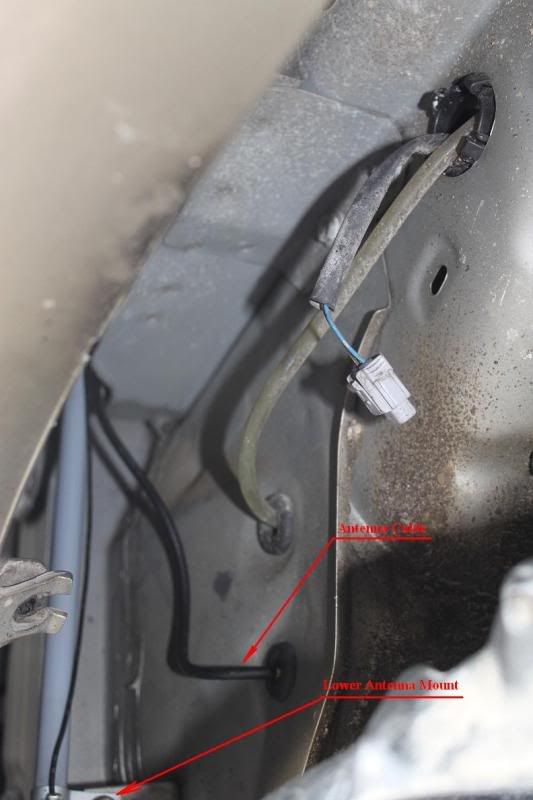

Look inside the fender and locate your antenna unit. Spray some penetrating oil on the bolt and using 10mm socket unscrew the lower mount (just 1 bolt holding the antenna). As you already unscrew the top base mount, your antenna should slide off really easy. Pull it out. Locate the grommet where antenna cable going into the cabin. Pull it out with some antenna cable. Don't pull too hard as not much of a free loop antenna cable has on other side. When you pulled the grommet out, just cut the cable with cutters. Now remove the the antenna off the vehicle.

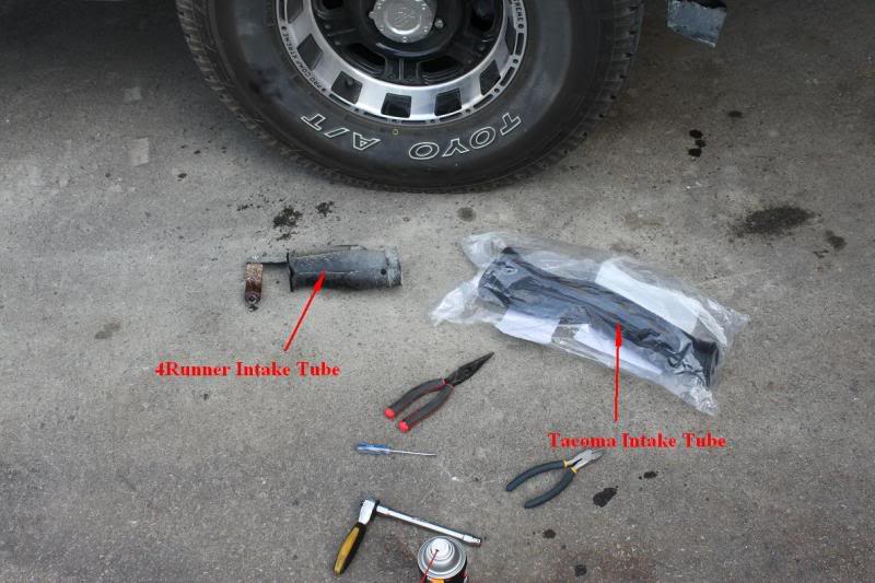

Look under the fender and locate the stock 4Runner Intake tube. It holds by single bolt. Spray some penetration and remove the bolt using 10mm socket. Ba careful as brackets are very gentle and if you have corroded bolt you may break the bracket off. You'd need this bracket for the new tube. Remove the 4Runner tube off the vehicle. On the image bellow you can see the comparison of 4Runner and Tacoma tube. You'd need to install Tacoma Tube instead of 4Runner for the snorkel connection. Your 4Runner tube will not work.

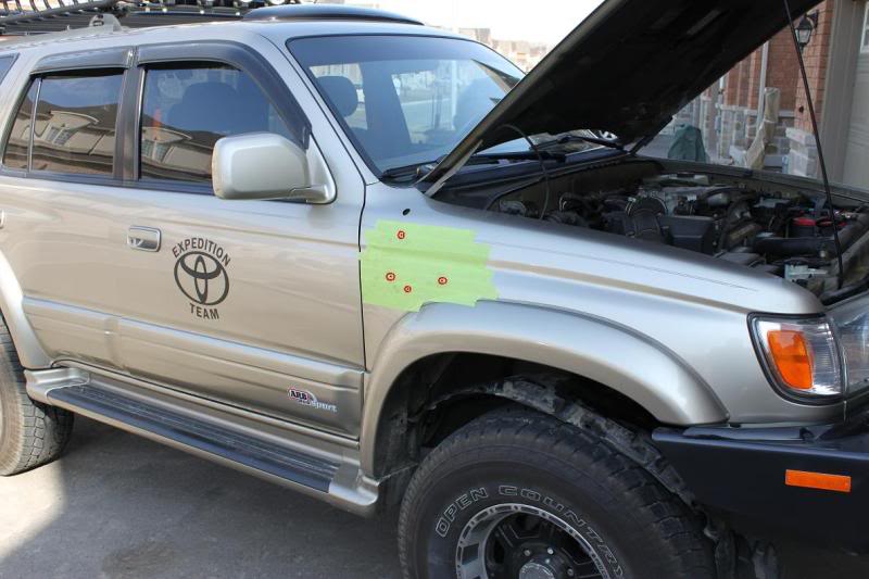

Most important stage as you'll be drilling your fender. If you do it wrong and your snorkel will not align in worse case scenario you'd need a new fender. At this stage use the phrase: "7 times measure and 1 time cut".
Locate the template form the package. It was initially taped to the side of the box (inside). If you carefully opened the box without a knife you should have it intact.
Having your antenna removed giving you a start point. Disregard ARB instructions as it designed for Tacoma. You need to alight the template to your antenna opening hole leaving ~1/4" gap between template and the hole.
Before attaching the template use painters masking tape to cover the fender under the template. You can use masking tape as well to help you hold the template in place when you align it as was shown bellow.
PAY ATTENTION that edges of the template do not align with your fender and flares. Remember template is made for Tacoma. You mast have edge of the template parallel to the fender, but not match exactly.
On the template you'll see 3 mounting holes and intake tube hole. Make sure you pointed which is which one.

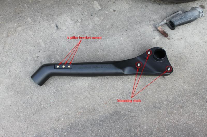

Locate the hardware bag in the Snorkel package. Remove 3 studs from the bag and thread them into the snorkel body. Use Blue Lock-Tite to secure them in place.
Take the upper tube bracket from the hardware bag and install it on the Snorkel body using supplied hardware. Do not tight them down.

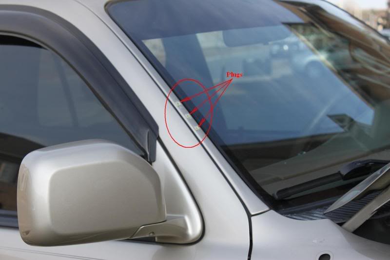

Locate 3 plastic inserts in the hardware bag and using silicone (for sealing purposes - highly recommended) push them into the A-pillar holes. Do not use much of the force as you can either make a dent or push the insert through.
Remove the A-pillar bracket from the snorkel body and install it using supplied hardware on the A-pillar.

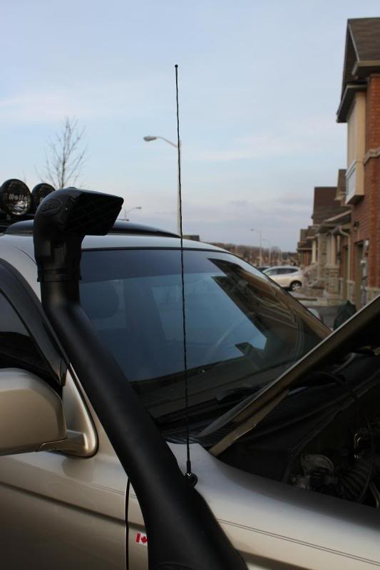

Locate the scoop and matching black clamp in the Snorkel hardware bag.
Position the scoop in the way that you have ~1/4" gap between the end of the A-pillar Snorkel tube and end of the slide cut of the scoop. Turn the scoop, so it faces front of the vehicle parallel to the driving lane. Tighten the clamp.
[Detail picture to follow]
Take Tacoma Wip from its package and screw it to the antenna mount. Slightly tighten it with a wrench. Do not use pliers as you'll destroy the coating and it may rust on scratches.

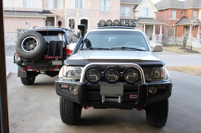

At the end of the project here are a few images of the Snorkel installed on 2001 4Runner:
