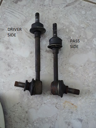

same problem here (98 4r limited)new shocks and springs in all corners and now is leaning to the right (pass side) the difference in front and rear is 1 inch,if i lift the front pass side i can achieve the same measurement in al corners,so this mean the problem is in the front pass side,maybe??? double checked everything before and after installation and its ok the only parts im in doubts are the sway bar links ,do those links make any difference in height if one it tighter than another?

well finally i found the reason why my 98 4runner was leaning to the pass side (exactly 1 inch).the reason was that the PO installed a rear swaybar link in the front pass side,so that 1 inch less in the pass side was compressing the lower a arm 1 inch,the front links are nearly 7 inches from top to middle joint,rear ones are 6 inches,well anyway problem solved if anyone tell you that swaybar links doesnt affect the height show him this post and tell him he is WRONG.
Attached Thumbnails 2000 4Runner, significant lean after installing shocks and springs!-links.jpg
