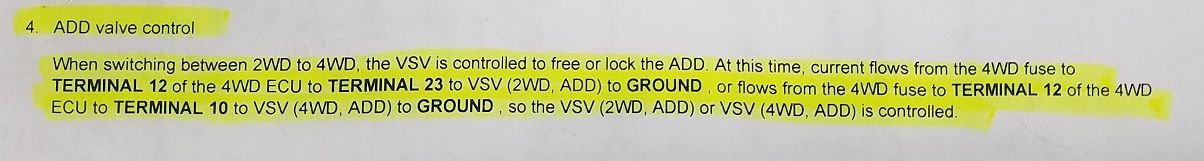

From the diagram I attached below the 4WD position sensor/switch is located on the rear of the TC. There are two of them. It's the on towards the front of the car.
- Continuity checked on the 4WD position sensor: NO Continuity, which means state = 2WD correct?
I removed the 4wd fuse and applied direct vacuum to the 4WD (Blue) Add actuator.
- Placed the TC lever into H4 Lock position.
- Replaced the 4WD fuse
- Lights still blinking.
- I tried the same with just the button pushed for 4HI Unlocked. Lights still blinking.
- Power/Signal never shifted the VSV 4WD side. Only Constant power to the 2WD side.
I also ran some tests on my 4WD ECU. When I engaged the TC lever into H4 or use the 4WD push button 4HI unlocked I should have voltage on wire/terminal # 10.
The ECU is not sending a signal to terminal 10, which is what sends the power to my VSV 4WD solenoid.
Could I have a bad ECU?
