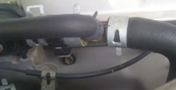

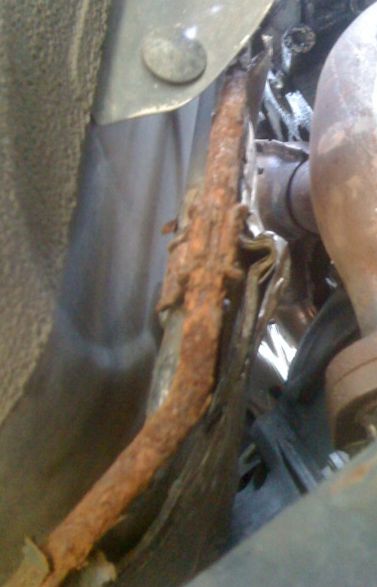

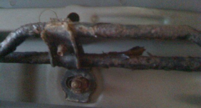

I replaced the timing belt and water pump etc at 100k and was planning on including these as well. I am attaching some pics that started this thread after discovering the rust on these lines. There is corrosion and what looks like rust on a coolant line T connector of some sort in the first picture and then rust on the lines in the other pictures. Thats when I was trying to price that rear sub assembly and replace that with radiator etc etc. I have no experience whatsoever with anything coolant related so I'm hoping to just gather my parts and figure out who to install. I'm afraid these rusty lines are going to break if I delay.

OK here is the list as it stands now and I'll have to update with the factory part numbers when I locate the rest.
Timing belt (dealer)
water pump (dealer)
idler pulleys (dealer)
cam crank seals (dealer)
thermostat (dealer)
fan clutch (dealer)
radiator (KOYO 1998A go-part.com)
upper/lower hoses (dealer)
rear heater line (dealer 87248-35061)
trans cooler (B&M 70264 http://www.summitracing.com/parts/BMM-70264/)
OEM or Zerex coolanthttp
