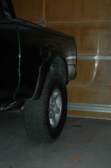

I installed the Camburgs last week, along with Deaver leaf packs.
Still waiting on the Bilstein 5100s for the rear, right now running the stock TRD Bilsteins..
HINT, HINT: come on Wheelers, send me the darn Bilsteins!

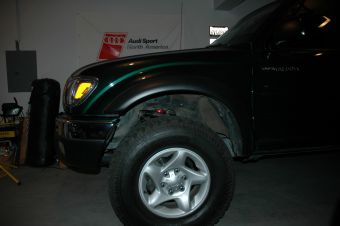

Pic 2
pic 2

I have been wanting a 2" lift for a while, what can you tell me about this?? Where you bought it, price, ect.
Thanks
Old 12-06-2004, 07:34 PM
P. Bauer's Avatar
Join Date: Oct 2003
Posts: 108
Received 0 Likes on 0 Posts
Bought everything from Wheelers.com
Camburg 2.5 Coilvers
Deaver 5-leaf Leaf Packs
Bilstein 5100 Rear Shocks. (back-ordered until 2020 apparantly)
Install was pretty straight-forward.
The truck drives like a dream. Not too stiff, but so much better than stock. Feels like it's more solid too, not so wishy-washy on the freeway or over small undulations in the road.
