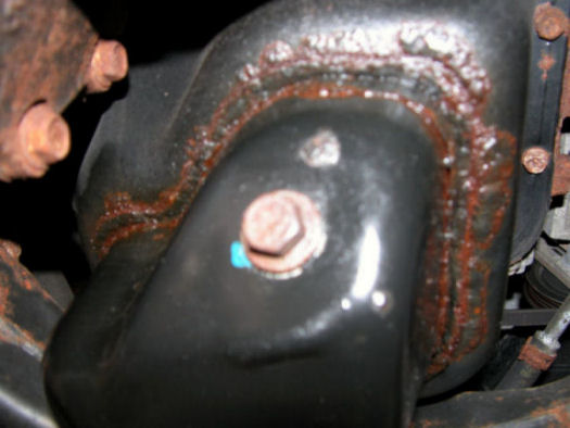

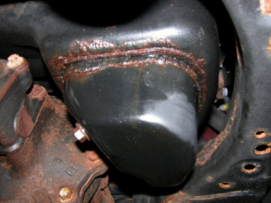

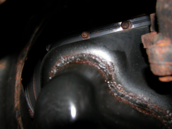

2.7 owners check your oilpans for rust
Welded on extended sump (factory) has rusted through at the weld and is leaking oil. More fun and games I guess.
Attached Thumbnails 2.7 owners check your oilpans for rust-rusted-out-oil-pan-001.jpg   2.7 owners check your oilpans for rust-rusted-out-oil-pan-003.jpg   2.7 owners check your oilpans for rust-rusted-out-oil-pan-002.jpg

Yea that road salt is brutal... Just seems like a strange place
for rust perforation.
