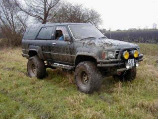

Old Aug 3, 2003 | 08:33 AM
fenman666's Avatar
Joined: Feb 2003
Posts: 11
From: norfolk u.k
35x12.50x15 bfg tyres... 3" bodylift
Attached Thumbnails 1st gen //rear window does not work please help-p2090005.jpg
