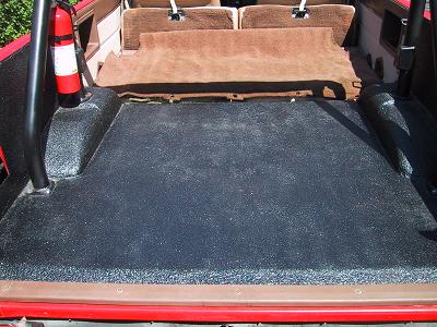

I had the rear plastic panels in my 4Runner crack a few years ago. At this time i was still fighting off the rust and the rear bed area was beginning to develop a few holes, so I got a LARGE piece of sheet metal and bent and cut it to drop right into the back bed area. I also cut some holes in the sides to retain the storage areas in the rear quarter panel. The sheetmetal is riveted into the side supports and it is all covered with Herculiner roll-on bedliner. So far i have had no problems and the entire setup is very solid.

RAD that looks super clean. Good Job.

Im not sure of the exact weight, but I remember that it was pretty heavy dropping it in. I have had no problems with this custom install, and the steel is thick enough that if you manage to dent it, youre a hero. I definately recommend the Herculiner. By applying it yourself you can make it as thick as you want. After covering the bed, I covered the outside of the truck below the body line all the way around. Locking diamond plate covers for the side panels make a nice custom touch too.
