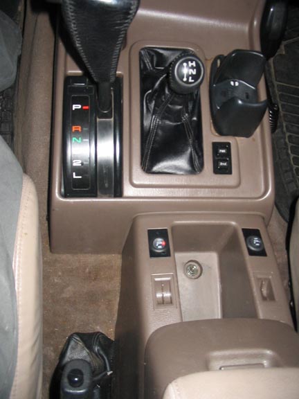

Alright, well I got my two sets, and installed them in the Land Cruiser this weekend. No surprises, taking the seats apart was a bit of a chore but everthing all went together fine and the heaters work well. Hey Cracker.. in the last page of the instructions they mention a referral program

Here's a pic of how the switches turned out.. I drilled holes in some blanks and installed them in the center console, when I do this to the runner it will look very similar..
