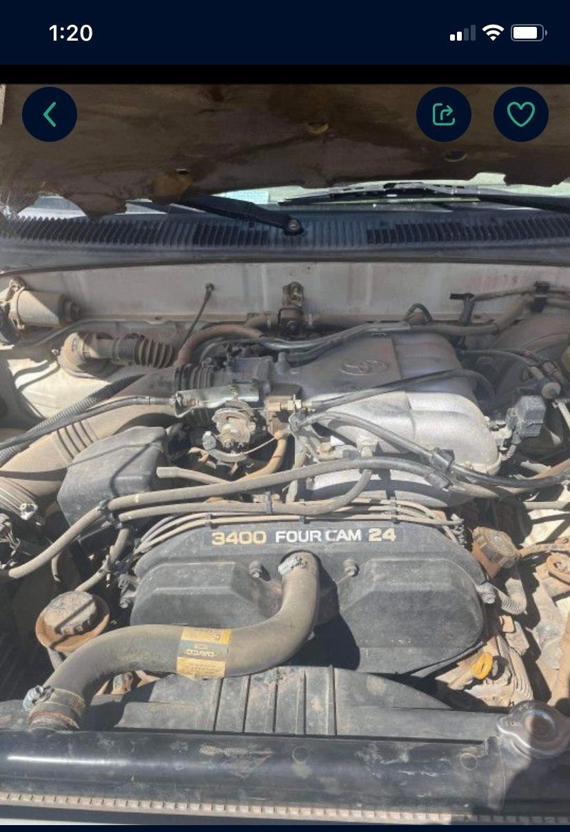

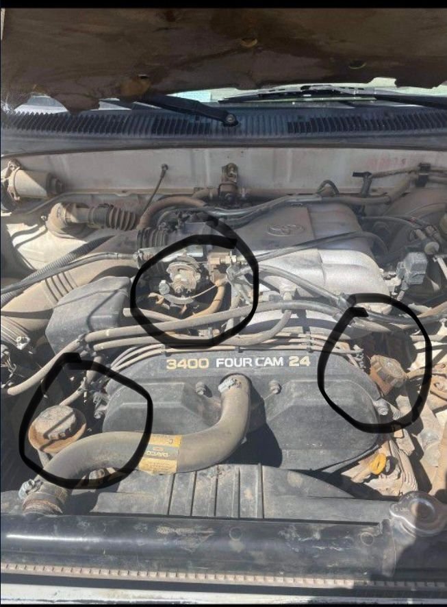

Hi! Next week I am going to test drive a 97 Tacoma. It has been in the desert it’s whole life with 4 different owners. This will be my first Toyota 4x4 truck. Currently own a camry. I’ve read that these trucks have a problem with rust so I will make sure to look for that. I have attached a picture of the engine. To me it looks like there might be some leaks near the caps or possibly a valve cover leak.

None of those areas circled are really too much of a concern.
the frame rust/rot issue will be in the rear of the truck. Starting at the front corner of the bed on the drivers side on the inward facing side of the frame box, near the fuel tank, and up the jump over the rear axle.
