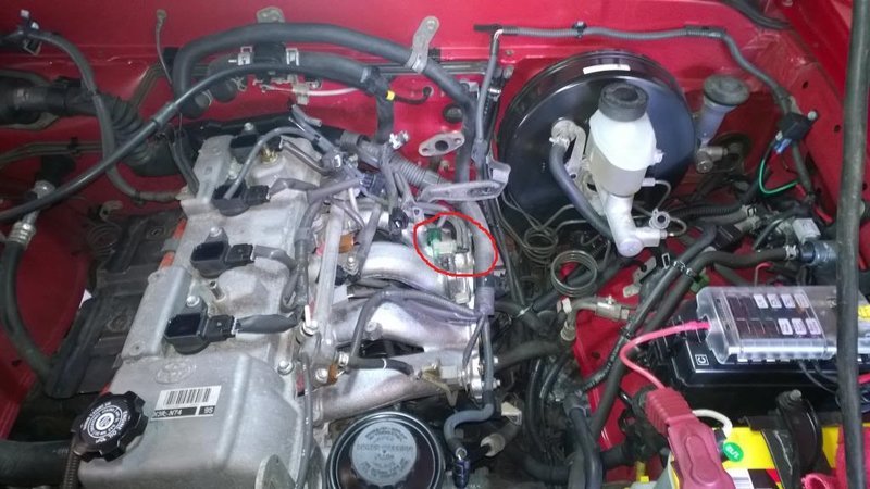

I looked up the Jdm versions and you're right they in fact do not have egr systems fitted. I never knew that.
Not sure if yours will have the VSV, if its not equipped with the egr valve. However, the attached picture shows the one that uses those capped vacuum lines. There are three total, two on the charcoal canister, the third in between the plenum and intake runners.
The ECT sensor is located right behind the cylinder head and firewall closer to the exhaust side. If it isn't reading operating temp or is out of spec the ecu will force the engine to run bad (rich i believe, not sure though).
