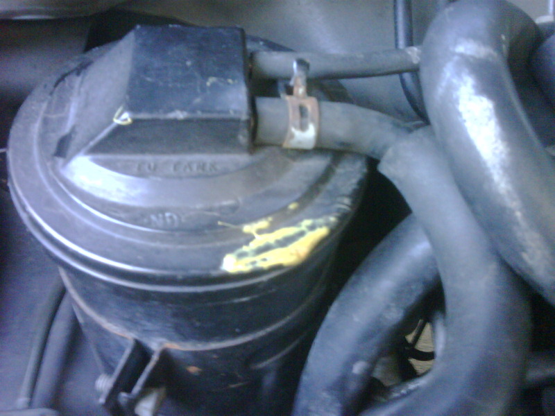

Anyone got a picture of a 1995 Toyota tacoma 3.4l Evap canister. In the middle of my engine swap and with my engine harness being a 95 my Evap canister is different than what I am familiar with. I have one for my 2001 engine but it's wrong. I can't seem to get a picture from Toyota or online of what my Evap can is supposed to look like but I gotta go trade mine in for the right one. Damn guys at the salvage yard keep pulling one up from a later year. Thanks.

Thank u for the reply. That ones on Toyota site, but says it's not an idzact picture of what the can looks like. :-/. I think it more looks like a 88-95 3.0 charcoal canister but could b wrong. Got the part number from this site, but the charcoal canisters don't have p/n's on em so don't help much at salvage yards. if I can't get a pic within a week I'll probably just buy one new.

Probably of no help but here is a picture of mine,1994 3vze
