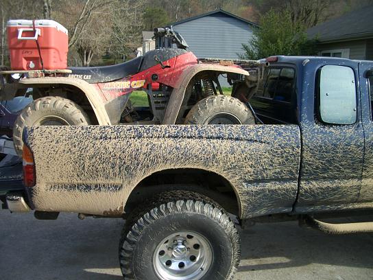

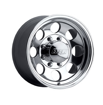

i have a set of 10's,but the more i look at the 8's i like them what u guys think?probly without the centers. my bad a 33-12.50

They look nice, wich one depends on how wide your tire is.

Either will work

either will work...but i've heard of people blowing beads on a 12.50 tire with a 10" wide rim...idk if they were aired down or not though...personally i think the 8" wide rims would look better...
but your tires wont be pushed out as far..lol..i like my tires to stick out past my fenders a couple of inches LOL

i know it would work i had 33-12.50's before i was just thinking of going with the 8's cause the tire looks ballooned out on the 10's

if i was going to run a 12.5 i'd run a 7 or 8 inch wide rim.
