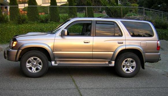

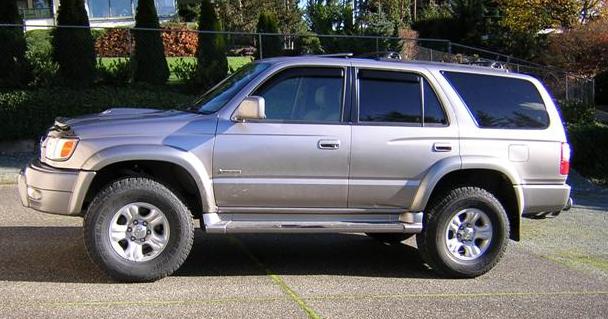

I didn't think they were sagging - they looked fine to me - flat level as far as I could tell (I had a '91 and put downey's on it to get rid of the sag - so I know what the sag is!). I figured that is the way it came from the factory. Check out the pics before (stock) and after (880/906/265.75). Sorry its parked on a slope, but hey, thats my driveway!

Keep in mind that 02 was PRETTY DAMN LOW. I was disgusted when I parked the 02 next to my 91 --- I had bought a soccer mom rig without even knowing it!!! At least now it looks respectable.

Looks much better.
