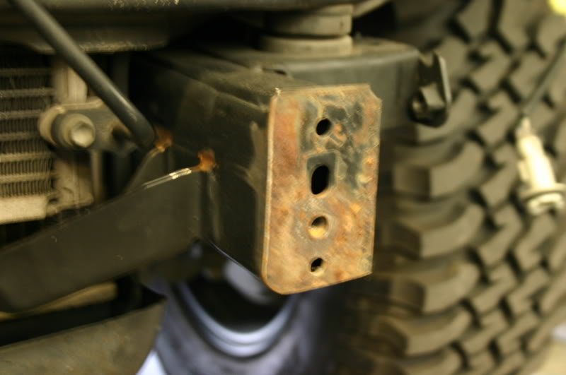

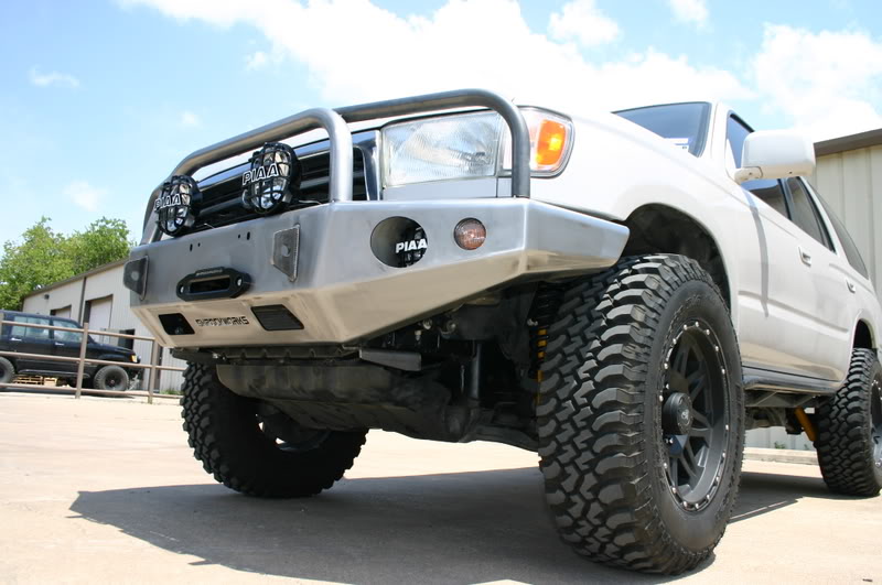

Originally Posted by wmflyfisher
Thanks Aaron. Havn't decided what I'm going to do yet. Might just sell this one and go with a Shrockworks. Just don't want to be SOL if I ever want to sale the vehicle.

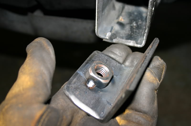

If you get our bumper the end caps are cut off, but just at the frame end, you basically grind the welds off and remove the cap, at that point we recommend doing the frame end cap mod (which we include the end caps to be welded in) to add the 1/2" bolting attachments to the frame ends. Our bracket catches both the stock tow mount bolts on the bottom, a 3/8" bolt from top of frame to bottom (drilled hole), a 3/8" bolt through stock holes enlared (from 5/16") 10" from the frame end and the 1/2" end cap mod bolting location for each frame rail.
If you do this mod for the bumper you have, there is no easy way of going back besides keeping the frame ends and welding them back on later. And this would make it specific to the bumper you are showing (or custom).
The widths of the Tacomas and 4Rs are the same...the difference would be flares. The early model SR5 flares are like your Tacoma the later model SR5 (99 and newer I think, but not certain off the top of my head, notes are at shop) and LTD. are 2" flares each side.
Pics of early and later model 3rd gen end caps

after mod...you'd basically be doing the same but 3" shorter..keep in mind the piece shown was prototype angle iron..the one recieved with our bumper is CNC lasercut and formed
