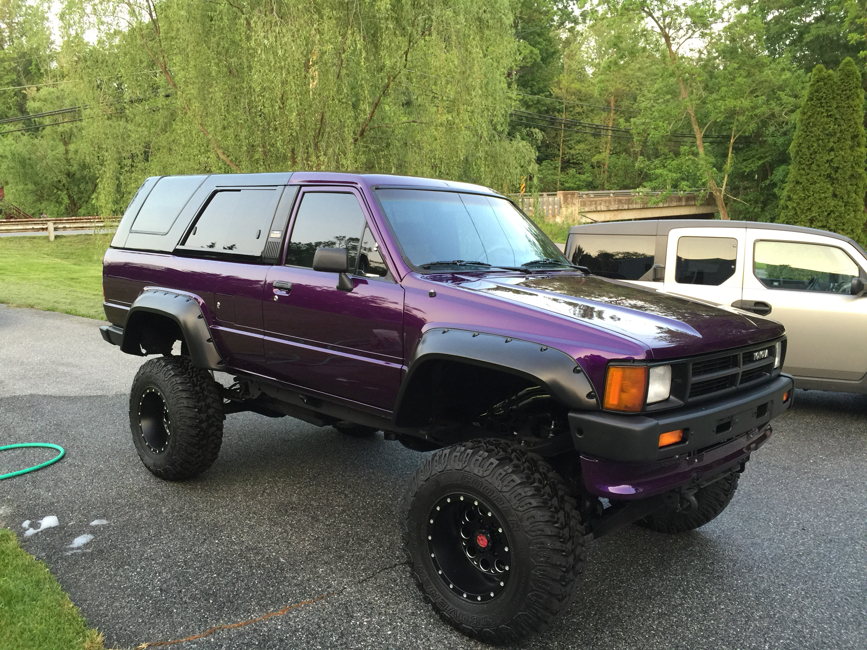

Well I have my own opinion on Northwest off road. I bought all the swap parts from them (less the radiator) to put my 302HO in my 88 4Runner. All the parts including the headers fit perfectly except the oil pan slight interference with the steering stabilizer (that was an easy fix). My problem was getting info from them. As in what needed to be done of it the swap.
First off my rig is a mall crawler. I don't take it off-road, more to shows. I do drive it back and forth to work 2-3 days a week.
As far as Northwest they don't tell you you must put a body lift and a suspension lift on to fit the engine in. They say on there website "highly recommend". They don't tell you if you use a Ford small block you need the short water pump to fit it with any chance off fitting a radiator in the truck. So here is a list of everything I did to make it fit. And I'm still running the w56 manual trans from the 22re.

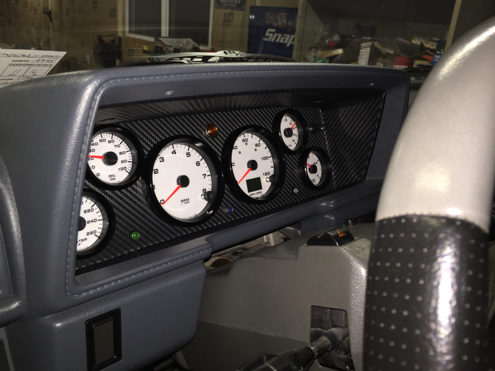

Gauges won't work with V8 and Ford engine found it easiest to put in speed hut gauges with GPS speedo

Here's some pictures (truck still had 32" on it in picture)
Attached Thumbnails V8 Swap, Going Racing, looking for insight... long term thread-photo69.jpg   V8 Swap, Going Racing, looking for insight... long term thread-photo319.jpg   V8 Swap, Going Racing, looking for insight... long term thread-photo334.jpg
