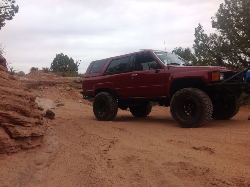

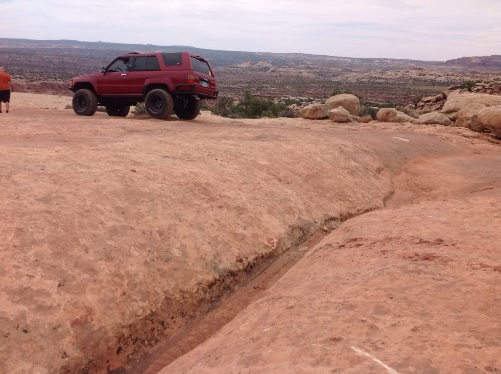

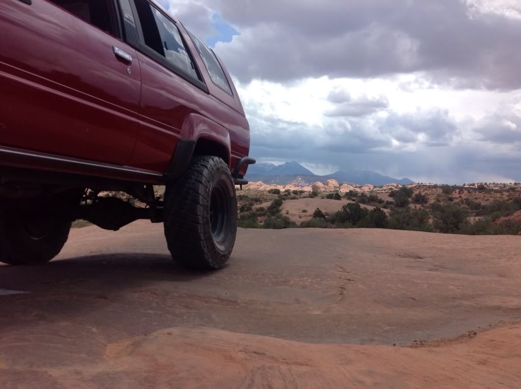

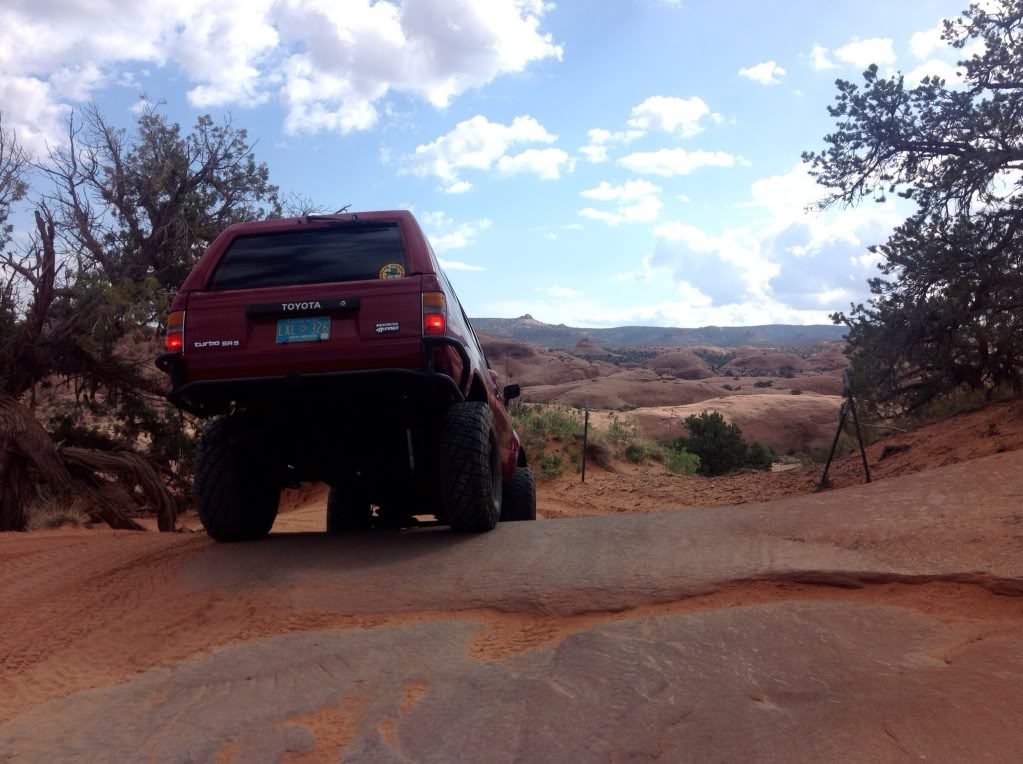

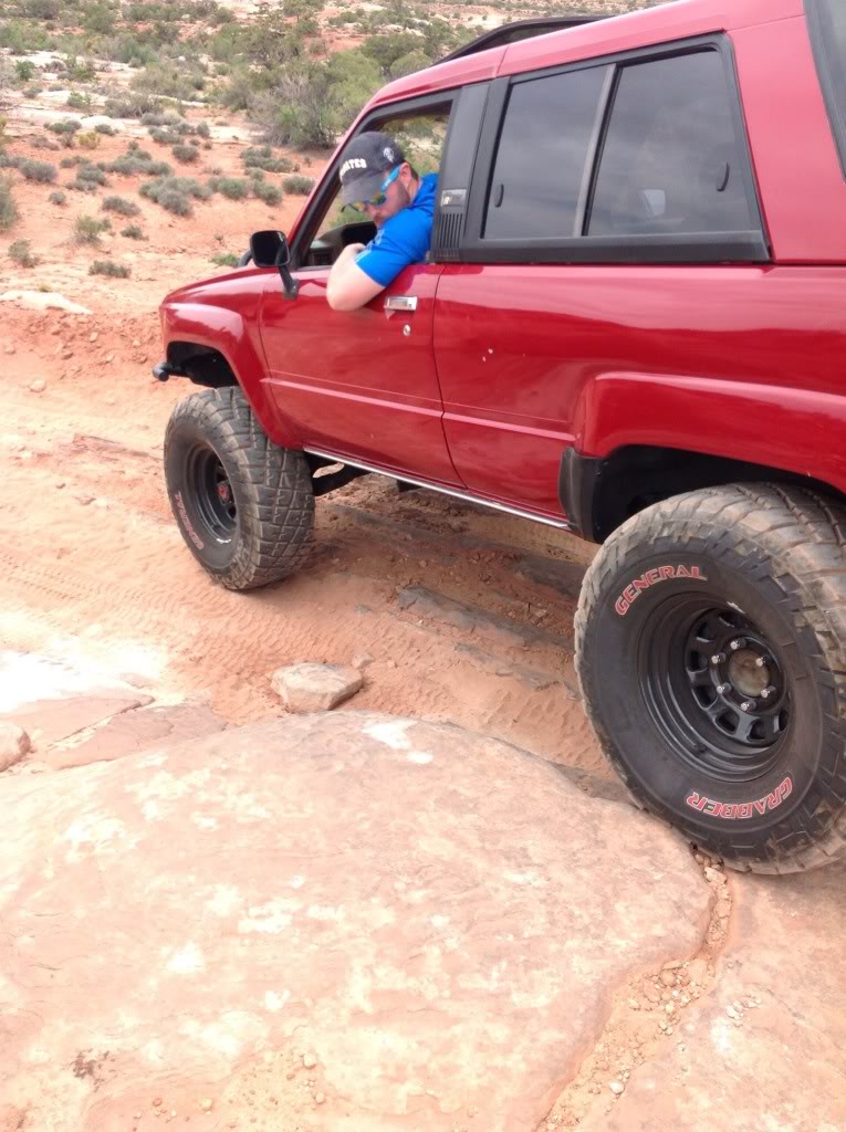

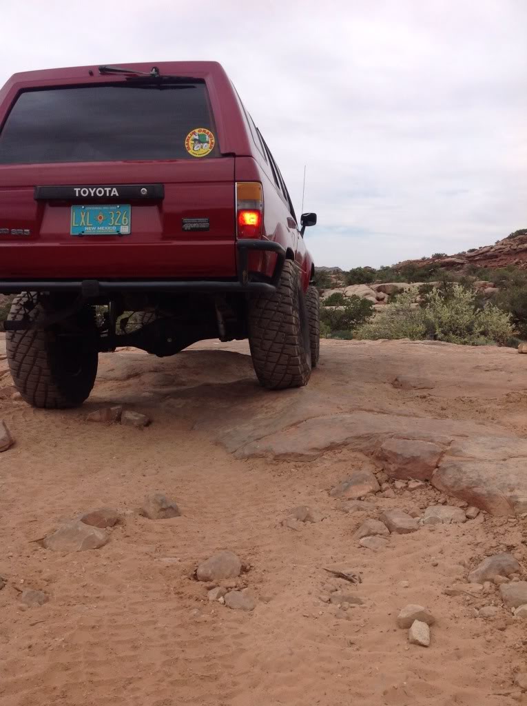

wow it's been a while since i've uploaded anything! i'm going to put up some pics tonight of Moab, Utah. i went out there a week ago and ran Sevenmile Rim and Fins n' Things to test out the rig! with front and rear lockers it crawled like a tractor. simply impressive. i loved watching all the Jeepers struggle haha.

TURBOrunnerNM's Avatar

Thanks man! Yep, 5.29s front and back. Grizzly locker in the rear and a spartan in the front with Yukon gears. It ran the trails with ease and crawled at 2mph at 2500 rpm! Tons of low-end torque with the new gear ratio.
