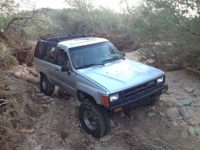

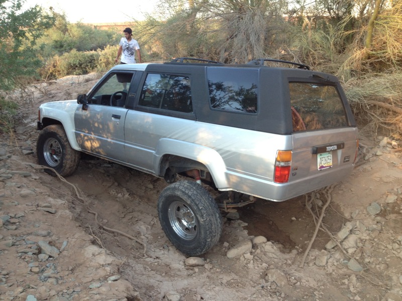

Went out a couple of weeks ago with Assyrianrocker and snapped a couple of pics.

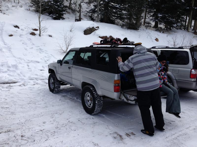

I'm really big into snowboarding so I thought Id snap a couple of pics of the truck when I loaded it up with some boards and went up north to Snowbowl.

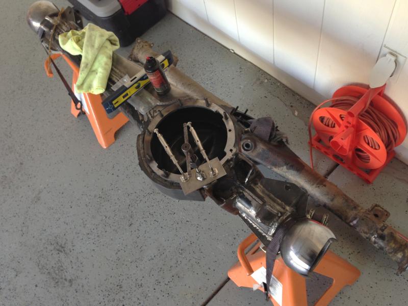

Meanwhile, getting some stuff done at home. The axle is almost done being modified for the e-locker with 4.88 gears.

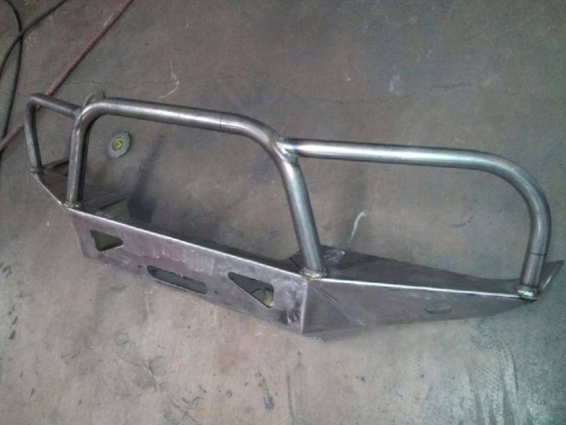

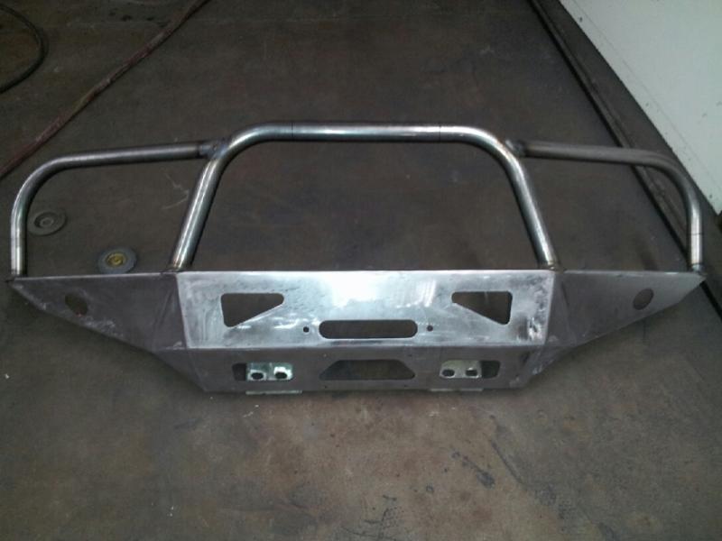

It seems like I update this thread once every 6 months but funds just haven't been there for me to get this project really rolling.I did manage to get my cbi bumper all welded up and flap wheeled. I will be sending it to the powder coater in the next couple of days and snap some pics when it goes on the rig.
