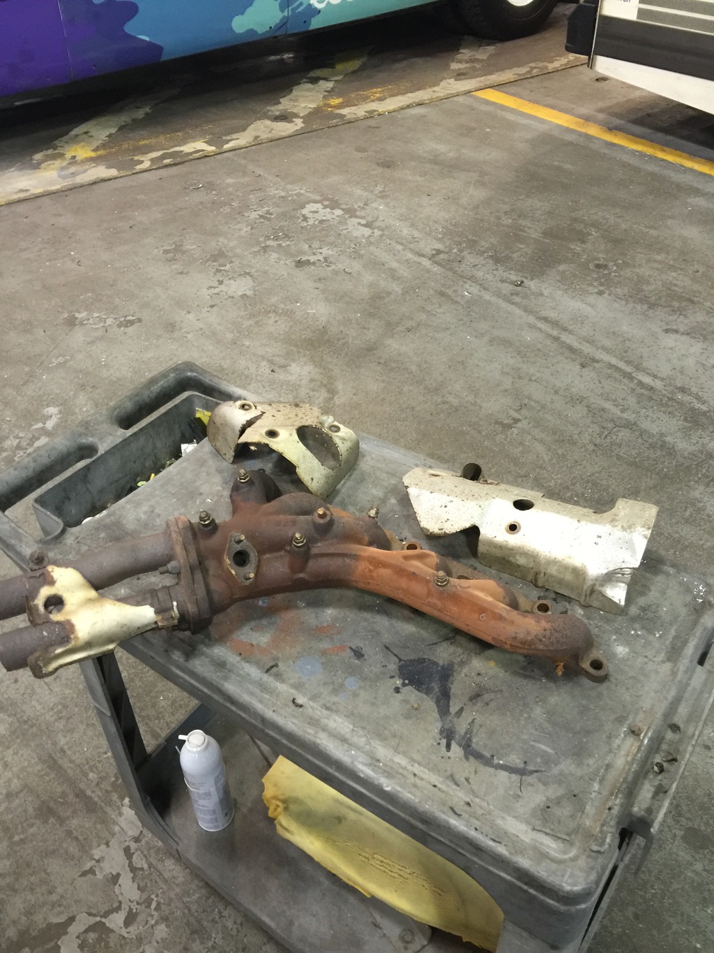

Stock 5MGE Exhaust Manifold as the PaceSetter in the pics turned out to hit the frame with the trans installed

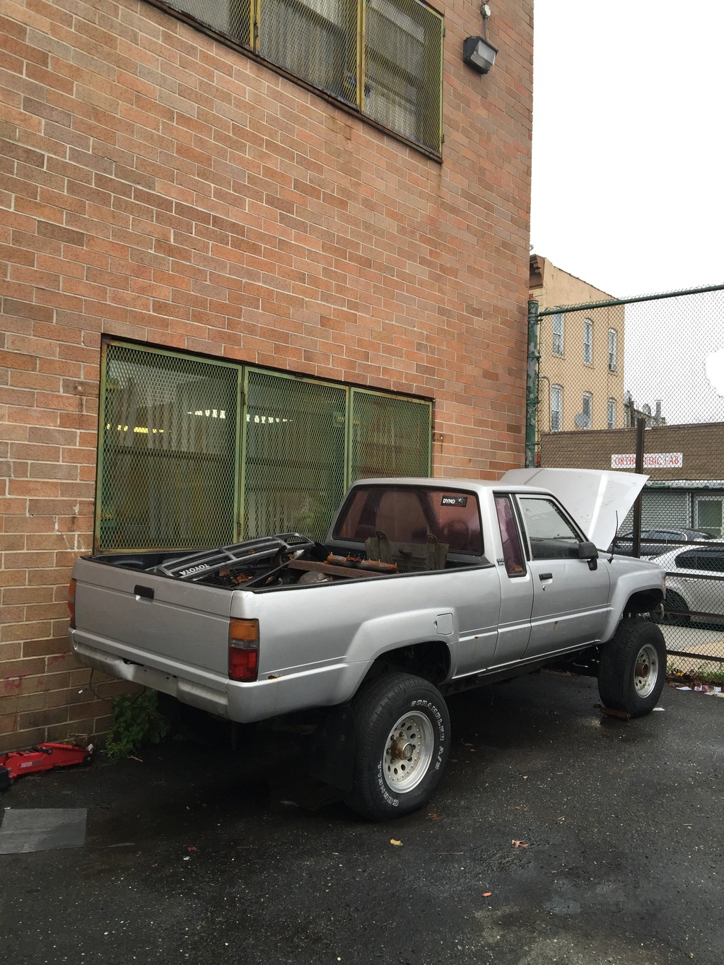

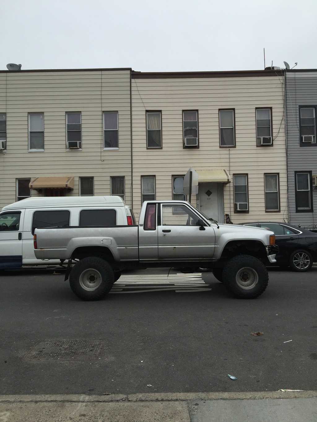

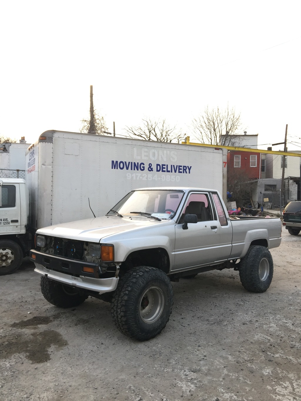

Loaded up from the sellers house. July 2015

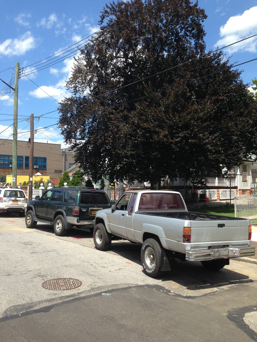

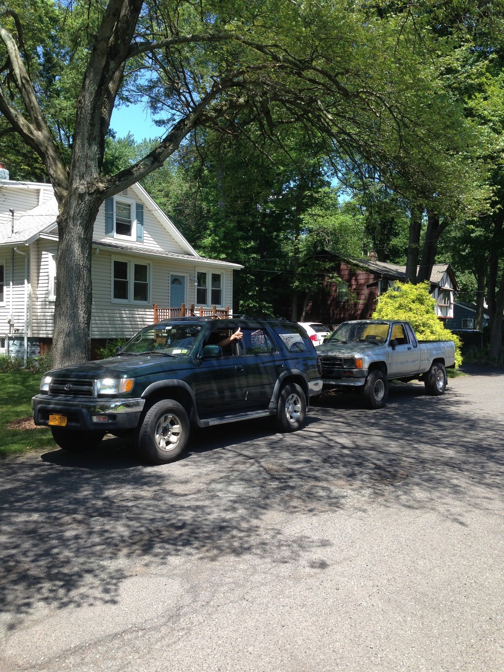

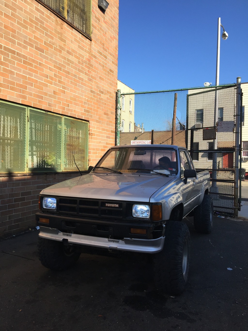

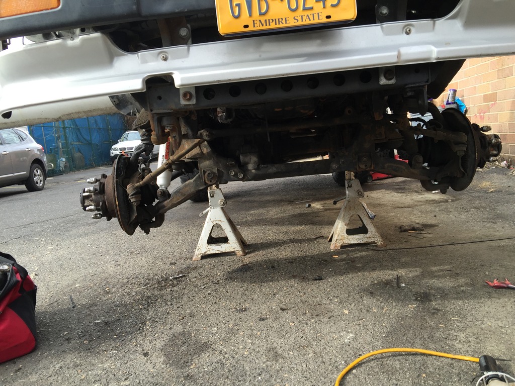

Here in NYC at my friend's house.

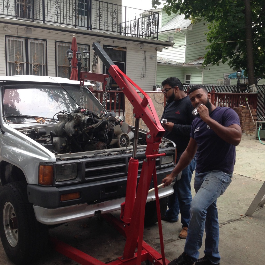

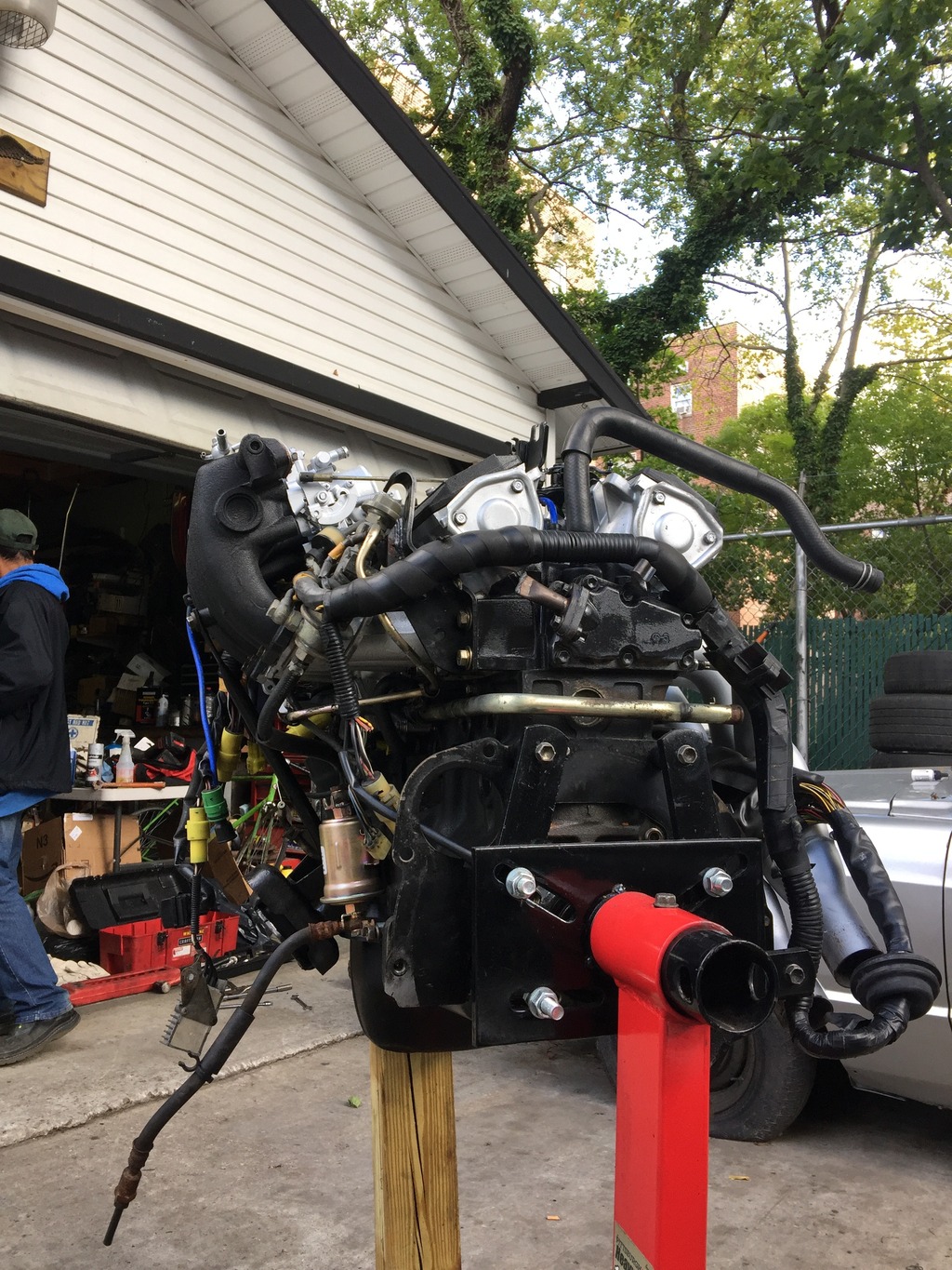

Me posing after getting ready to pull the motor September 2015

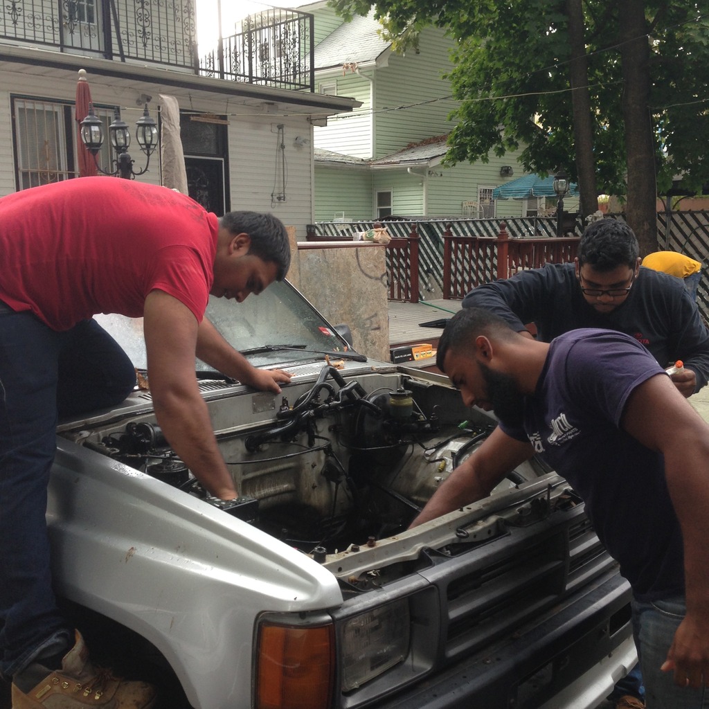

My helpers for the day. Having Ice Cream

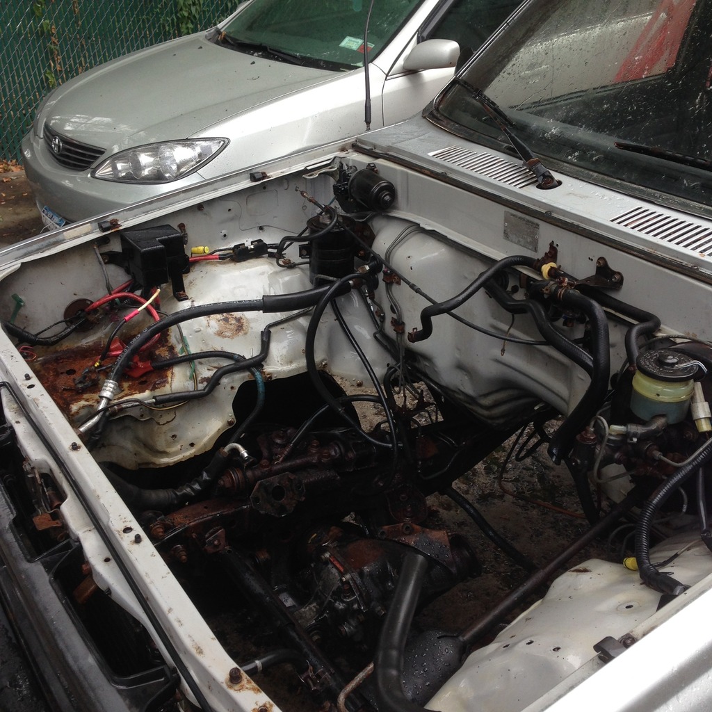

Some more of my helpers helping clean the engine bay.

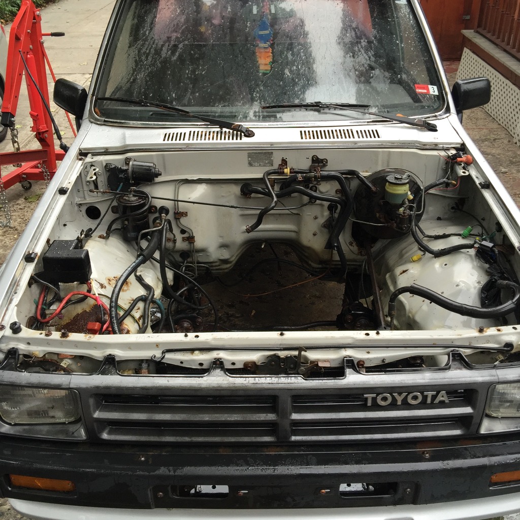

All clean. Have to take care of the battery tray rust.

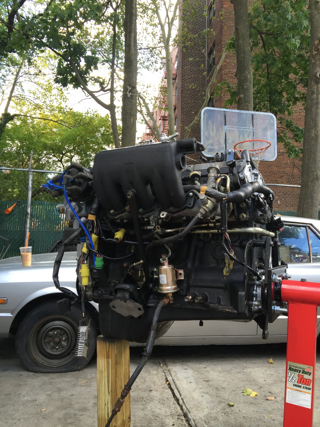

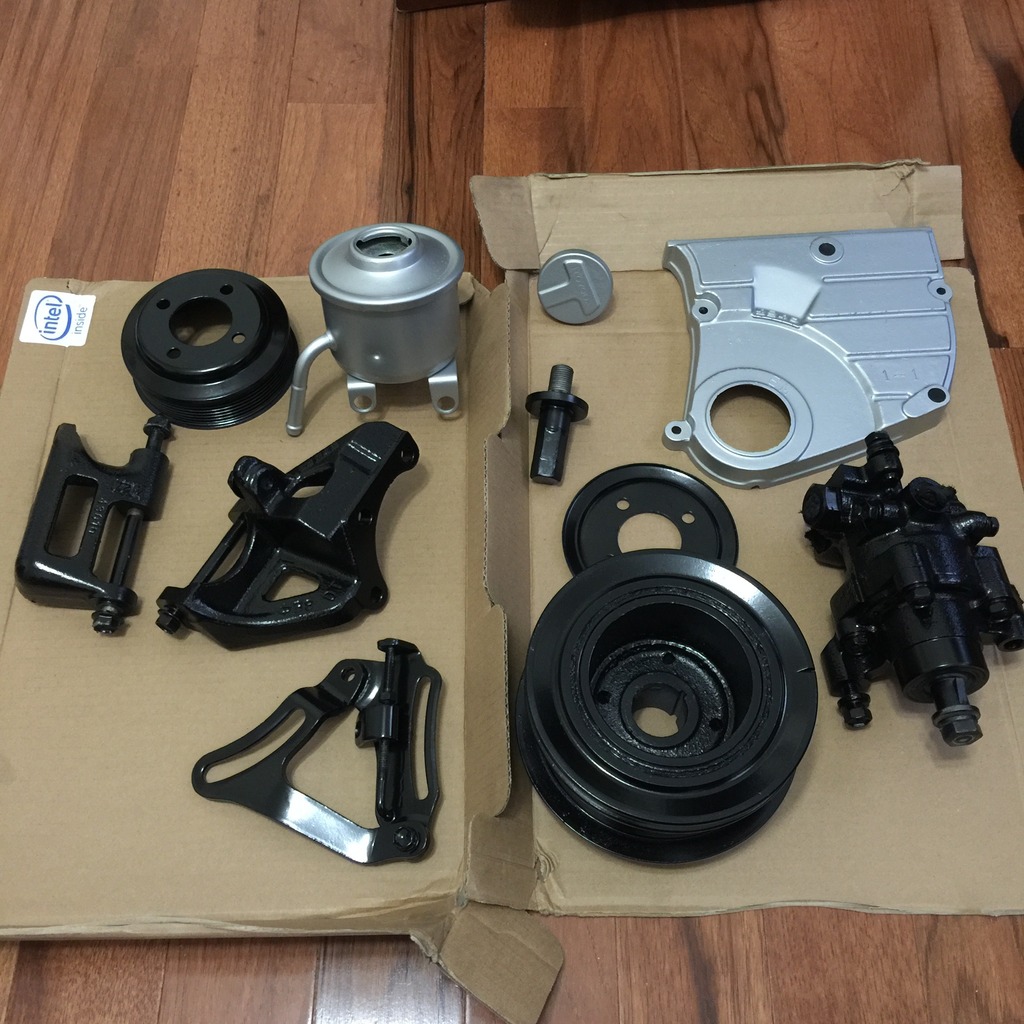

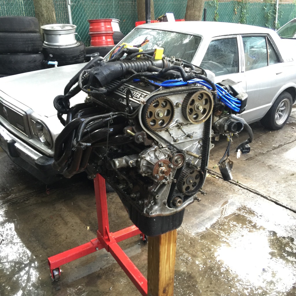

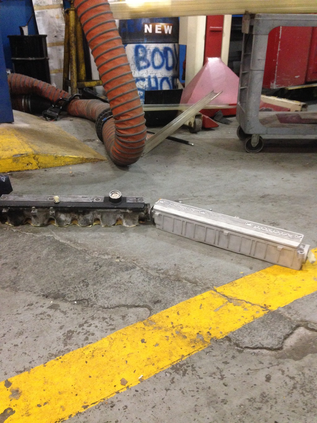

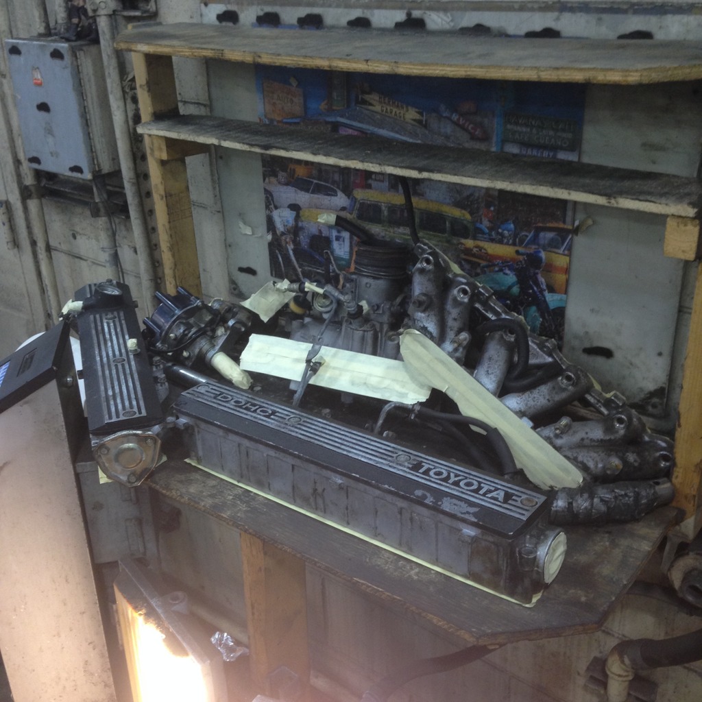

Stripping the cam towers and all the timing belt covers to be cleaned and painted. And to make way for the Valve seal job.
Brought the top end and a bunch of parts to my job to be sandblasted.
Before and after the sandblaster. (Yes I taped the gasket surfaces)
Some misc brackets and covers painted by my friend.

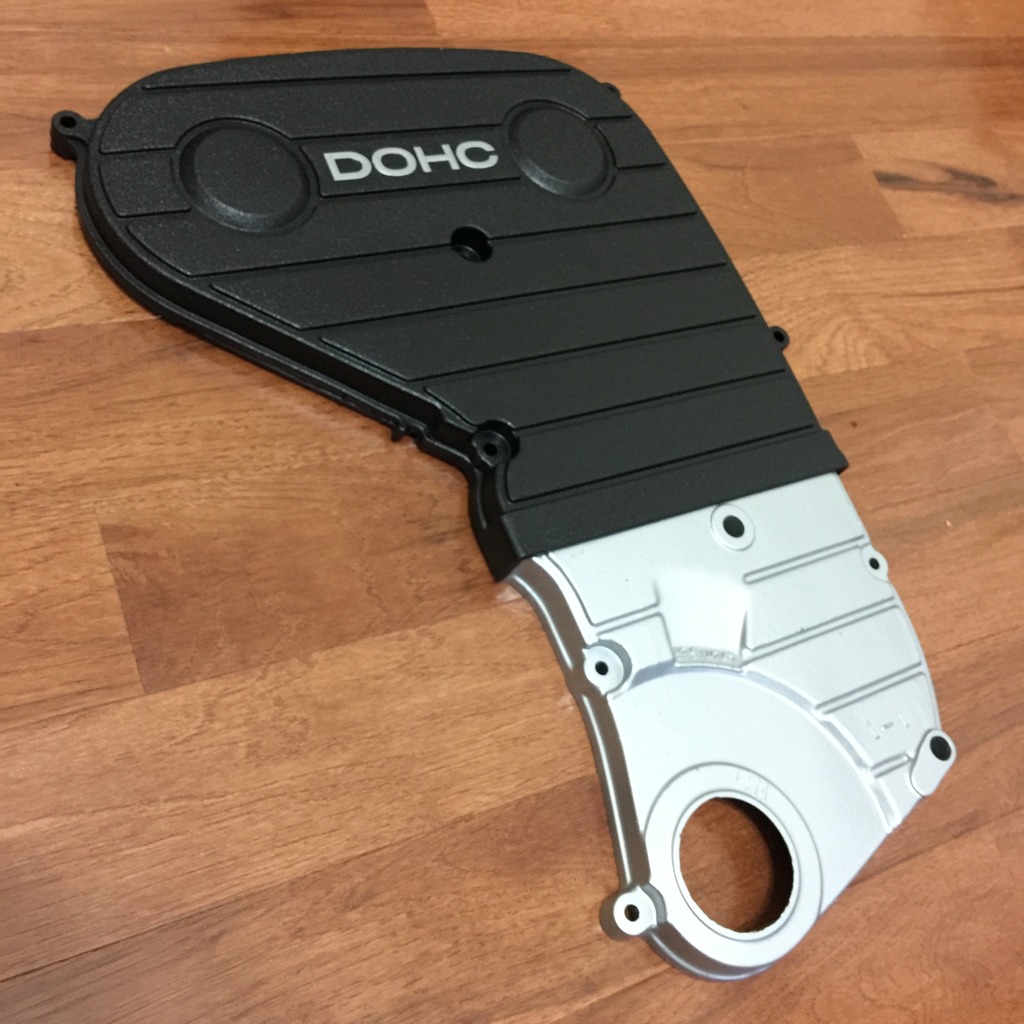

The front timing covers after being refinished by my buddy.

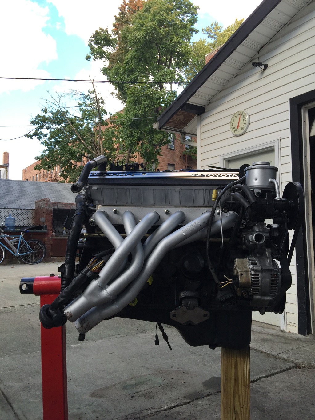

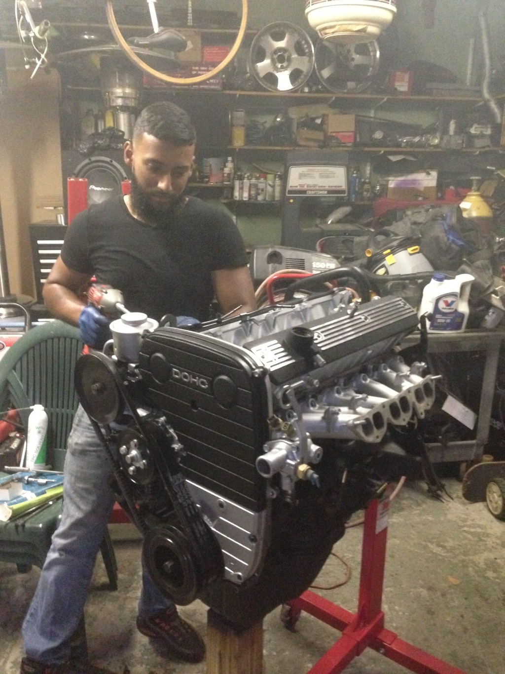

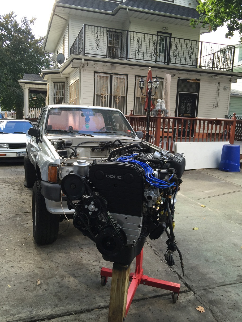

The engine taking shape again.

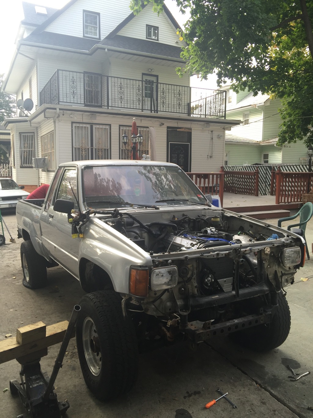

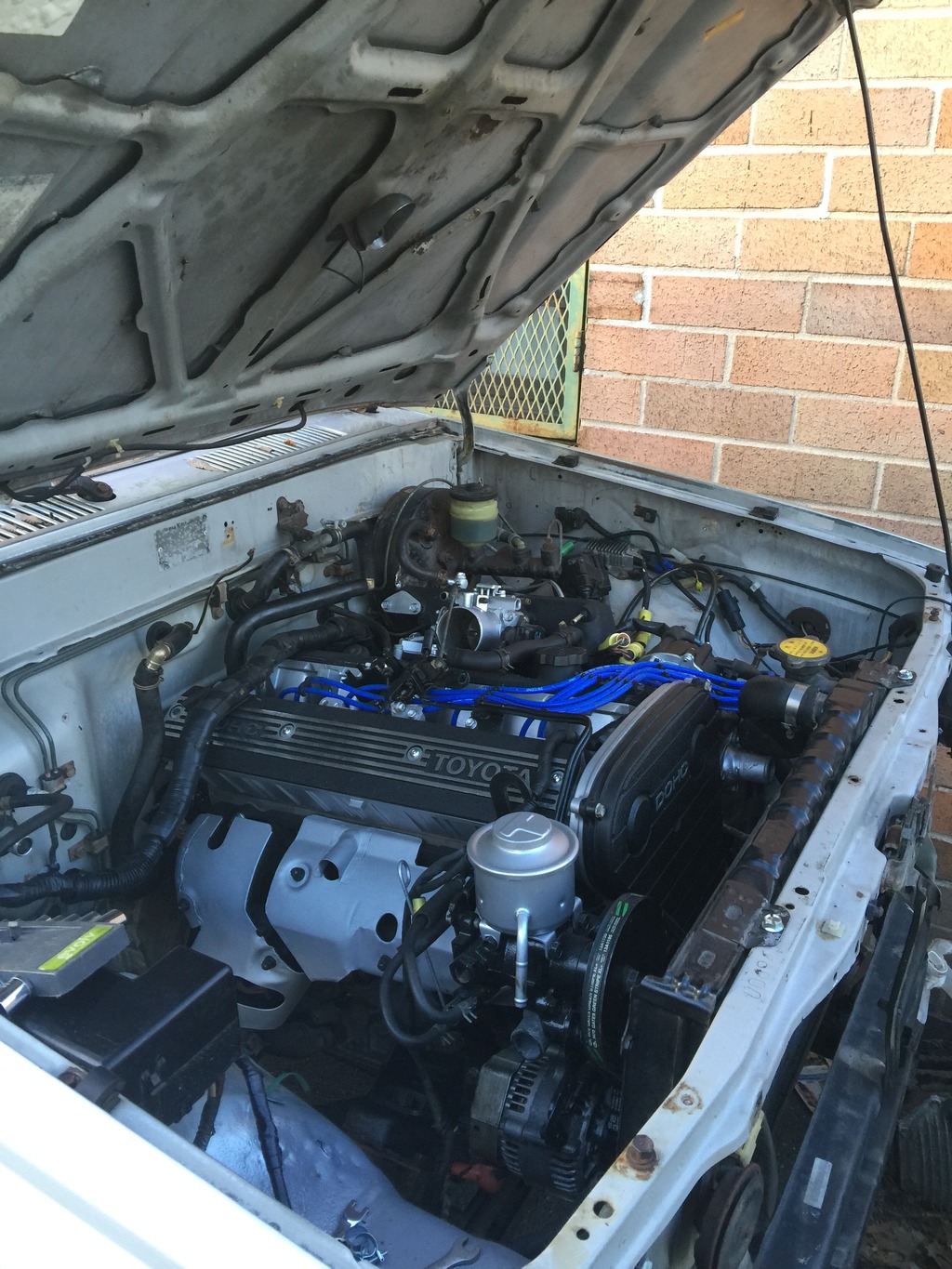

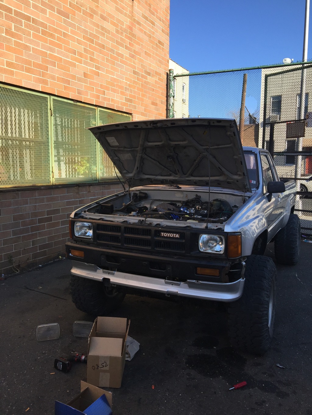

Time to see if it'll fit. 10/17/15

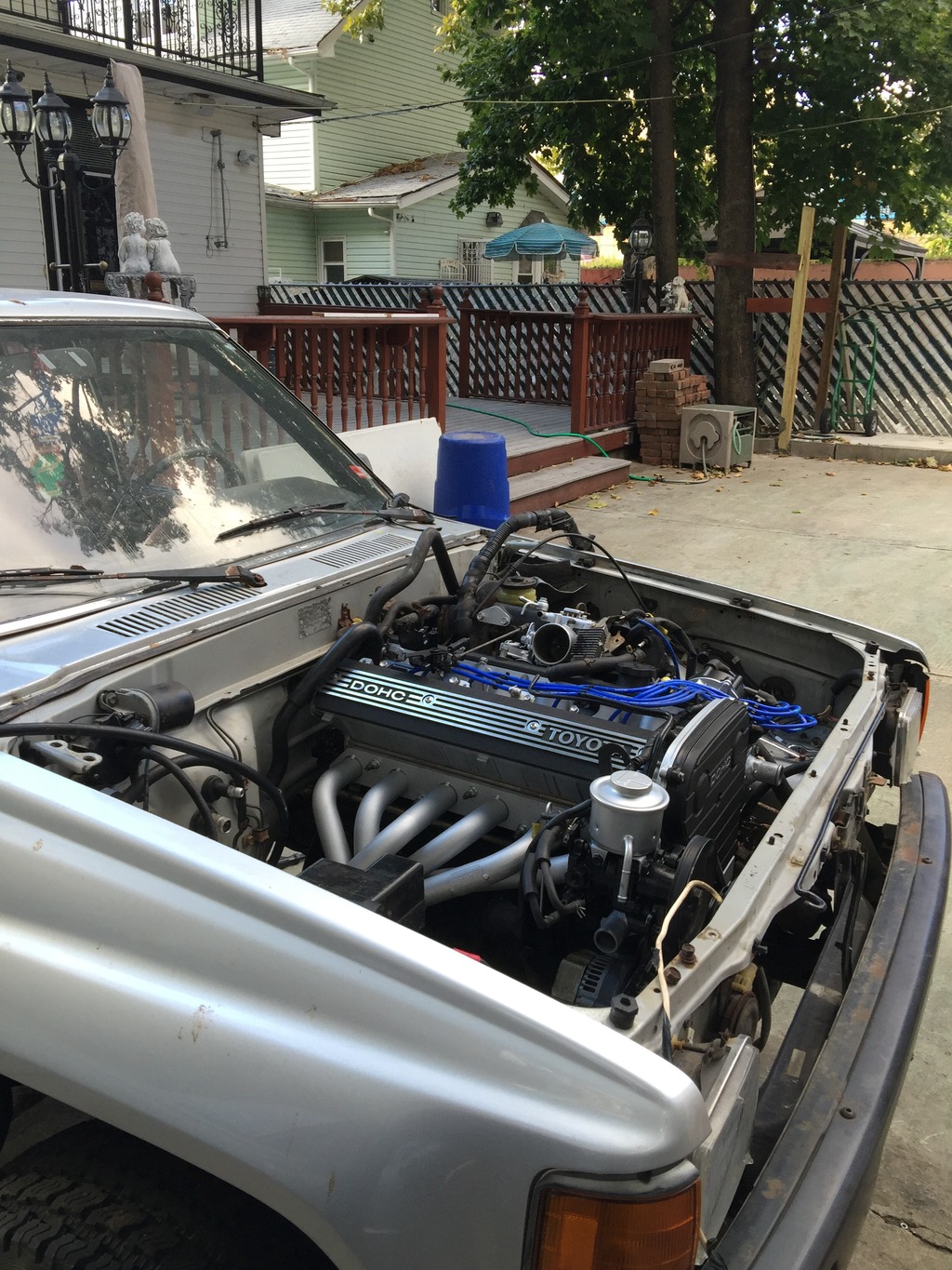

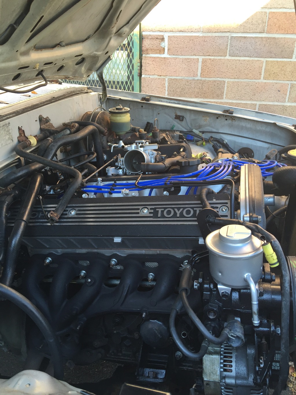

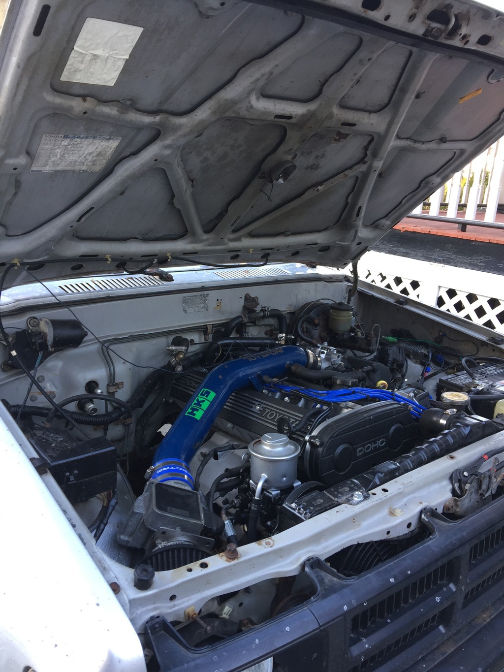

It fits! Engine seems to sit really high and it does. But I did get the hood to close. Im thinking Im going to need either a 2" or 3" body lift to relax the heater hoses. But most importantly the bellhousing. Which youll see in another photo.

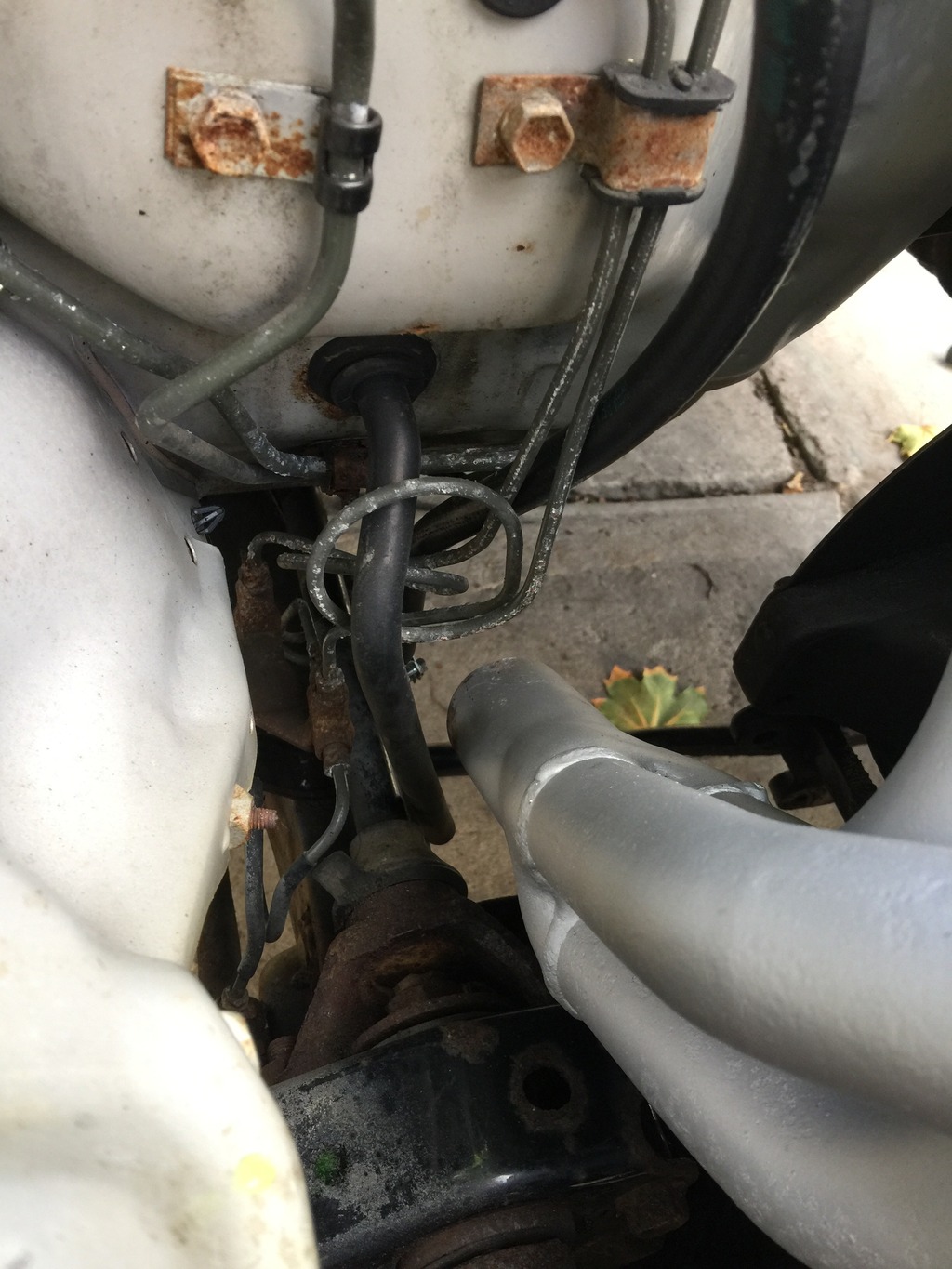

The header outlet clearance without the collector Y pipe. Ill have to fab a heat sheild and some heat wrap for the lines.

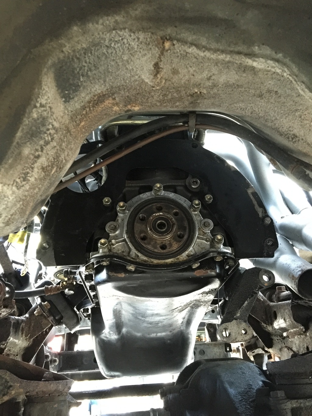

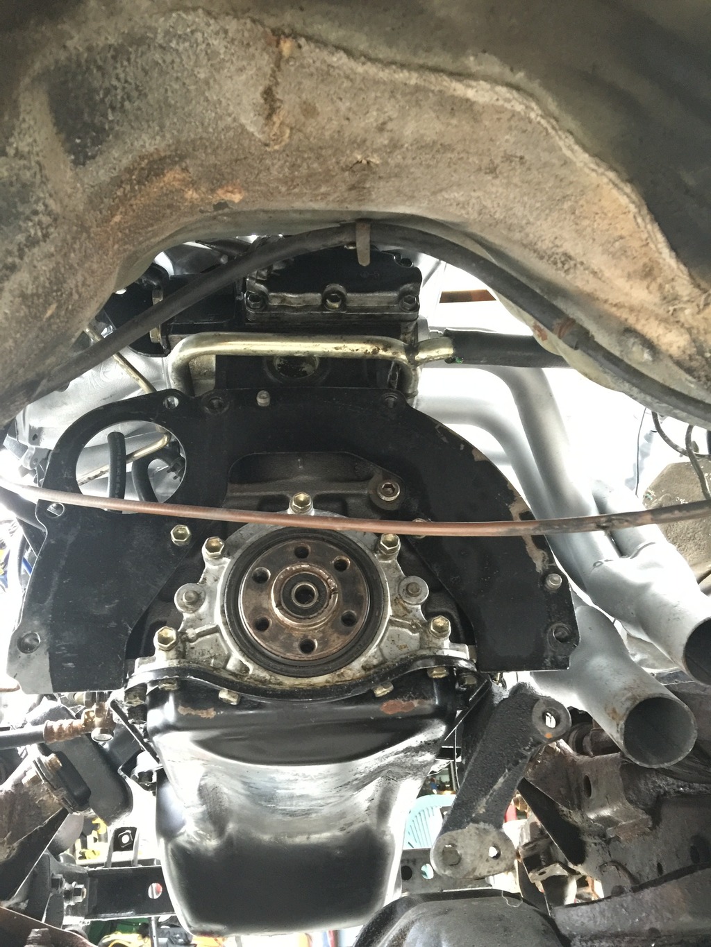

Oil pan clearance. Again this is a 5MGE front sump with Cressida Metal brackets and 22RE rubbers. The steering damper was removed and looks to be the only "mod" to fit the motor thus far.
My current issue now. It looks as if I cannot fit the transmission due to the new height. The engine sits a bit higher on the frame brackets. Upon realizing this, all of the reference photos ive saved off the internet. It looks as if all the trucks have some sort of body lift. But most of the trucks seems to have already have them before the swap so they arent always listed as a required mod for the conversion. Therefore, I completely overlooked that and now I have this issue. Im thinking to order a 3" body lift for the truck to make some more space. Which will also make my radiator mounting a bit easier.

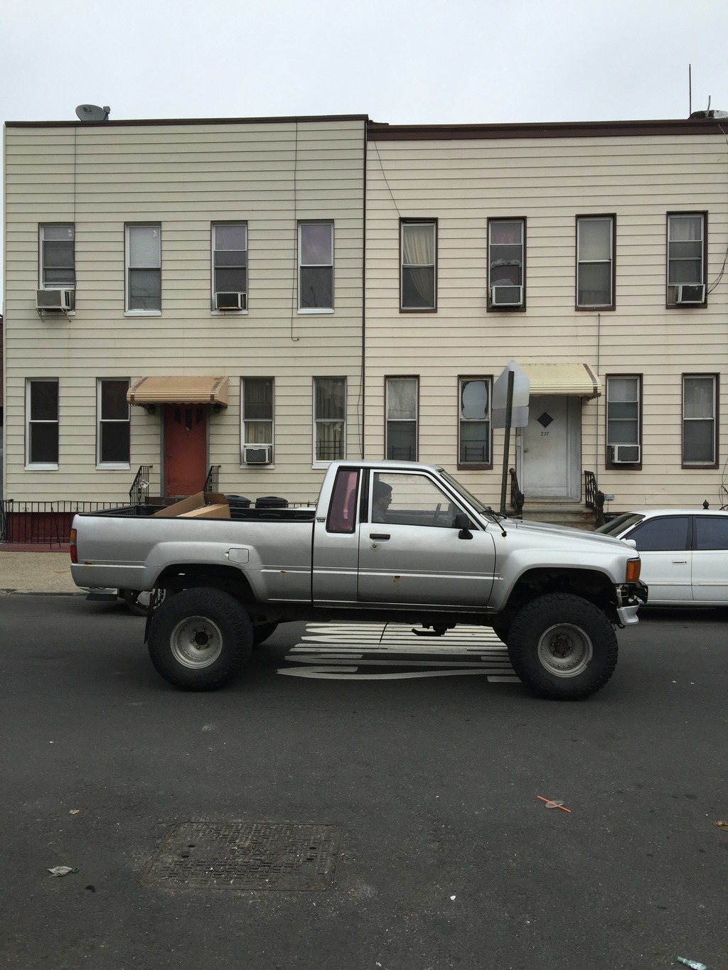

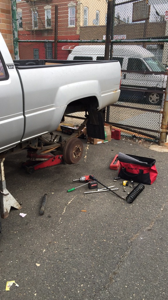

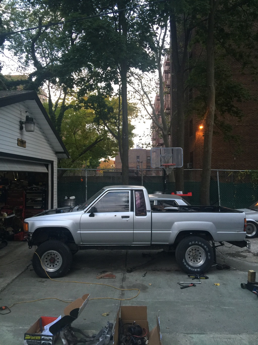

Corax, I ended up going with the 3" Body lift from peformance accessories through Summit Racing. I figured why not. It's a street truck and 3" is the max on a body lift people recommend.
I ordered it last Sunday and got it by Wednesday. And installed on Thursday.
The body lift turned out to be an easy install since almost everything that needed to be disconnected was already removed to begin with. The only things I had to remove were the bumper and the steering shaft. Which was coming out anyways for a Tilt column swap. The bed bolts were a bitch to remove since they were a bit on the right side and the tabbed studs ended up bending. Luckily I was able to use a vice grip on the three that gave an issue. The kit had a longer fuel vent hose but made no mention of the tank filler needing to be extended. I searched on Yota tech and found the answer. I'll be cutting it in half and extending it with a metal pipe. I forgot to take a before photo. Sorry about that.
The cab lift done.

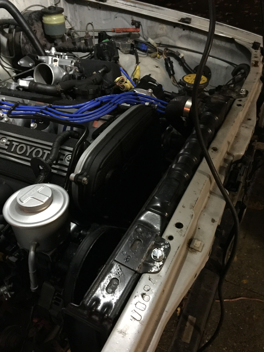

Stock 85 Supra radiator with top brackets beaten flat to the stock core support.

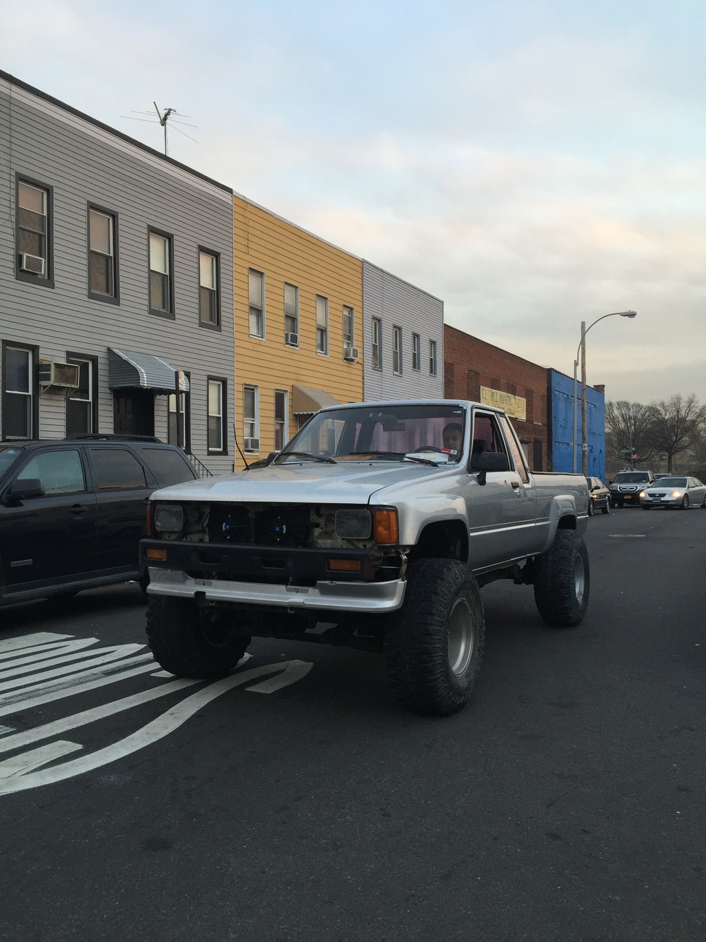

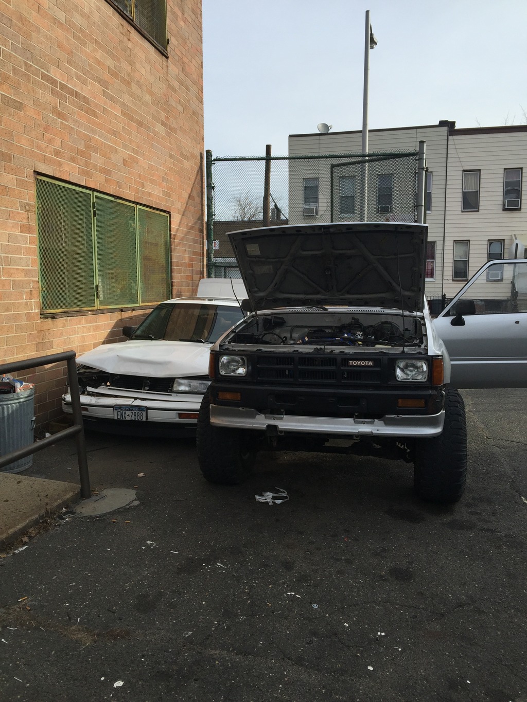

Last week I sold the ugly diamond plate/Chrome bumper to a friend with an 82 4x4. I hope to replace it with a smittybilt if I can find one that isnt rotted.

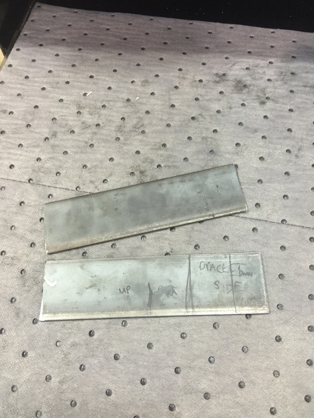

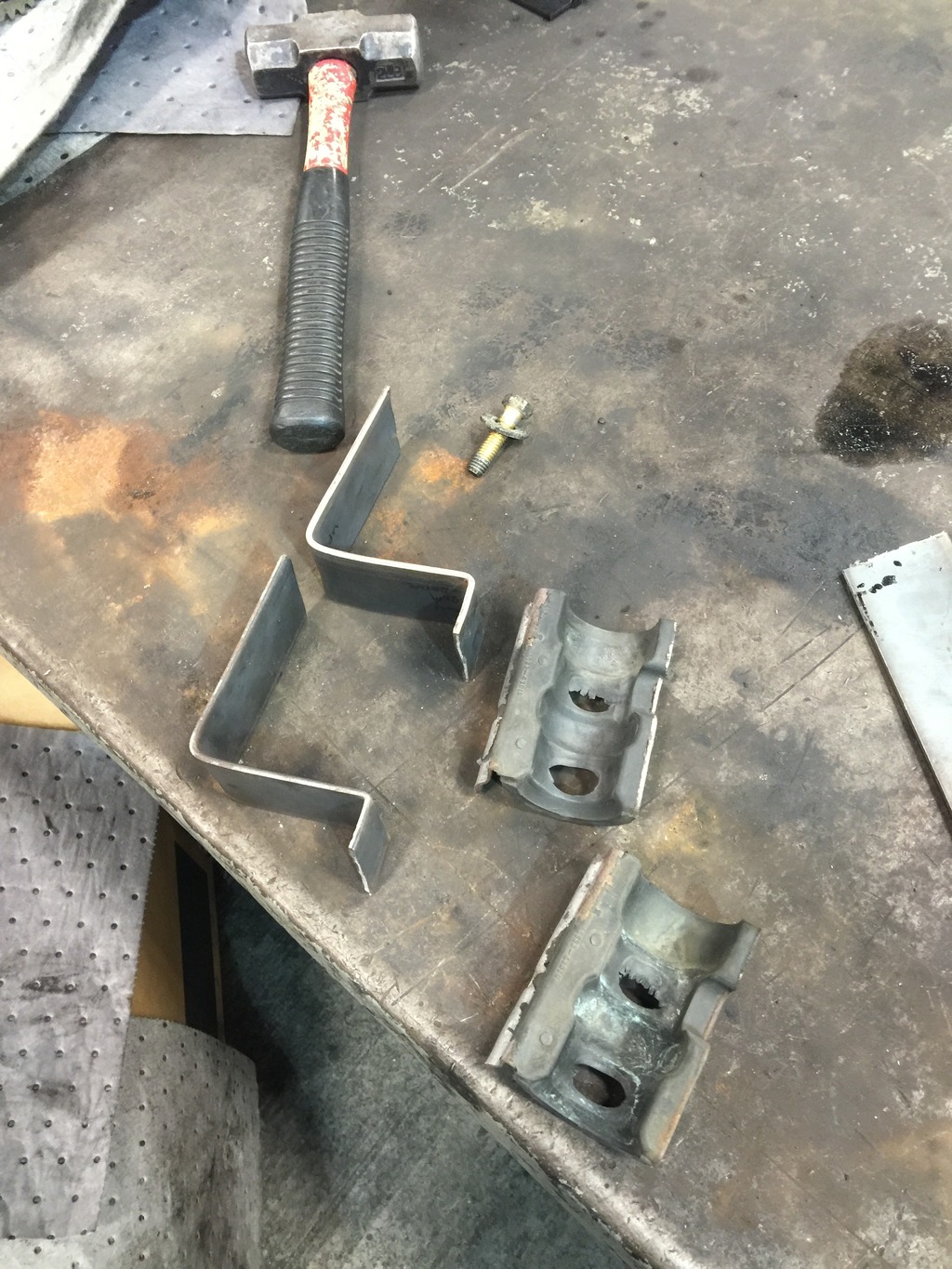

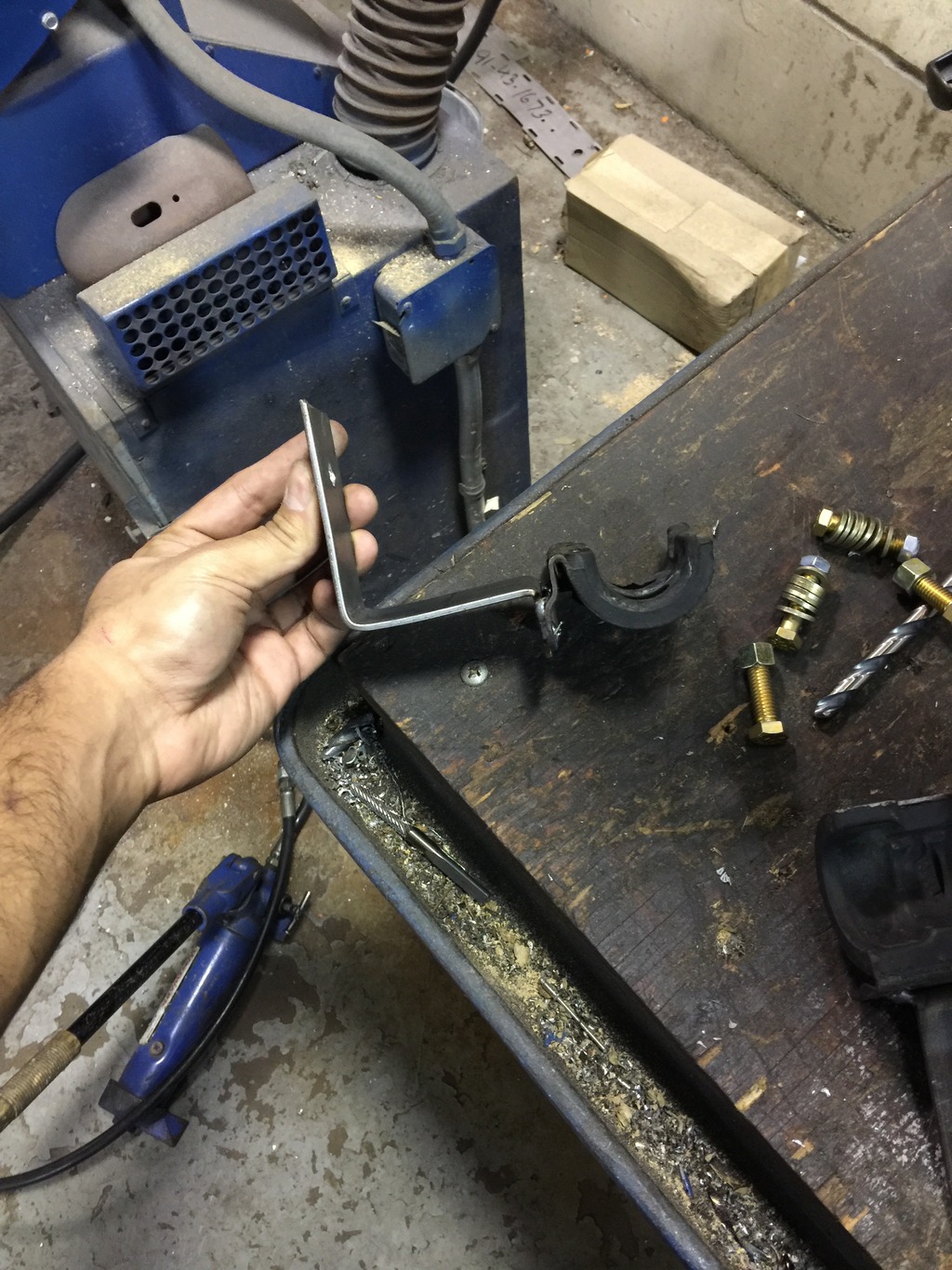

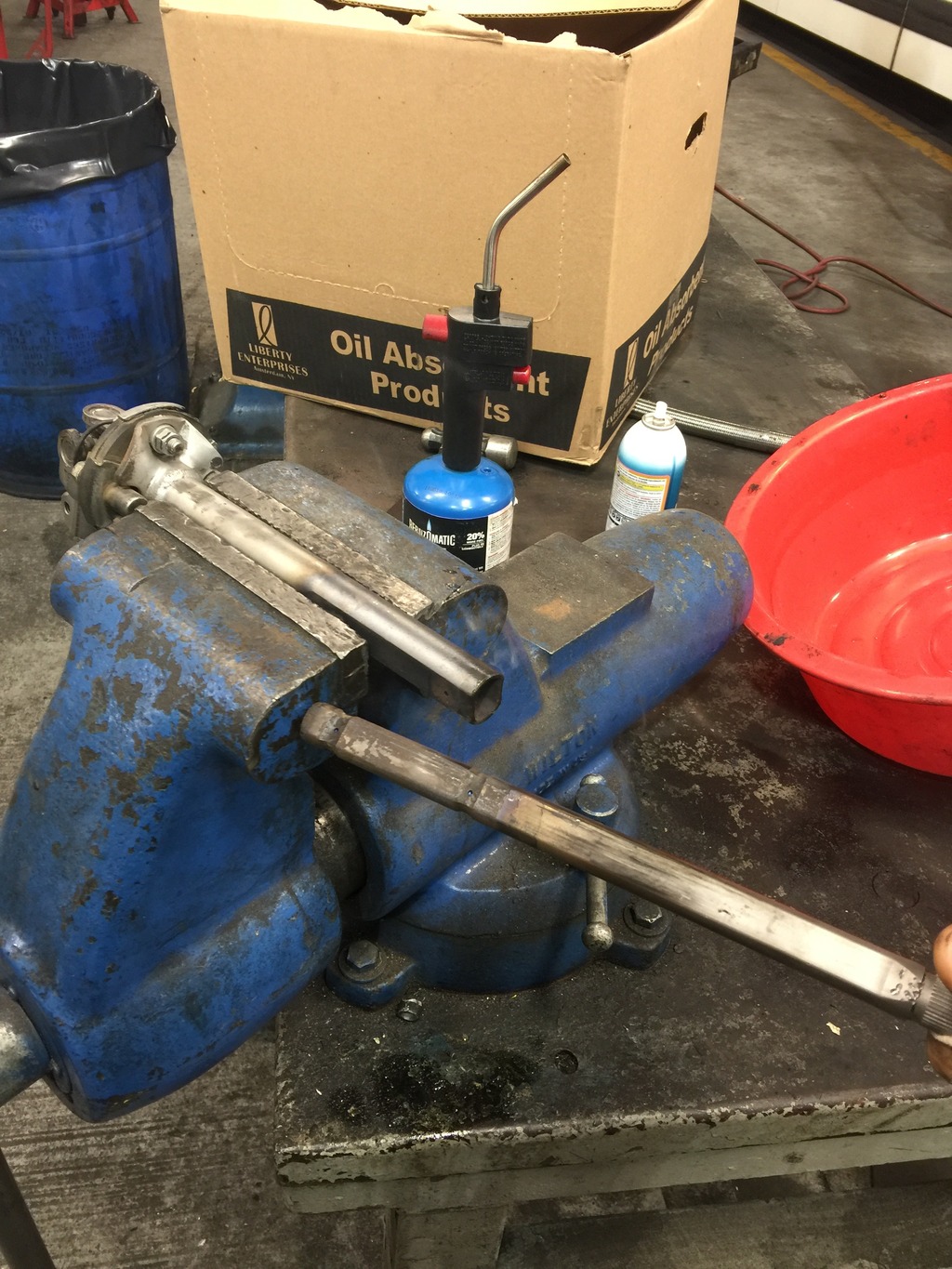

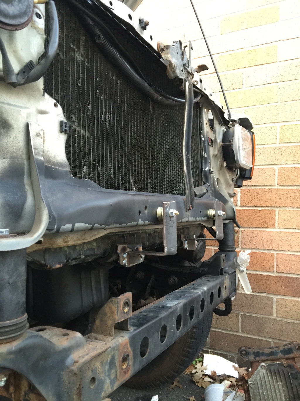

The next thing I needed to sort out was the lower radiator brackets. My original plan was to weld a piece of angle iron to the truck frame and then weld the Supra lower brackets to that. But being where I have the truck now I couldnt use a welder as easily. My neighbor gave me an idea that I should try to use the core support. Which to be honest, my dumbass didnt think of it. So I took a rough guesstimate and took some pieces to work and used a sledge and vise to shape them. Had someone at work weld the brackets to the angle iron. Came home drilled a hole in the core and used a bunch of washers to take the slack and help keep things tight. Im suprised I got it to work honestly. lol

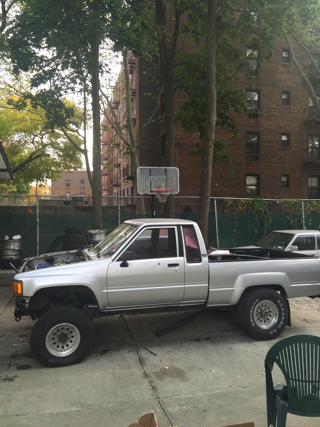

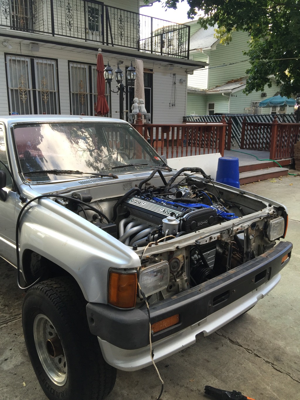

And im going to leave this off at this pic. Things are starting to take shape. The only things really left on the engine part of the project is to wire the cooling fans, wire the engine harness, get a power steering line made, and connect the fuel lines. I ran rubber fuel injection hose from the motor and im going to splice them into the hard lines near to the tank.

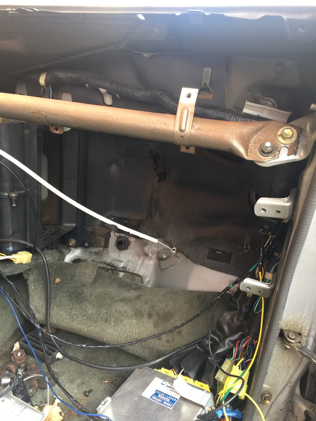

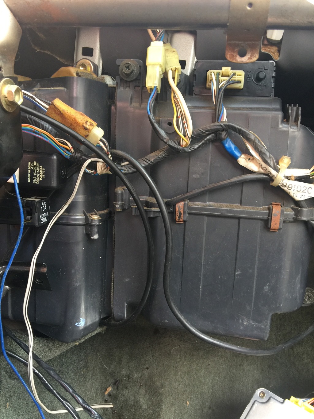

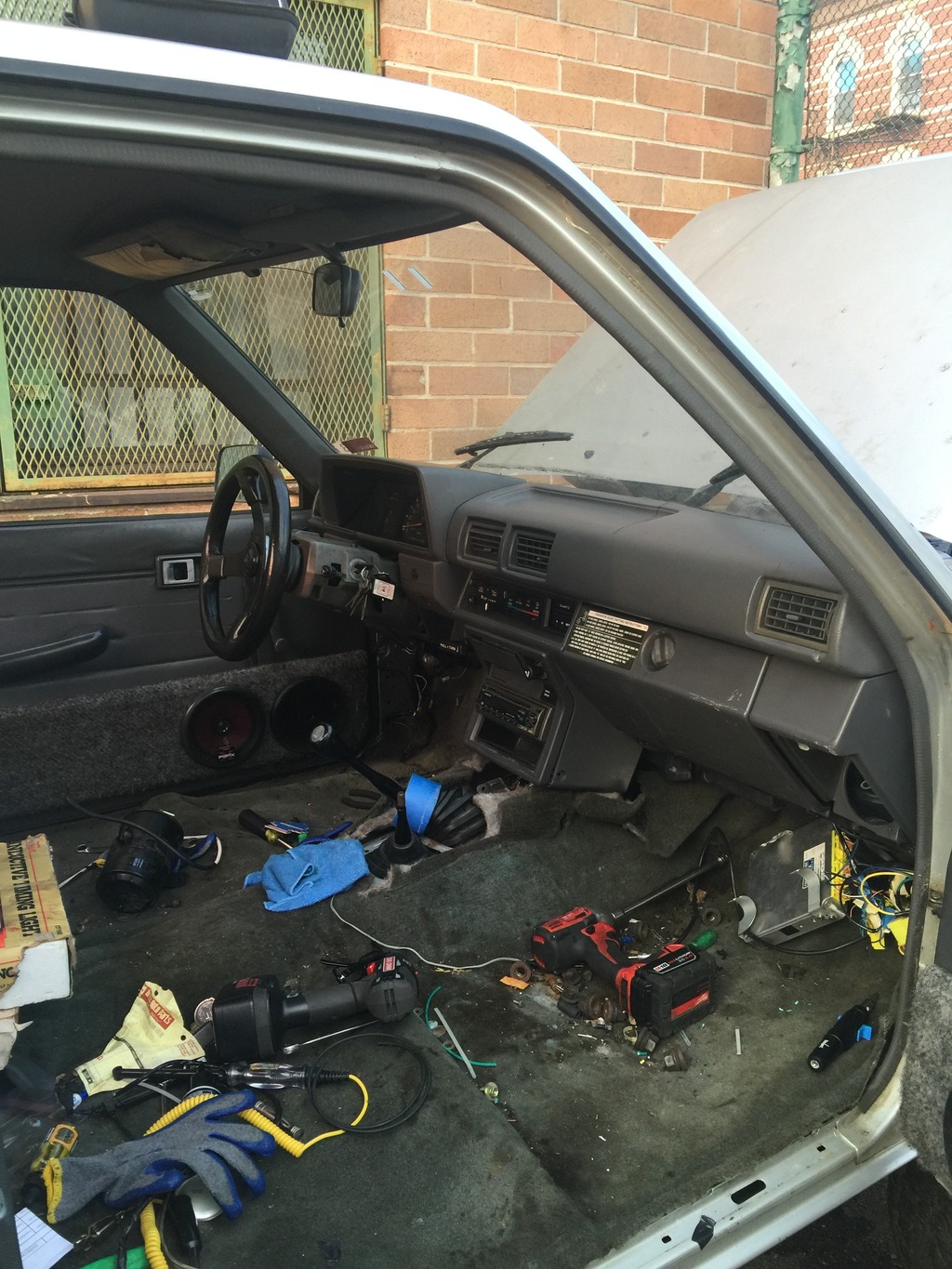

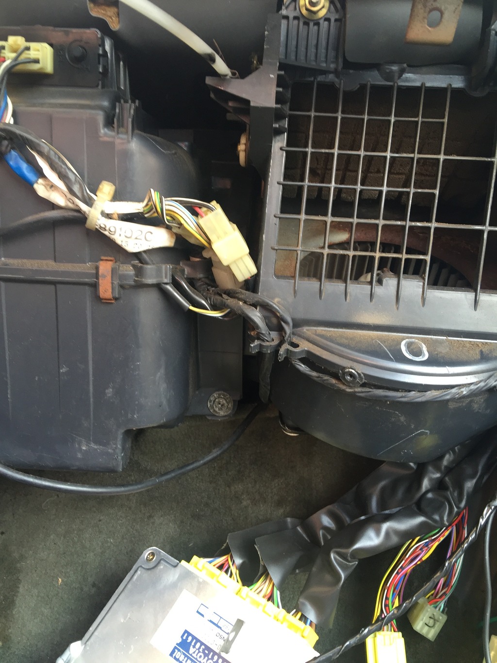

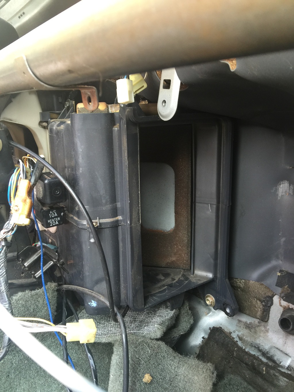

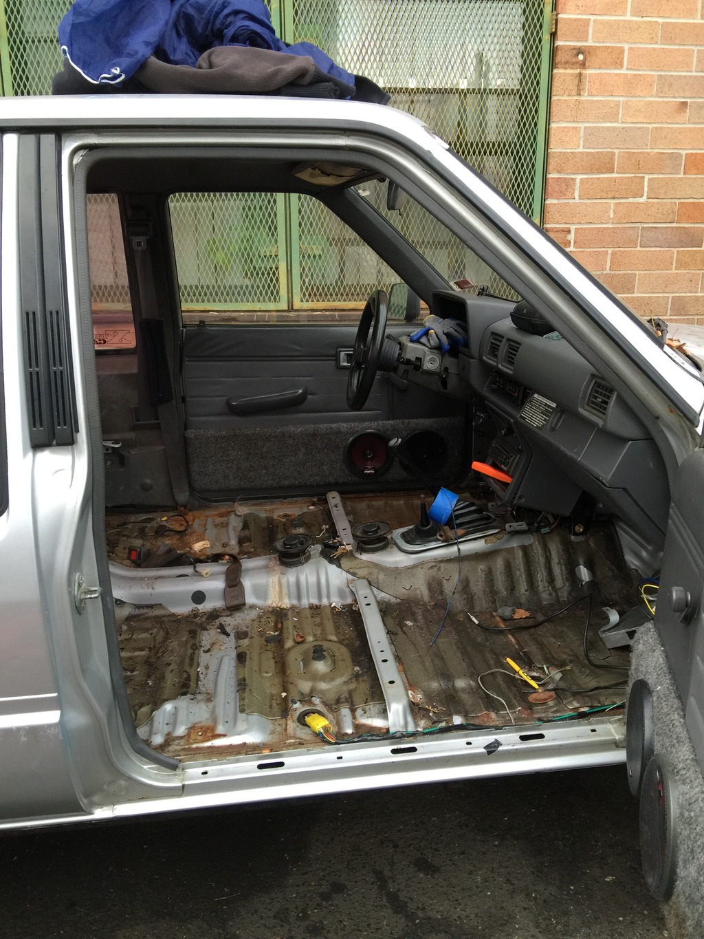

Yesterday, 12/12/15 I tackled the wiring. Started a little later in the day than I wanted to. But I had taken the night off of work so I could work through the night if I wanted to.
This is where I started off. I thought I was gonna be able to get by with just the lower right side panels out of the way. But then I quickly learned that wasnt gonna happen like that. I also learned that the giant dash is basically one whole piece lol. I first removed the dashpad, then gave in and removed the whole dash.
All to get to this one relay since there wasnt much slack to pull it through.

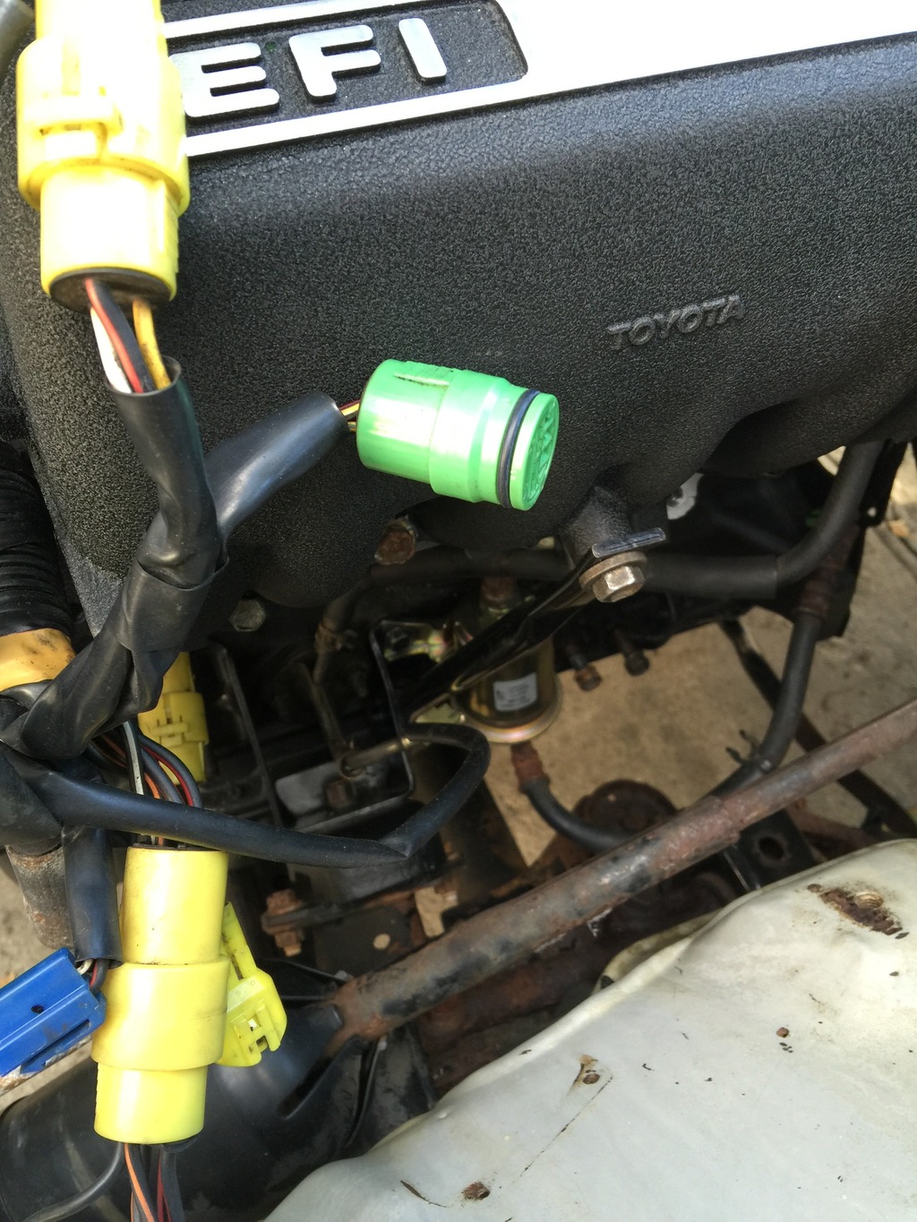

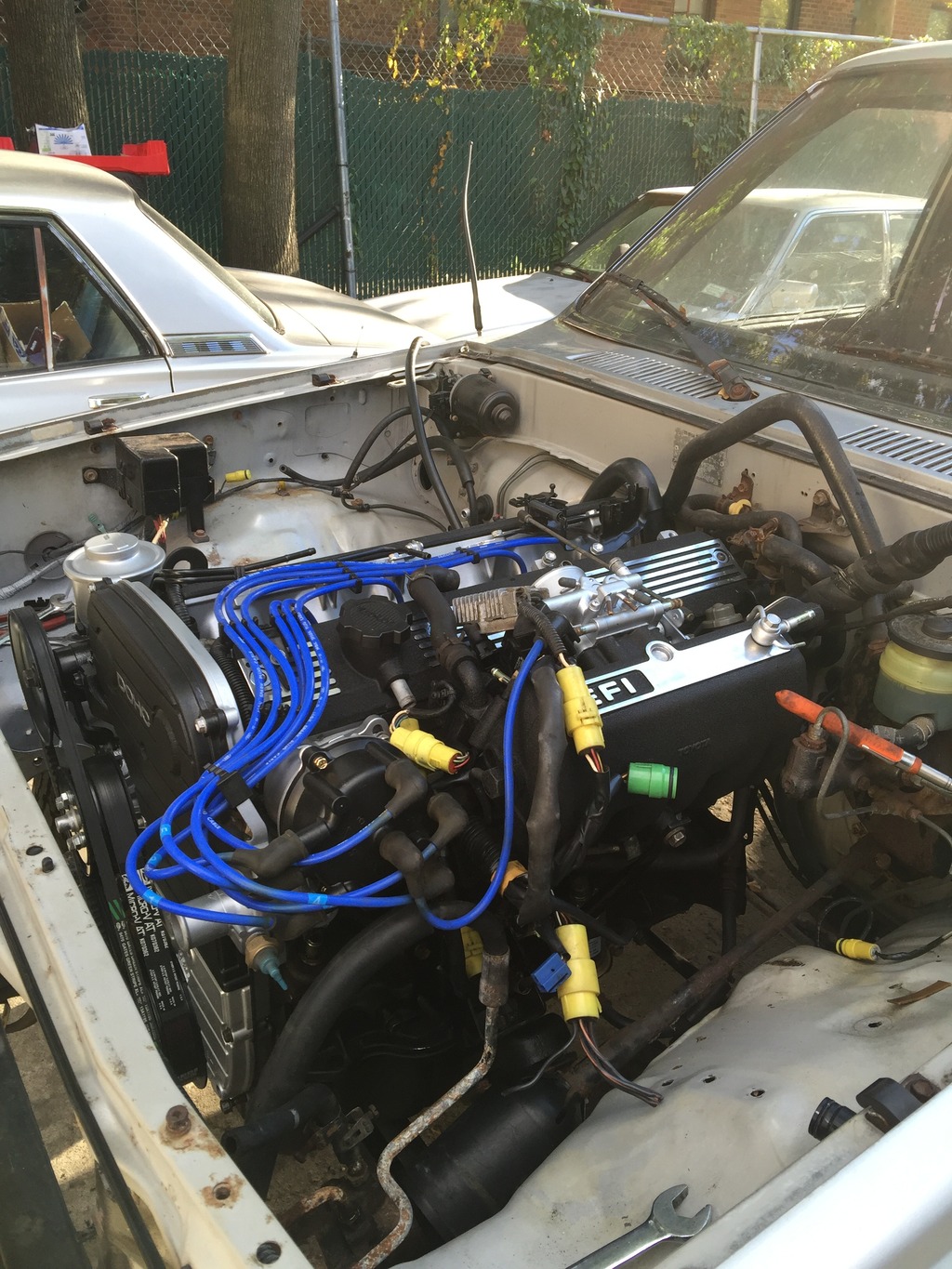

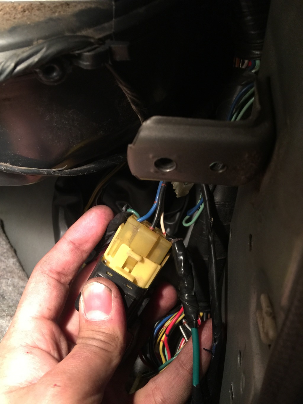

I needed to tap the AFM FC wire from the Cressida C1 connector to the green wire on the COR. And splice a start signal to the black wire to the far right. (the one on my pinky finger) I thought maybe the truck wouldve already been wired like that but I tested i with a test light and that was a negatory. No big deal.
I didnt take much pictures while I was working through the wiring. But I did take a video explaining most of the wiring I did. Which I will be uploading soon. One thing I did notice was an abundance of pieces of insulation on top of the heater core when I removed the PE center vent to access some wires. Which I quickly guessed was a mouse nest. It had three dead mice in it. Ewww. So I was convinced they had to have made a nest in the rest of the heating circuit. Being that I was already balls deep into the dash it was a good time to pull the vents and HVAC units to clean them. I had read a thread by Terry87 a few months back on cleaning a 84-88 HVAC system. Which I read out off curiosity. Read it again last night and tackled the system this morning 12/13/15.

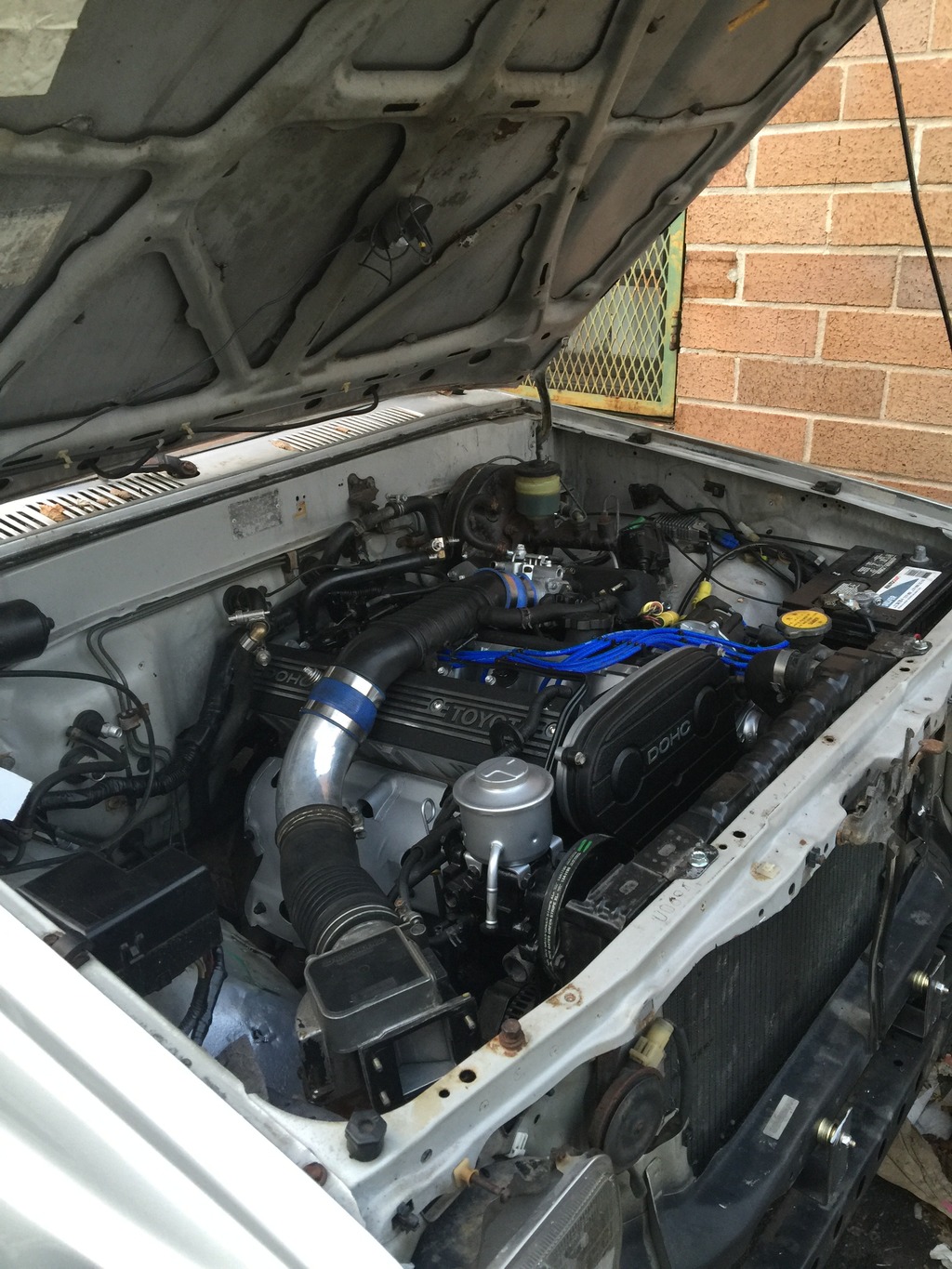

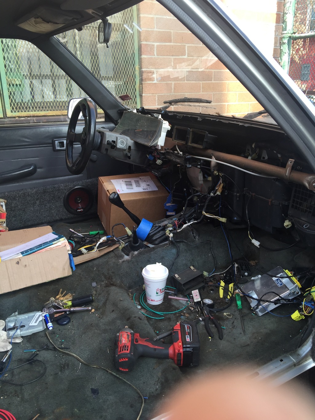

How I started the morning off.
And some reference photos to remember how things were connected.

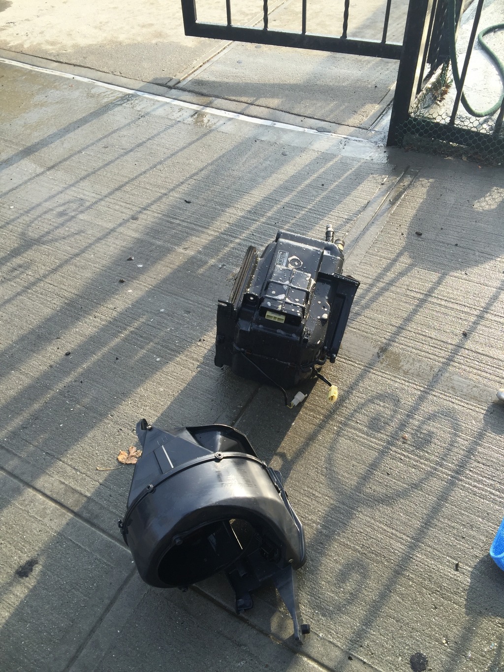

First off I started with the AC unit. I already had all the lines under the hood removed. So it was just the matter of removing the bolts and sliding it out. Followed by the blower unit. After verifying which blower resistor I have. (4 Pin) I looked into the heater core housing and there was nothing in there so that was a good thing. A/C unit was also clean as was the blower housing. I took the blower motor out and washed the whole housing as well as the AC unit. I also used this opportunity to take all the vent shrouds, dash, and all paneling and wash all the dust and dirt out on them and in them.
At this point a few of my friends came by and I wanted to try to start it when they came by. It fired on the first crank and quickly shut off. I tried it again and it ran steady. I didnt run it for too long as I didnt wire the fans or put coolant in. Nor was the coolant gauge wired. So I started to assemble the dash.
And ending with this for the day. My friend wired the fan relay for me and the fan while I was assembling the main interior bits. Tomorrow if I can get up early enough I will be taking a look at a small fuel leak I have at the pressure line where I spliced the rubber hose. Adding coolant, maybe wire the temp gauge if I wanna take a guess. I have a EWD manual coming later in the week. I just wish I found it on ebay a few weeks ago.

Ill update this thread in a day or two with the wiring and the progress. The wiring is actually very easy if you already have a EFI motor in it from the start. I have a bunch of progress shots I didn't upload. I actually started driving the truck two weeks ago.
Some people say you can get by with a inch body lift. Corax did his to make his radiator clearance better. Since I mated the Trans to the engine with the engine already in I needed a bit more clearance. I could've prob did a 2 inch body lift but I went three inch since I had mostly everything disconnected anyway and was already doing a tilt column swap.
The top mounts of the supra rad were beat flat and screwed into the top support and the bottom was the supra mounts with flat stock bent and welded then bolted to the lower core support of the body. I could've did tabs from the frame. But with the body lift I didn't like how long I would've had to make them to work.

Time to catch up on updates from the last few months.
As for the wiring. I didnt take any pics of the diagrams pinouts I made since they were crudely drawn. Some of the plugs on the truck side will slightly differ as my truck was originally an automatic 22re. Also the engine harness for the 5M will differ depending on the car it came out of. 83-84 Cressidas would have different plugs. And somewhere between 85-86 some plugs were slightly different on the Cressidas. So far ive seen the 87-88 Cressida engine harnesses are wired the same. 82-86.5 Celica Supras will have a different harness. The 82 being the most different one. But once you find the functions you'll be fine. All I did basically was match the Engine harness wire functions from the 22RE to the ones on the 5MGE utilizing all the trucks original fuses. I didnt want to do any additions. I took a video originally for my own documentation but I decided to upload it if theres anyone that could find use for it. A lot of the older writeups on these swaps say its the same as the 7MGE. It is to an extent. Basically the SupraCharged 7MGE/GTE diagrams are correct for the 5MGE. The functions are the same, But the wire colors are different. Once you connect those basic functions the engine will start minus the gauges. My video will give you a good idea on what to do. The only thing I wired after the video was the speed sensor wire from the truck's chassis harness to the engine computer.

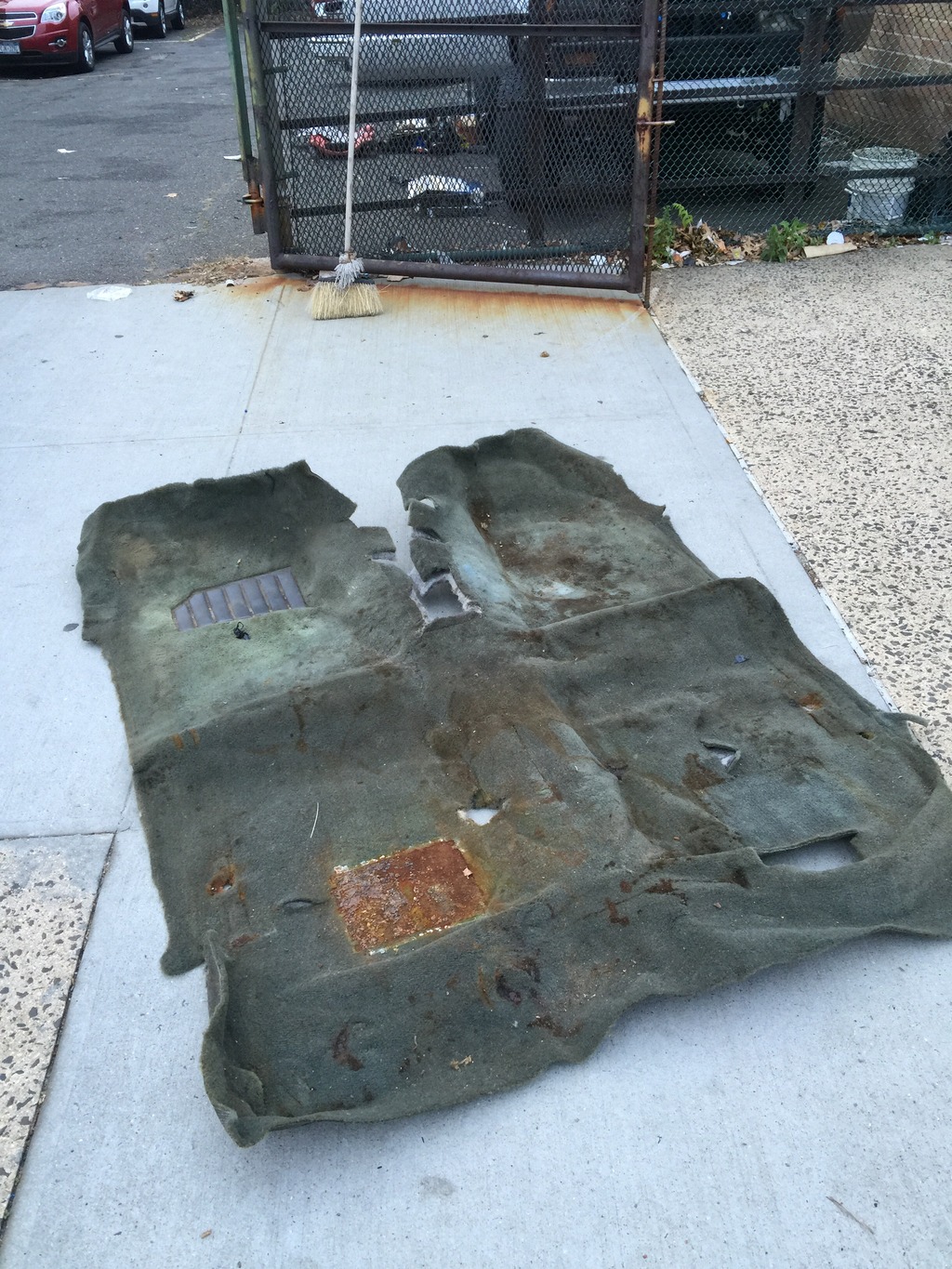

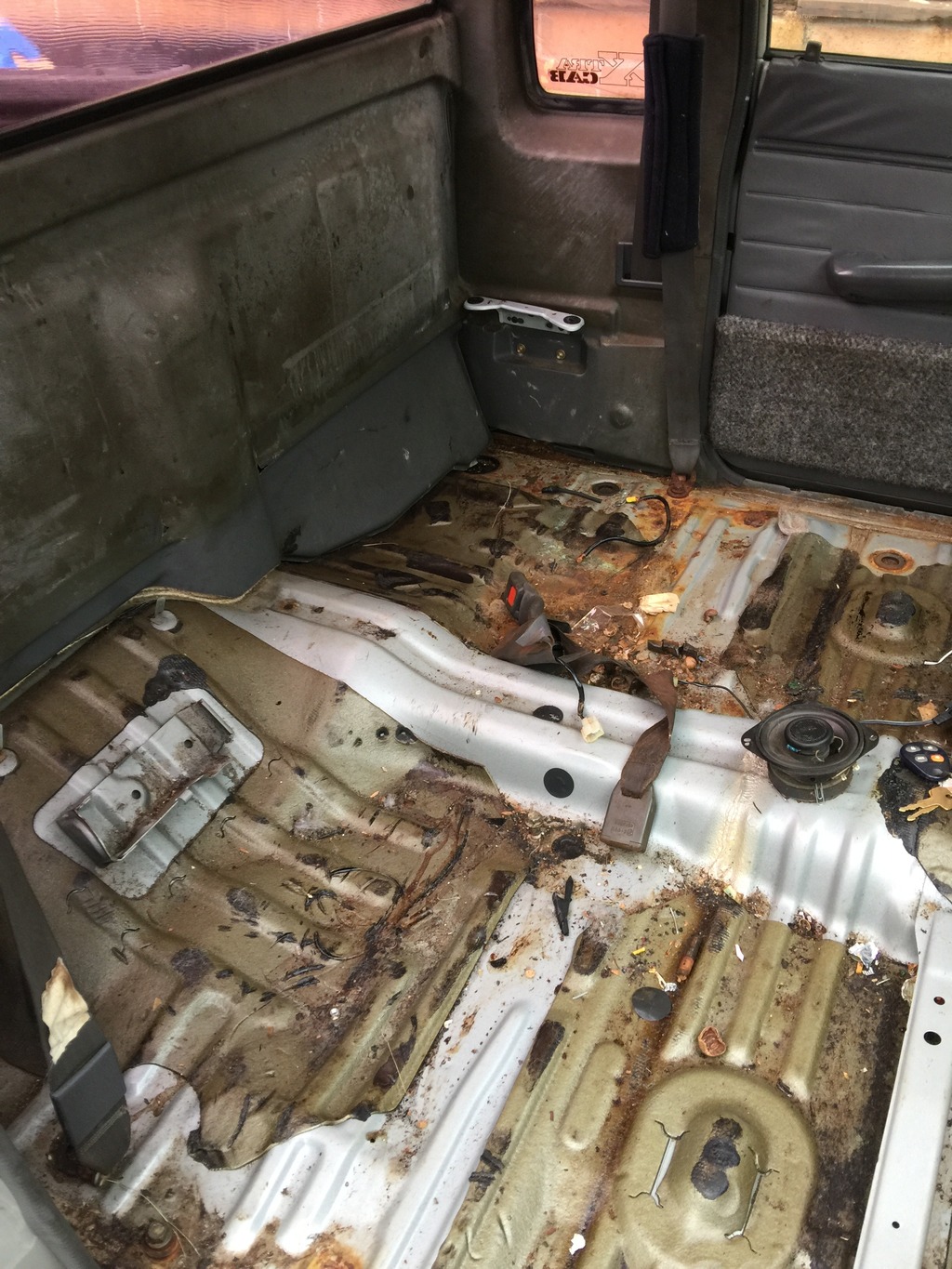

After I got the truck running, I tackled the carpet. Being that I found a mouse nest in the truck that meant the carpet and floor had to be cleaned. I removed the carpet and took it to work and powerwashed the life out of it. When it warms up in the spring, I will be removing the carpet to be redyed and the interior plastics repainted.

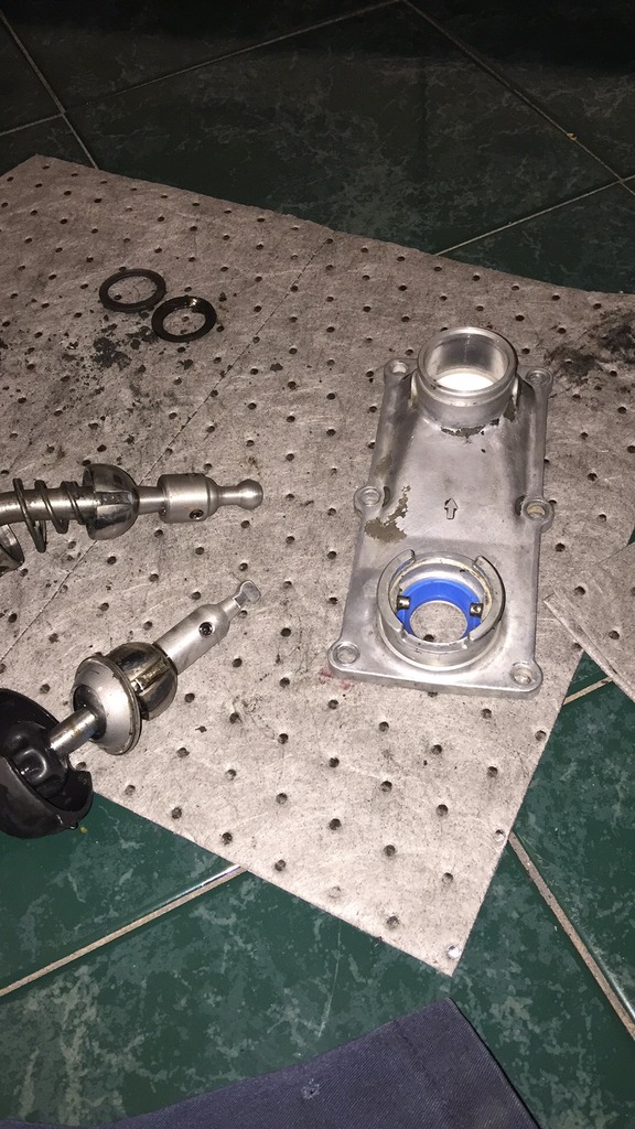

After that was taken care of, I found out that the W56-C I had put into the truck turned out to be bad. It popped out of first gear, and third gear would engage at all. So I ended up finding a tranny on craigslist a few days later. The guy said it came out of a early 90's truck 13 years ago with about 100k on it. I assumed it was another W56-C which was what I wanted so I can use my LCE short shifter. Turns out the tranny came out of a mid 80's 22R truck so it was a G54. No biggy, went from $450 to $60 and I took it home. Since the guy was gonna toss it if I didnt buy it and he just wanted it out of his way. I then brought it around the block and borrowed a friends lift and did the tranny swap with a buddy. Took about two hours with us taking our time. I didnt take a pic during the install since I was busy. But I did take the time to install the 15x10s on 33x12.5 I bought last year for $100. That I did take a picture of.
With the driveline sorted out, it was time to attack some other minor things to get it roadworthy. At this point, we were expecting a hard blizzard to hit NYC that saturday and the same week, the Wednesday I got into an accident with my '87 Maxima I adored. So now I needed to not only drive this during the blizzard, I needed it to be a daily driver. So I installed my Hella E Code housings with 6000k HIDs as well as the grill.

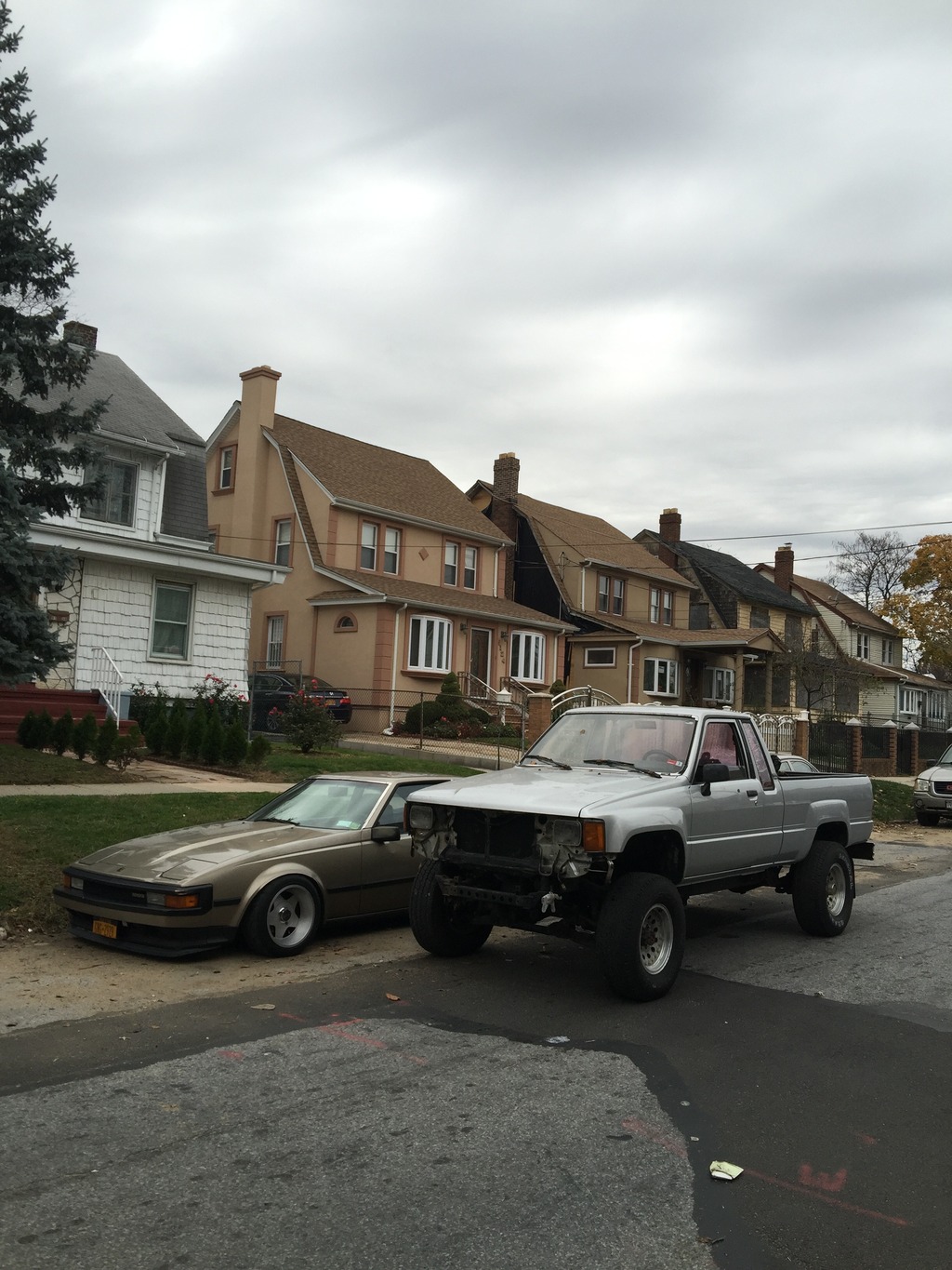

Then the next day the blizzard finally came. And I couldn't wait to test out the truck. Despite the tires being on their last legs the truck performed excellent in the snow. Made it to work the night of for the overtime spot. I spent the early day driving the truck around to make sure I wouldn't have any hiccups.
After running around with no air cleaner for two weeks. My other buddy gave me his old school ToySport intake with open element filter off of his 87 Cressida since he's going to 1JZ swap his car soon. He took my intake piping for the time being to move his car around. I will be pulling the intake off at a later date to blast and repaint either black or silver.

Well being that the truck ran on three cylinders when I bought it, it's wayyy better than the 22RE. Going off of memory from driving my buddy's 85 4Runner SR5 five speed, I don't see myself downshifting as I would with his truck. Torque is way better. I've also owned a 85 Celica GTS 'Vert with a 22RE and 5 speed. So I know how those motors run out of umph on the higher gears. Even with the 33s I have on the truck I don't have any complaints with the power. I haven't decoded the diffs on the truck yet. But I don't feel like I have to regear for daily driving.

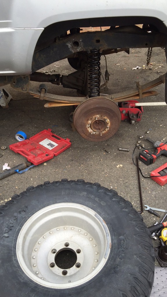

So two weekends ago the weather was in the low 60's so I decided to finally toss in the "lift kit" I had collecting dust for awhile. I ordered 14 inch 100lb Black Magic springs with a set of Rancho lift shocks and a 1.75 inch BJ Spacer kit with diff drop I bought off a guy on Craiglist.
Cutting the steel stopper short to slip the springs in. Was able to slip them in with a long flathead and a big prybar my friend held for me.
With just the rear done.
Pass side with 1.75 BJ spacer and left side untouched.
With the front and rear done. No torsion adjustment.

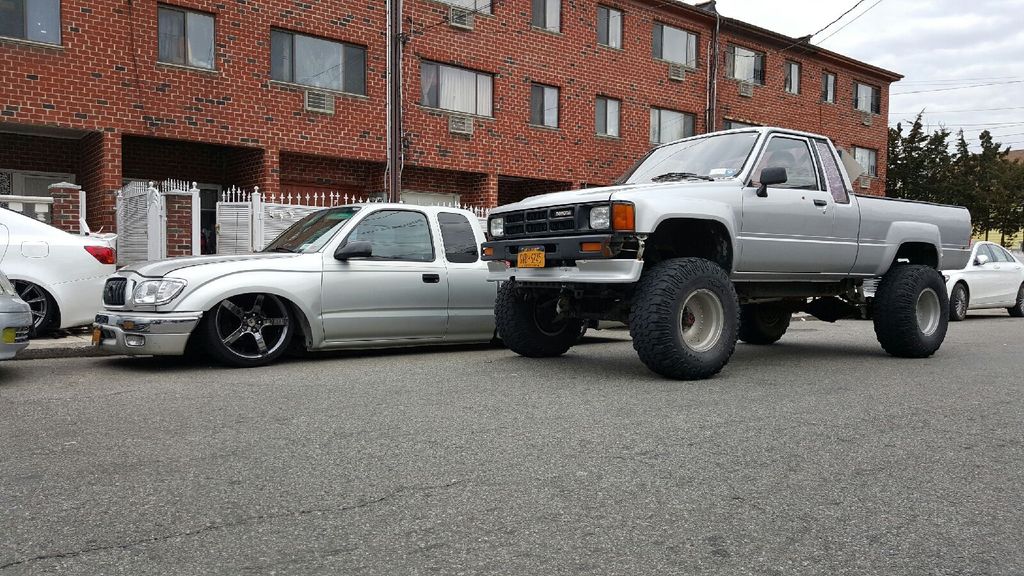

And later on the Sunday I stopped by my buddy's to take a pic with his Turbo Taco on air ride.
