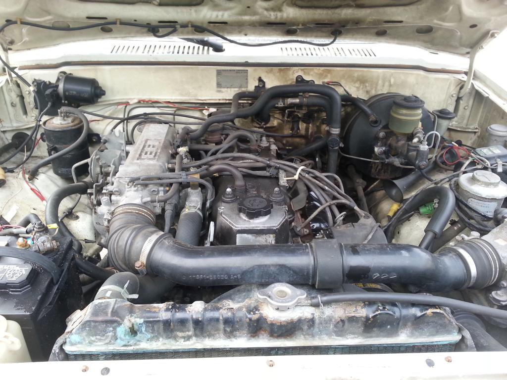

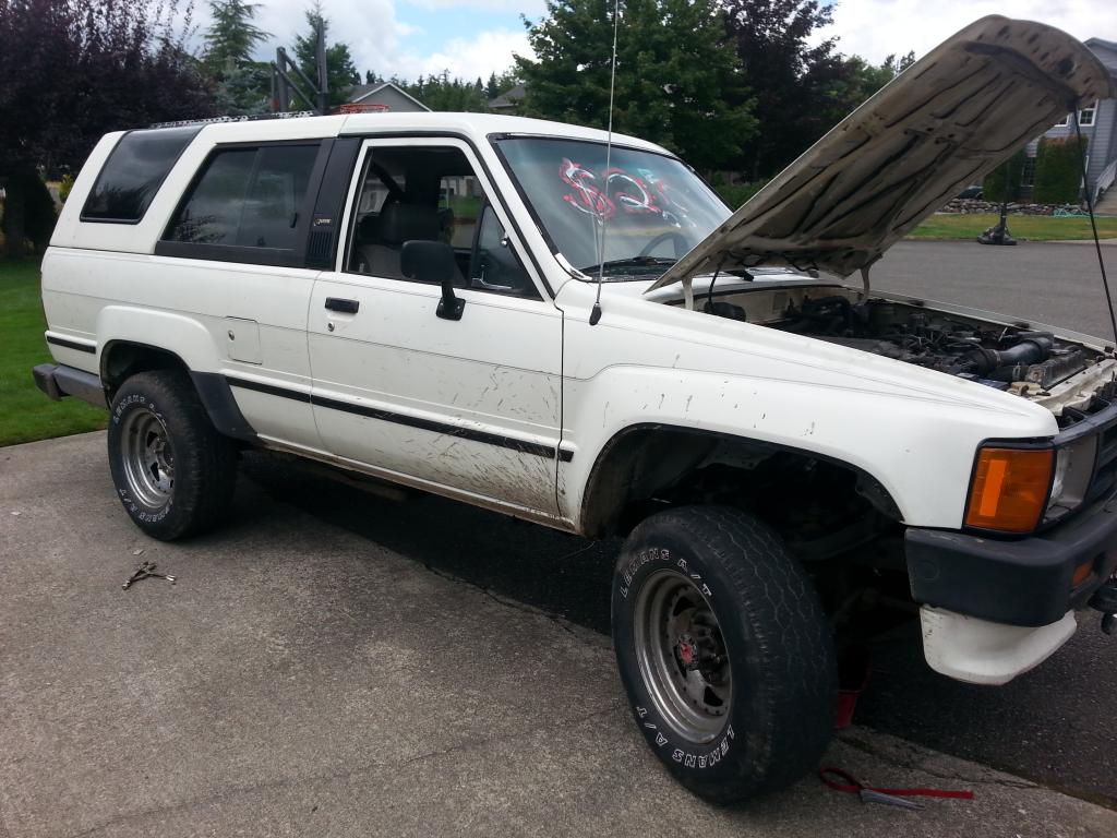

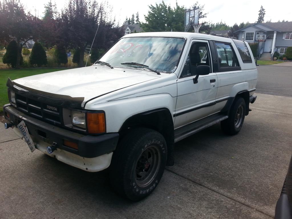

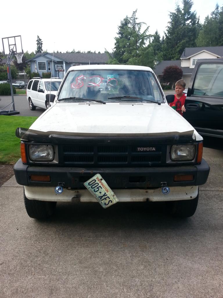

Well hey guys, been on yt for a while now, and I bought my first Toyota this July, a 1986 4runner! My neighbor has and 87 and an 85, and that's what got me hooked on the 4runners. I paired 1700$, almost all my summer job savings with 279,000 miles but supposedly 100k were behind his RV, also it supposedly has a trans out of a pickup with 150k on it, but who knows! When I picked her up the only things that worked were mechanical.. no blinkers, stereo, lighters, dash lights, horn, dome light, junky anti-theft system, among many other flaws. The engine burns a little oil, but that's what I expected.

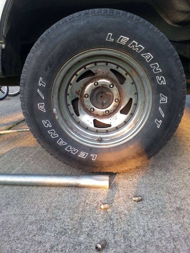

First step once I got her home was to clean her really good, and what better way then with a pressure washer hahaName:  20140723_165211_zps1g2jva6c.jpg

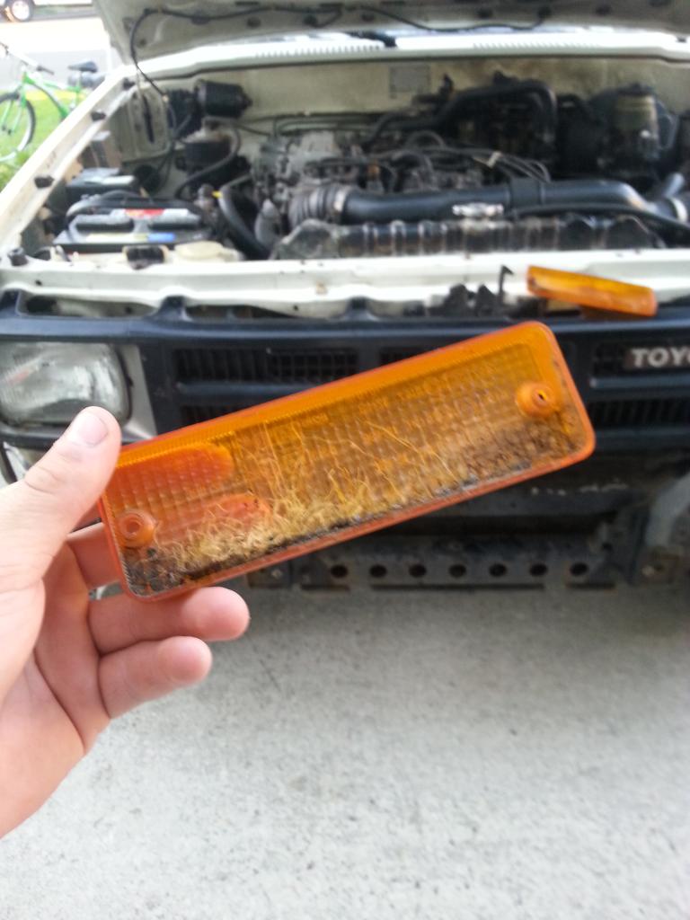

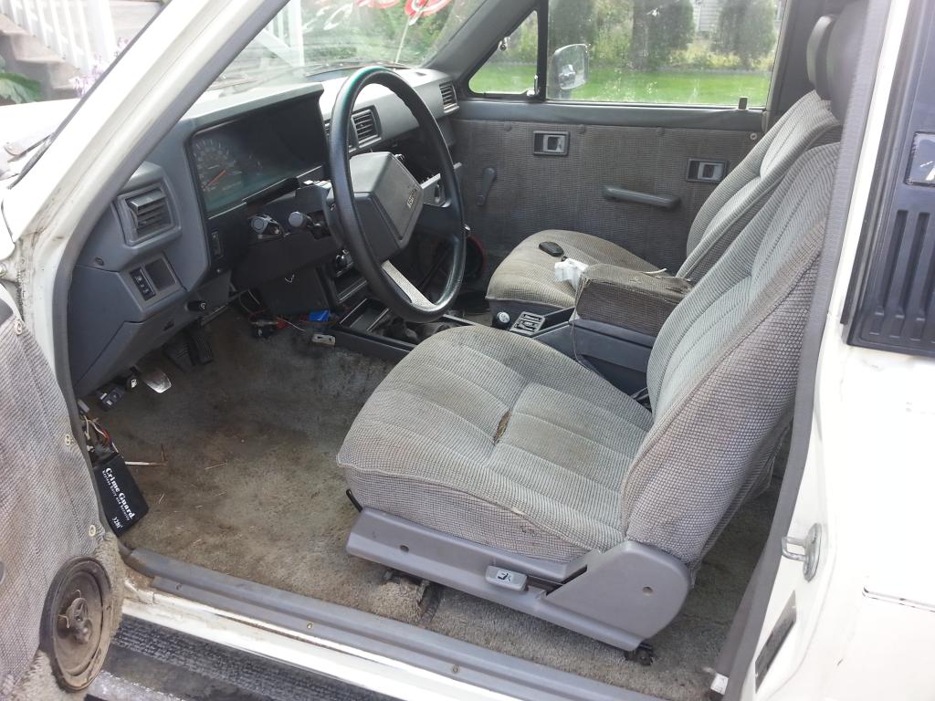

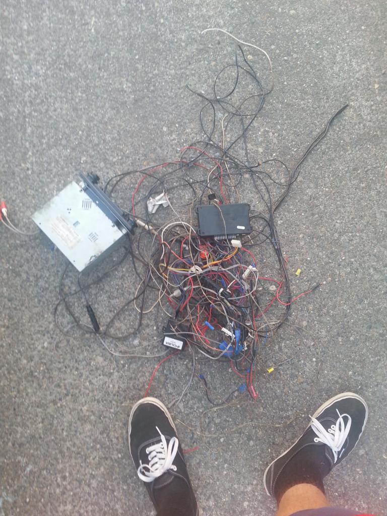

Size:  124.0 KBThen me and my dad got to getting the blinkers working and stripped out about a mile of old stereo and alarm wires Name:  20140726_195957_zps3e9w8blj.jpg
Maybe this is why my blinkers didn't work (too much blinker fluid?) Name:  20140913_185053_zpsjs5livrw.jpg

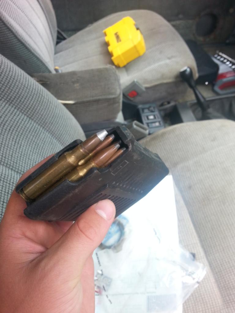

Also found the original receipt from the dealership 13,217$!, and a .308 loaded clip in the glove box Name:  20140726_153840_zpslv8mda3k.jpg

Then after trying to kill myself with exhaust fumes, I decided I needed some new exhaust! CJ's Custom and Exhaust does a great job, off canyon in Parkland wa

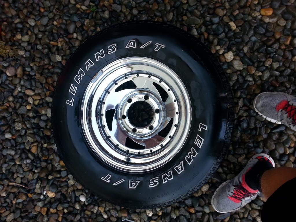

Got that working so I polished up the wheels
Before:
After:
Wire wheel and some bleach did the trick!

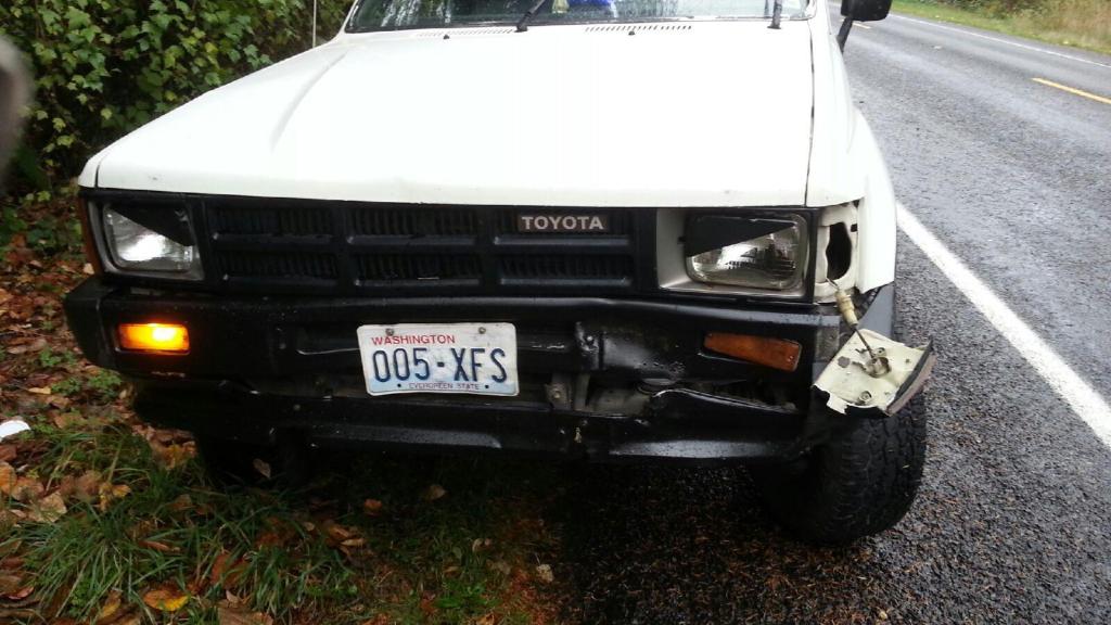

So in doing what 17 y/o's do, I ran into a ford and buggered up the front of my runner...

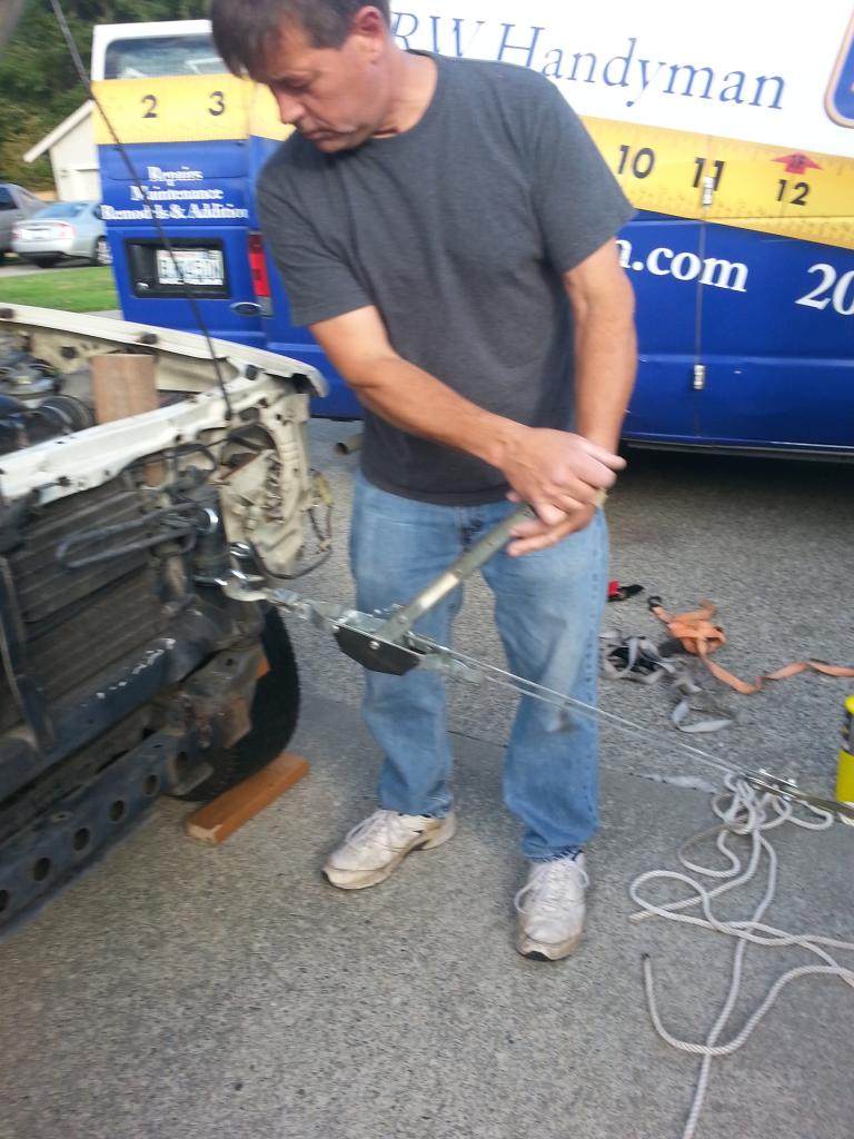

Pushed in the whole front right corner close to 3 inches from the left, bent the hood a little and broke the radiator from its mounts. I didn't even have to order new lenses as I didn't crack anything, lucky me!
Oh and did I mention that I did this on my way to catch the bus for my high school football game? haha, still made the game! Name:  20141019_154014_zpsc8vuy8hj.jpg
So me and my dad used a come along attached to his chevy and to an I-bolt on the other to pull the corner out. I ordered a new bumper for like 35$ online and a bumper bracket for 45$ and I was back on the road!

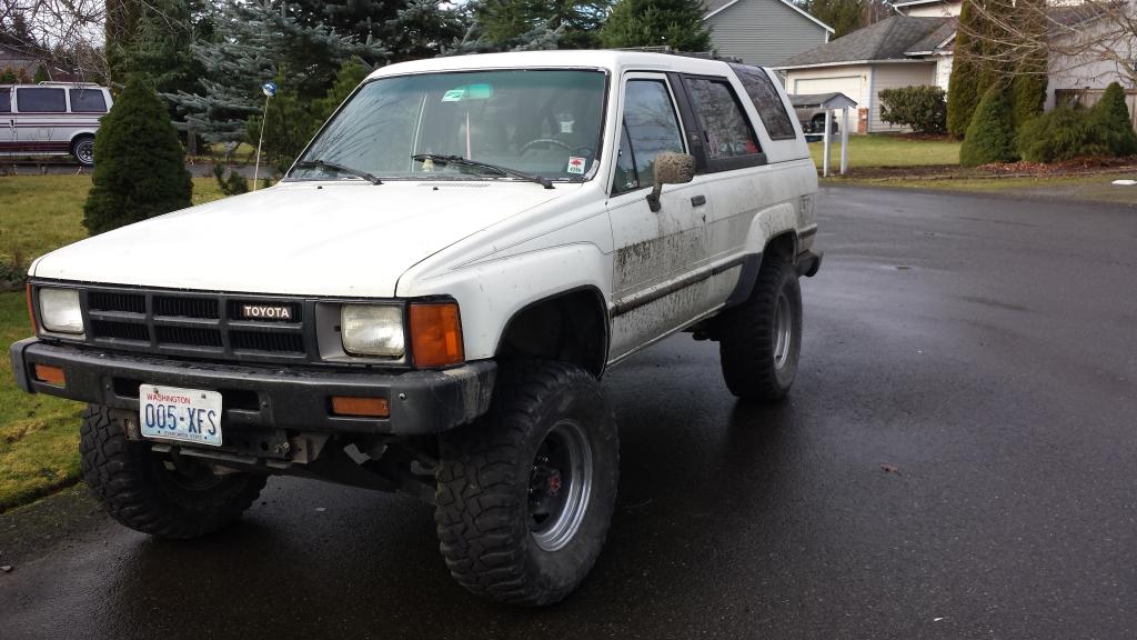

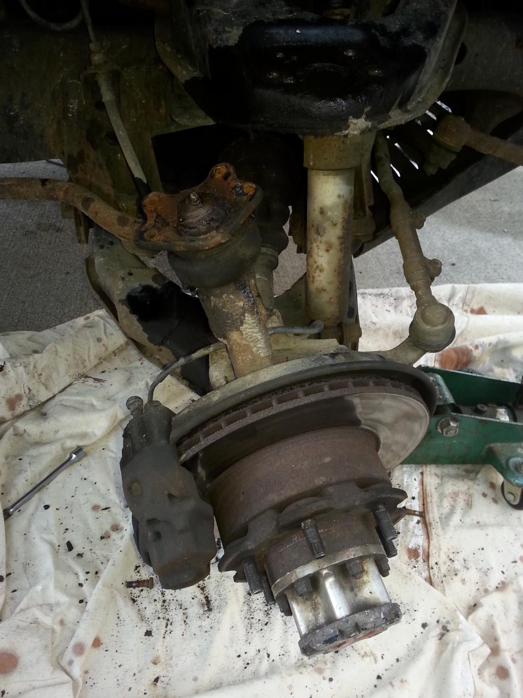

Then, last week I installed 4crawler's ball joint spacer, diff drop and sway bar drop.Name:  20141214_124421_zpsinobgidg.jpg
Before taking the wheel off, put a space next to the bump stop or else after the spacer, you will struggle to get the uca back on.
Remove the upper chock mount and sway bar.
Remove studs, and trim the uca to fit the spacer (see 4crawlers instructions) and re-assemble
Fairly easy project done with basic mechanical skills. only special tool needed will be a cut off wheel or angle grinder to cut the uca. Make sure to get an alignment afterwards!
No complains so far after alignment!
Got some new-to-me 32x11.5x15's installed and couldn't be happier!
I so far have taken the runner out snow wheeling twice and after being out wheeled by my buddys Subaru with studded snow tires, I have quickly learned that I need a locker and maybe a wench. I'll have to wait till summer because with school and playing 3 sports, I have no time for a job right now.

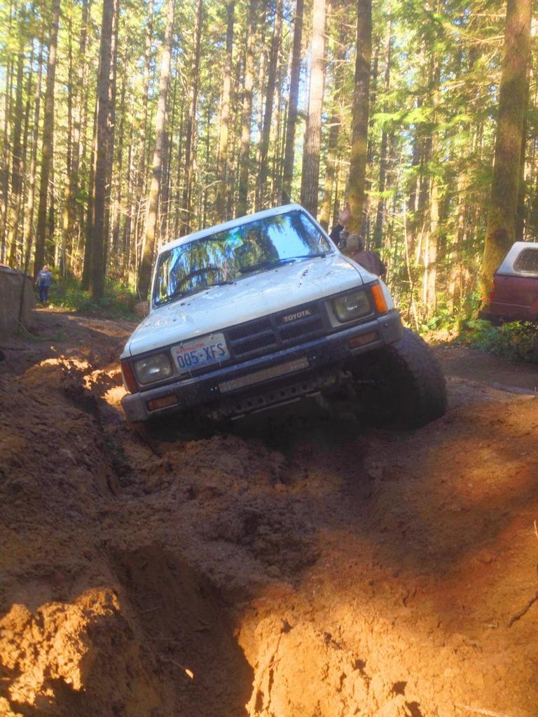

Took my 1st real wheeling trip and blew the headgasket about a year ago, this is Tahuya orv

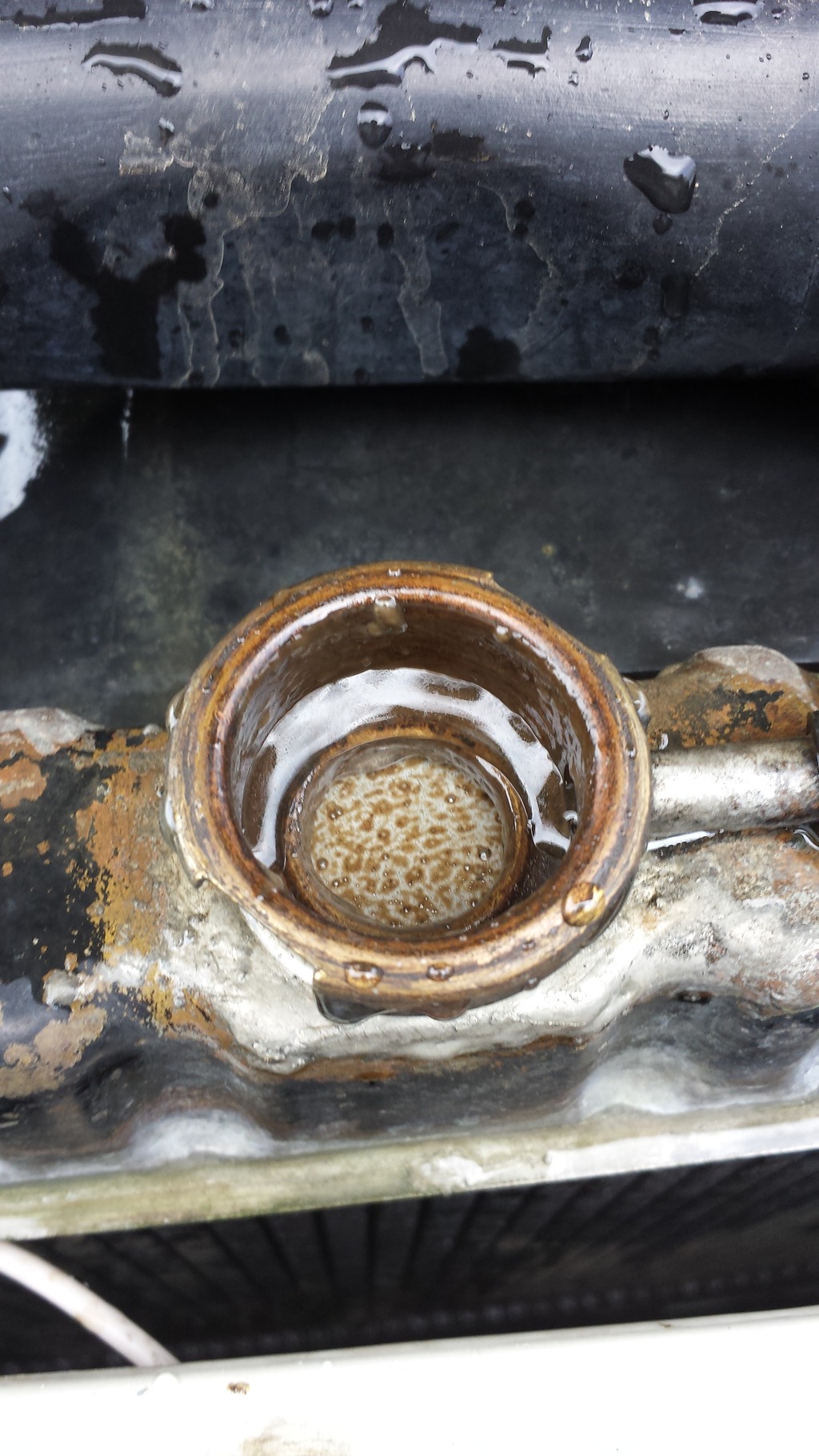

Came home and checked the oil to find this milkshake...

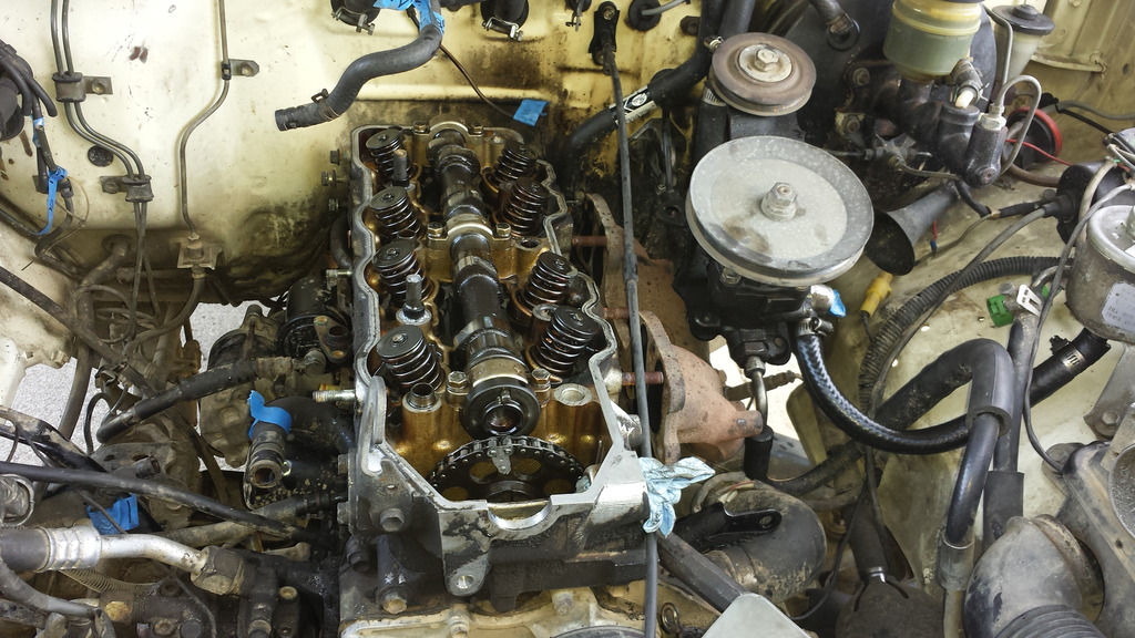

Me and my dad began to tear it down to replace the HG, and went to pull the head bolts and we broke 4... yes 4

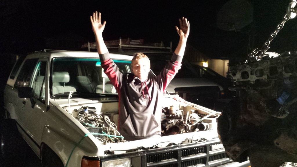

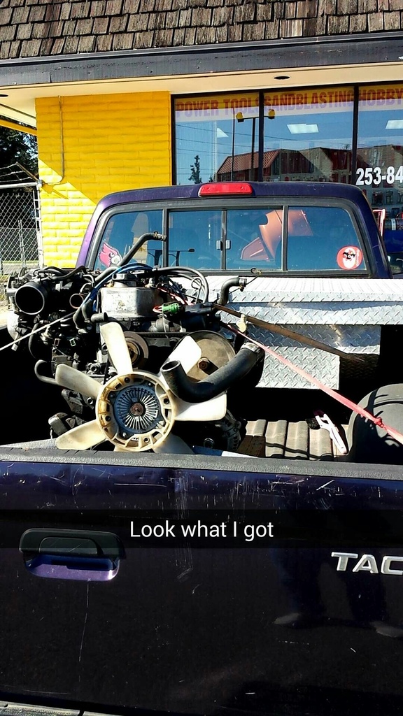

So we made the decision to pick up a used engine out of a celica, FYI motor mounts and oil pan will need to be swapped to the 4runner parts
Got back home and got to work! Man this was a good feeling!
Ended up getting it all put together and it preformed even better than before, im claming the Celica GTS engines got more horsepower
