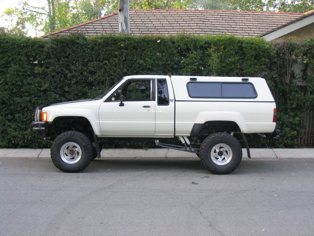

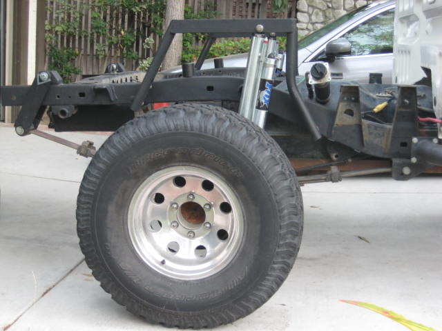

Hey Toyo! I don't know if you got to look over my Chevy 63" swap on my truck up at Pismo, but I have some opinions. First I don't think I would go that route again for my pickup. I would do a spring under Deaver pack such as the f55 or f67. However for a 4 Runner the Chevy 63 would probably be better because the added weight. For my truck the Chevy was too high a spring rate; even after removing the overload leafs. I found my particular setup was around 4" of lift and that was too much as I only wanted 3". I flipped the shackle to the top of the frame that lowered it some as well as improved some other characteristics. I also took the middle leaf and cut it down and relocated to the bottom. I got the height about right and the spring rate is decent; but its not very progressive. Another downside is a spring over will suffer from excessive axle wrap and wheel hop. I noticed that from the get go even with overload leafs. I played around unsuccessfully with traction bars. I did find a solution but don't want to go into it now as its something I am developing. Suffice to say I have been modifying the Chevy 63 set up for the past year and still trying to get it optimized. The pictured set up at full droop to the point where it goes flat will yield about 12" of travel. I still have room to grow as my shocks are 14" travel. I am considering replacing my 4.5" tall bump stops with some 3" tall ones and letting it go into negative arch. I suspect this will damage the spring so not sure this is a good idea? I will to do a write up in the next few weeks.

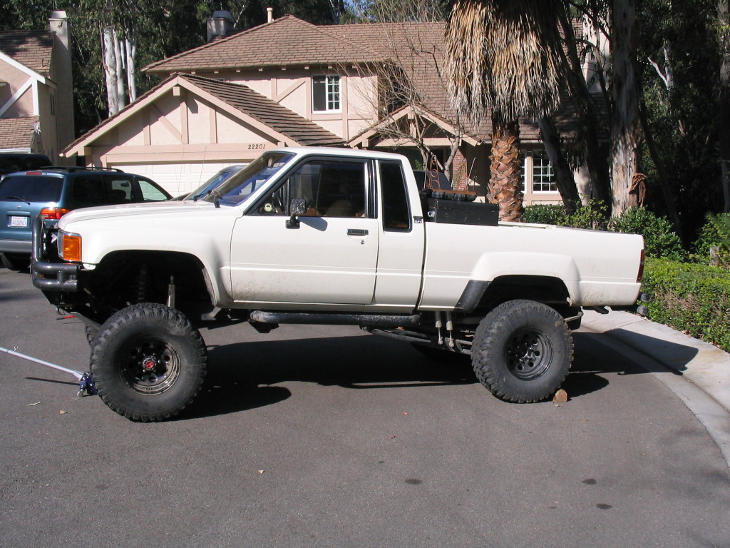

You know, after I wrote that post about the "Daily Driver" I looked it over on the Giant website. Your right, that thing wouldn't work in the 4 Runner, not sure what I was thinking? When I was in the shop I looked at the mock up and the two rigs under construction and was thinking about my old Pro Comp Track Bar set up that used really short shocks and was't cycling 22" of travel. What I had on my truck back in 2002 was sort of a joke but it evolved to something decent. It all came off when I installed the Chevys a year or so ago. The original configuration from Pro-Comp used some shocks that were something around 6" of travel. But it put the shocks mid way up on the traction bars at a steep angle. The shocks mounted up behind the cab and you still used the main shocks! Three shocks, crazy! Later on I moved the upper bracket far up into the bed as possible (within the 2" body lift) at a less dramatic angle. The shocks had 9" of stroke but this geometry got 10" of travel with Downeys Kicker Shocks and bump stop bracket. When I removed the kicker shock assembly and went with lower profile shocks I got 12" of travel. The traction bars and kicked shock combination was super stable, the thing launched like a dragster and even had decent articulation. I did miss them a bit, but an additional 2" of up travel with progressive bump stops made a little wheel hop acceptable. The dampening was poor and the track bars were tearing themselves apart. Cracks in the welds and the bushings ruptured and couldn't be replaced anymore.

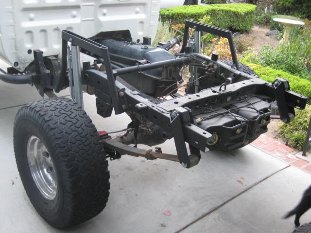

Sorry I'm running on! Back to your 4 Runner. Your currently getting more wheel travel than the stroke of your shock. On my 4 Runner before the 6" of lift that was my problem too. I now have 6" of lift but three of which is blocks. In my case, the blocks, and lift from shackles and mini-pack, allow a 10" travel shock in the stock mounts. But, I was using every inch of the 10" travel shock. So I mounted a 14" travel shock outside the frame rail. What ever spring I end up putting in there now it should handle it.
I think for the Chevy springs you will need a minimum of 12" travel shocks. That is going to be the tricky part. I don't have the answer, I'm just pointing out the problem. And the way you mount the shocks will bring up axle wrap issues. The dog leg configuration where one goes forward and one back is the obvious configuration. Anyway, points to ponder.

wow Nate, you have almost done it all. i have seen that shocks mounted like yours to help with axle warp before and asked the guy about it. he said it doesnt work. i wonder if yours does?? the shock install will be tricky to do if i want it to be mounted properly but i just need to get the chevys installed so i can see what i have to play with. you have given me a few things to think about tho.
maybe i can run two sets of rear shocks mounted two different ways. only a pair will be in use at a time. a set up made for DD and one set up for rock crawling. both sets will be on quick disconnect??? i think this would be cool

Well, what's on my 4 Runner is kind of a place holder right now. I don't know if you've read my build thread lately but here is the link. https://www.yotatech.com/forums/f199...l#post51632049
Basically I've just been driving it on the street as my commuter. It does have axle wrap but not any worse than with the dog leg shock mount. Most likely I am going to install All-Pro 6" leaf springs. My friend James (the 1992 white 4 Runner on my build tread) has this spring pack and some Kings both angle rearward and it seems to be stable. I don't know what effect having them face forward will have. He has a 3" body lift so he can get the shocks up higher. With mine no body lift means outside the frame rail angle forward. The All-Pro spring pack has 10 or so leafs in it so it doesn't wrap much.
I am guessing if you keep your Chevy 63" unmodified and run overloads your axle wrap shouldn't be too bad with the 3.0 motor. Maybe you could mount the shocks in the wheel well like I did. You need 3" wheel spacers/ adapters to do it. You may also have to hang the lower shock mounts below the axle but because its tucked up close to the wheel it doesn't hang up like it would near the middle of the axle.
