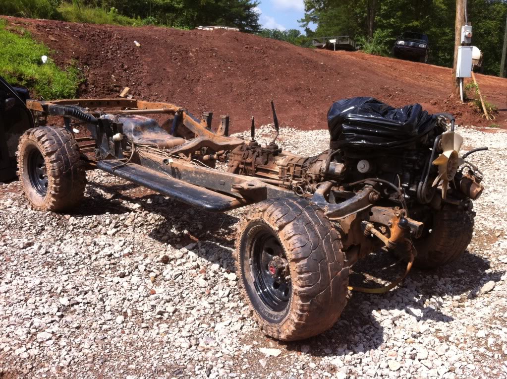

Update: 7-19-13

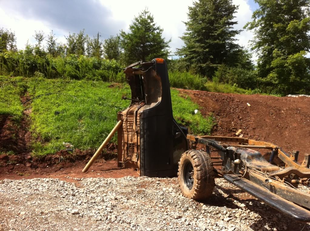

I was gonna pull the engine and tranny today however I changed my mind.
I decided to get my cab ready to pull instead. I started with the wiring which is really easy because my truck is a factory carbureted truck. So once the wiring was all unplugged I started with the 6 body mounts. Those were really easy since I just installed a 1" body lift a few months back. After that I unbolted the radiator and unhooked all the power steering hoses. Once that was done I unhooked the better part of the brake lines and clutch. Most of which I cut do to being rotted and what not. Once I was done which only took about 1 hour I called a good friend of mine to help me remove the cab safely. To remove the cab we laid 4x4's onto my rock sliders on the passenger side. We then picked up the drivers side and let it slide slowly down the 4x4's until the passenger side was on the ground. I then used the 4x4's to prop the body up while I pulled my frame out from under. Once done we laid the cab done on the ground then stood it up on its rear so I can pressure wash the under side of it which is extremely filthy
I do not have pics because it started storming like crazy when we finished. I plan on taking pics in the morning.

#31
Hmmmmm,...... I SWEAR is missing something..... AHHHHH, an antenna, yeahhhhh, that's it!
hahaha. ......
THE FUN BEGINS! Nice, Tboy
By the way that is a very interesting lot. I'm sure it's just gravel and high brick content Soil? Its just so freaking green in that first pic! I like it!
hahaha. ...... THE FUN BEGINS! Nice, Tboy

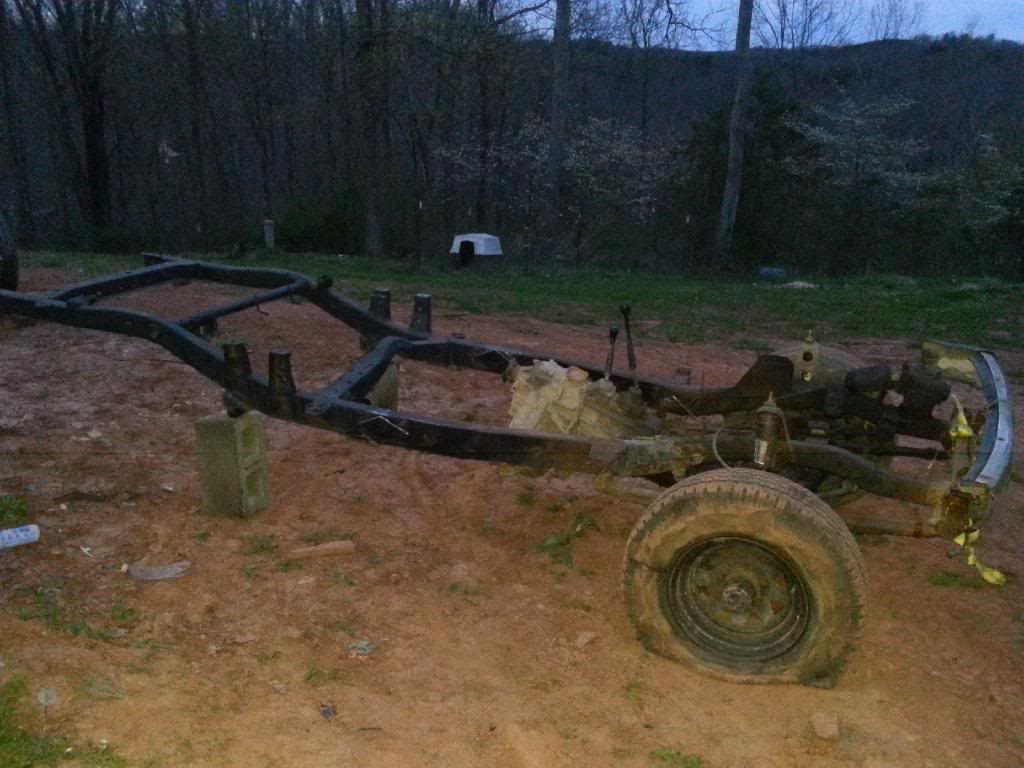

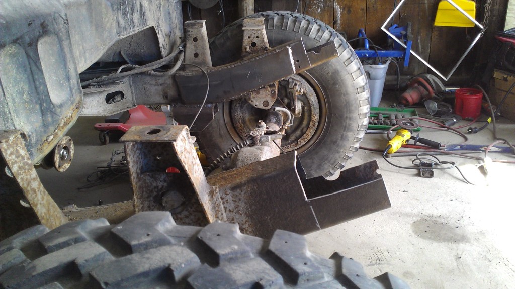

Its been along time since I posted here so I figured I'd give a good update.
I bought another toyota last week. Its a 1985 Toyota 4x4 SR5. The truck that I bought was a parts truck. I bought it from a parts yard for $200.00. So that meant know title. The cab has been pretty much parted out. No engine either. The chassis is 100% complete. The frame is severely rotted from the rear spring mounts back. The front of the frame is spotless tho.
So my intentions is to cut the 85 frame in half and add my 2WD frame to it. In return this will save me a ton of money and make things easier for me.
Now before people start to criticize me, let me explain some things. I am a WV certified welder. I'm very familiar with frame repair. Now I'm not just cutting two frames in half and welding them back together. Once I get my measurement instill then cut both frames in half at a 45 degree angle. Once their cut I will slide a peice of 1/8" rectangular tubing 12" into the 85 frame on both sides. Leaving 12" hanging out to slide the 2WD frame onto. Then I will weld my frames together. Once welded I will do some plug welds. This will eliminate the risk of my frame cracking under stress. I've done this once before on a old IFS truck I had. If I remember correctly 2x4 rectangular tubing fits great into our frames. You do have to use a hammer to get it in there tho. Its a very snug fit.
Once I get this done I will have a complete strait axle rolling chassis on stock suspension. Thus allowing me to transplant my 4.3 engine and mounting my 87 cab. Putting me that much closer to having a finished toy.
I have already stripped the 85 down to just a rolling chassis. I done that today. I will update with some pictures soon.
So what do you all think?

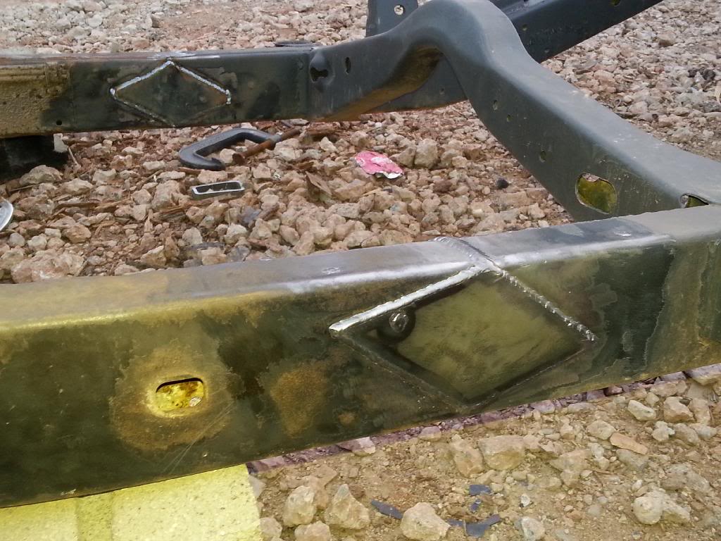

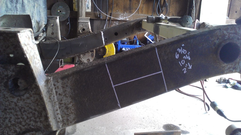

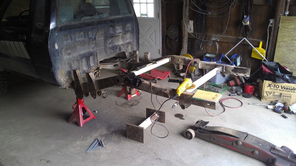

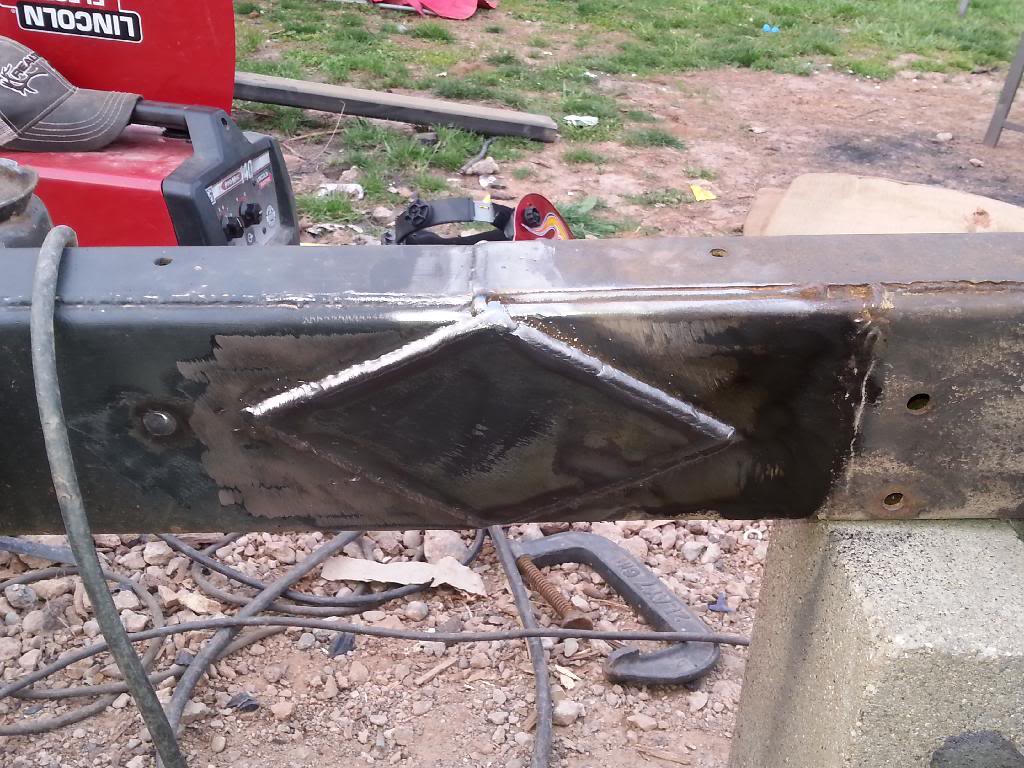

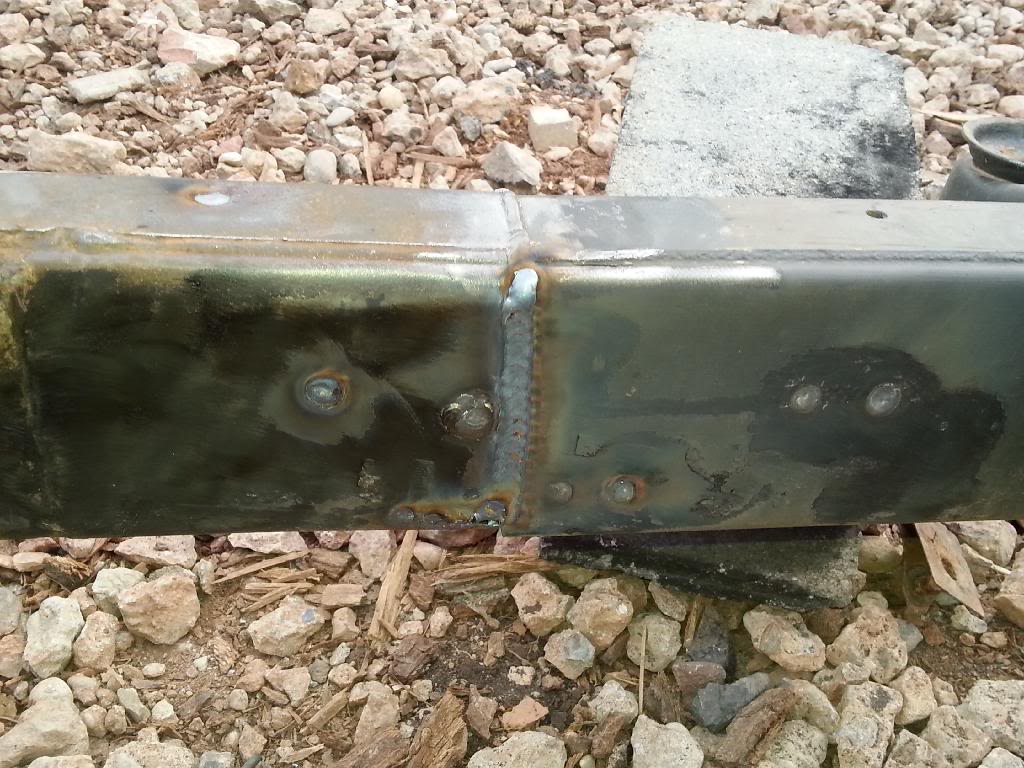

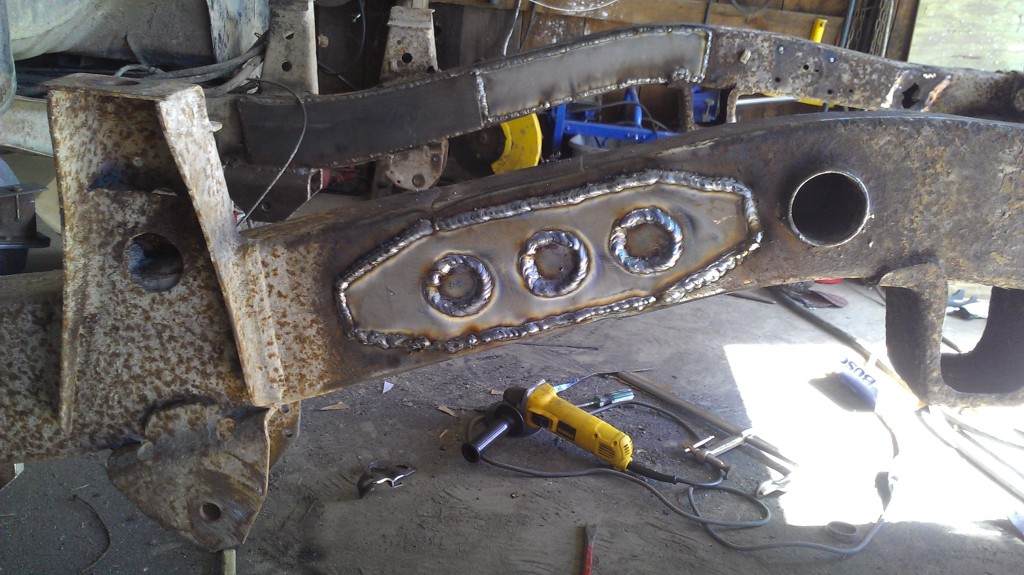

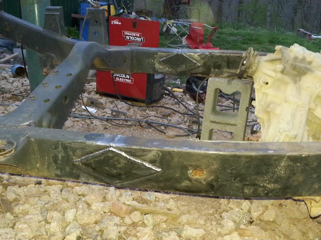

I know its been awhile since I fooled with this project so I decided to work on it some this evening. After thinking long and hard on it I decided to cut my 85 frame in half and just replace the rear section. After taking 100 measurements I made my marks and done my cuts with a angle grinder. Putting this back together was quite hard. But anyways after tak welding things back together I pulled measurements to double check that I was straight and level. Then I welded it up solid. I didnt take alot of pics but I did take a few.
Once the frame was cut I slid 2/4 square tubing into the front half 6" and left 6" hanging out to slide the rear section onto. Not only did this help hold me straight its also extra support in the frame. After sliding things together I welded them solid all the way around. Then I made a few punch welds to the square tubing. Once done I grinded my welds flat and diamond plated my frame on the inside and out. I don't think she will ever break. Do you?
