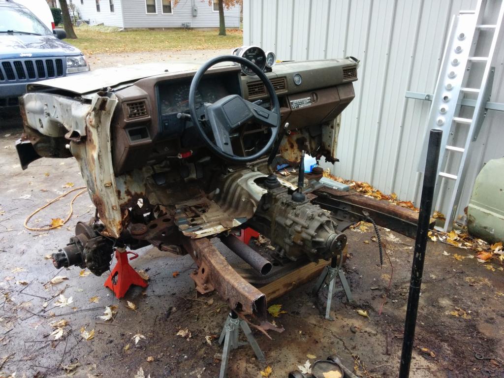

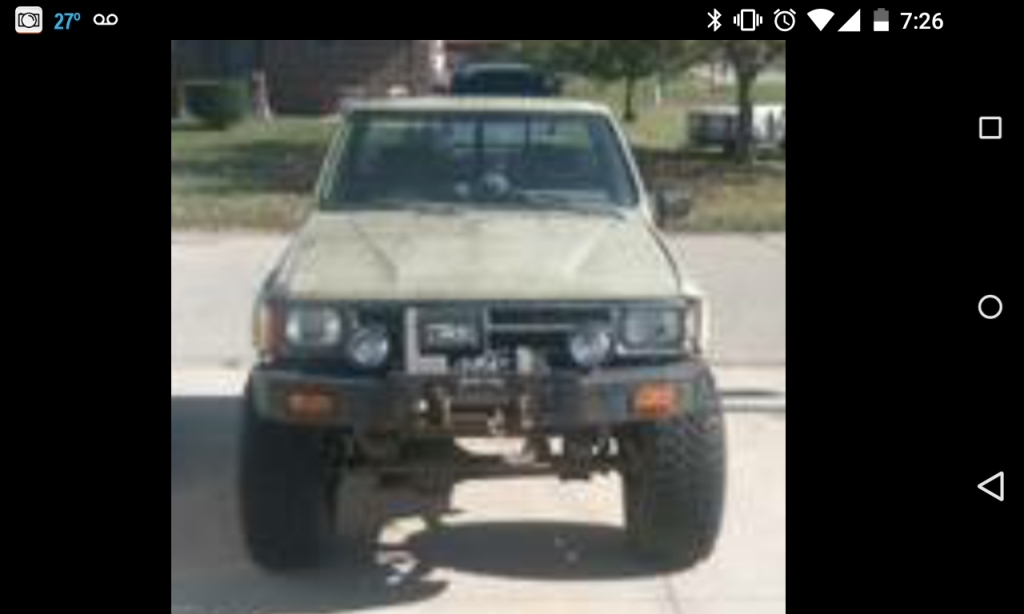

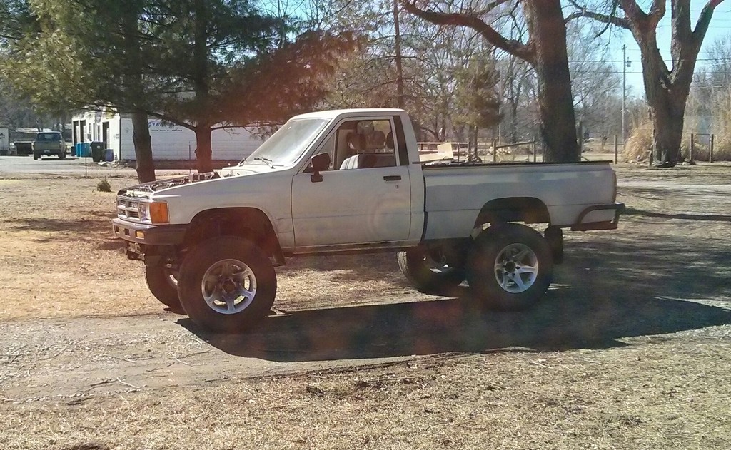

So I bought a truck that was advertised as a 87 with Chevy axles, in reality it was an 85 that was basically stock aside from lift springs and homemade bumpers The drivetrain was in decent shape but the body/ frame were beyond repair from rust damage.
The only decent picture before I dismantled it. Fear not though the 85 gave its life for a higher calling.

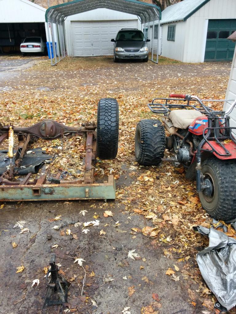

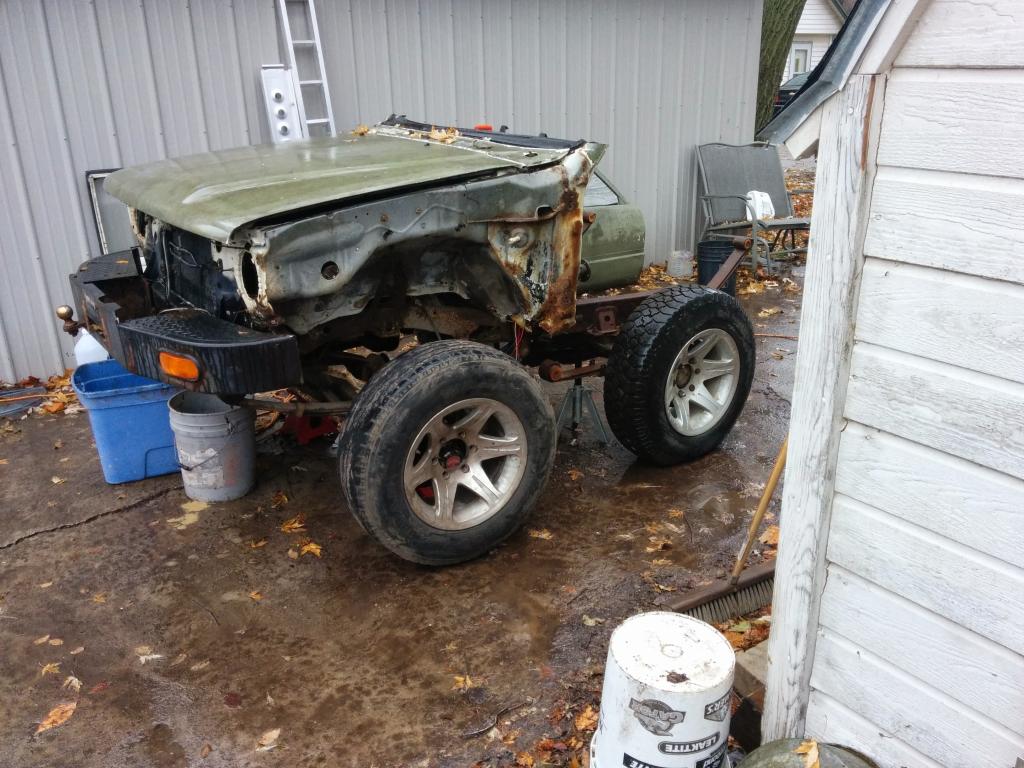

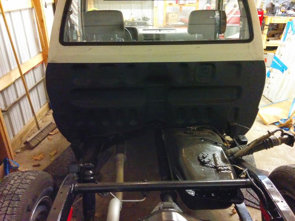

Before long I had scrapped the truck and kept the goodies that I needed for my build and anything else that hadn't rusted away. I built an axle rebuild stand from some sort of pipe holder dealio.

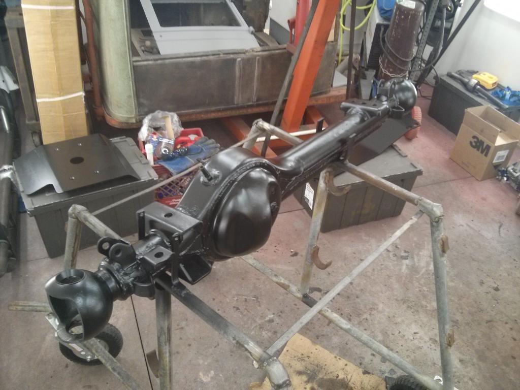

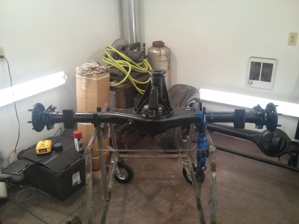

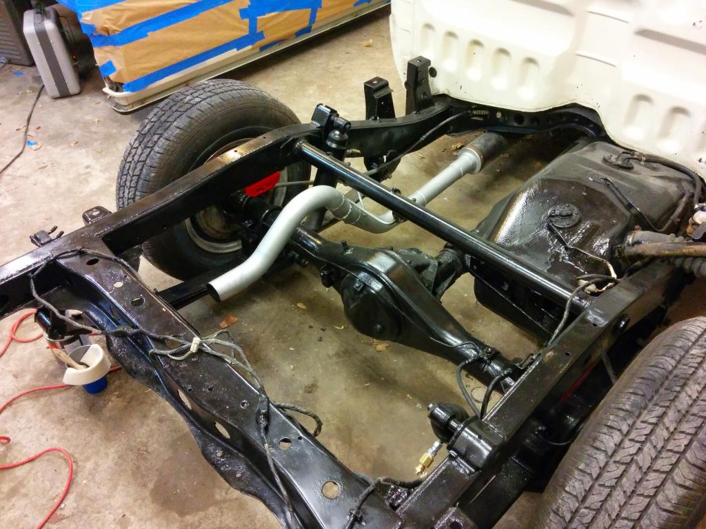

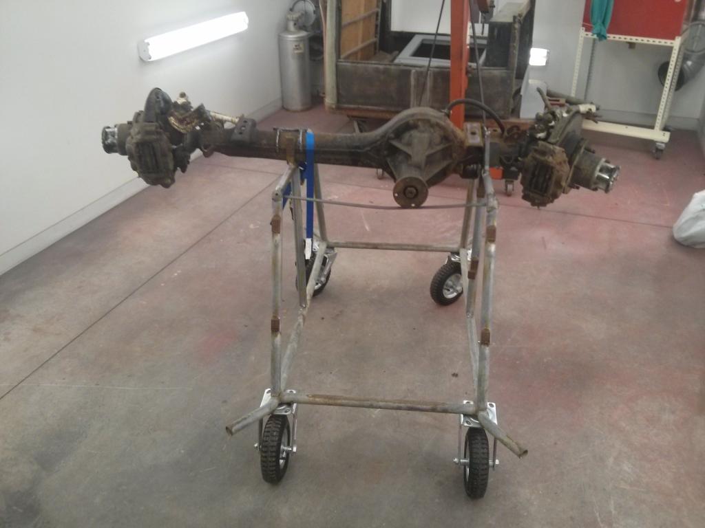

First I rebuilt the front axle.
Then the rear

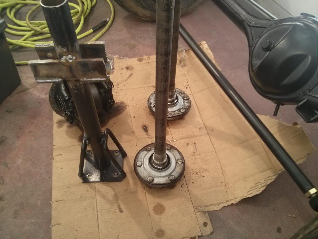

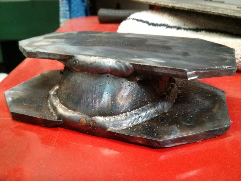

Made my own bearing press tool entirely from scrap. The bottom plate is a little thin but it was all I had in the shop and didn"t want to wait. It worked pretty good really. I replaced all bearings and seals in the axles except anything in the third member.

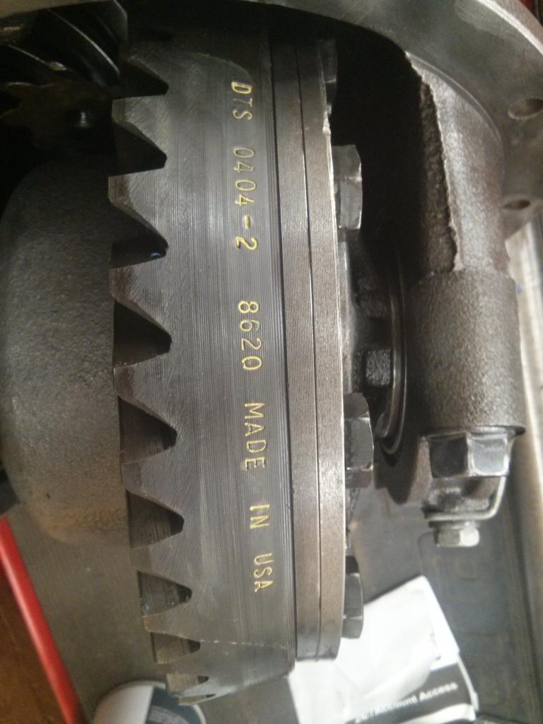

I should mention the 4.88 gears and detroit lockers I found in both axles.

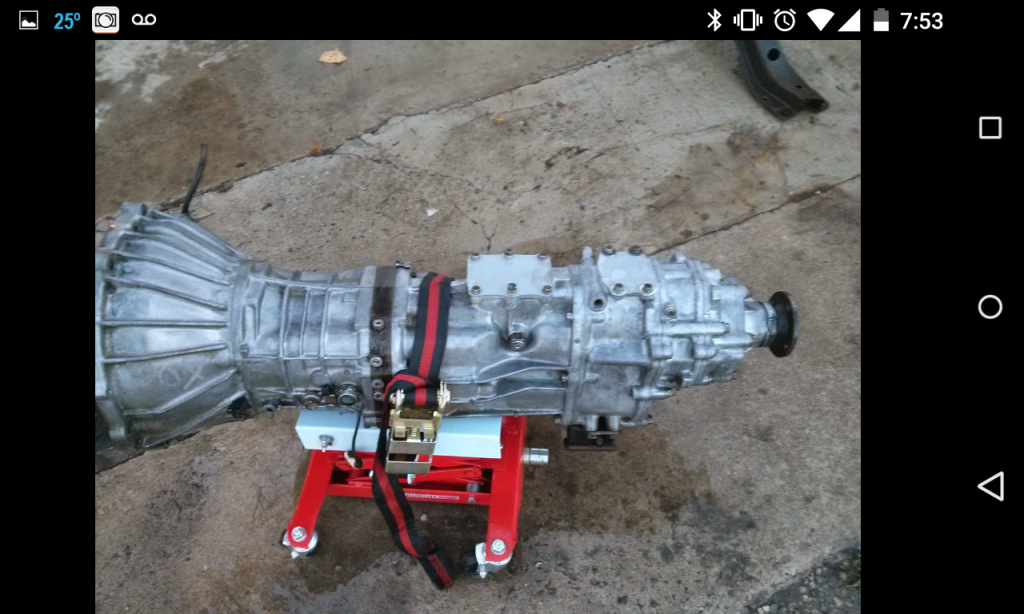

The 85 had a 87 W56 swapped into it at some point. Another bonus. I cleaned up the trans/ t-case did a twinstick conversion and changed the output seal while I was at it. Bought a Marlin HD mount and a budbuilt skid to hold it on the truck.

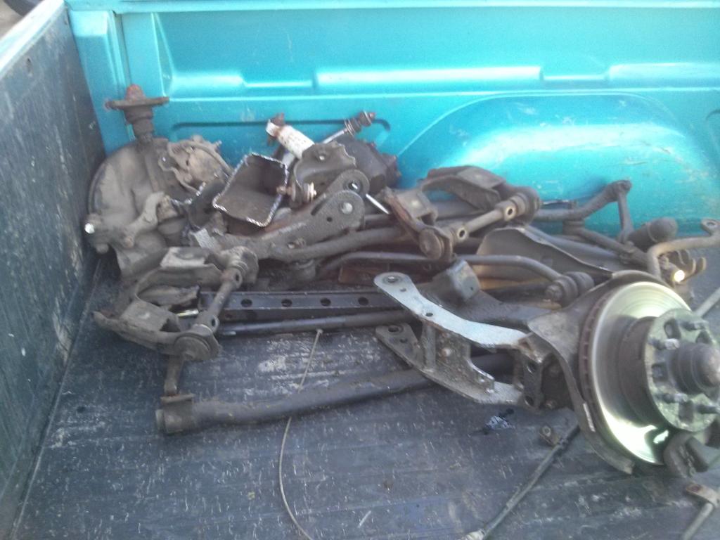

That happened on a Friday night, Saturday was IFS removal day. Not my idea of fun but I got it done. I see why most guys remove the IFS in one piece but I like taking things apart and it gave me a better understanding of the old suspension.

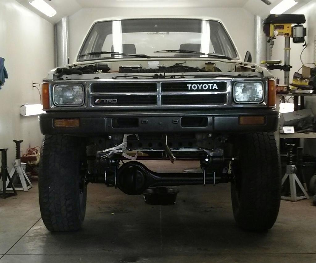

Sunday was the front axle mock up/ tack in day.

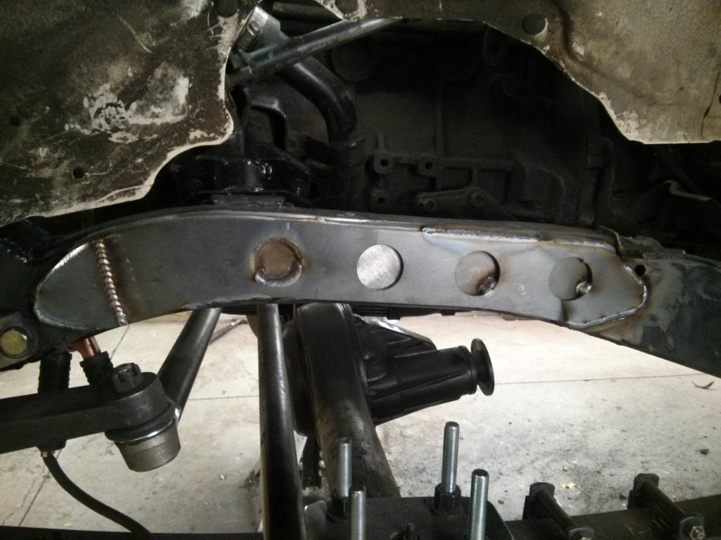

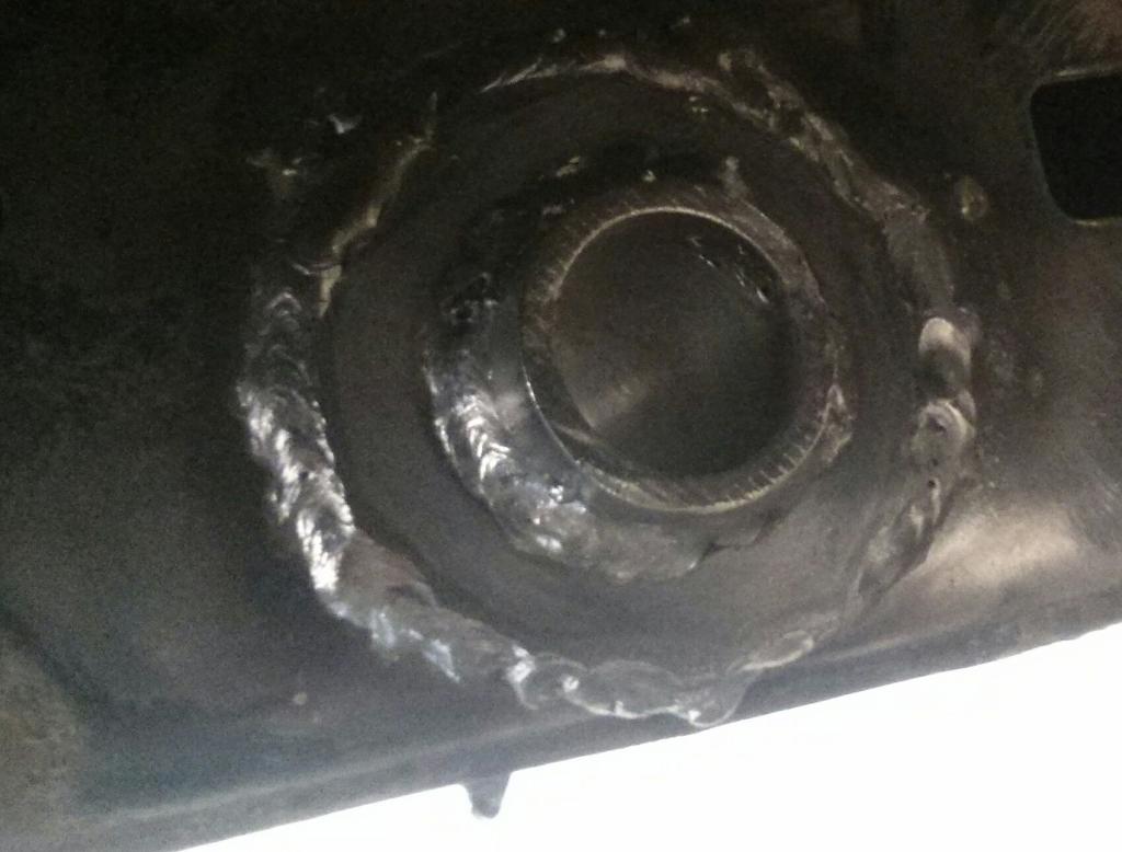

The next weekend it was time to burn the hanger/ tubes in, bought some 1.5" washers to reinforce the frame tubes on all sides. I also got some small stuff like rear brakes installed. I'm running the sky rear disk kit as well as their e brake kit.

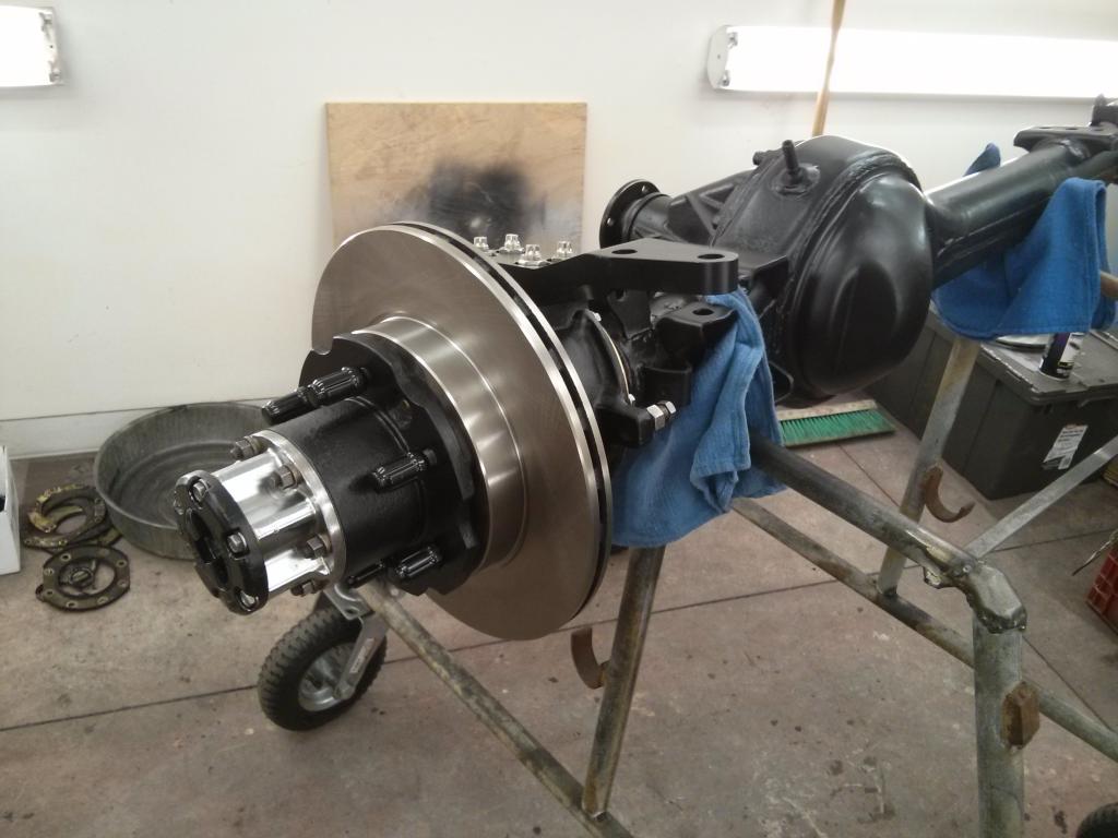

Im running OME medium springs in the front and stock 2wd rears that I pulled the overload and installed the bottom two springs from the 85 rear spring pack, that truck had maybe 4-5" of lift. It did the trick and firmed up my worn out 2wd springs. So far the truck is sitting sorta level, interested in seeing how it all settles out.

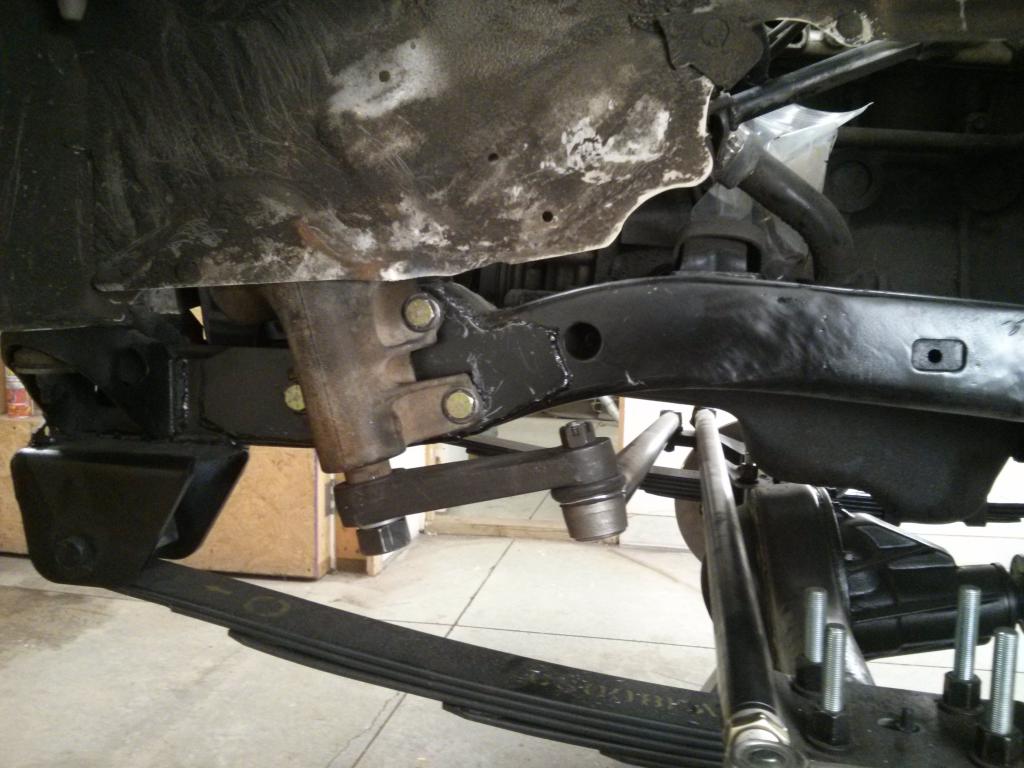

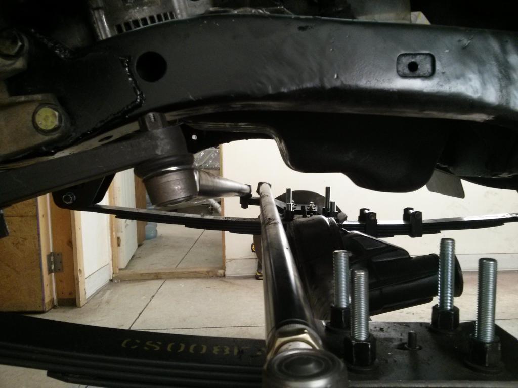

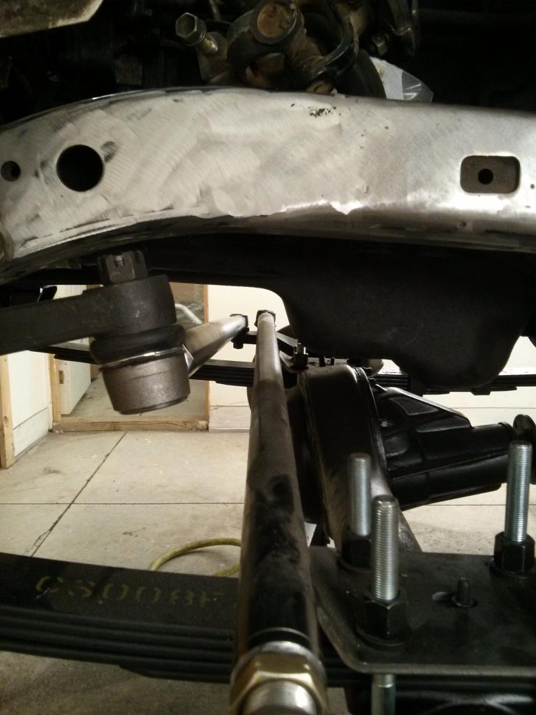

Today I got the steering box and mount installed. I swapped the 4wd u joint onto the end of my steering shaft and broke out the plastic pieces that keep the shaft from being a slip shaft.
Clearance is going to be close between the tie rod and oil pan while turning and compressing the suspension. It should clear but I am almost wishing I had moved the hanger forward like most everyone does. I Don't plan on running anything bigger than a 32 so I didnt want to move it forward any.

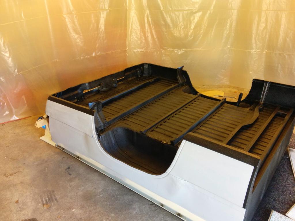

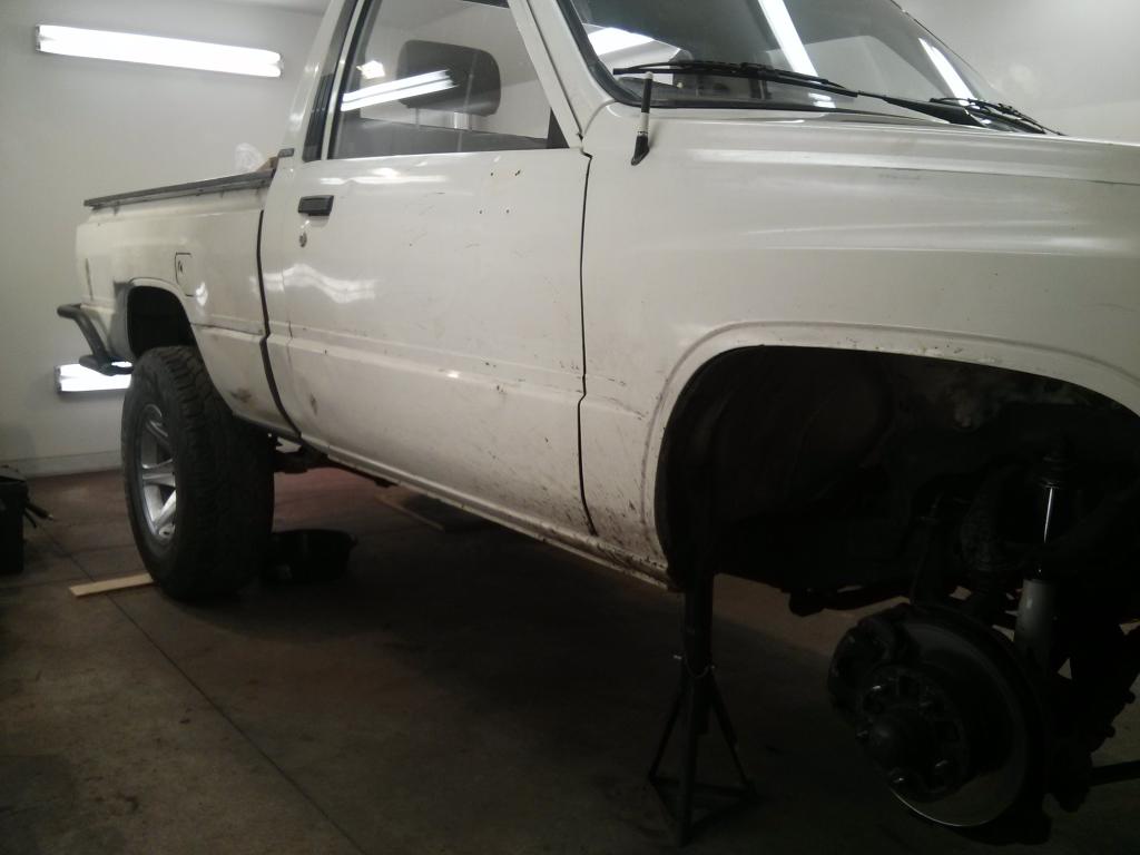

Heres a couple pictures from last year. Before I knew I was going to do the swap. Pulled the bed painted the frame and bedlined the bottom of the bed back of the cab and the front side of the bed. I recommend Raptor liner for sure. I have also pulled the carpet sound deadened the interior including the doors and swapped my bench out for some 4runner buckets.

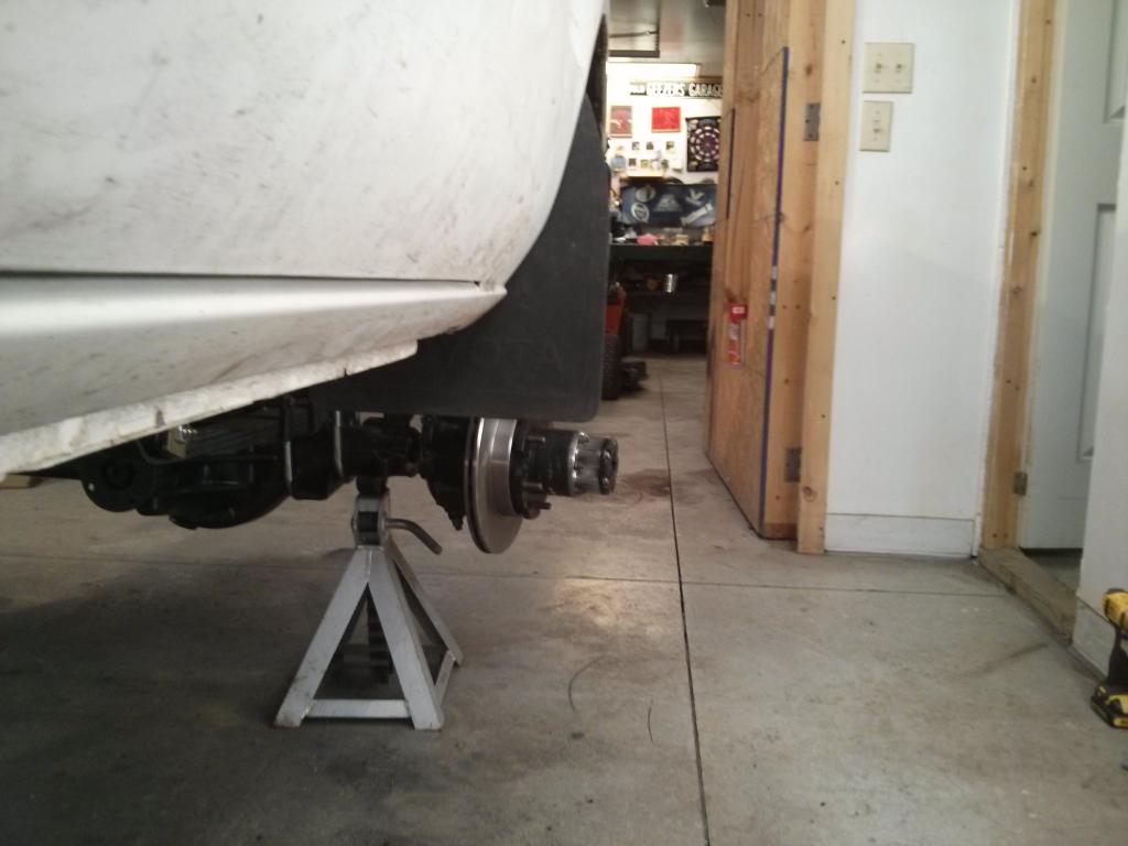

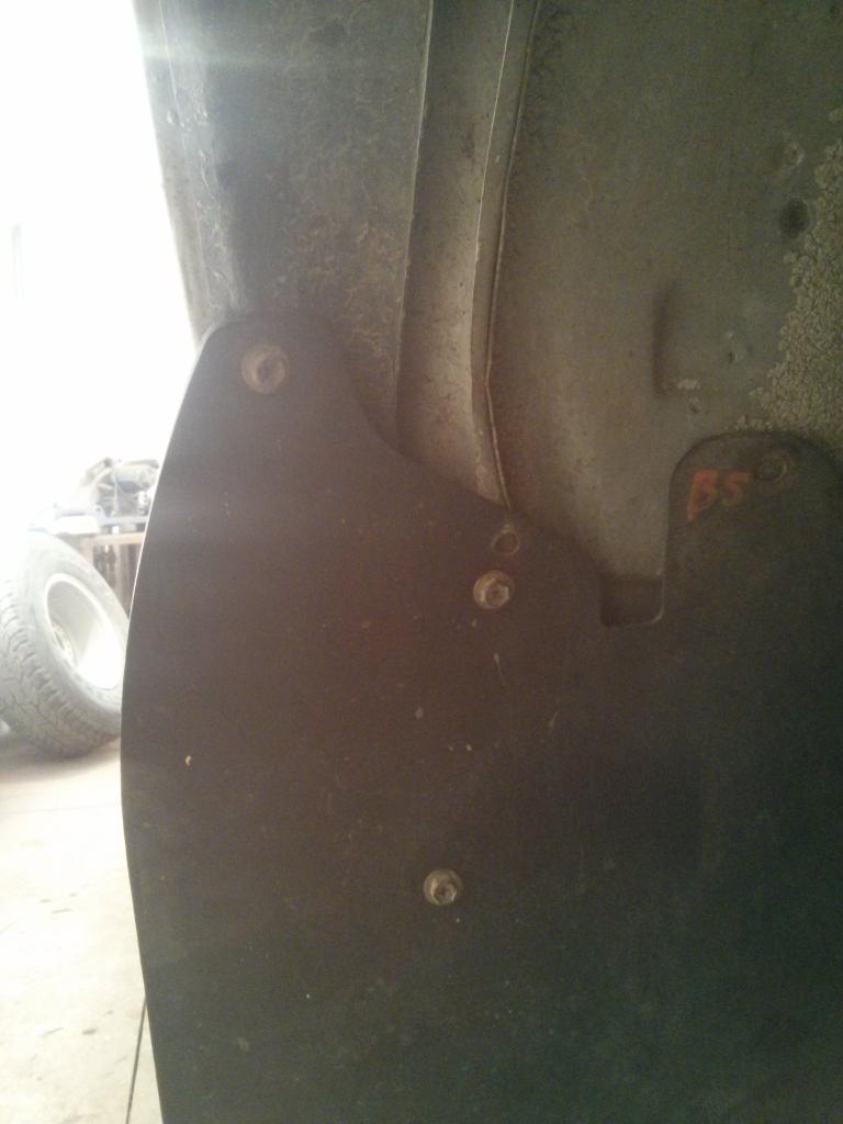

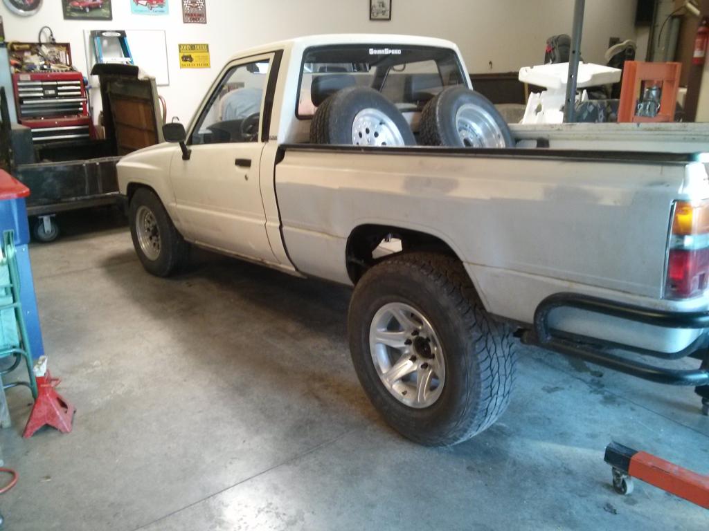

Thanks guys. Yesterday I swapped out my door seals and got my front mudflaps put on. I was able to use the factory bolt holes for the fender liner, the liner needs replaced since I trimmed it for clearance when it was lowered. They are mounted pretty high but I like the look and its where the holes were. I am going to add washers and another couple mounting points. Need to paint the letters white also.
I also started putting my power steering parts on. I am glad I bought a complete truck to get all these parts/ hardware. These trucks are scarce around here at JYs.
From this angle you can see the passenger side rocker panel is mint. For some reason the driver side is rusted through in many spots.

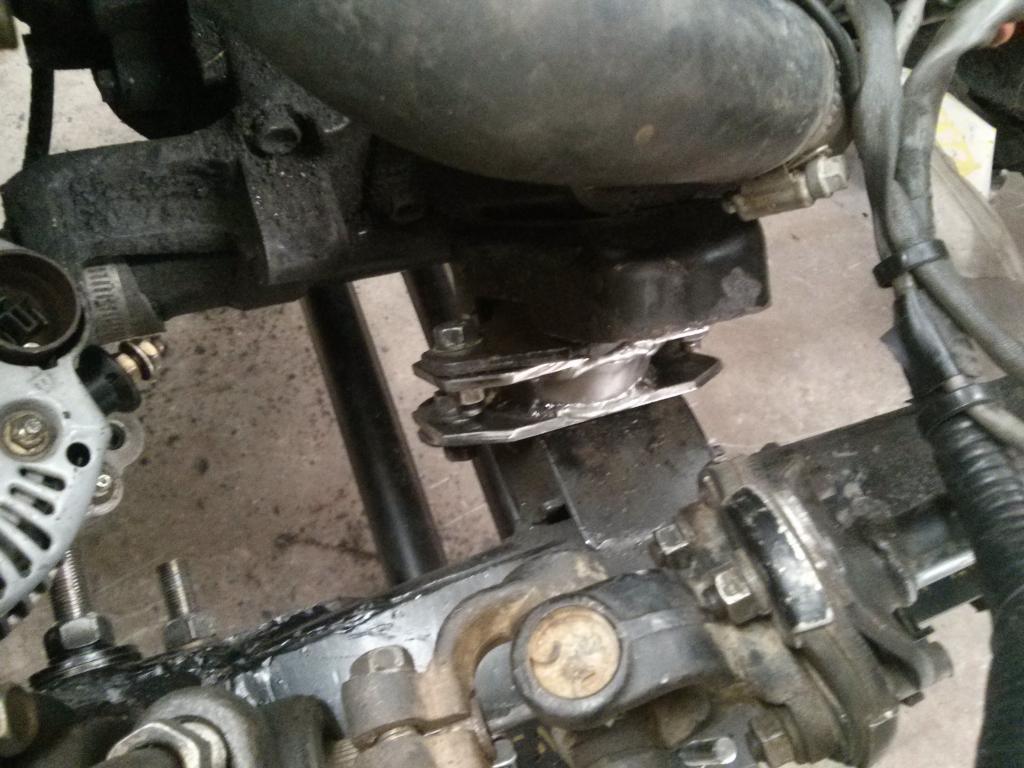

Built and installed some motor mount spacers to help oil pan clearance. Ended up lifting the engine about 1.5". I used some heavy pipe and some 3/16 plate I had laying around. Of course now I have a couple small clearance issues with aircleaner and fan shroud but they should be easily remedied.

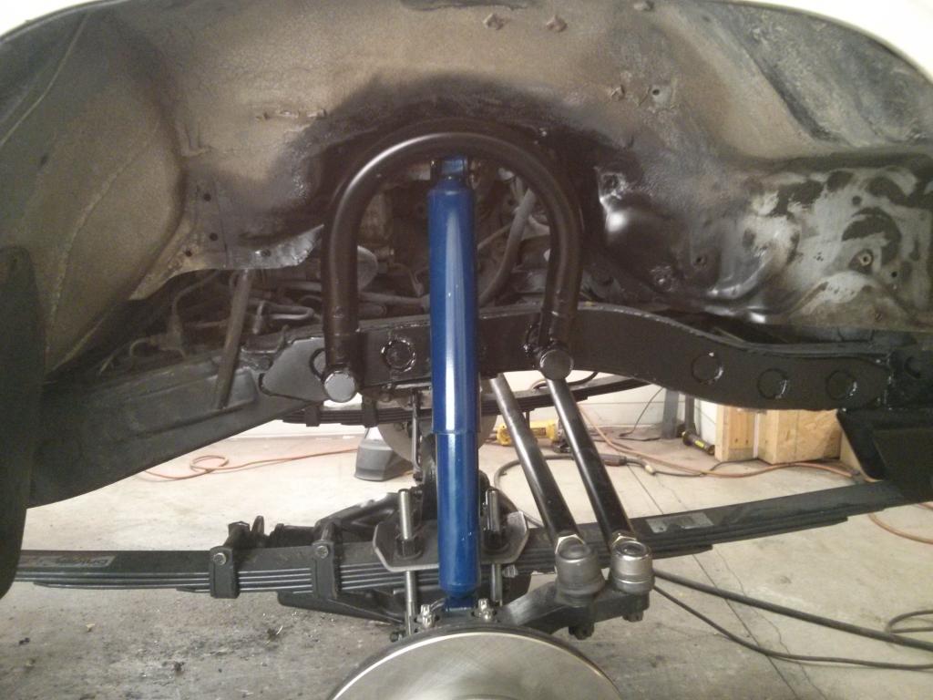

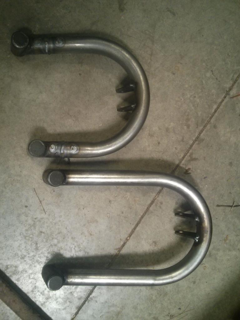

Between yesterday and today I was able to finish installing power steering and get my shock hoops fitted up. Also got the passenger side bumpstop installed.

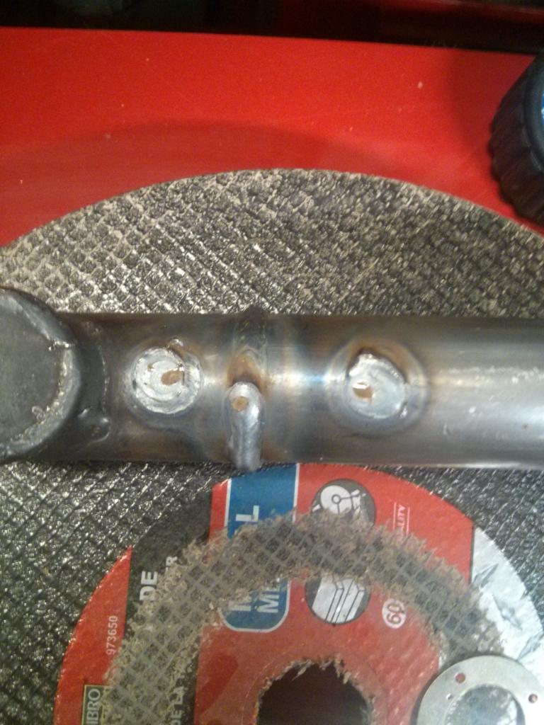

I bought trail gear hoops and they needed cut down about 4". I put a piece of tube in the middle and drilled some holes for plug welds. still need to add gussets from hoop to frame. I need to measure but it looks like I may be able to use the same shocks front and rear.
Got the driver side all made up just needs welded on. I plated the frame with the Trailgear pieces. Very slow going when doing stitch welds.
I did the old stack a tack where I notched the steel to bend over the steering box mount, it's notched on the other side a half inch over to form an offset. I could have just butted them together but felt this would be stronger. Ideally the frame plating would go on before the steering box mount but I got in a hurry.

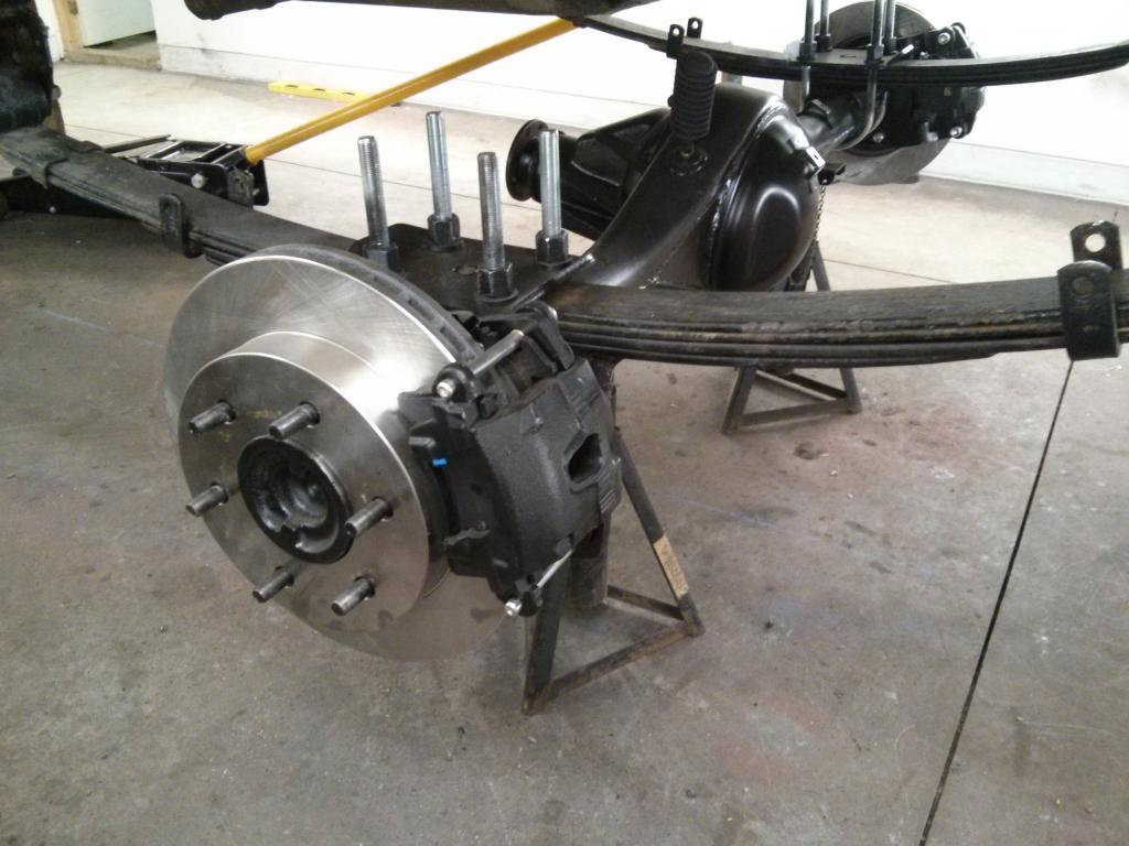

Got my rear brakes all wrapped up a few days ago also got the front done except for brake line and calipers. I will take pictures of the rear setup sometime tomorrow.
