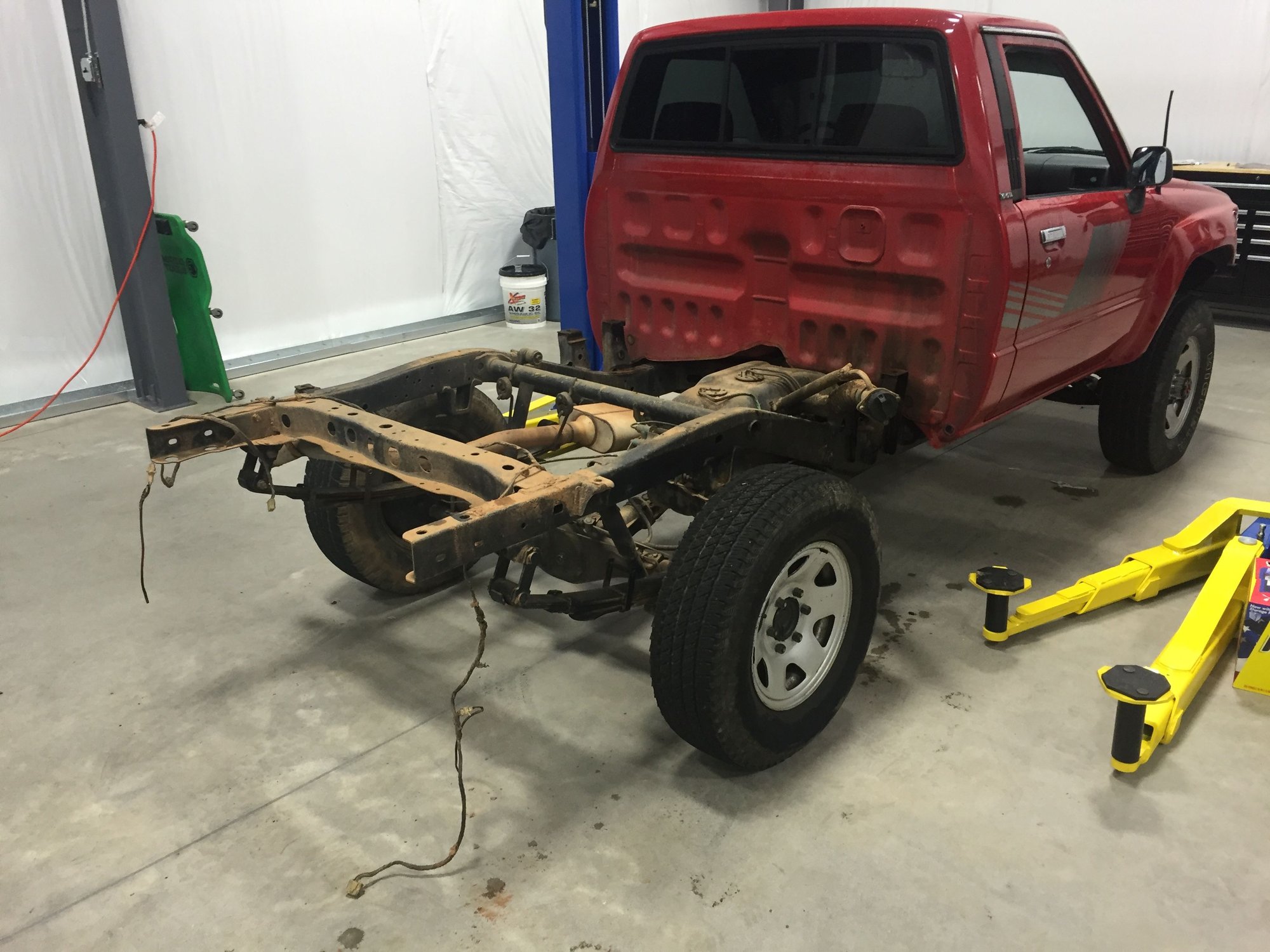

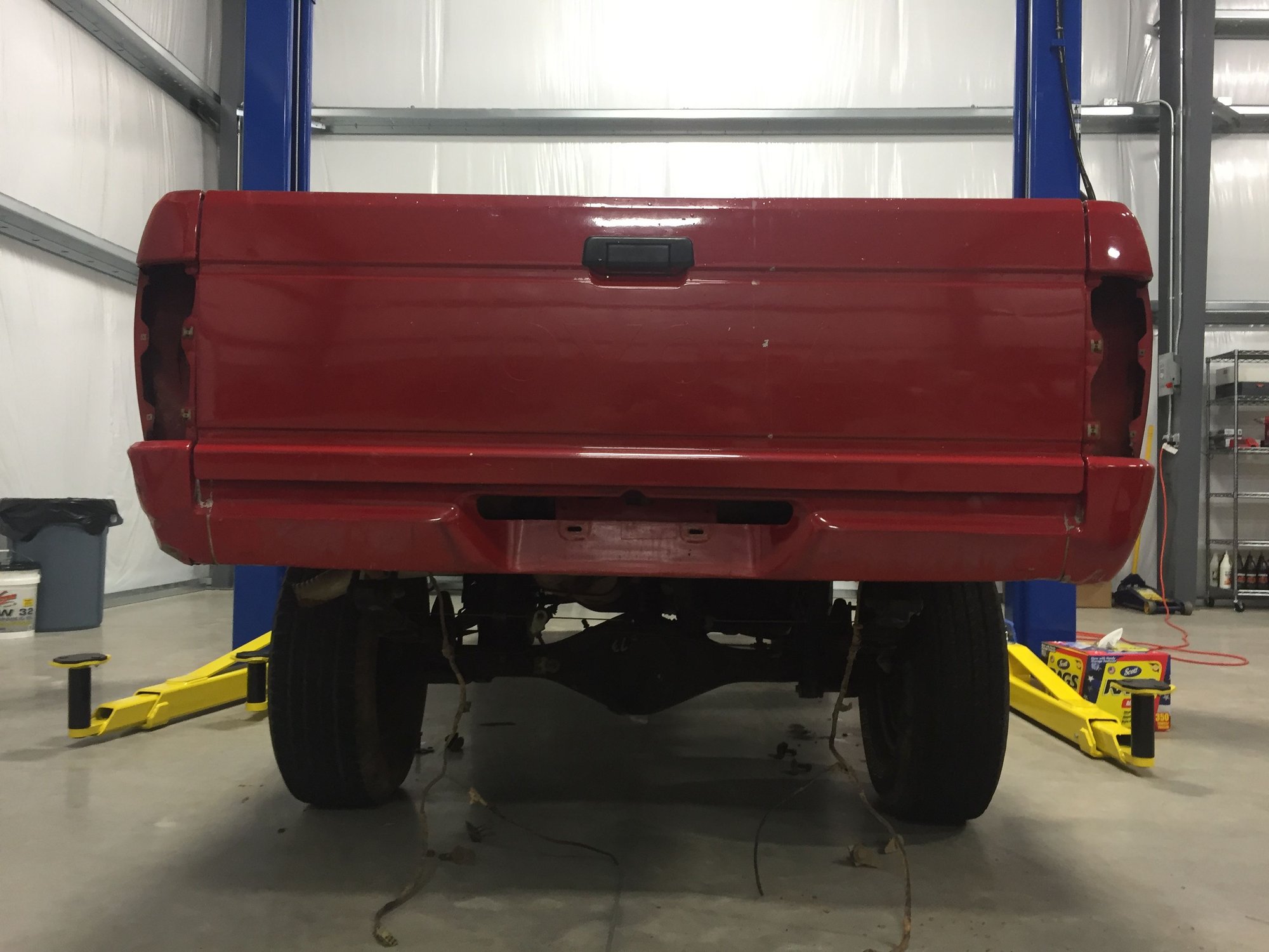

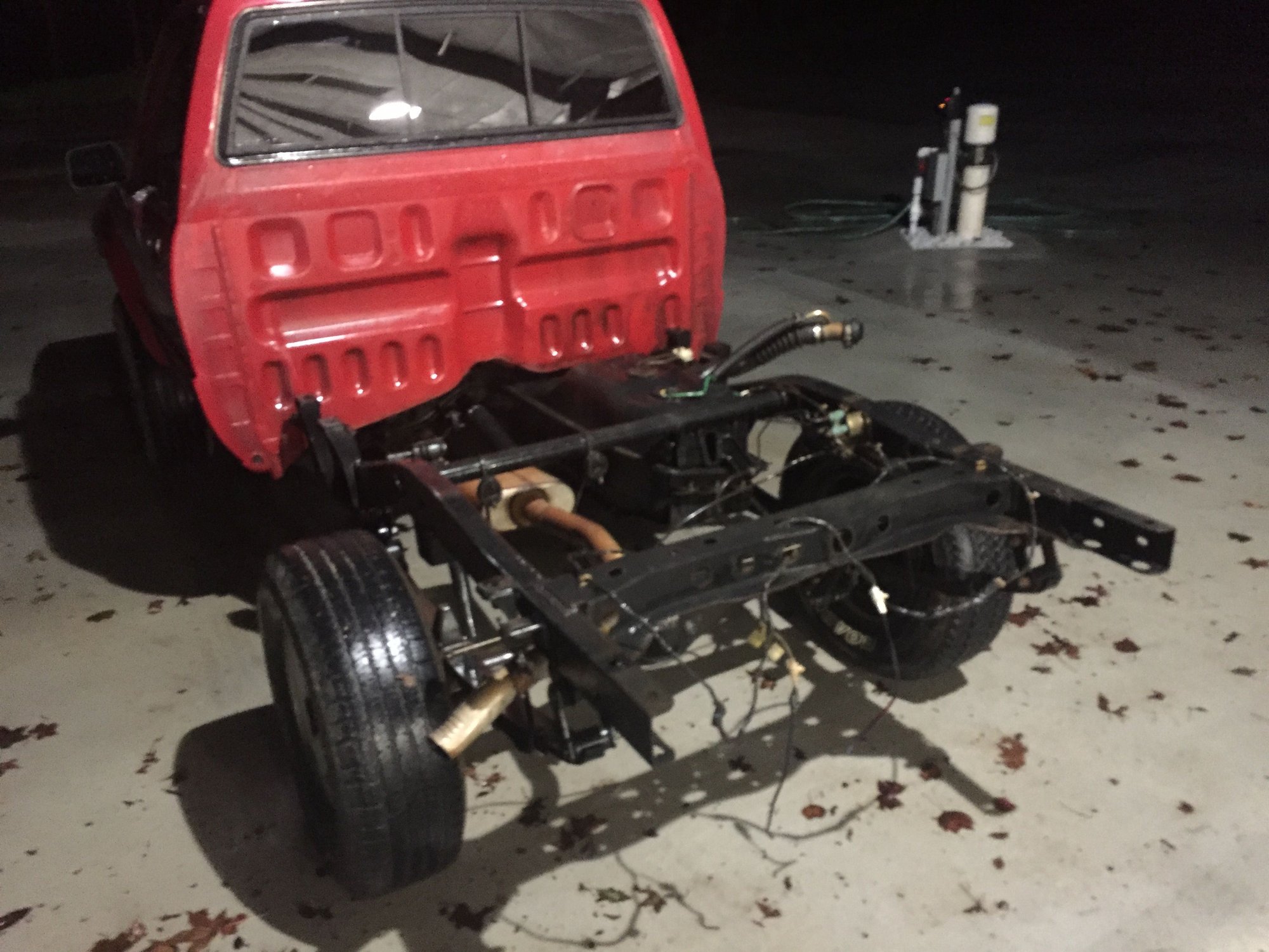

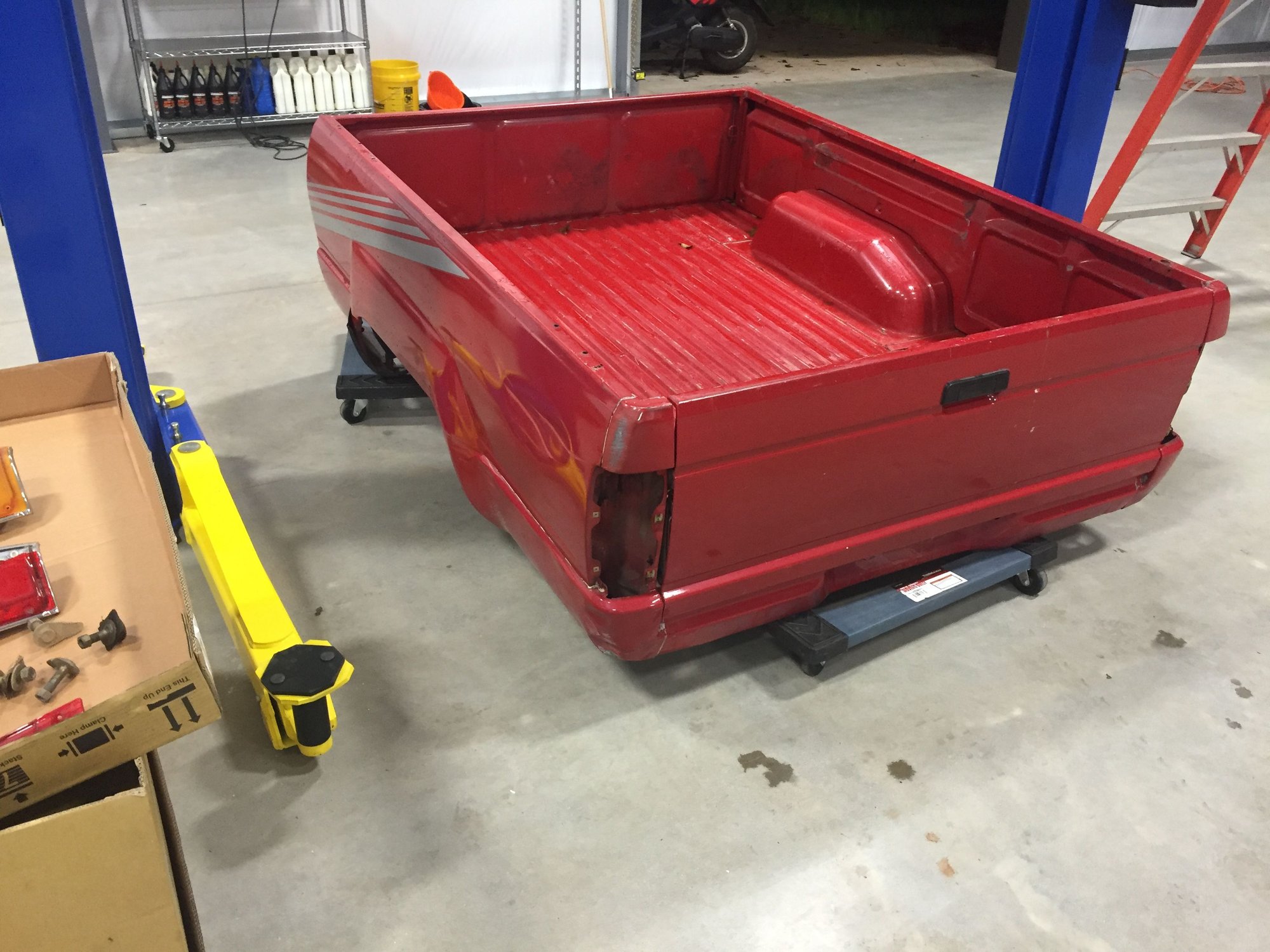

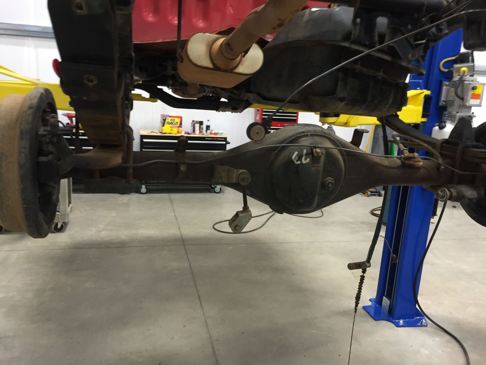

Got the bed off last night. Time to start the axle swap!

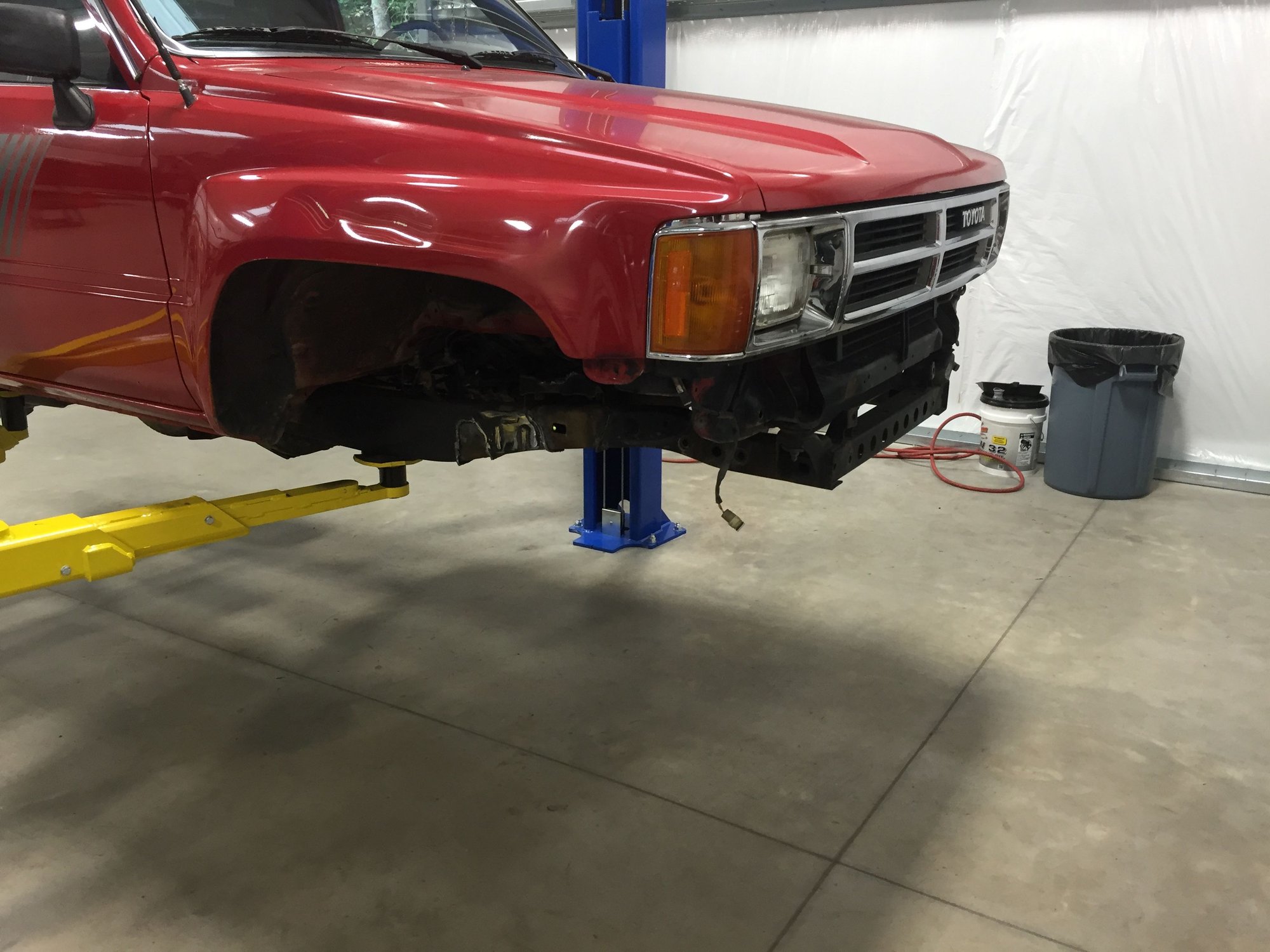

From: Georgia

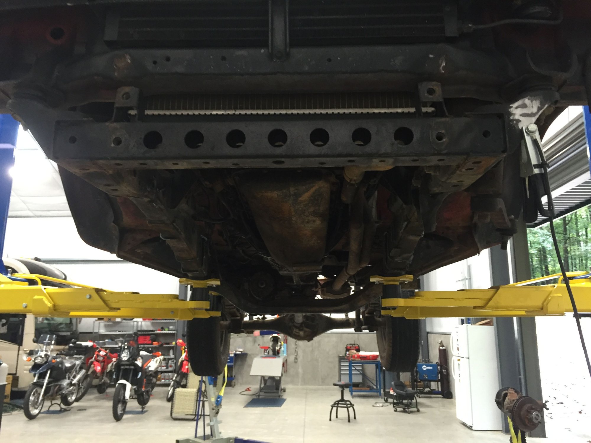

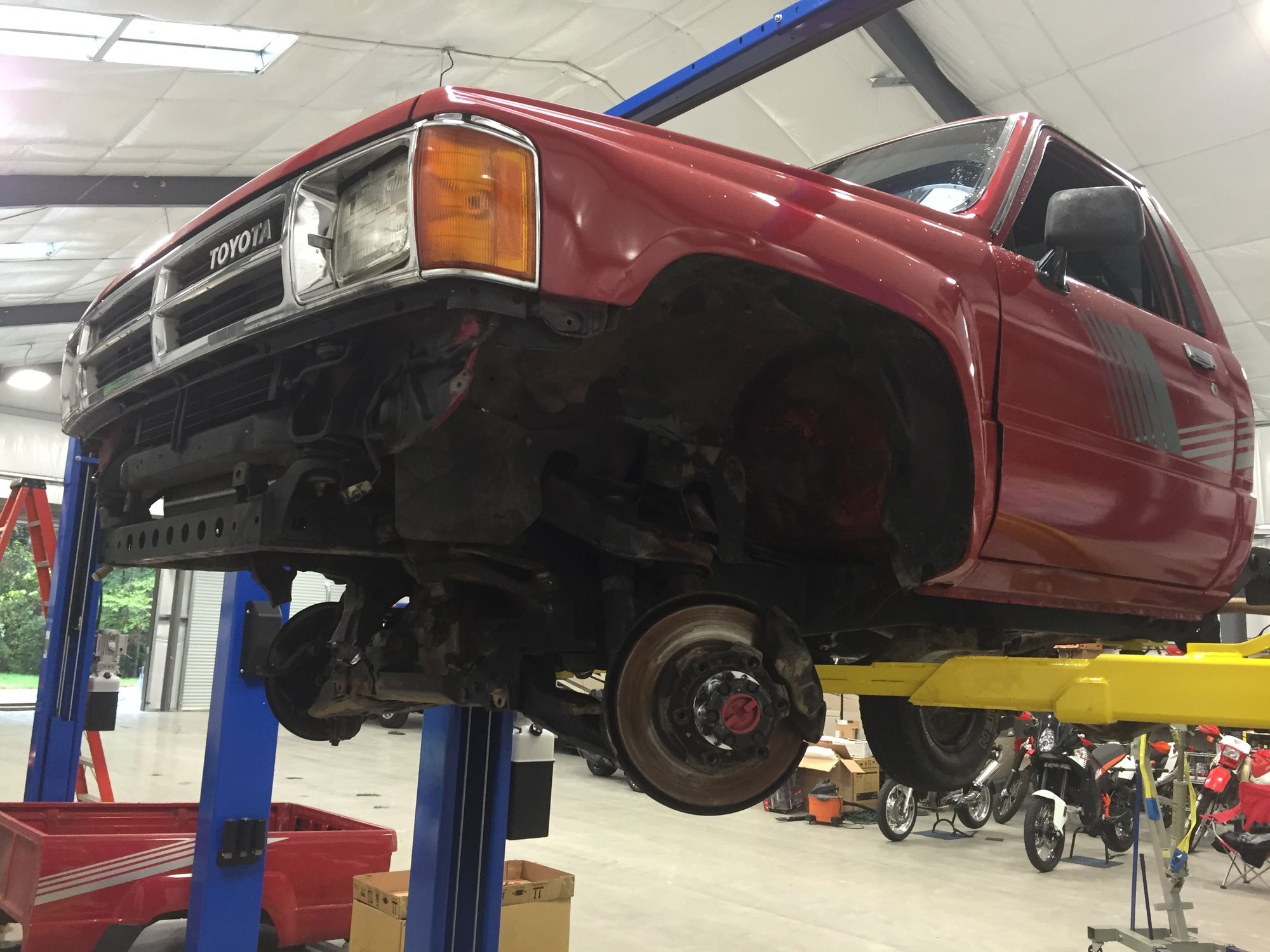

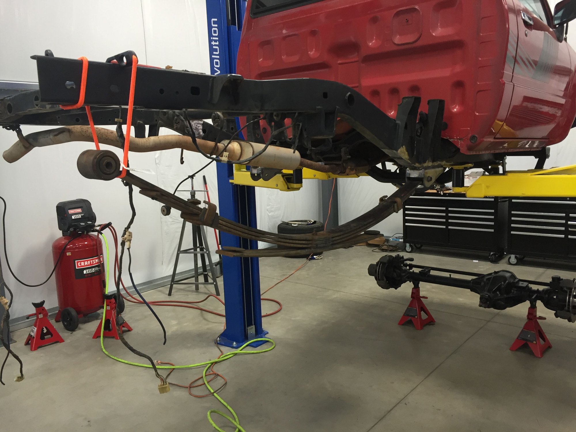

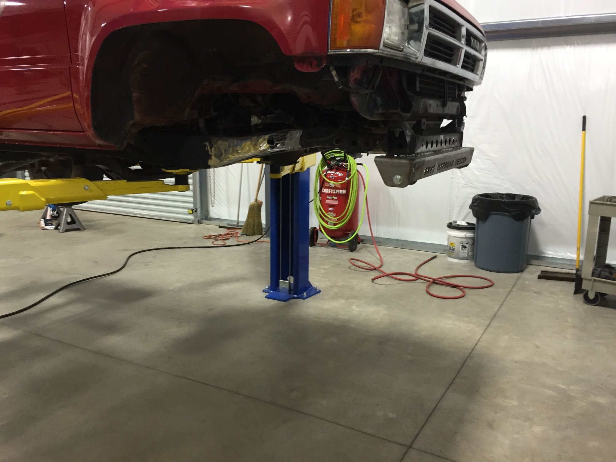

Did a little work today. Got the front ds out and all the steering out. I also finally took off the hideous front bumper that came on the truck.

Nice shop! SAS should be cake with the lift.

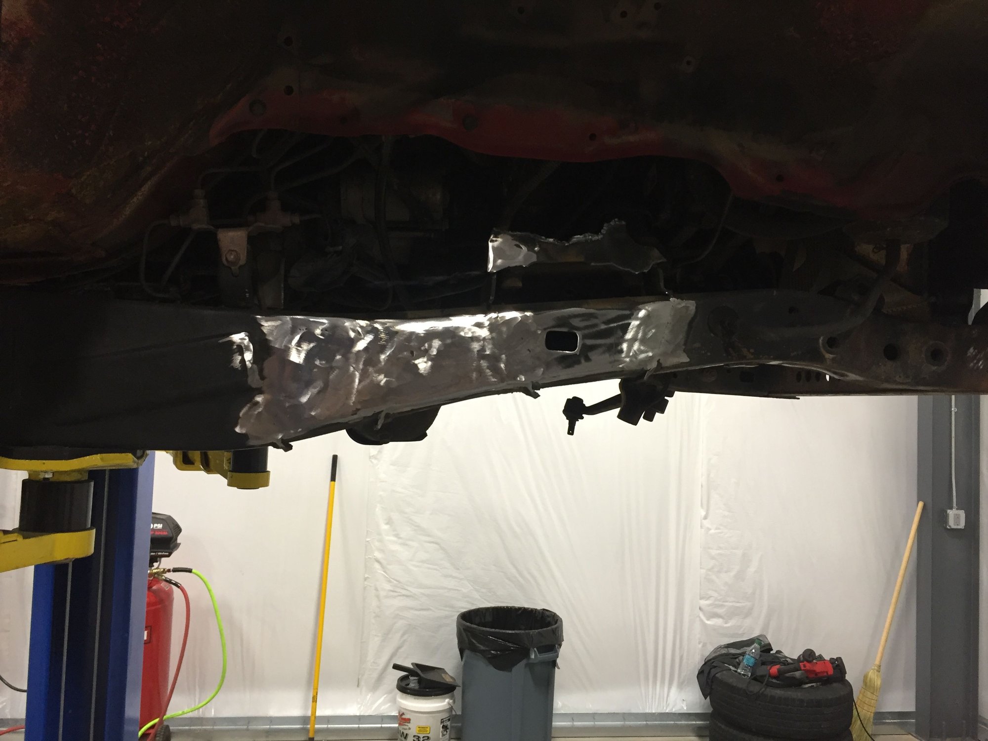

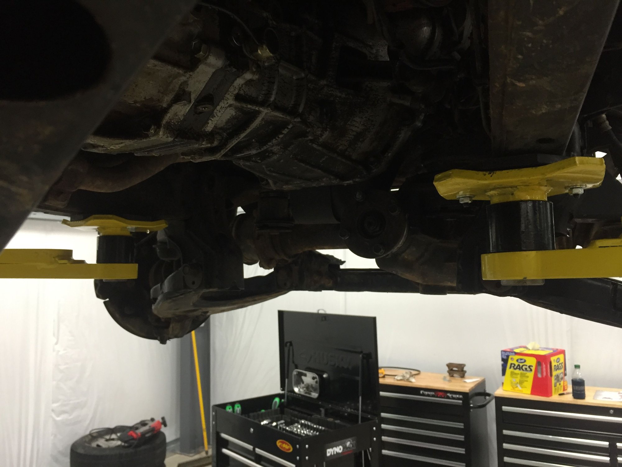

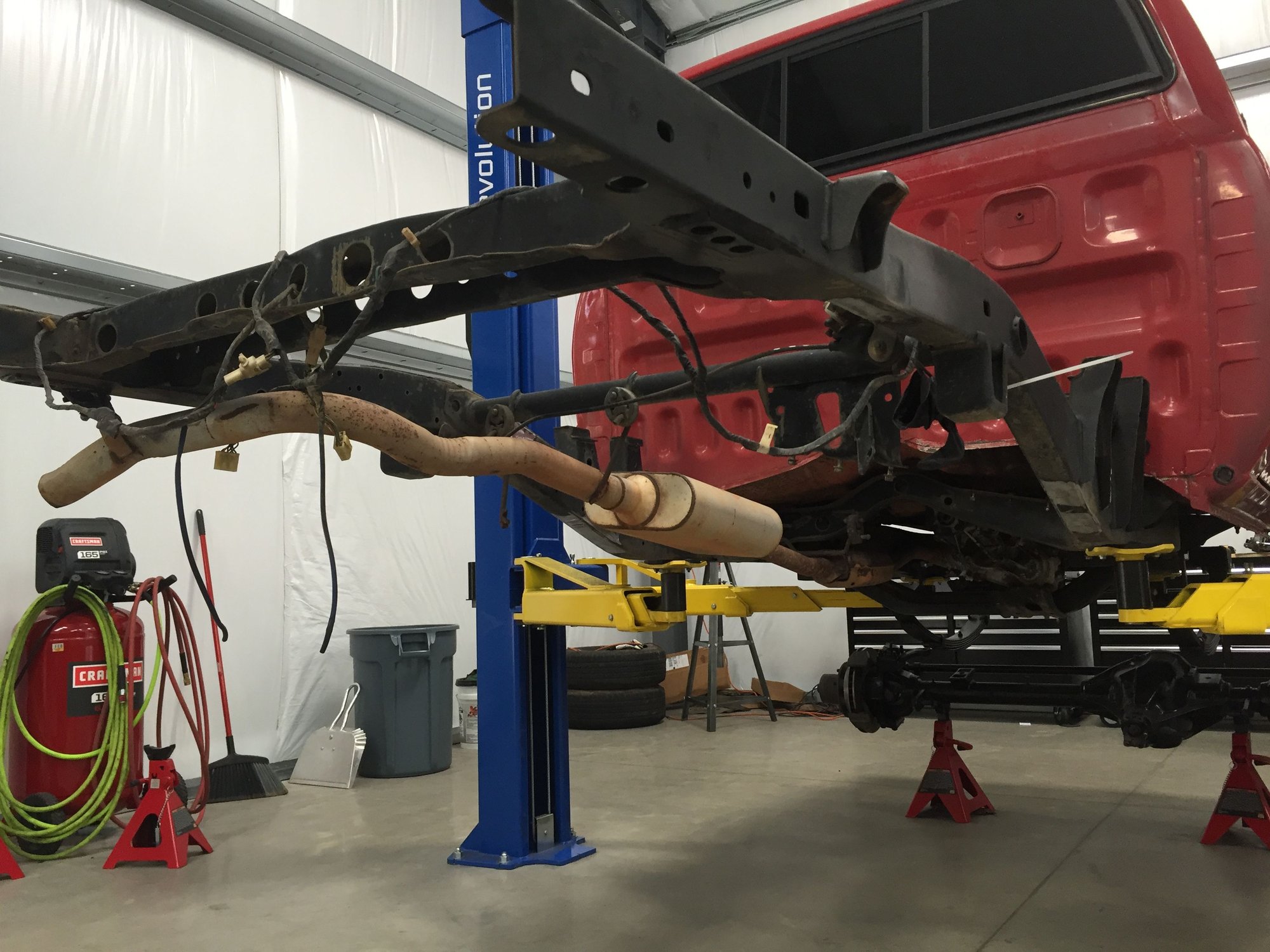

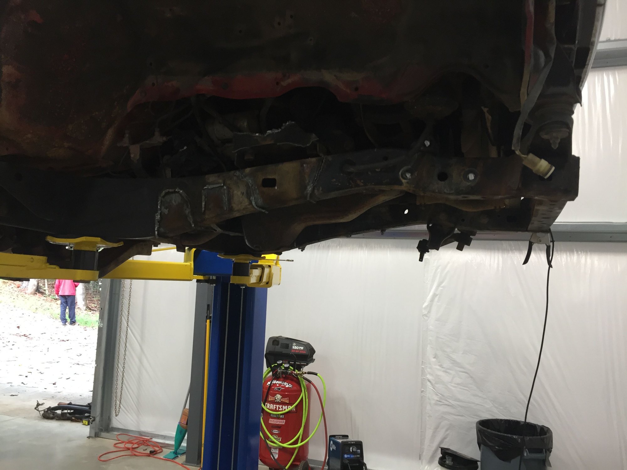

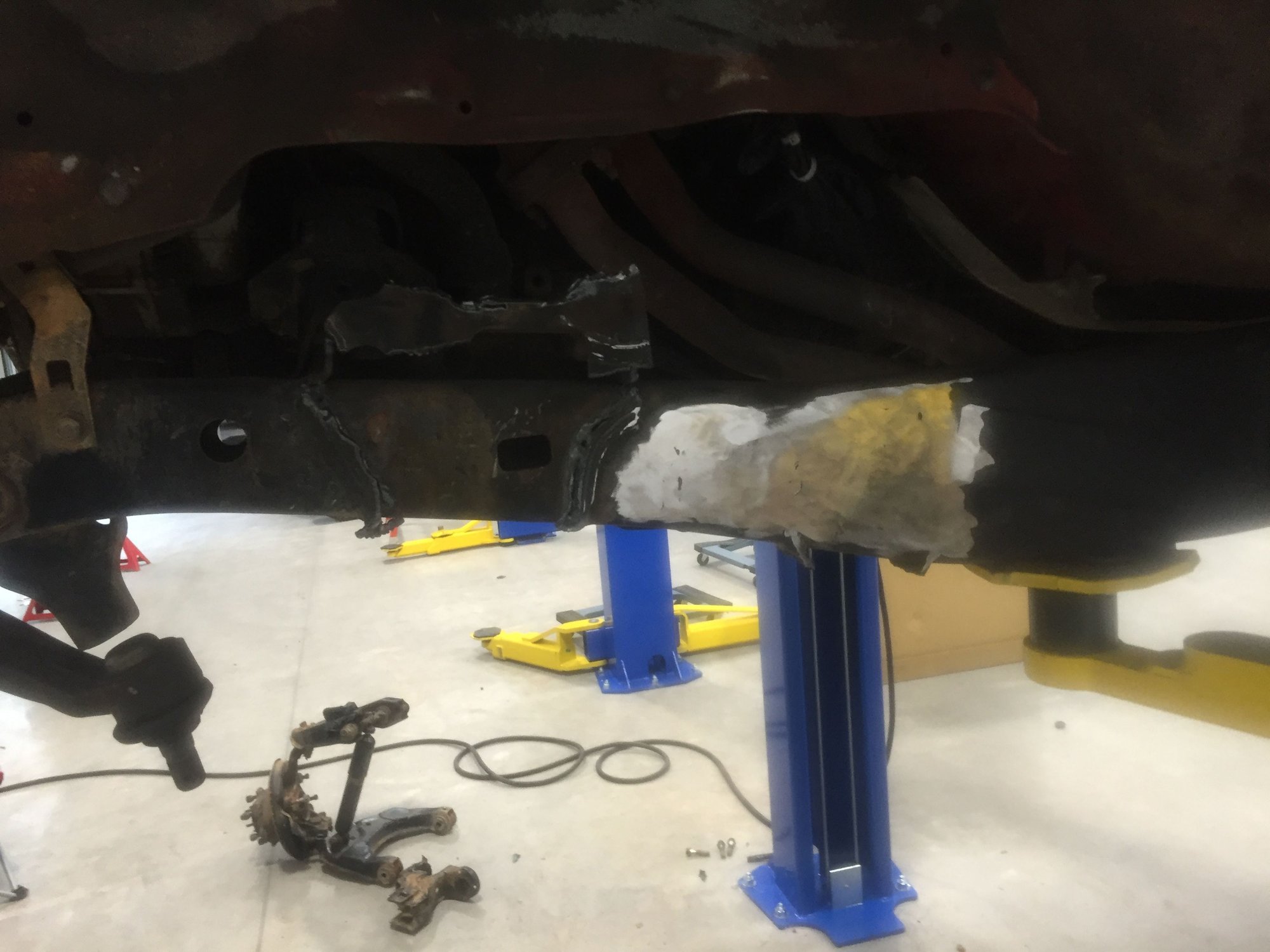

Got alot done on the truck today. Got the ifs completly yanked out and all the brackets cut off. I still need to do some grinding but, Im officaly at the point of no return. 👍🏻

Thanks man. Its really my old mans shop and hes letting me use the lift.

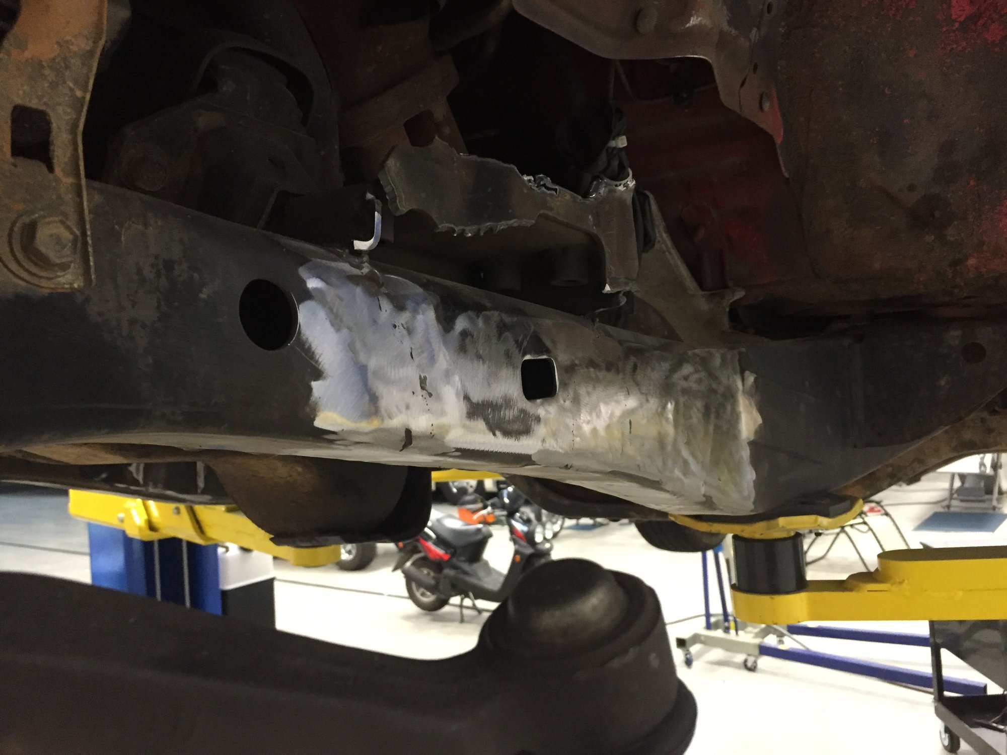

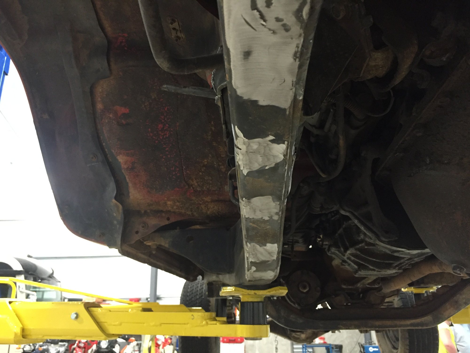

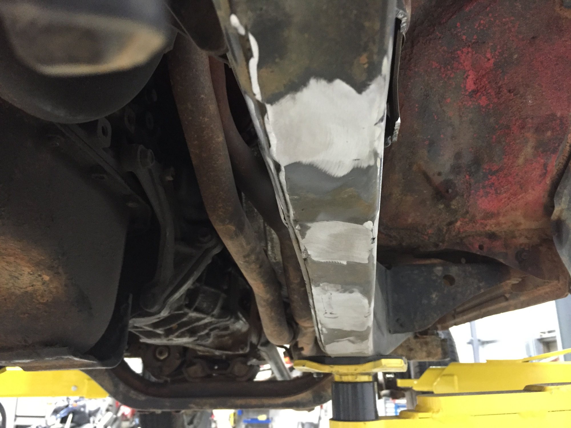

I only had a couple hours to work today but i knocked out about 80% of the grinding. Hopefully i will have time tommorrow to finish the grinding. Still need to plate the motor mounts were the ifs use to be.

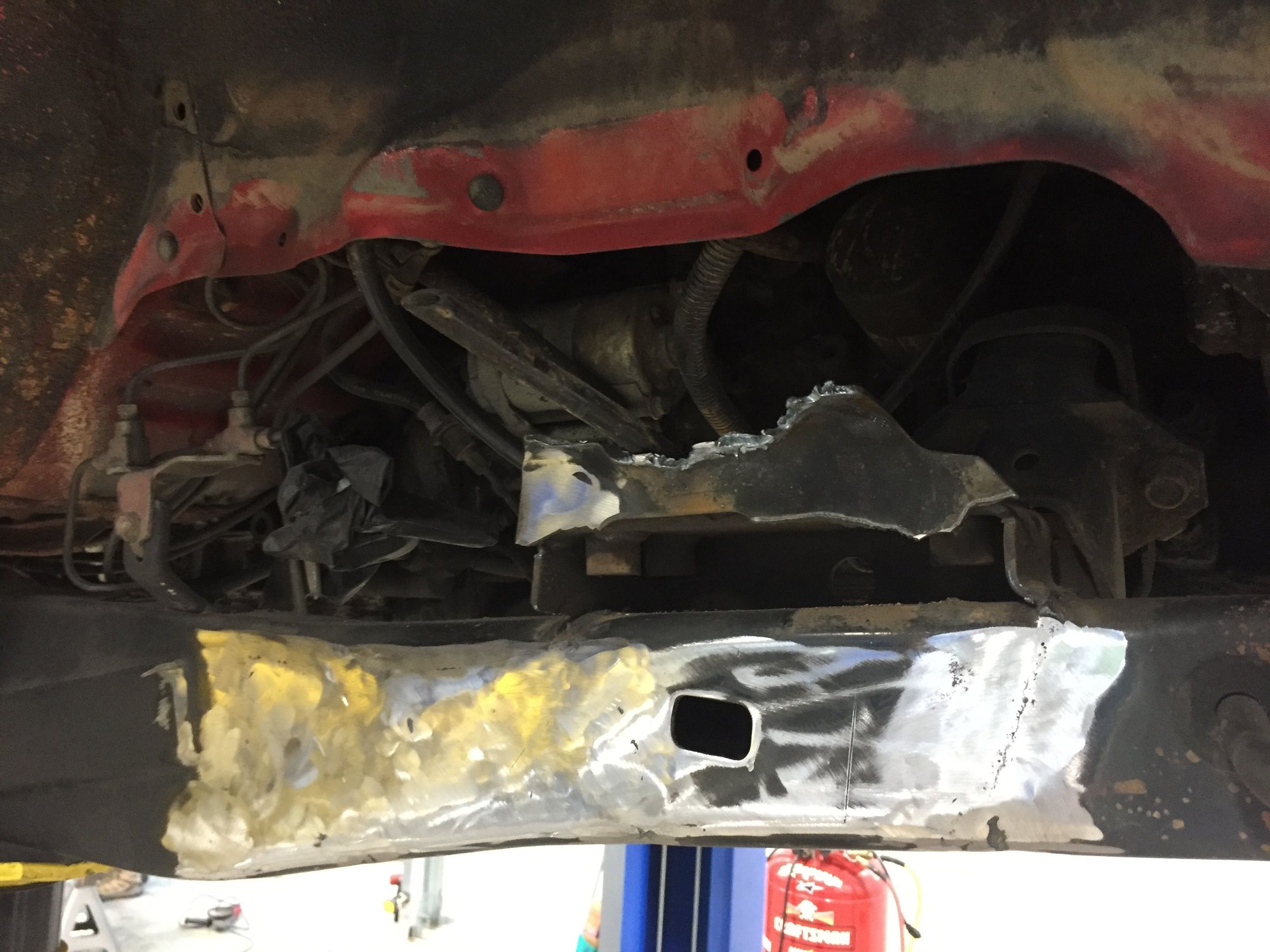

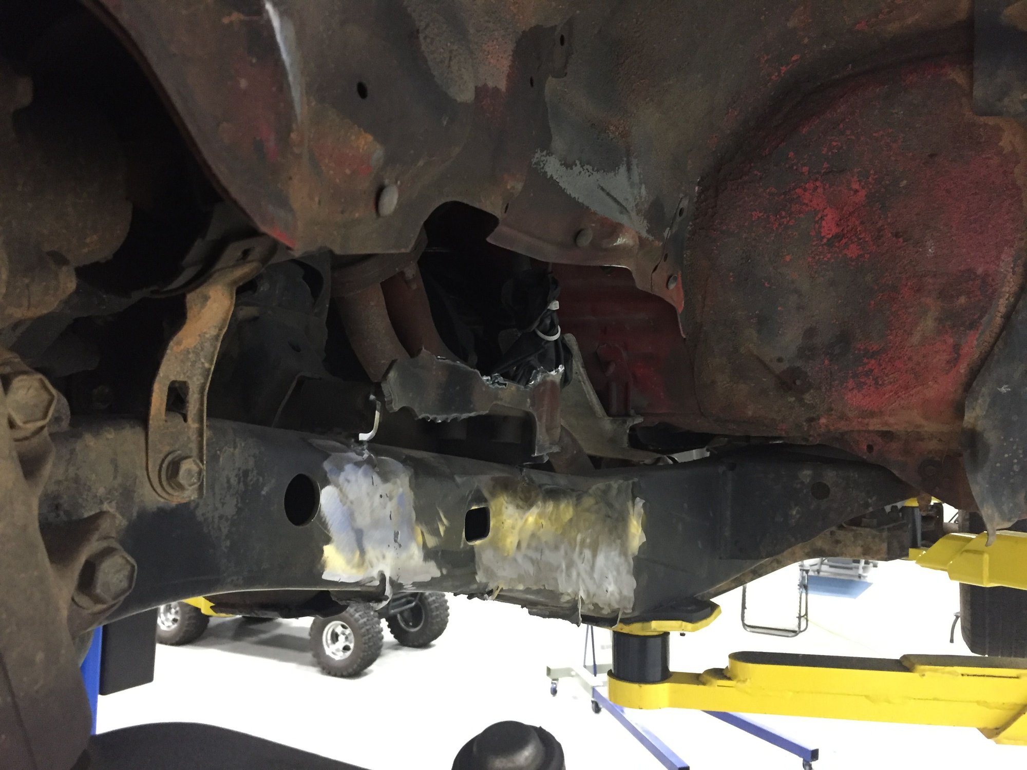

From: Georgia

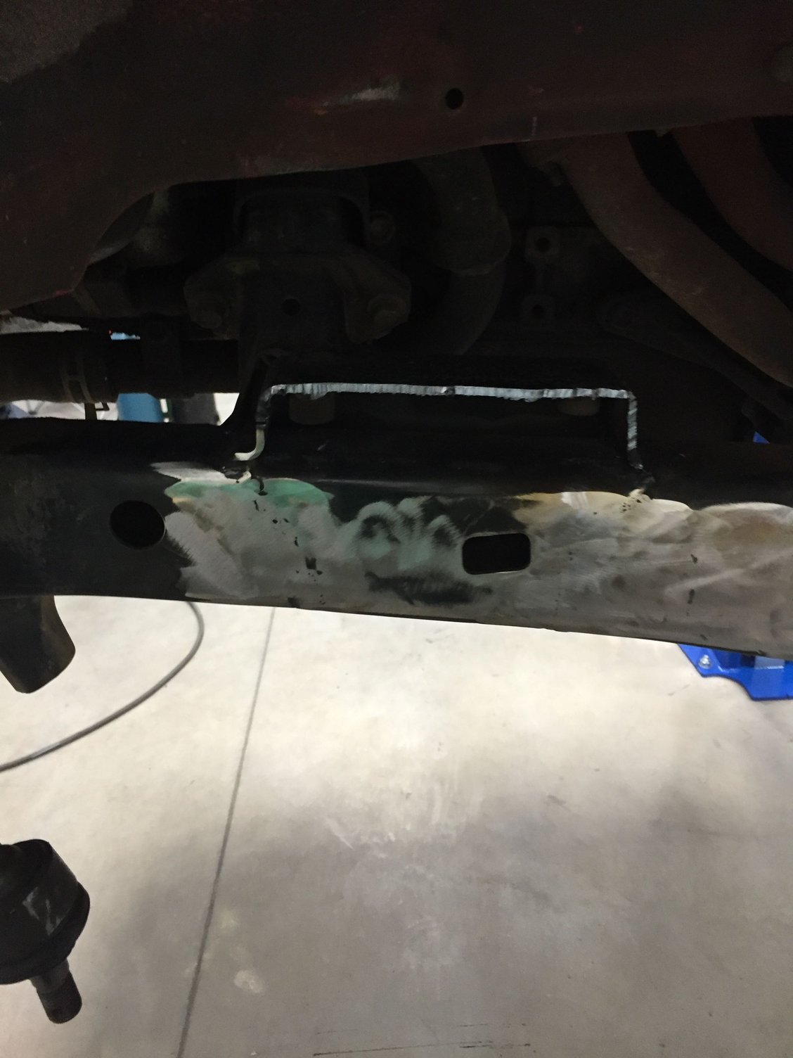

Pretty much finished the grinding today. Next up is plating in the motor mounts and welding on the front leaf hanger crossmember.

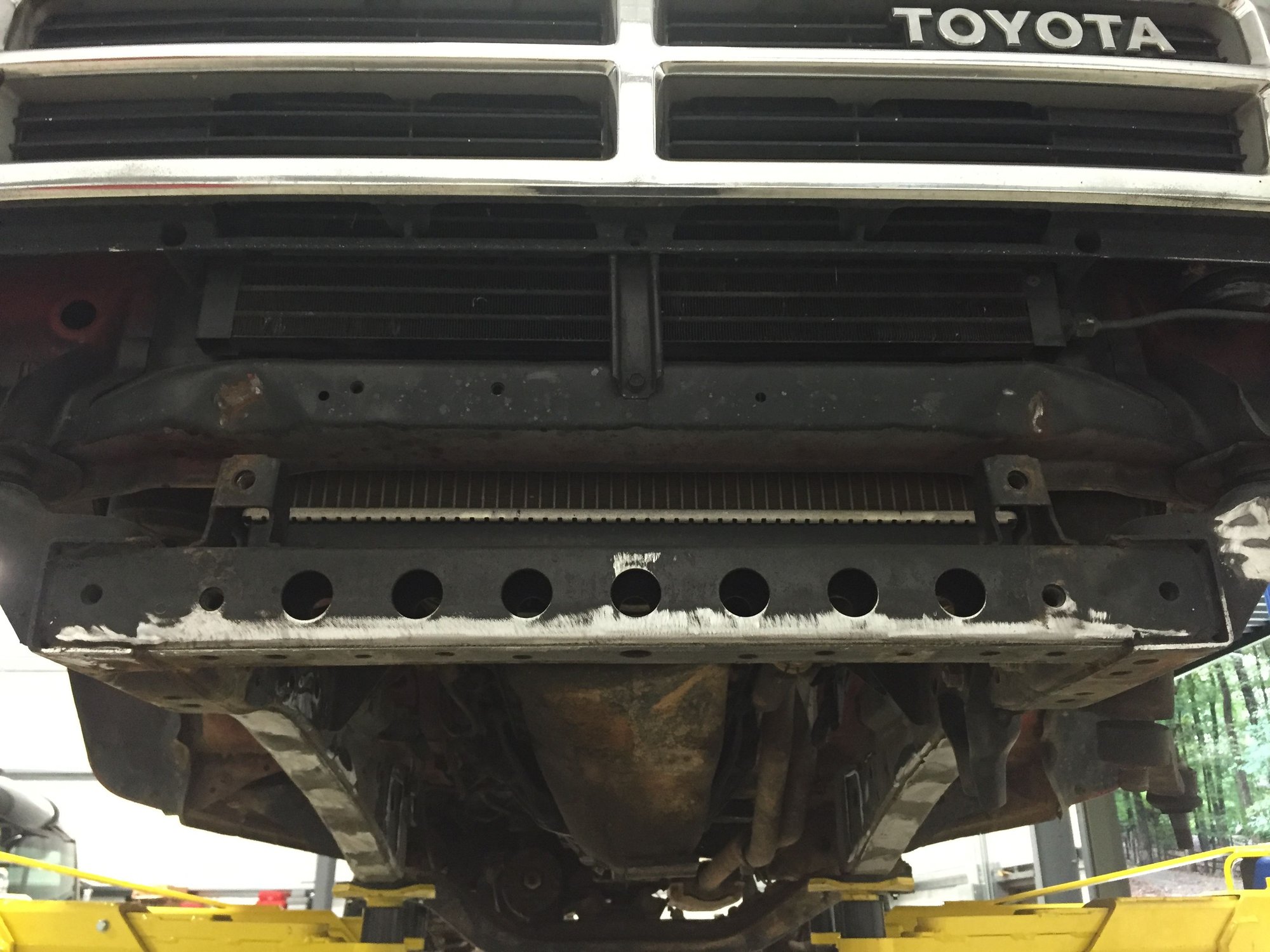

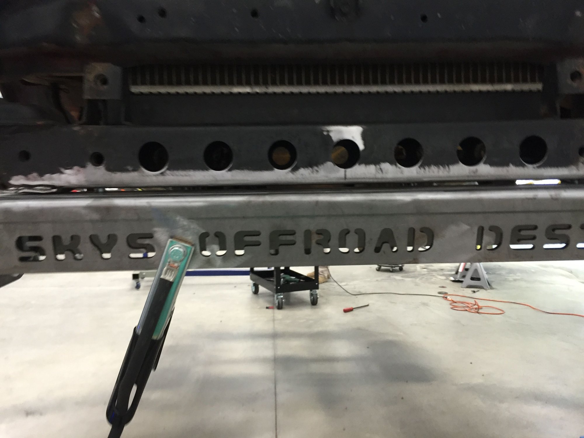

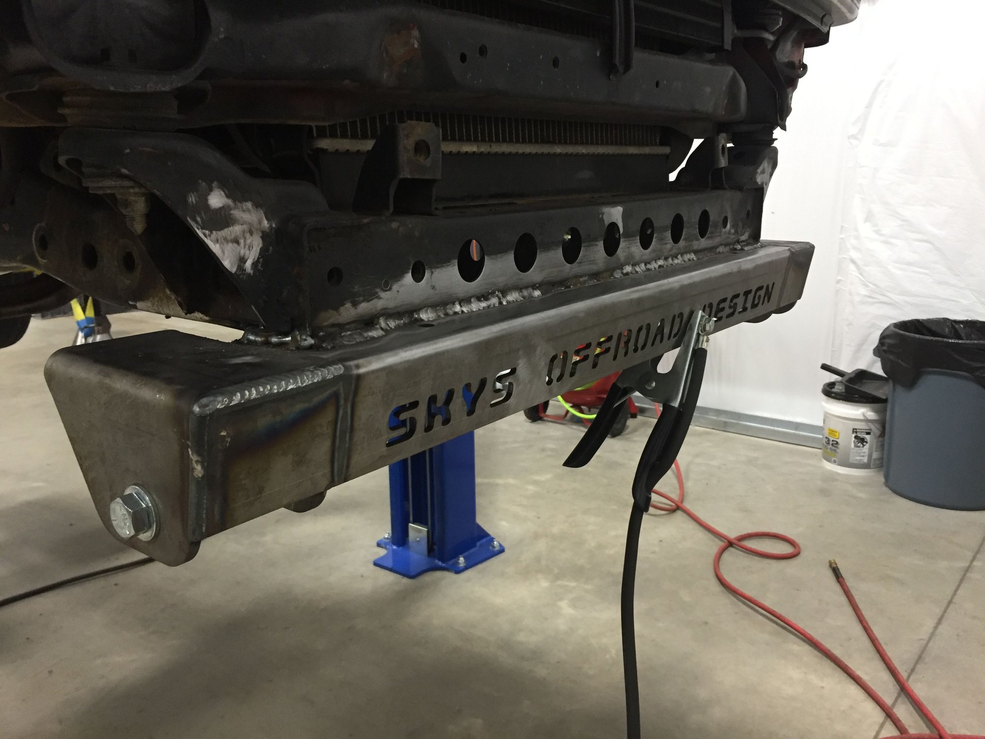

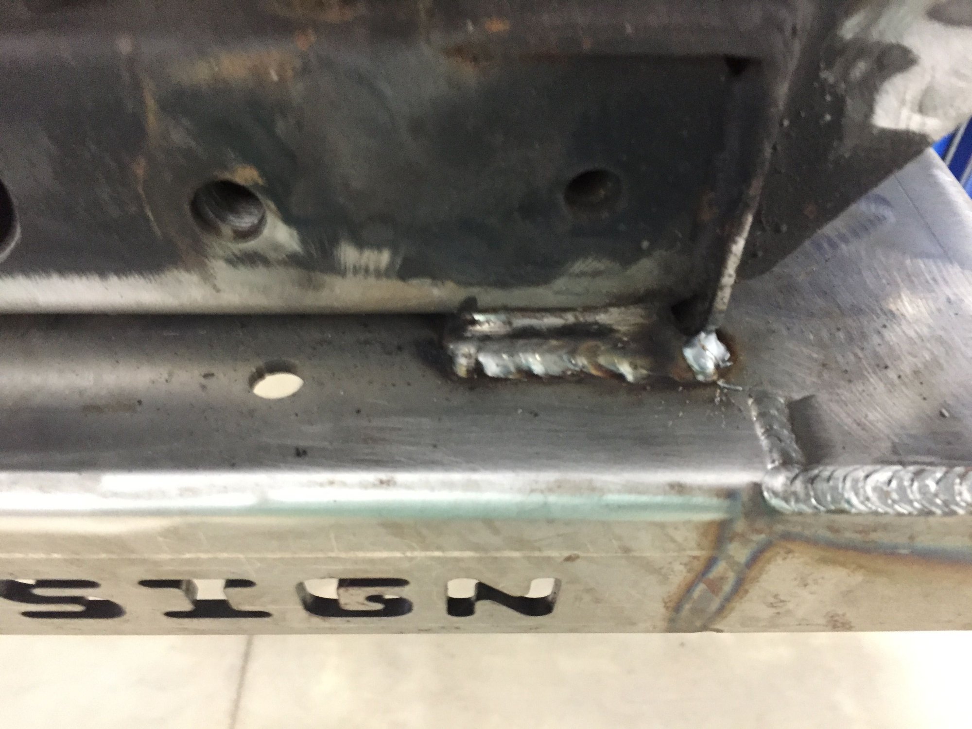

I welded on the front leaf spring crossmember today. 👍🏻👍🏻 I'm getting close to test fitting the front axle. Hopefully, I can knock out the motor mounts tomorrow.

I only had about a hour to work today so, I started working on the rear. Next prioritys are plating the motor mounts, cutting the holes in the frame for front leafs, and cutting off the factory rear mounts.

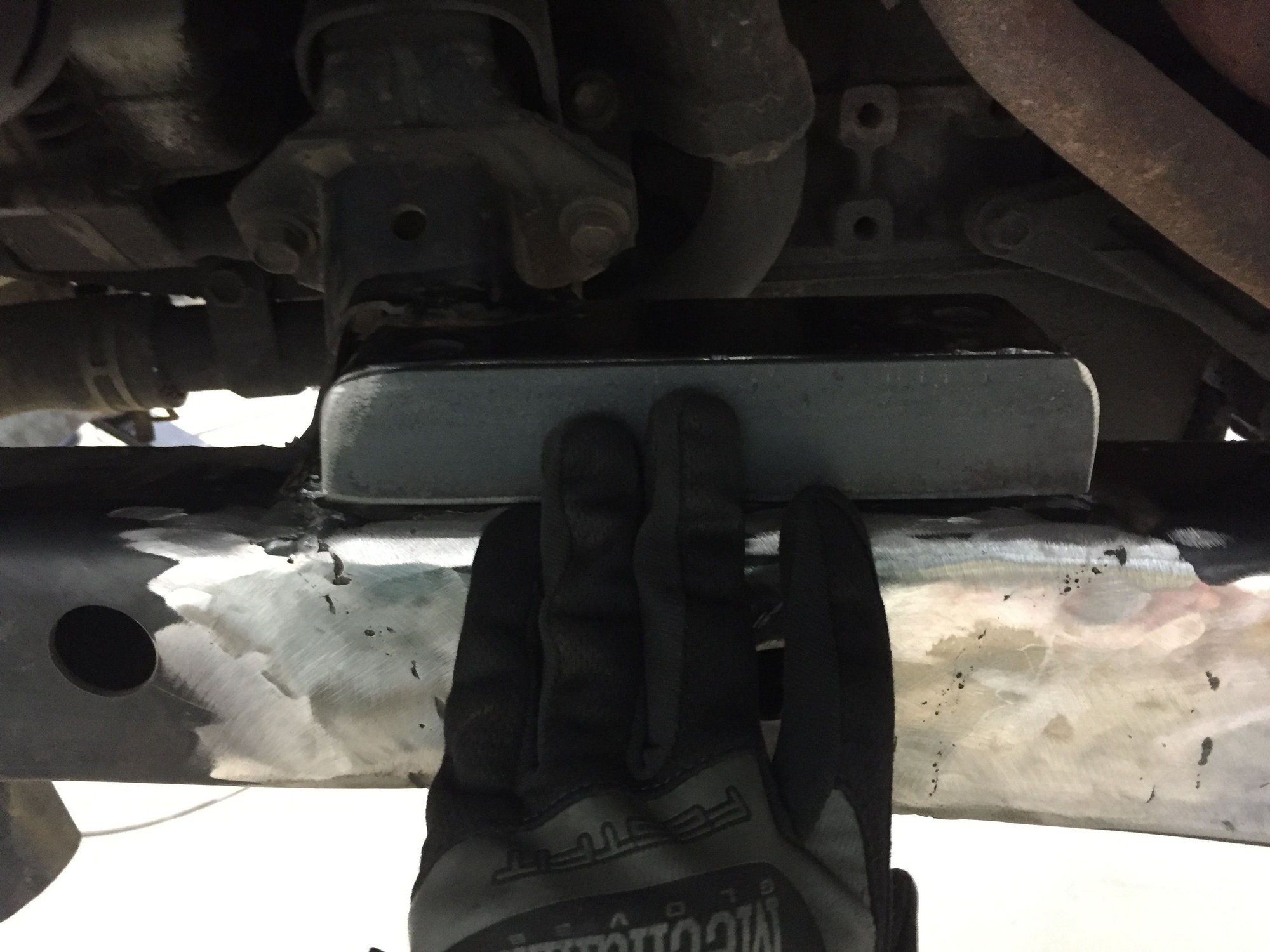

From: Georgia

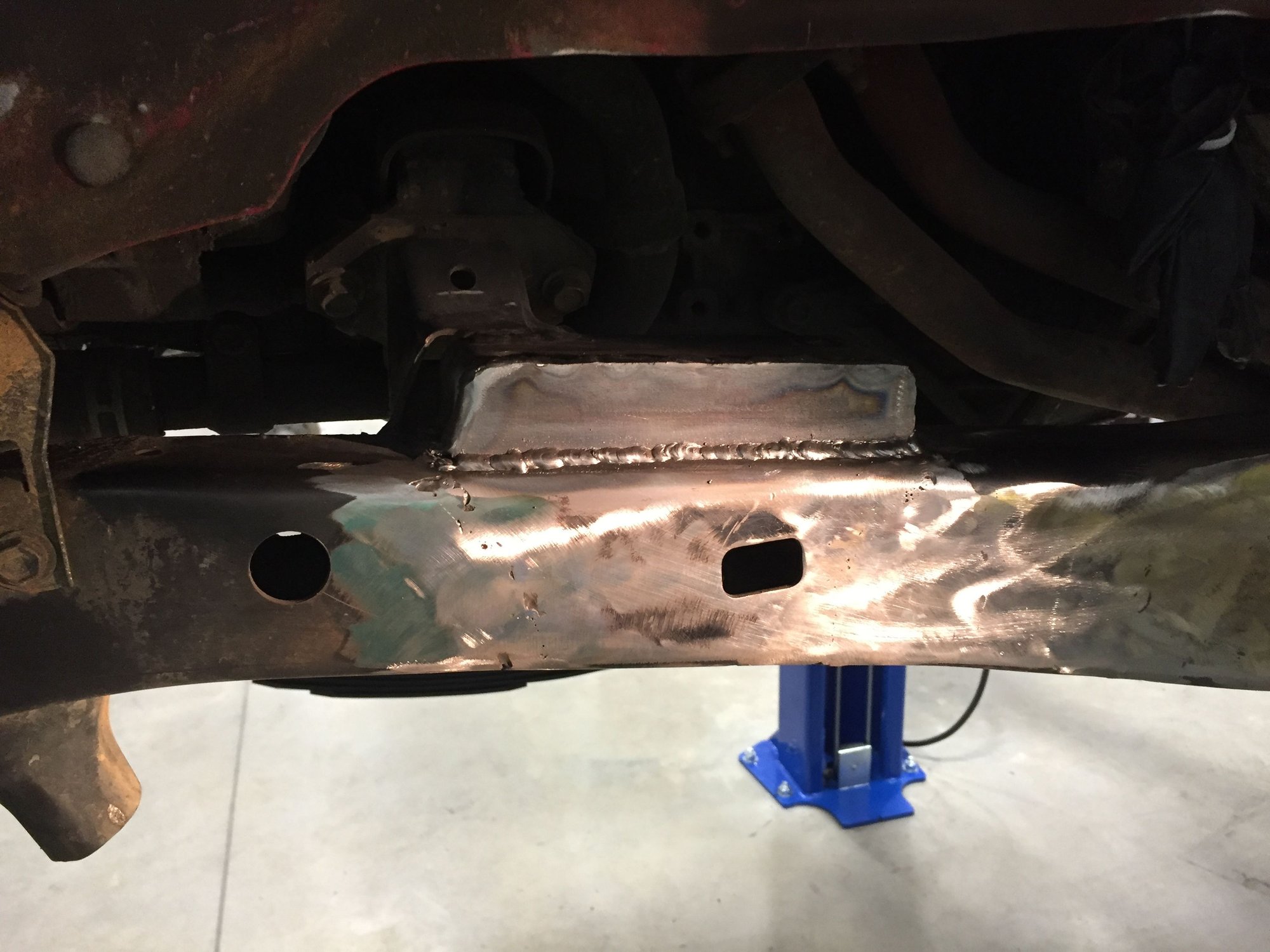

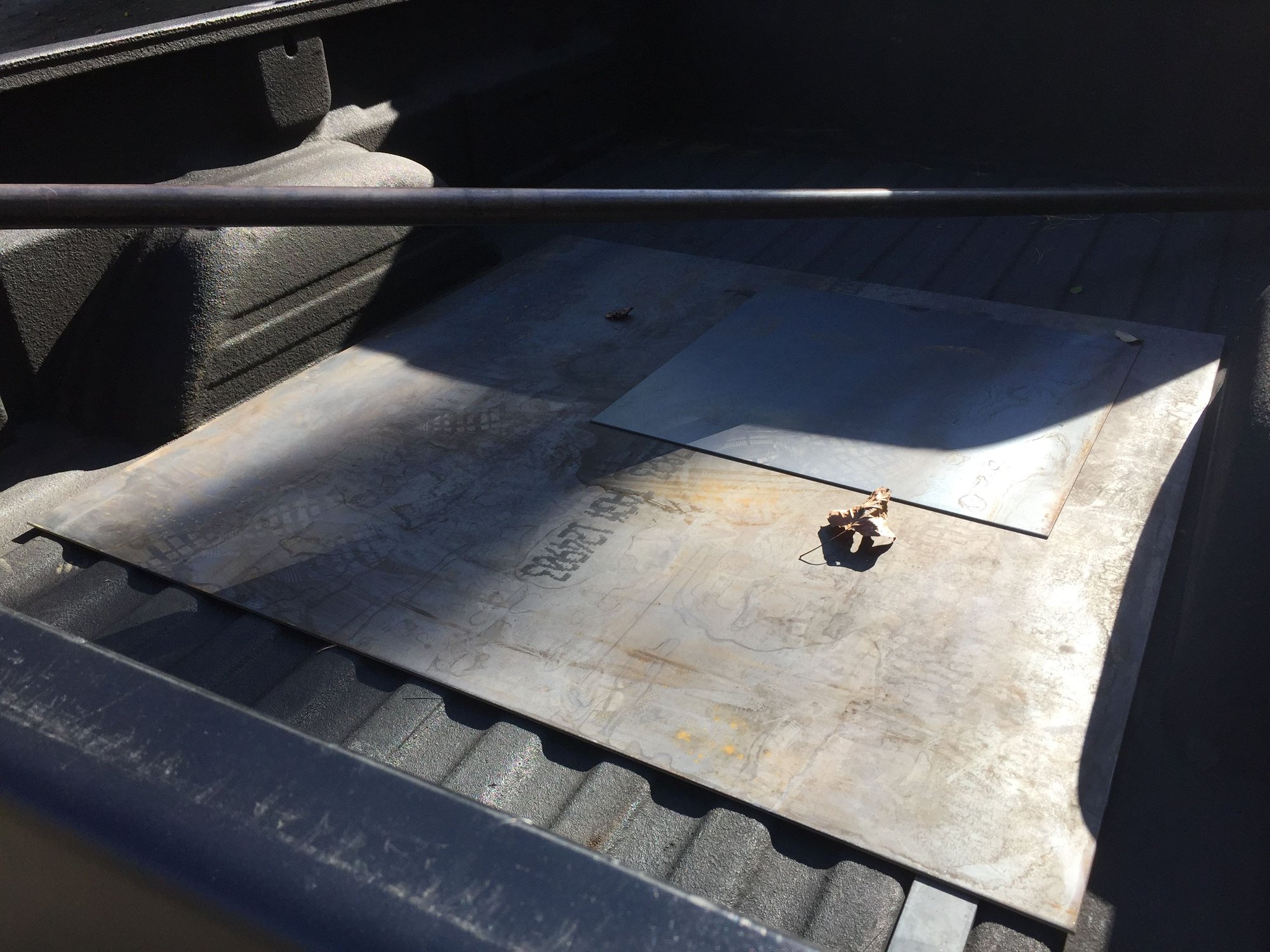

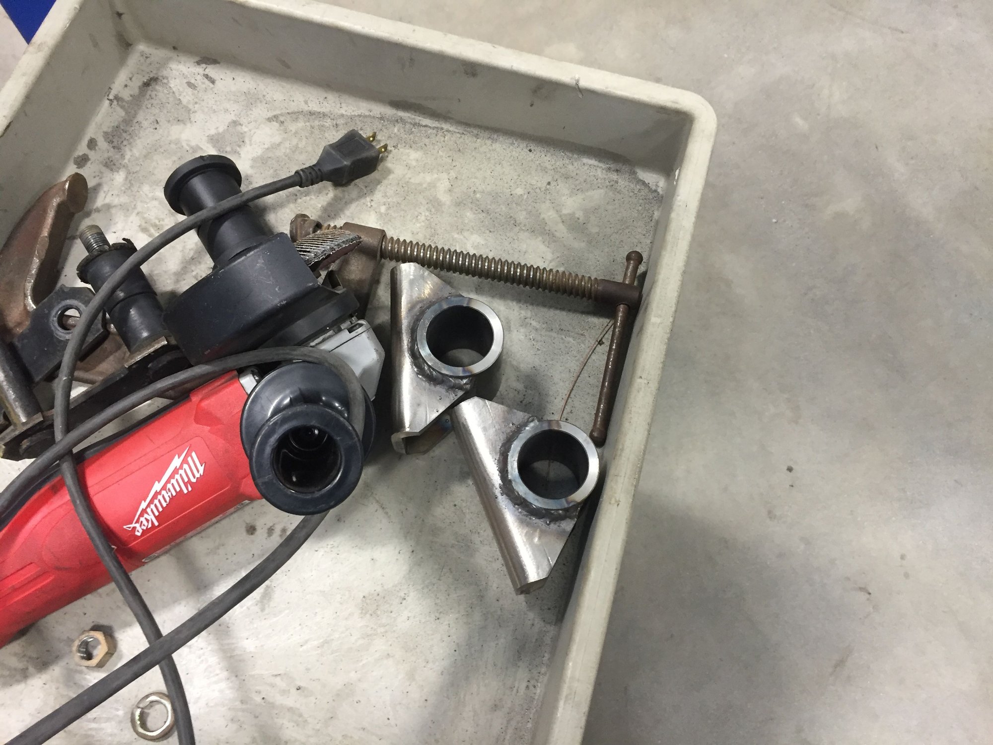

Motor mounts are done. Cut the mounts down and then cut out some plates.

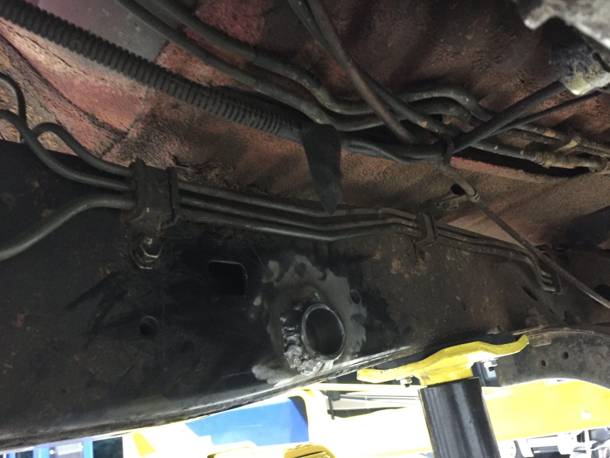

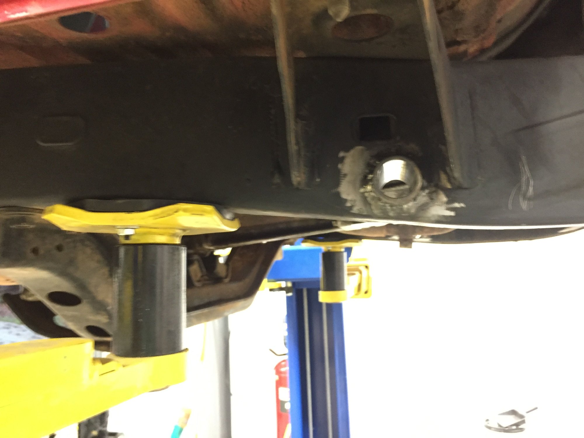

From: Georgia

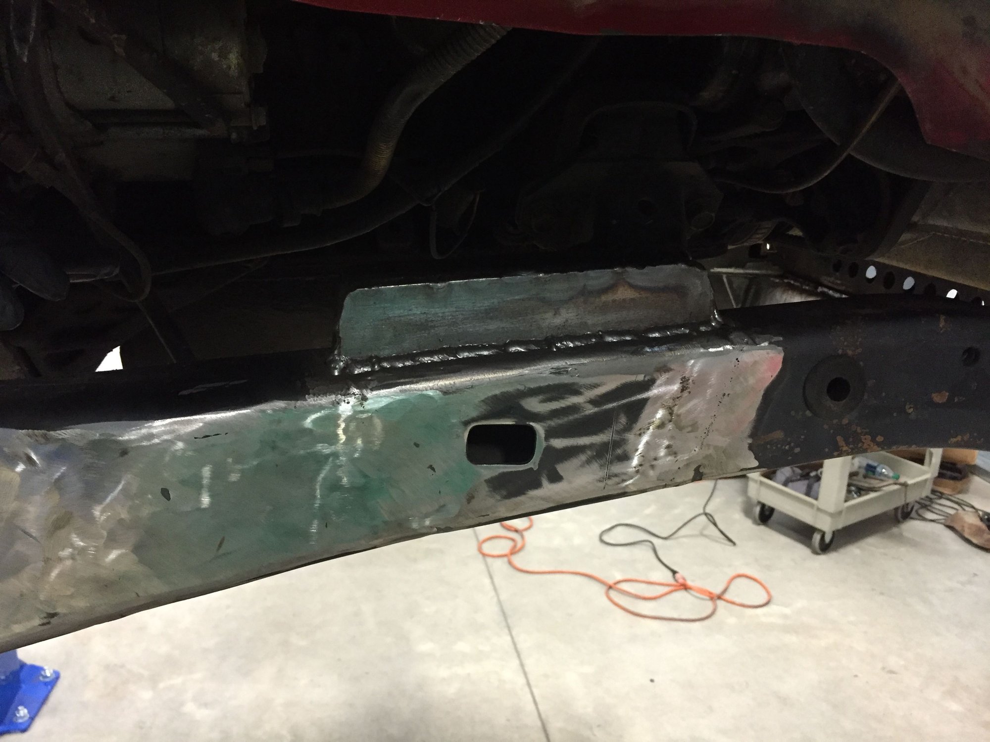

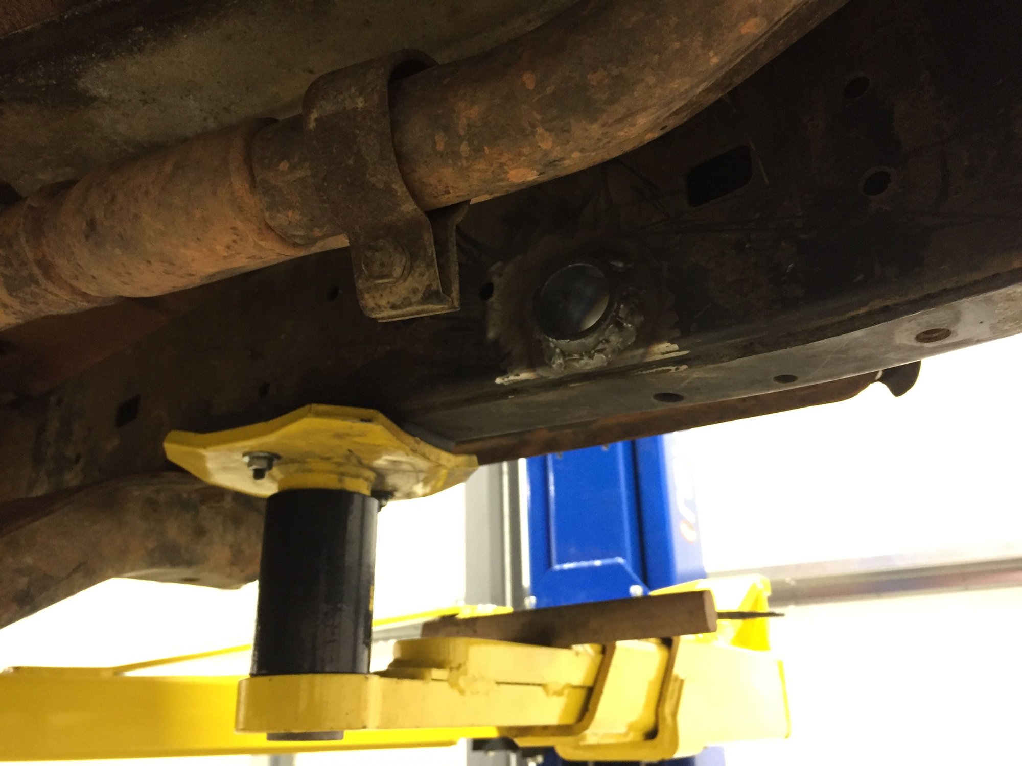

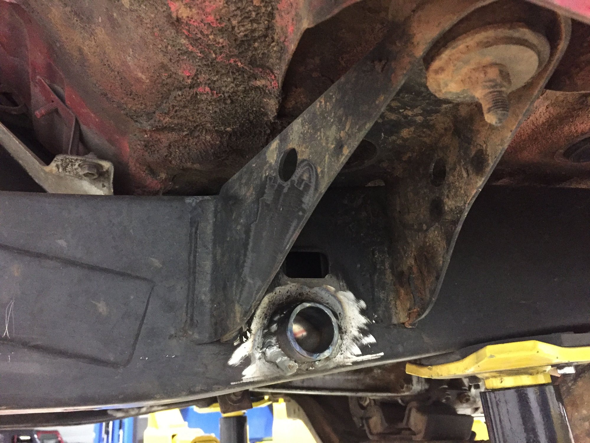

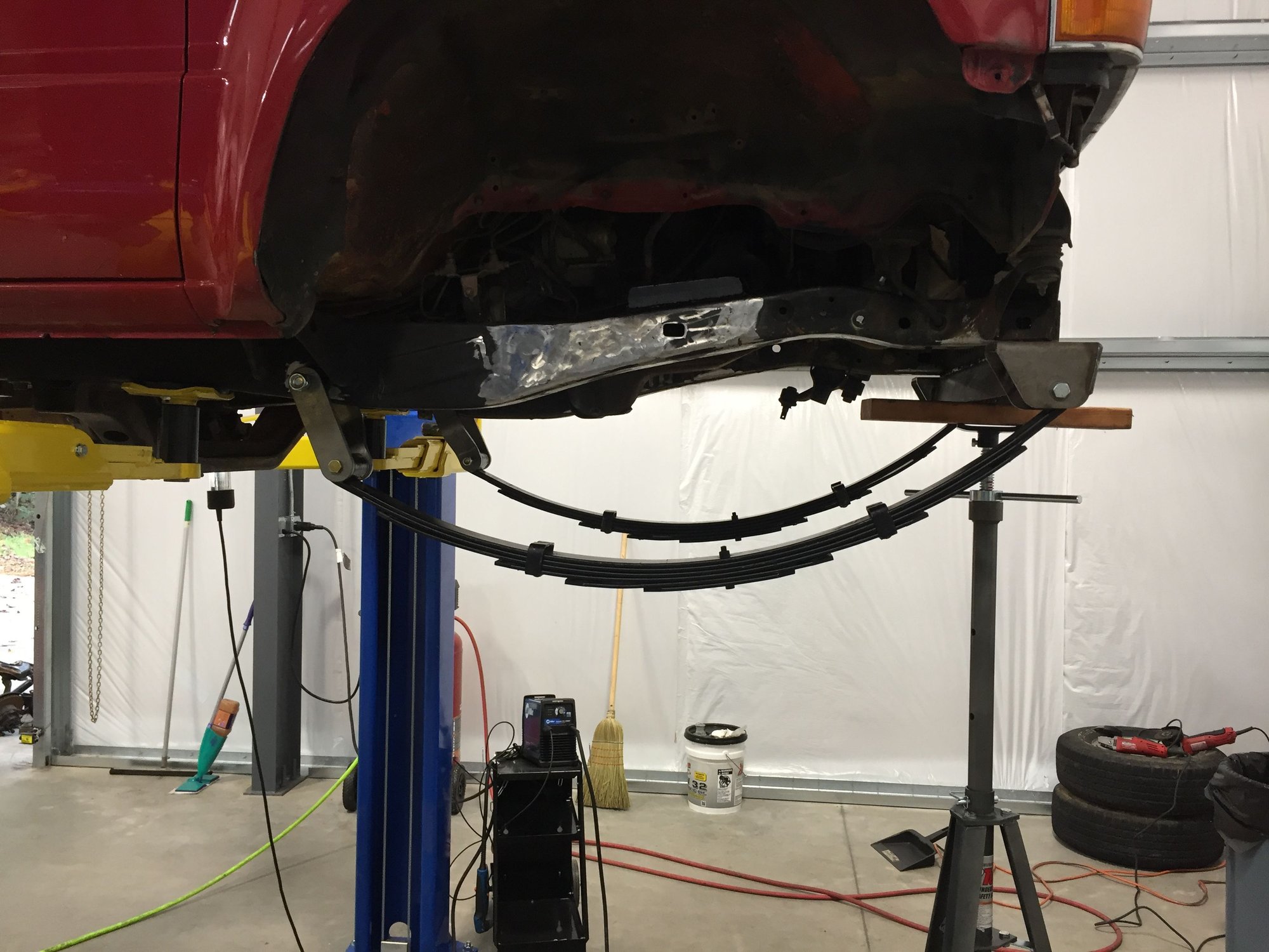

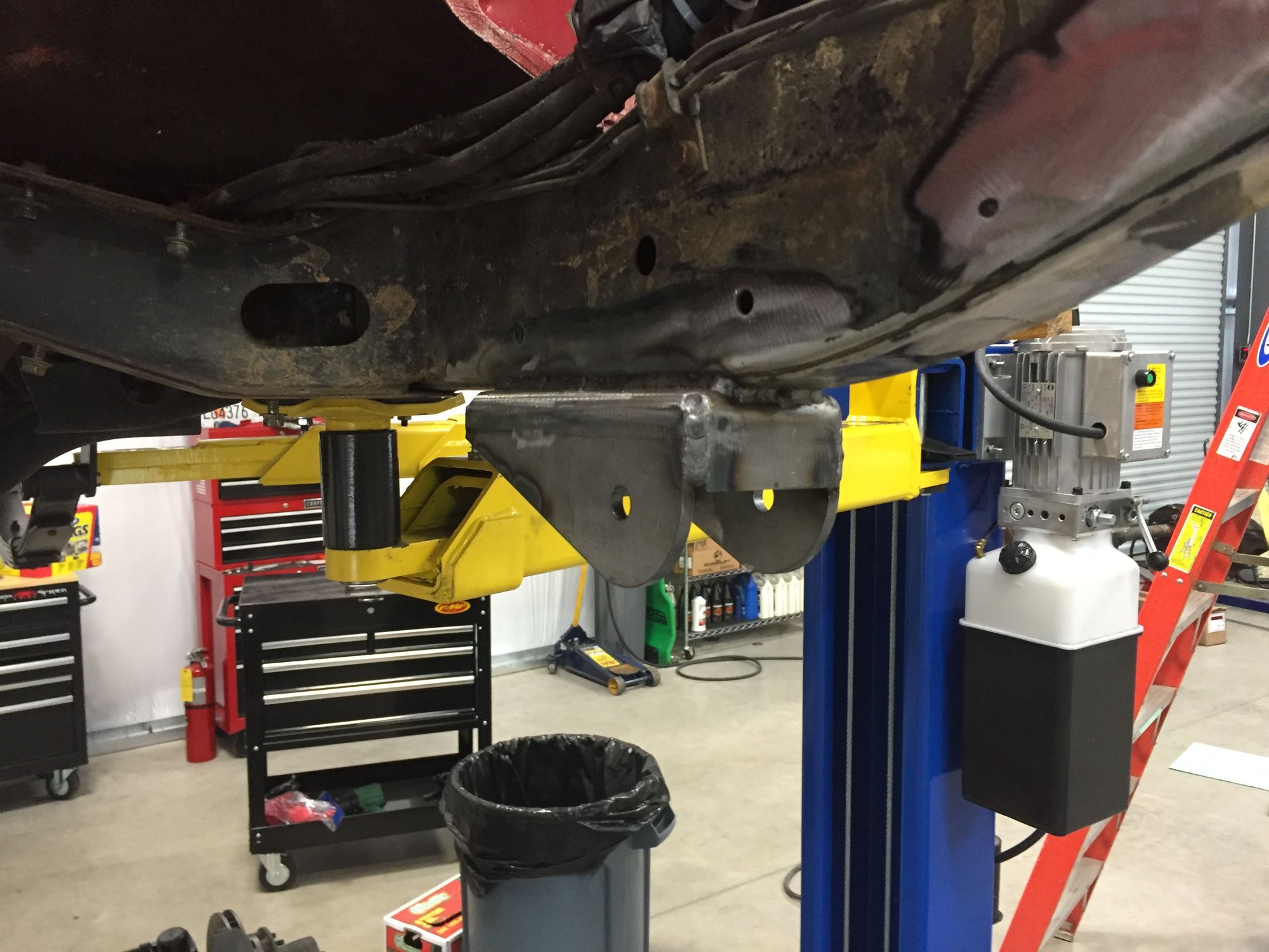

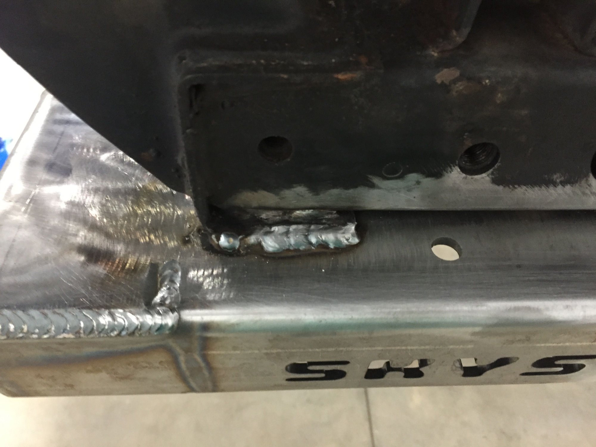

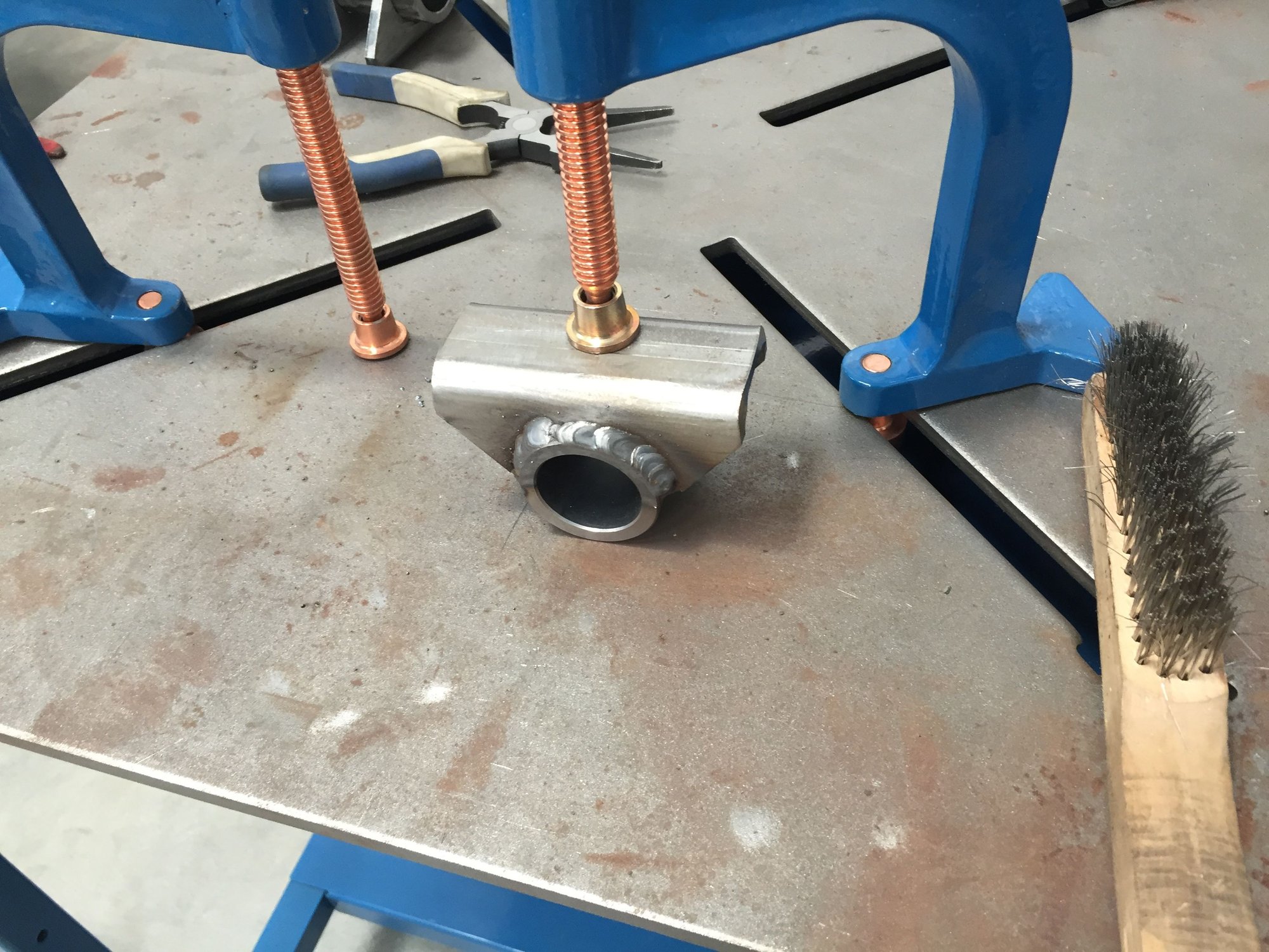

Cute the holes in the frame for the sleeves and burned them in. Hopefully tomorrow I can put the front leafs on for the last time and test fit the front axle.
Heres a pic of them mocked up before i welded.

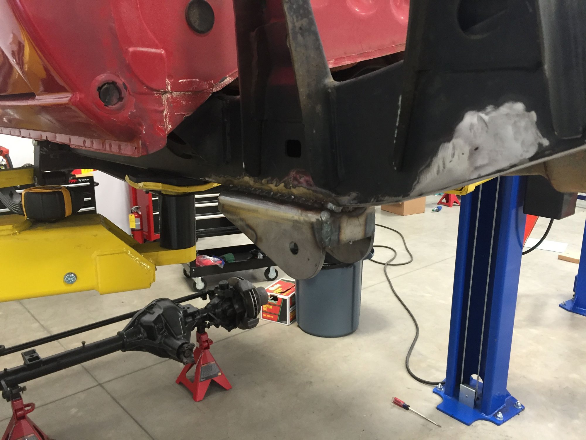

  #117
TheBrokeYota's Avatar
Joined: Apr 2015
Posts: 154

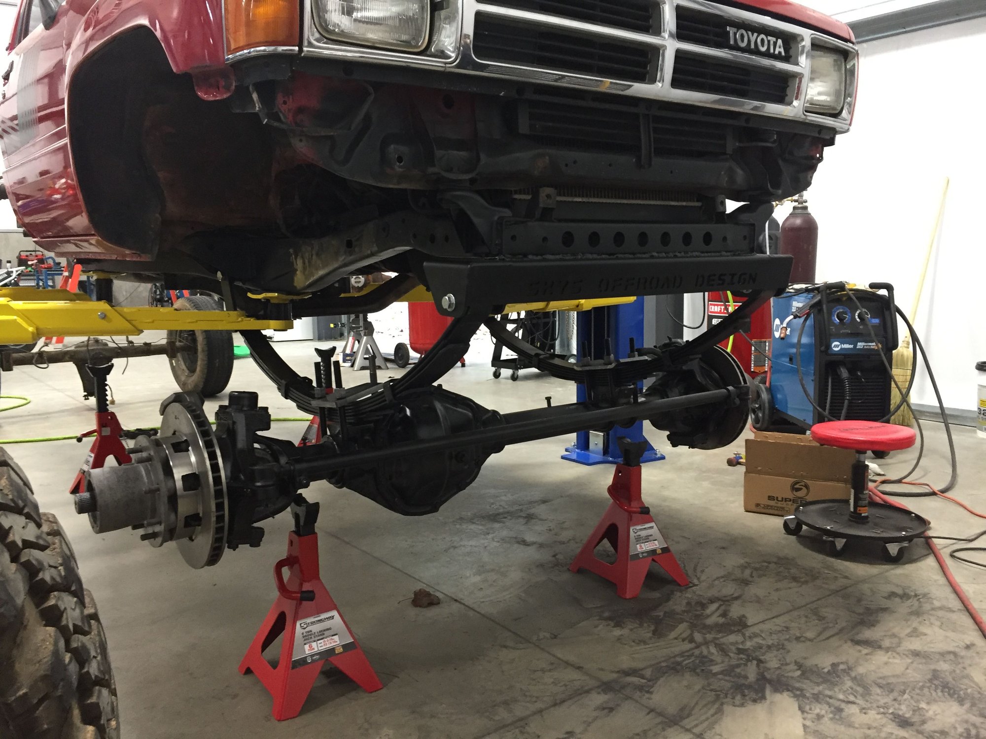

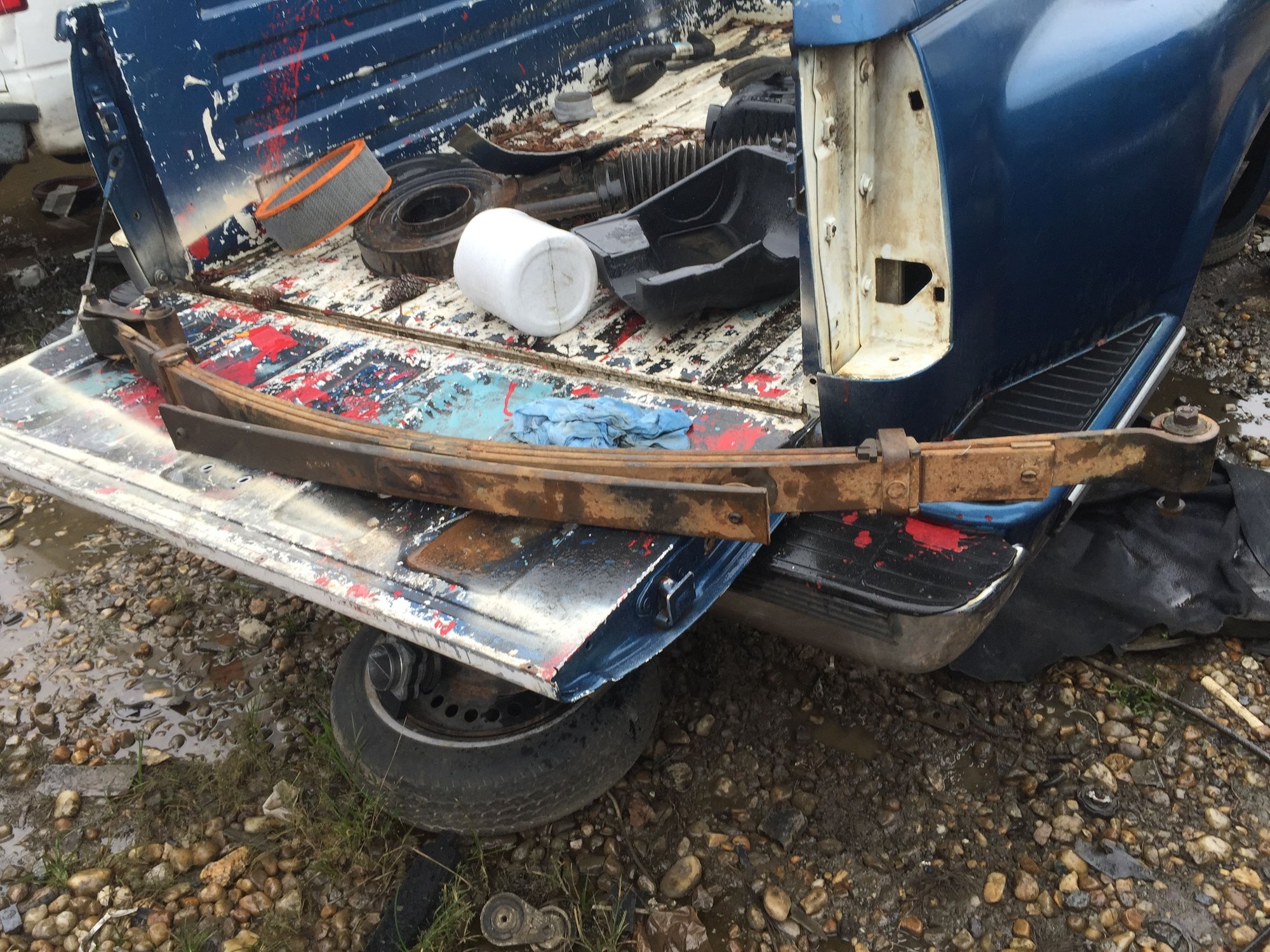

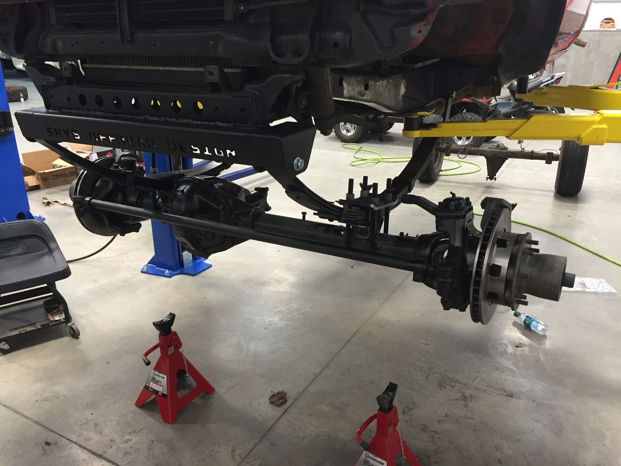

From: Georgia

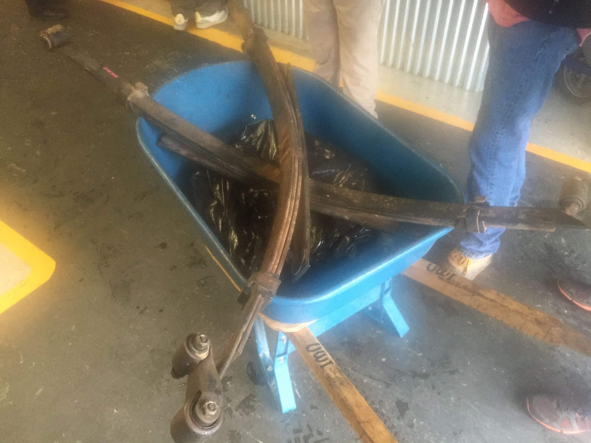

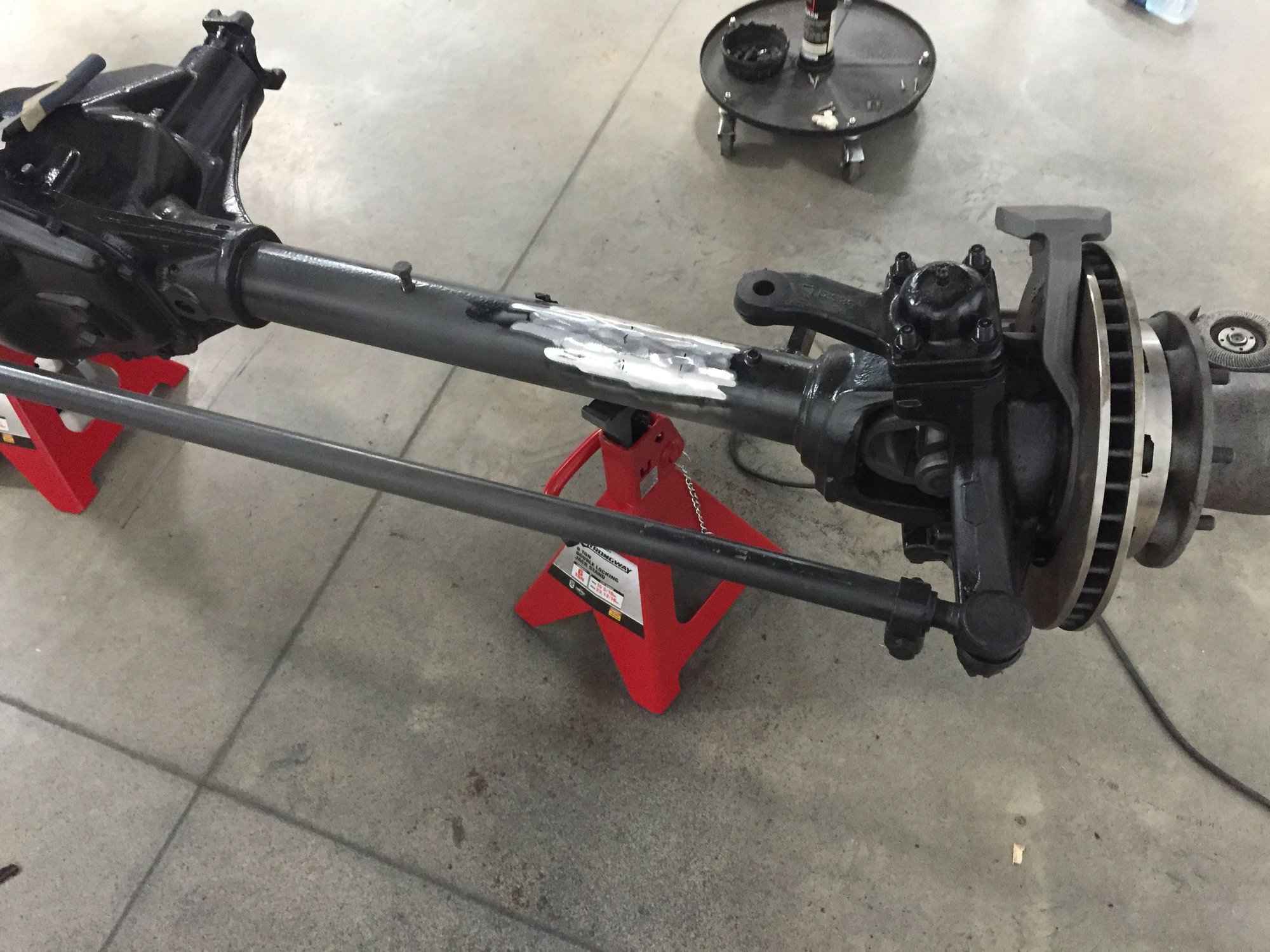

Hit a big milestone today. I got the front axle in and test fitted. As expected, I had to cut off the driver side perch and move it over 3/4" and re-weld it because the Sky front crossmember is made for the chevy 60, which has a different blah blah blah... Long story short the axle sticks out 3/4" farther on the driver side than the passenger side but i can live with it. I also finally went to pull a part and got some 63" springs.

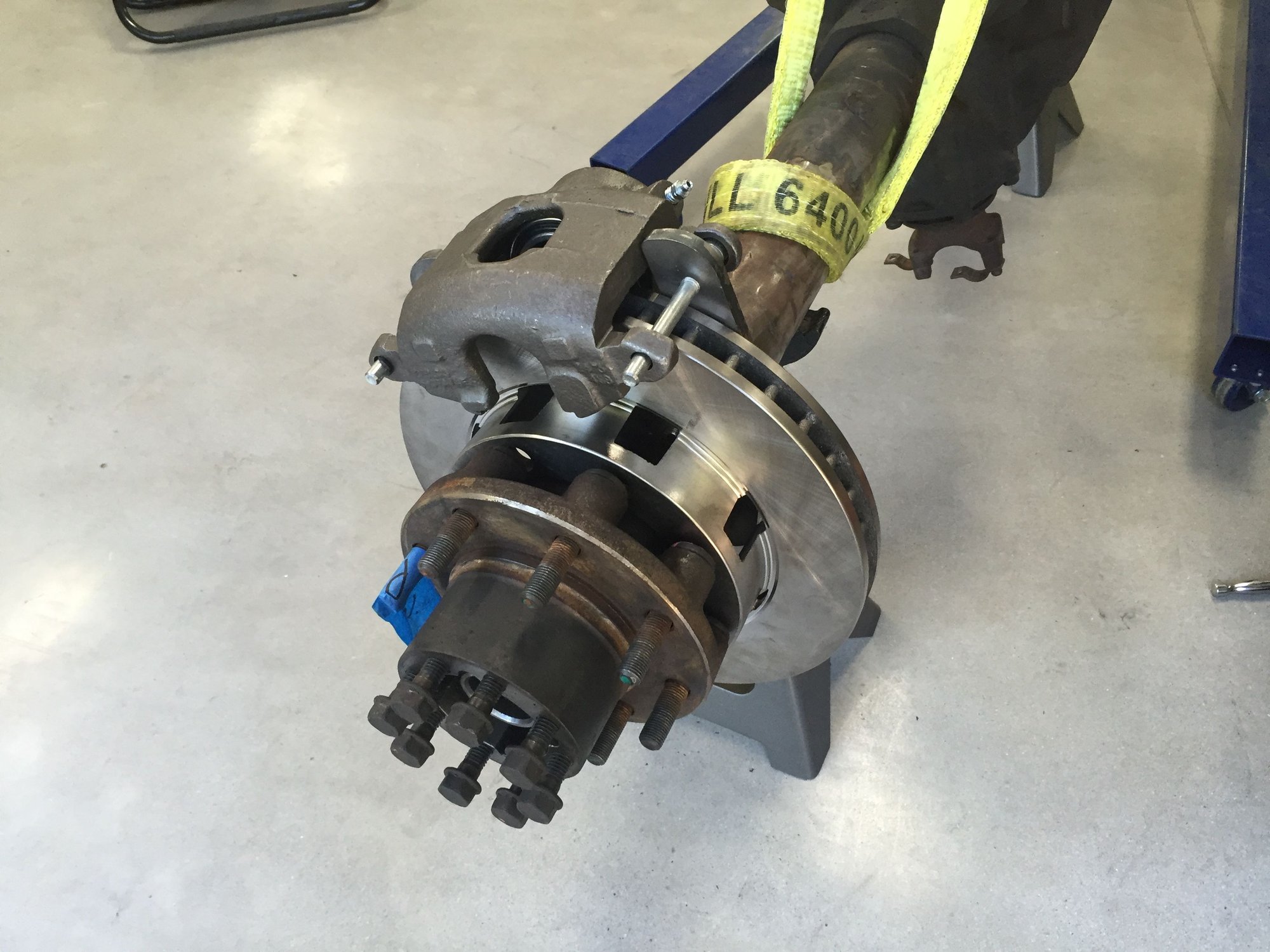

From: Georgia

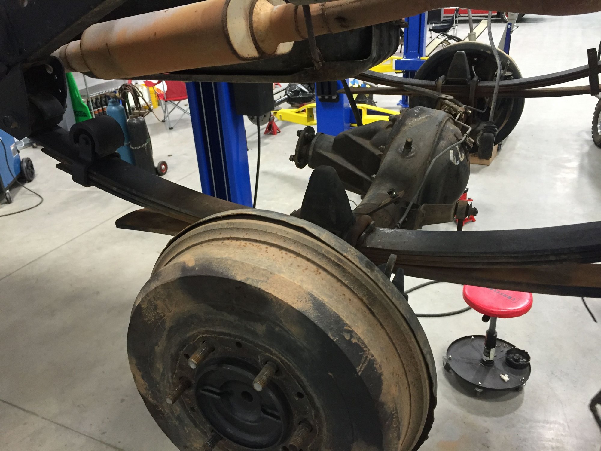

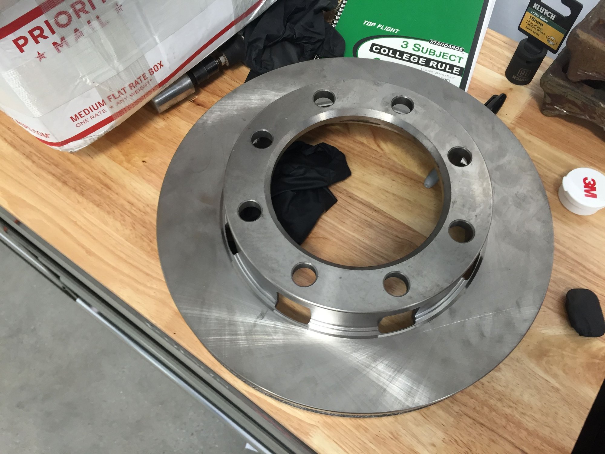

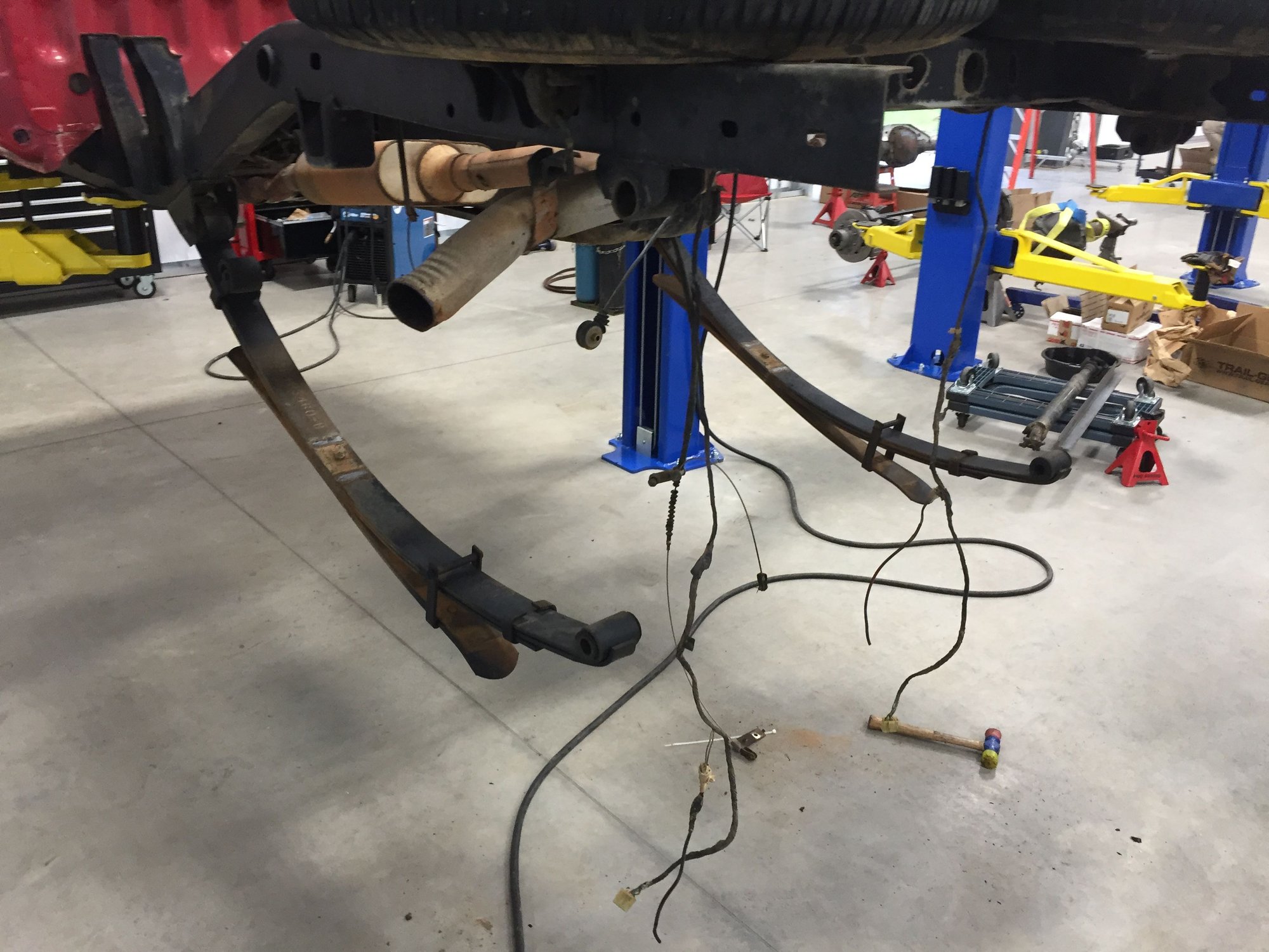

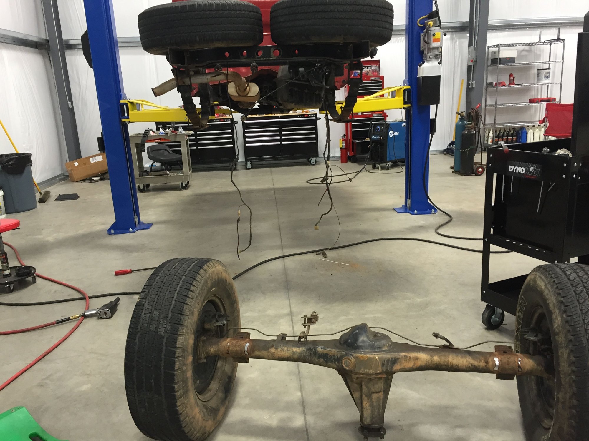

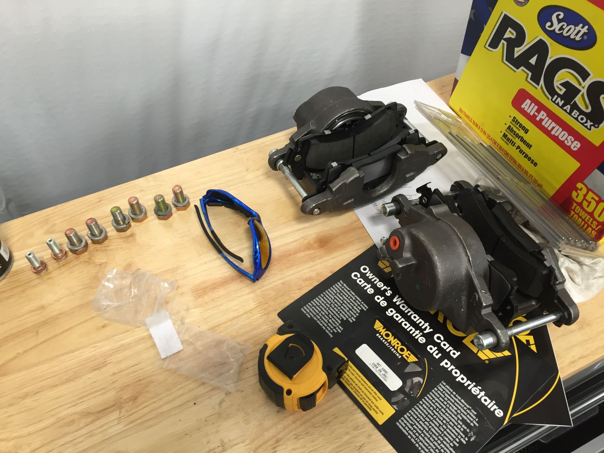

Well, I got all the stock rear suspension mounts off and grinded down. Hopefully, I can have the rear axle in by the end of the weekend. The disc brake kit also came in for the 14 bolt.

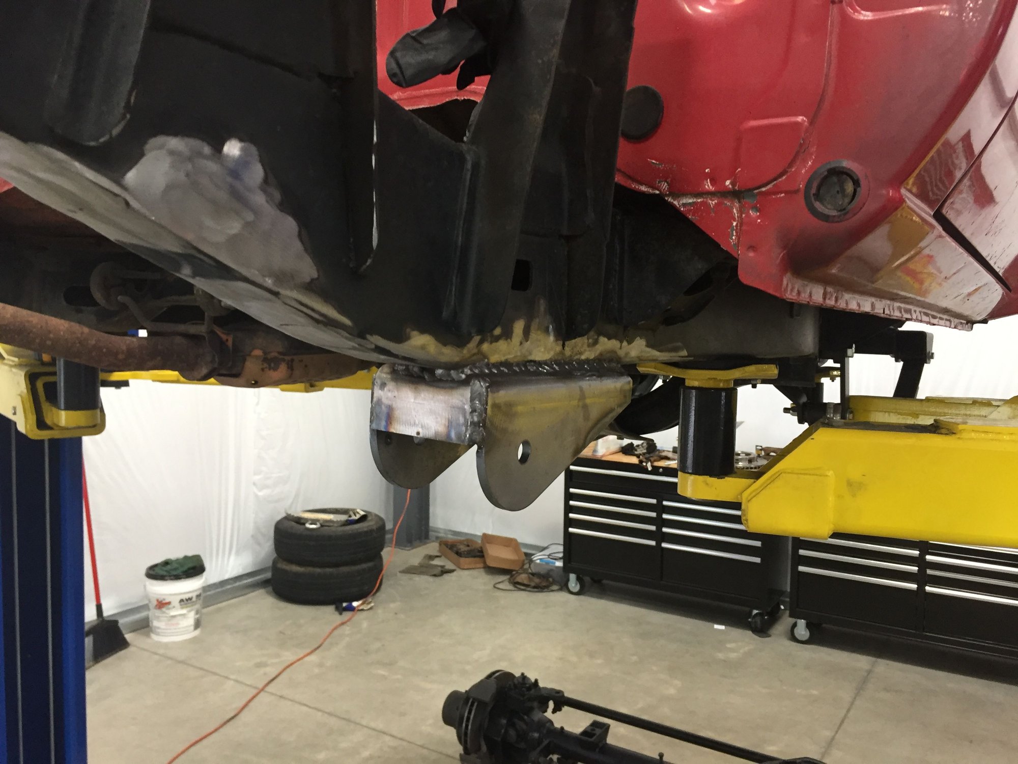

From: Georgia

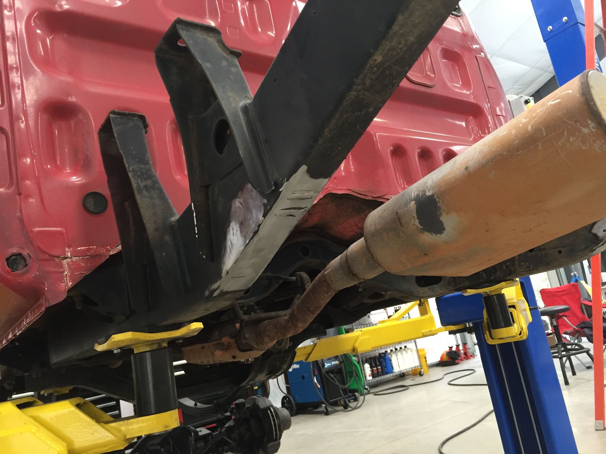

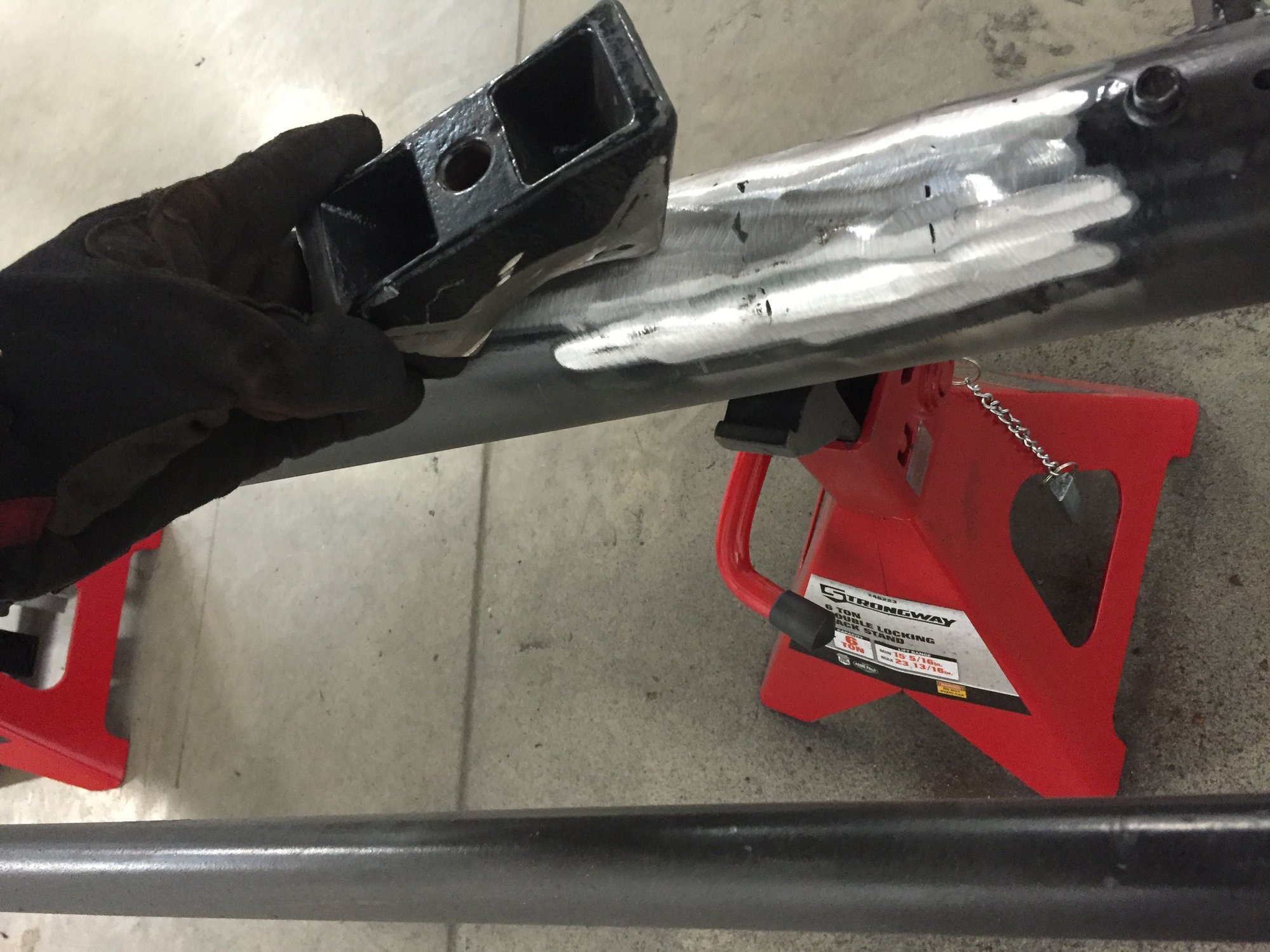

I welded up the rear leaf spring mounts and welded them on.

Posts: 154
From: Georgia

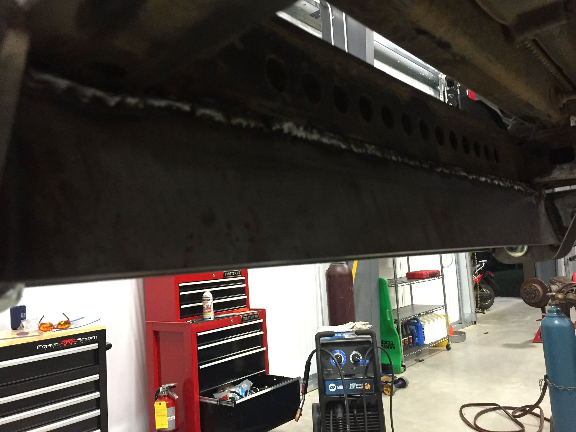

Welded the rear leaf hangers up. I also got some steel to box in the frame in the back, make front and rear bumpers, and make some rear leaf shackles.
