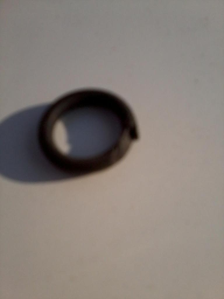

I made some progress with a little step back. I had been driving it for 1 or 2 mile short trips. Sunday I got brave and put 60 miles on it to really check it out and everything went well. I then took it to work which is 35 miles one way. Got to work and smelled gas. It was #4 injector leaking. Had my brother to haul it back home for me on a trailer so as not to catch a fire and burn it up.
Dont know what went wrong. I replaced all of the rubber seals with new ones and have done around 5 head gaskets on 22res and numerous other times of having to pull injectors out for one reason or the other and never had a problem with leaks at the injector. We are getting rain for the next couple of days and soon as I can I want to tear it down and see what went wrong. I sure it will be a simple fix.

heyy it sux about the leak. i came across the same thing on mine.
i fixed it by getting new orings and adding sum grease on them before i installed them. so they slide in instead of getting stuck and ripping.

Hey Twisted and Rob, how you guys doing? I got some good news. I got the leak fixed. Somehow when I put the injector into the fuel rail, I knicked the top O-Ring. Wasnt much of a knick but made a bad leak. UPDATE: OIL them O-RINGS when installing them. (Oil, WD-40,...)

Thanks guys. The Oring that was the culprit didnt have much of a rip in it, but it was enough. I checked and rechecked when I put it in this time. This time I am sure I dont have any leaks.

Dont know why the picture is so blurry, but hopefully you get the idea. Just double check your injectors when you put them in. I have done this several times and never had a problem. I may have just gotten over confident in myself an could of had a big fire. Hopefully this will save someone here a problem.

LOL, mine looks better in pics than it does in person also. It doesn't take much of a tear for those O-rings to not seal, I usually put just a tad of grease on them before I install them, helps it slide in without snagging. Can't wait until my son is old enough to help me work on my truck, I also can't wait until he is old enough to mow the grass take out the trash ect. lol
