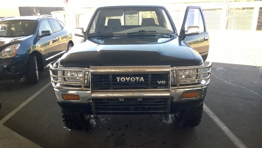

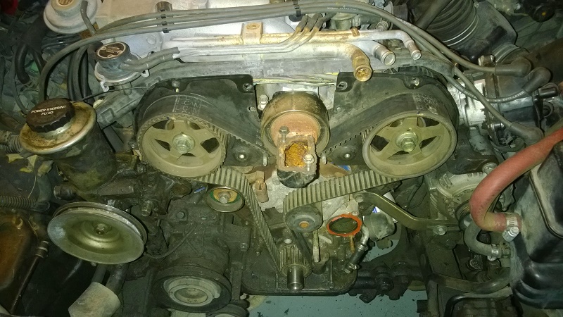

So far, ive replaced the FUEL PUMP, CORRECTED TIMING, FIXED LEAK FROM DRIVERSIDE HEAD REAR and best of all, GOT TRUCK RUNNING!!

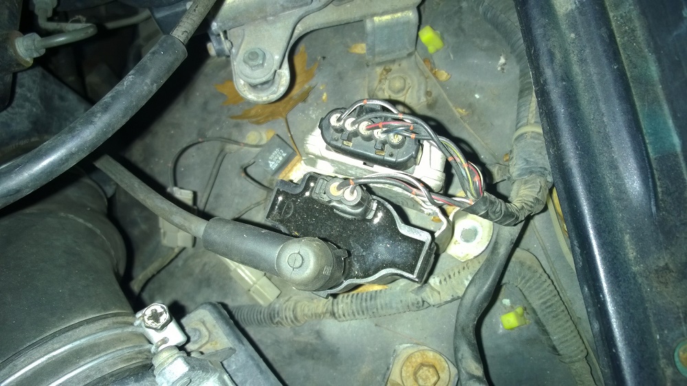

The information I received from the guy tinkering with my truck is that the COIL ($65 at parts store) was bad as there was no spark at the distributor and he asked me to get one prior to returning my truck as he thought that was the issue, it was not.
He then told me it was the igniter that was out and needed to be replaced, upon looking for this I found it was almost $300 for a new one!!! That is an expensive part for a "possibly." Either way, this is when I got my truck back as communications with the guy started up again and I did not want to loose my truck.
I found the igniter on Ebay for $50 bucks and promptly ordered it. Of course, this was not the issue and I was happy to not have wasted the $300 on a new innecessary part.
THERE WERE NO CODES TO GO TO AND NO INFORMATION TO FOLLOW AS THERE WAS NO SPARK... After checking some things, my dad told me to check the fuel pump just in case... and of course, it was bad...

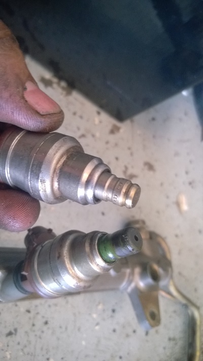

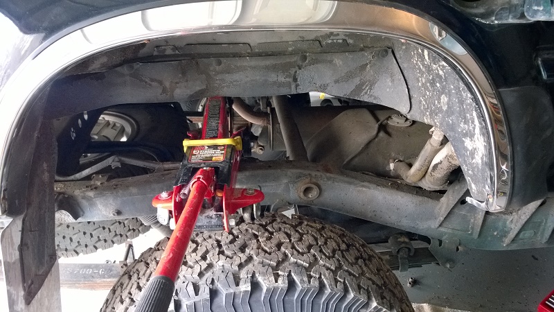

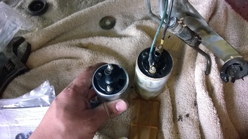

Tested the fuel pump by un-tightening the banjo bolt for the fuel rail and sure enough, no pressure. Surprisingly enough, the FUEL FILTER was still good so I put it back on (I know, I should have replaced it from the get-go but I was just trying to ge the truck started).
I spoke to my friend Sam and he told me it would be easier to pop off the bed than it would be to drop the tank... My dad on the other hand, told me the oposite. I came to this site and guess what? It was thesame thing, some people saying lift the bed while others said drop the tank... I lifted the bed and replaced the fuel pump easily...
STILL... TRUCK DID NOT START!!! I made sure there was fuel everywhere it needed to go to. Still had the issue with no spark.
Attached Thumbnails teaMJPx 1989 Toy Pickup SR5 Buildup Thread-wp_20140331_023.jpg   teaMJPx 1989 Toy Pickup SR5 Buildup Thread-wp_20140331_039.jpg

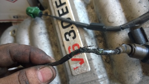

I was now getting frustrated that my truck was not throwing a spark and running out of options quick... I decided to re-check my work for the timing belt, this time meticulously going through everything ensuring nothing was out of place...
THEN I FOUND A WIRE PINCHED AND CRACKED WHERE THE INTAKE MANIFOLD MEETS THE PLENUM...
I did not think anything much about this wire but decided, since I saw it, fix it... Had to take the intake manifold off to get to the pinch and noticed the manifold screws were loose and barely holding it in place. I patched the wire and made sure there was no chance of pinching anything else, also took a look around to make sure there was nothing else wrong... Well, found there were a few screws loose here and there so I made sure to tighten them. I also found one of the return hoses from the bottom of the manifold was completely cracked... how can someone put that back on an engine? Well... Thats what I get for not working on it on my own...
Anyways, went to the autoparts and got a suitable replacement hose and put the truck back together... I had taken the Dizzy out again just to give it one last look... I put it back on the truck... I re-attached the battery cable... Cranked the truck and...
IT TURNED ON!!! OMG! THE ENGINE WAS RUNNING AS I HAD BEEN DREAMING OF... Well, sort-of... But its RUNNING!!!
(Picture of wire and how I wrapped the wires after...)

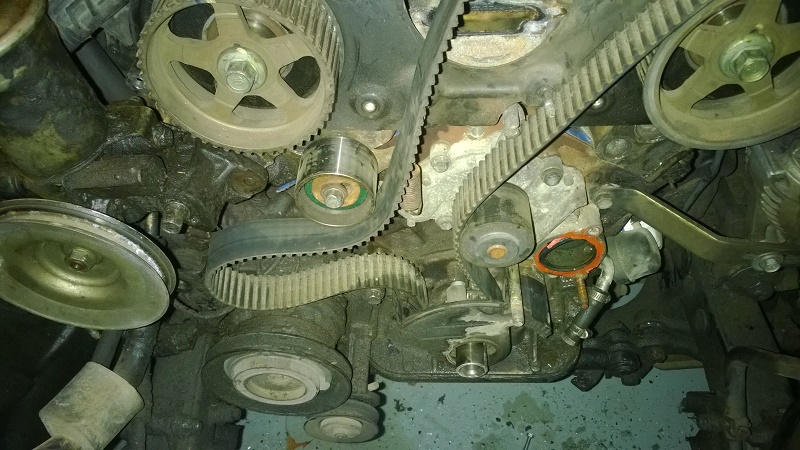

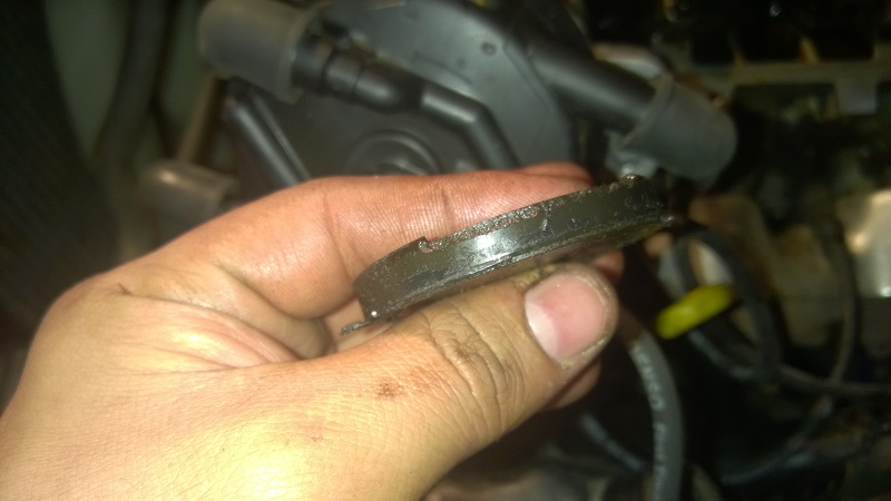

I was so happy to have the truck running I immediately began getting it ready to take it to emissions, of course the 1st go round it failed miserably. I decided it was time to replace the distributor cap, rotor, spark plugs and wires to make sure all the fuel was being burned correctly. Once these parts were replaced and I felt comfortable with the way the truck was running, I took it back to emissions. The truck passed with golden colors, I was finally able to use my truck as my daily driver once again.
Of course that could be the end of it, but since it's me it wasn't. I drove it to work my 1st day and when I parked I noticed a small puddle of oil under the truck. I don't like to use sealant or anything like that to clear up issues with the engine so I was stuck trying to find out where the oil leak came from. After looking up some information and speaking to my dad and my friend I concluded there is only one place really that the oil could be coming from... The valve covers.
I went to the auto parts place to order a new valve cover gasket kit and began taking my intake manifold back off. The leak was coming from the driver side and not the passenger so I focused mainly on that side of the engine. Of course, I thought I found my problem so I immediately replaced the gasket, put the engine back together and took it for a spin again. Unfortunately for me the oil leak was still there, replacing the gasket actually made it worse.
When I spoke to some people they said this could only be a bad job by me and that I needed to make sure that the seals were seated correctly... So I had no choice and took it apart again, making sure the seals seated correctly in the valve cover. Put it back together again and went for a test drive once more... Again, oil was leaking heavily but I could not locate where it was coming from. Spent days trying to figure it out with no success...
Finally, I went to buy a mirror (should have had one from the beginning... jejeje) from the autoparts place to inspect where the leak was coming from as I was not able to locate it and found my problem... Behind the engine there is a CAM CAP for each CAM and the driverside one was leaking. I had to take off the rear-most knuckle from the CAM to get the CAP off and...
Here is where I found another problem from the guy working on my truck... When I extracted one of the bolts that holds the CAM in place, part of the thread from the head came with it.
I had a nice coil of aluminum at the bottom of it that came out with the screw... I also noticed there was black stuff at the end and realized he used some gasket maker to ensure the bolt did not fall out...
I was livid to say the least!!! But that would have to wait for a tap and dye...
I tried to find this part (the CAM CAP) but was not able to as it is a hard part to find, everyone referred me to order from TOYOTA but that was going to take weeks to get back here. I found Nashville Engine Supply Warehouse and was able to get the part ordered and delivered next day for 11 dollars total. AWESOME!!!
Got my part and was able to replace the bad one. I also re-tightened the screw which went to the partially stripped head and it held... mostly. Lucky for me, the valve cover actually makes pressure on this last knuckle so between the semi-tight screw and the valve cover, my issue sealed itself... jejeje
Anyways, I finally got it all back together and voila! Most of the oil leak is gone. I have found a new leak but its from the carter and I can fix that easily... Will do when I do a bit of suspension work so I can take the oil pan out and thoroughly clean it as it should be, there is only a few drops coming from it so im not too worried... But on to the next issue...
(VICTOR REINZ PART #B45855...)

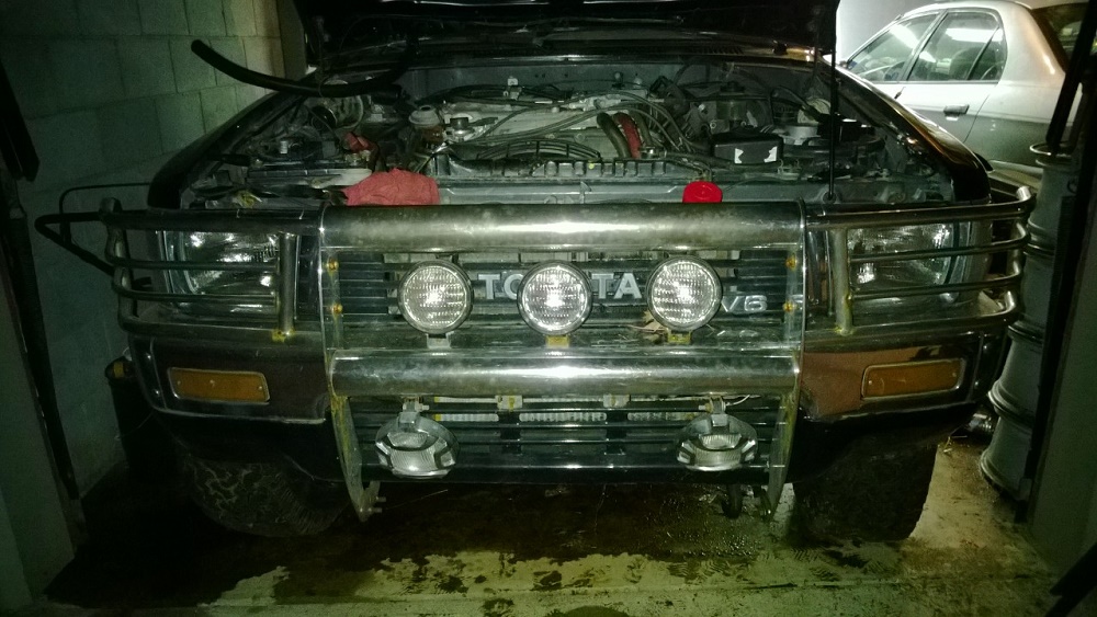

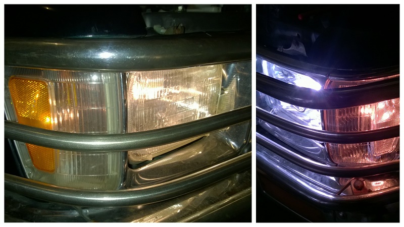

Changed the lights to an h4 conversion kit. Still waiting for my new rear lights and clear bumper lights.

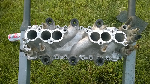

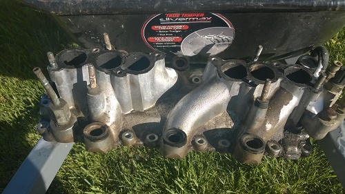

So... I went to 3 different Auto Salvage Yards here and what I found was surprising...
NO ONE WOULD SELL ME ANY PARTS FOR THE ENGINE!!!
Aparently, since these trucks are in such high demand around here (and many other places) I am not allowed to go to the yard and take parts... I can buy the engine or the whole truck... WOW. I went to different places and two said the same, another said they don't even have them because they have people that have them "on order" so the moment they get a TOYOTA its already sold. The other places and went to and called said they can sell it in pieces but when I asked for the DASHPOT I was offered the whole intake manifold with TB and DASHPOT... EXPENSIVE for some reason...
After wasting my whole morning looking around for parts I decided to go to the autoparts store... That was also pointless as the PS Pressure Switch is not available anywhere... When I took the PLENUM off I broke the TVV and was not able to find any of these parts... TOYOTA only... I did not want to waste the day so when I got home I took off the plenum and began to clean it...
THAT THING WAS DIRTY!!!
I encourage anyone: If you are going to be going this far in, go ahead and clean it out. It visually makes a difference and I'm sure this will make a difference in performance. I will be doing this to the intake manifold today as well. I also received my new KNOCK pigtail yesterday and went ahead and slapped it on.
I leave with pictures of the plenum and pigtails... jejeje

I went ahead and finish cleaning the intake along with the throttle body to make sure everything was good and followed suit with the plenum I did yesterday. The intake was so dirty that even after all the chemicals I had bought I was still not able to finish cleaning it, but I was pretty satisfied with the amount of cleaning I had done. I had already cleaned the throttle body before but I wanted to clean it as I didn't want it to feel left out... jejeje
I put the plenum back on the engine and was amazed how beautiful it looks once it is clean. Before I put the fuel injectors back on the plenum I noticed some of them were missing the caps at the bottom where the injectors meet the plenum. I went to the parts store in was quoted over $750 for a new set of injectors. They were not able to offer me a rebuild kit. I don't know about you but at this moment I cannot spend 750 plus just to get some injectors on my rig. I spoke to my dad and he gave me the confidence to go ahead and put it back together the way it is and it just hope for the best.
Being the thermal vacuum valve (tvv) was broken I went ahead and plugged it directly in to the charcoal canister with no problem. Put the intake on top and make sure I wasn't crossing any of the pipes. I put the intake back on and had a chill down my spine because I knew it was time to test it.
I turned the engine on and it sounded beautiful. Within a few seconds I had a smell of gasoline and I noticed a leak coming straight from the throttle body. I immediately shut the engine off and took a look, the in port of the throttle body was somewhat rusted and did not allow for a proper seal; due to this I was not able to check where the gas smell was coming from.
I went ahead and cleaned off that port from the throttle body and got a new bracket to make sure I could tighten it correctly and make sure the leak no longer occurred. Turned the truck back on with no issues and continued to have the smell of gas so I investigated. Found the rearmost driver side injector to be leaking lots of gas.
I don't seem to be experiencing any of the prior problems I was having with the exception of the smell of gas. I was unable to go and test the truck as I am unwilling to drive it with gas spilling everywhere. I'm stuck at this moment because I need new injectors. I'm going to see if I can get a deal on them on eBay or at least get a rebuild kit.
This sucks I wanted to drive the truck to work tomorrow and my wife is losing confidence in it because we are supposed to be taking the truck to Texas when we go visit next month so my dad can see it since it was his gift to me, but we can't take it if its having problems as it's a thousand miles away.
Anyway I gotta search and see what options I have left.

Old Apr 24, 2014 | 06:56 PM
94mackyota's Avatar
Joined: Aug 2013
Posts: 43
You can get upgraded 4-hole injectors from Flamethrower for $135 + shipping. Comes with new o-rings and plenum gaskets. Go on ebay and search flamethrower injectors 3vze.
Old Apr 24, 2014 | 07:03 PM
teaMJPx's Avatar
Joined: Apr 2014
Posts: 62
From: Tennessee
I realized that once I was looking at the threads and saw he is offering some to test them out. I sent him a PM but I did not realize he has them at such a low price. I can afford 150, I can't afford 750+. I looked at a rebuild kit but this is definitely something I can do. I'm waiting on his PM but his injectors are what I'm going with either way
Old Apr 24, 2014 | 07:08 PM
94mackyota's Avatar
Joined: Aug 2013
Posts: 43
I think that he is done with the free test ones but I could be wrong. I was just looking and he has remaned ones for $75. I bought his upgraded 4 hole ones for my 22re and they work great. He calibrates them before he sells them. Also very speedy shipping.
Old Apr 24, 2014 | 07:13 PM
teaMJPx's Avatar
Joined: Apr 2014
Posts: 62
From: Tennessee
I'm looking and can't find his injectors for the 3vze... I find him on eBay but as far as injectors go I find "Injectordyne" and "ozzydebear" and others but don't see his. I'm still looking as I need these bad...
Old Apr 24, 2014 | 07:31 PM
94mackyota's Avatar
Joined: Aug 2013
Posts: 43
Sorry. You're right. Those were injectodyne I was looking at.
